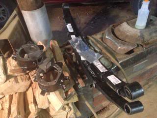

Allpro 4" lift springs showed up with bushings and tube jigs.

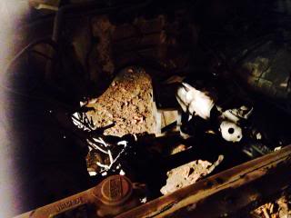

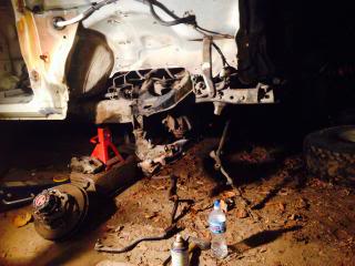

Moved the 87 in the shop today in the rain. Managed to take apart the passenger side hub,brakes,swaybar,shock,steering etc. Trying to decide if i can just go at it and start cutting or if i should br more careful and try and salvage the stock brackets that are welded to frame if theyre worth anything to anybody...I guess id like to just start cutting but i thought id get some input and do some research also.

You can pretty much start cutting and smoothing off all of it. Take your time and don't thin out the frame. You will need new shock mounts anyway and the four places it ties in to the frame are unnecessary. Sawzaw and a good grinder.

I say just cut it off. I think the only stuff worth saving is the aisin hubs. Torch off and smooth out with a grinder and a flap wheel.

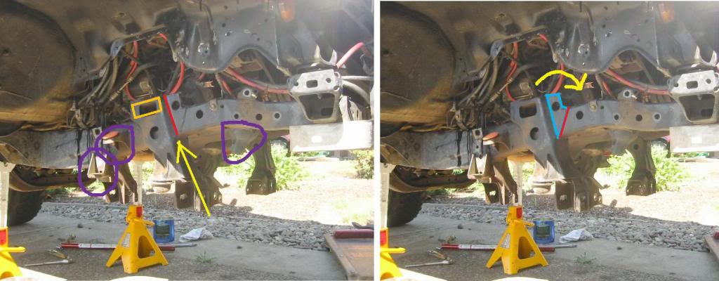

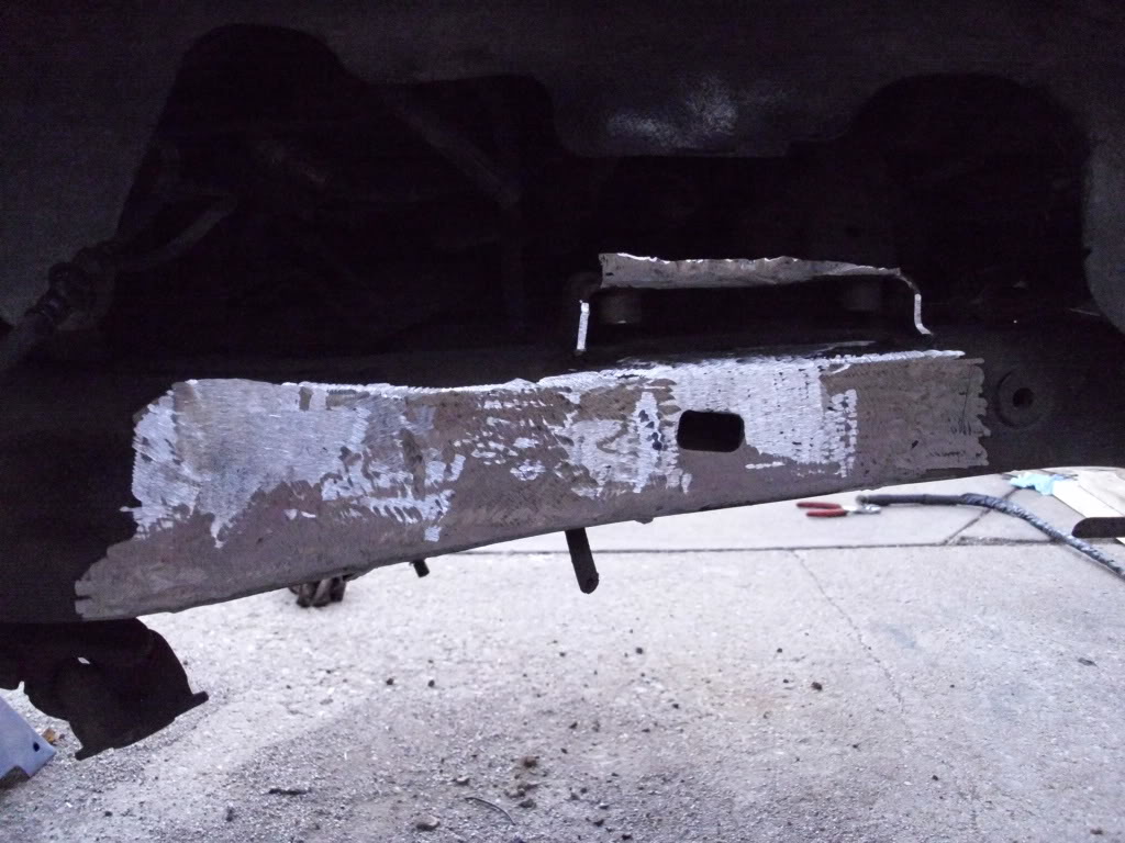

Okay I made a little diagram here. All the stuff in purple on the left picture can be cut off. I cut along the red line on the left picture. Then on the right picture, I folded the blue outlined portion out 90 degrees and cut by the red line again. Then you will grind that weld down. The orange box on the first picture is the spot that you will need to weld a piece of flat in to box it back shut. Hope this helps!

Ayight..Looks like i cut a little more out on the right side by the motor mount but nothing i cant fix.The left side ill do like you show in the picture Joe.Thanks for the help! Back to cutting and grinding.

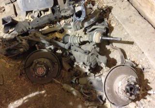

Some IFS stuff i removed.

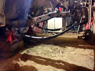

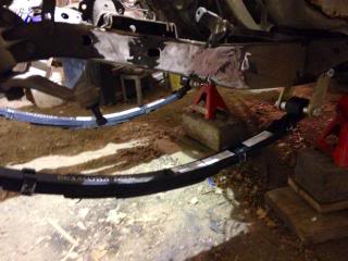

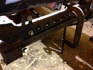

Dunno if i have the spacers in the correct spot, also the tubes are just mocked up,i still need to make sure theyre sqaure with the world before i weld them.Also i guess they get cut off flush with the frame??
Here you can see the angle of my shackles...ive seen them in different positions so i do not no if mine are setting good or bad?I also have the hangar a half inch over. I placed the tubes towards the front of the body mount.Also i still have to box in the motor mount/uca bracketry.
Spring hangar moved half inch forward.Also seems to be alot of excess thread on my pins.
Right side

As for the jigs i moved them forward inside the cab mount and used a 1 3/4 hole saw. Made for a nice snug fit with room for making sqaure.

You don't have to cut the tubes off that get welded into the frame. And you won't be able to tell anything about your shackle angle until the full weight of the truck (with engine) is on the springs.... You'll be fine though. You're not doing anything different than the typical sas...............Did you get your 220V hooked up?

Looks good. And like joe said you don't have to cut the tubes. If you look at mine they stick out from the frame at least an inch.
You made some serious progress!
