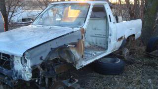

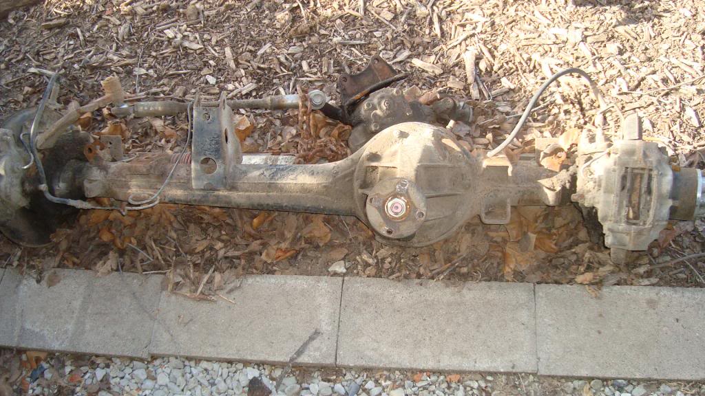

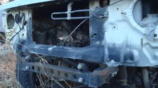

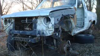

Managed to peice some stuff together and start a sas on my combonation of 87 and 88 4x4 trucks. My 88 is a dd and my 87 has been a parts truck. I plan on using the 87 truck because the cab and frame are in better shape than the 88. But the 87 is a carb 22r and the 88 is a 22re. Ill be removing the w56 and 22re and putting that and the wiring in the 87. My front axle im using is out of an 85 4x4 with 4.10s. I also have a 4.10 rear to match so i dont have to mess with changing gear although i wish they were 5.29s.

the 88

frame damage on the 88

The 87

85 axle

Man i didnt realize how good of shape that 87 was in. This is going to be a bada$$ project.

Yea that white 87 was bought by my neighbor with only 12,000mi on it. As far as i can tell its never been in an accident, and the frame is real nice. The cab is in great shape, the box is workable. The cab does have the notorious drivers front mount rusted. I will be swapping my 22re and w56 from the 88 and all the wiring. Id really like to put in a 4.3 but i dont have the $$$ To do it right now.
