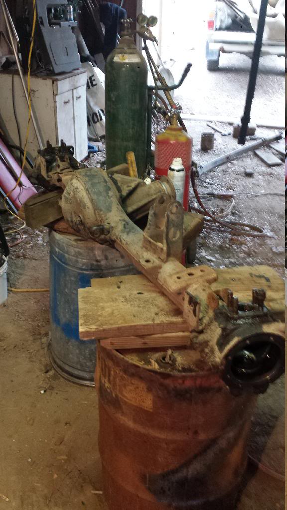

Dad helped me load the 85 axle outta my yard and into the garage, i made a makeshift bench for it to start disassembly to rebuild it,clean it up,paint it, and install the upper gusset after i hack off the crap i dont need. Ill post some picks later..gotta go to wild game feed.free will donation, alligator,pheasant,beaver,deer,raccoon are just a few of the things to try.yummy...and theres beer inolved as well.YAY

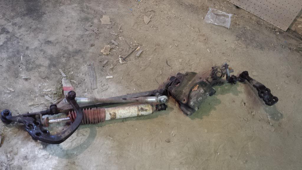

Heres the 85 axle in the garage.

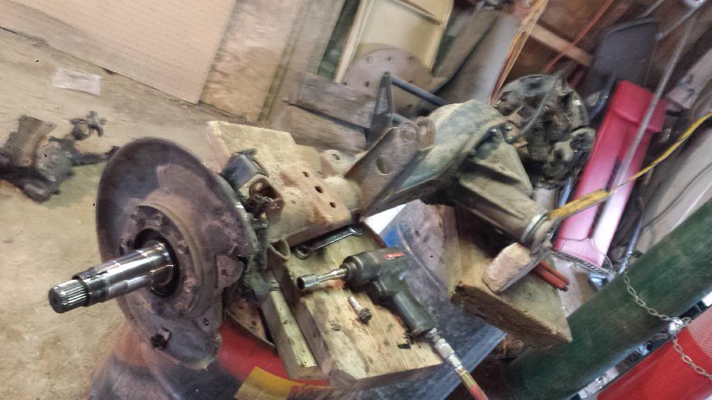

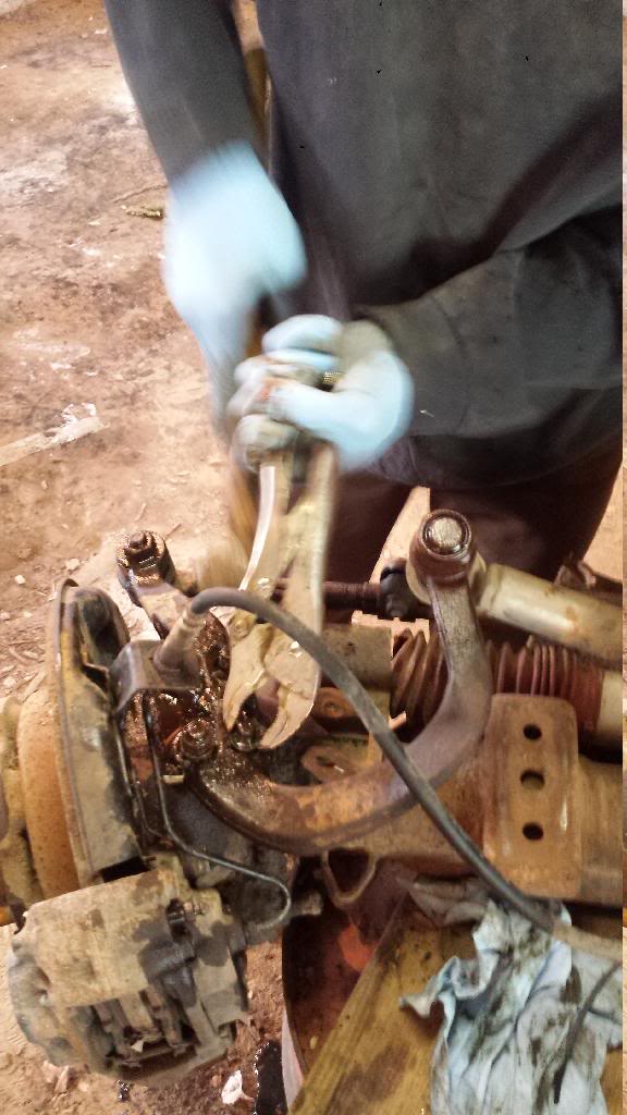

Smack these with a brass drift and theyll bust loose.

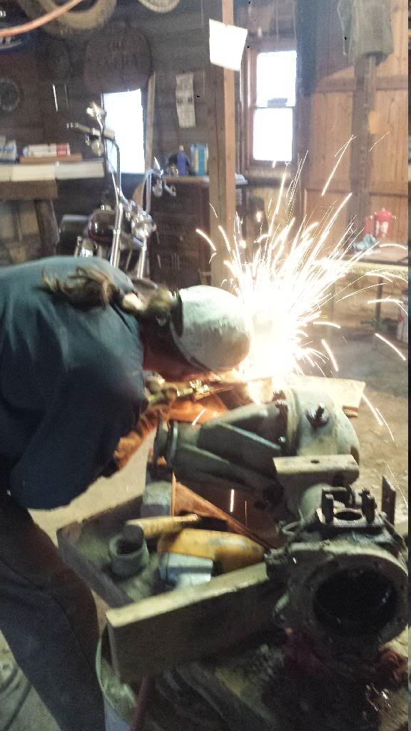

Cut some stuff

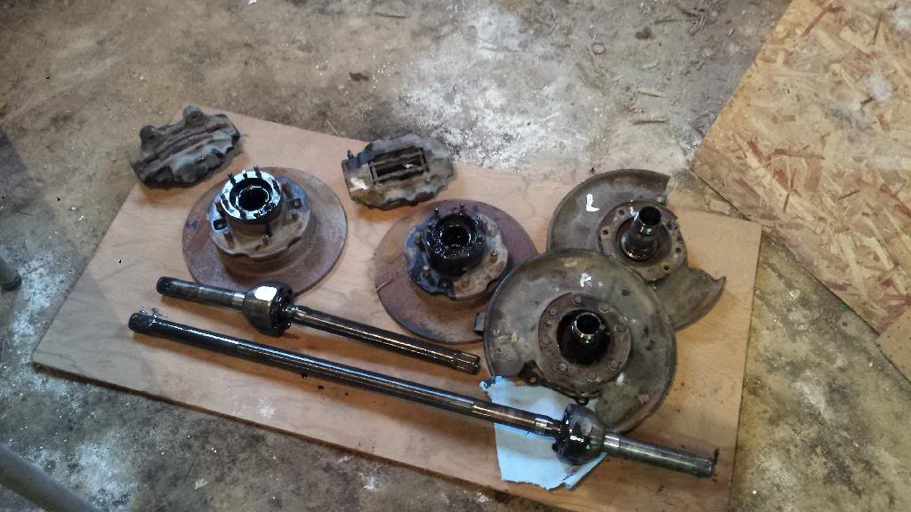

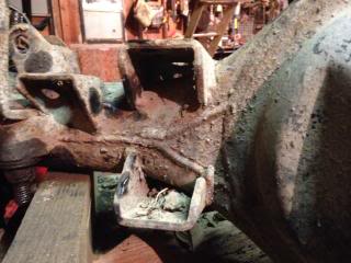

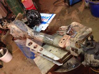

did some more cutting and grinding,
3rd member looks good,just filthy

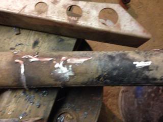

do these tabs get cut off with the bolts??Not the shock mounts of course...

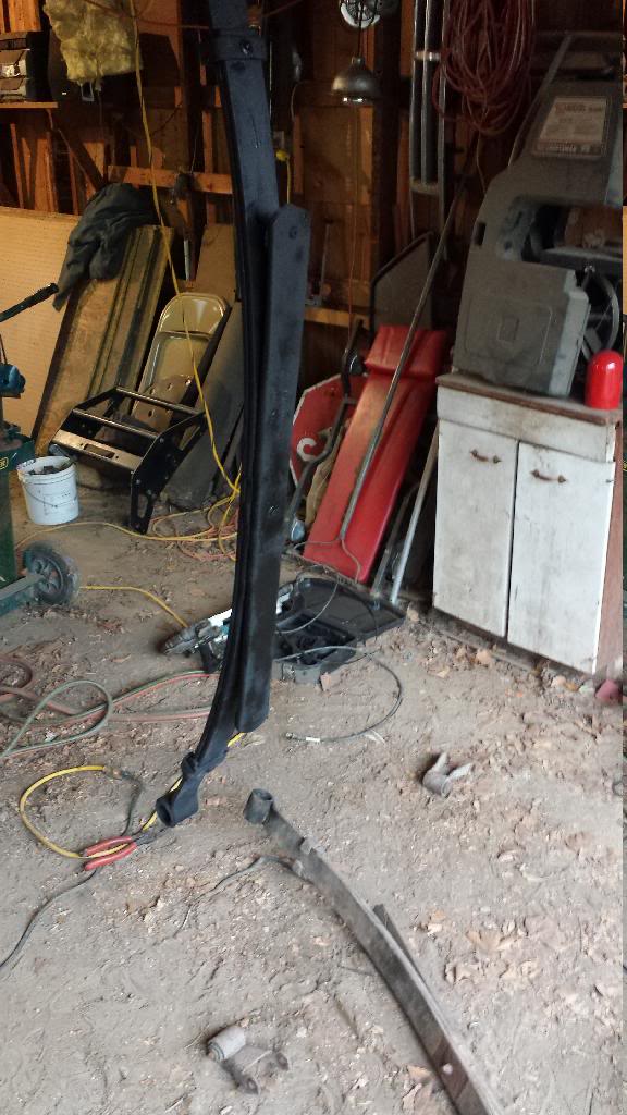

and the perch on the bottom??
my front spring hangar...tryin to figure out what kind it is...The shackle bolts are threaded to where the threads will rub on the bushings, which isnt good, Gizler told mr thats a trait of trail gear...
Had to help my bro get his cylinder head off tonight and it was parent teacher conference and my boy is doin great!!!YAY!!!But i didnt get as far as i wanted. It looks as if the PO of the front axle didnt ever change the axle grease...very broke down and dirty but the ring and pinion look to be well so i hope theyre ok.

Looks like the bottom perch on the right side of axle stays!!Good thing i didnt hack it off.
