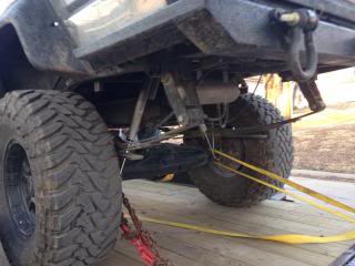

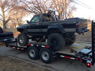

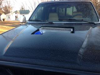

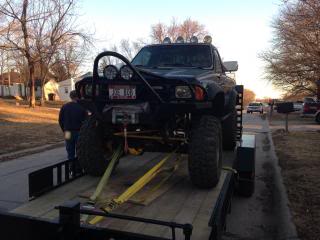

Buddy Pyrojoe stopped by so i took some pics of his truck.

By the way Joe...thanks for the flip kit u bolts!!!Hope the hydrosteer goes well for you.

That thing is sick!! I wish I could have been there to meet him and ask a million questions

Wish you were here too. Great guy with lotsa skills to pay the yota bills.
