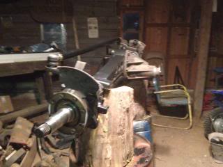

Dont laugh!!Realized i put my steering arms on vice versa just to tired to switchem back tonight...Gonna actually test my pre load and make it correct to on the trunnions. First time ive done this but its kinda fun.

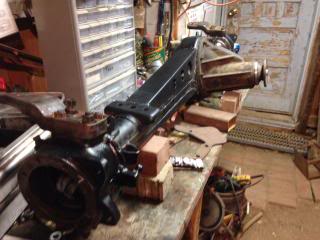

Rechecked the preload on the trunnions...15lbs.It feels good at that so im ready to put the rest back together.

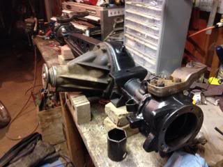

So i got the birfs packed full of grease and installed,indexed my spindle housing and gaskets,cut down my dust sheild, and installed outer seal.Im looking towards the tacoma brake upgrade kit through front range,i talked with Brian (who is a awesome guy who knows his stuff!!) and think the taco brakes being a slip on rotor would make brake work alot easier down the road.The kit sells for $99 then i just have to do some massaging on the ifs hubs to make it work.
