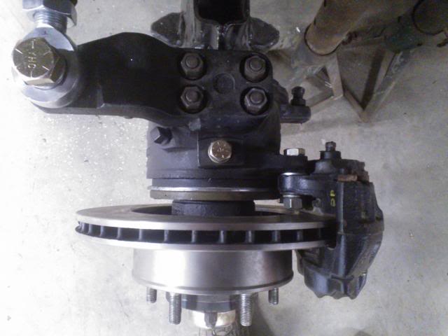

From: Northfield, Vermont
So i was looking into front ranges tacoma brake swap kit and i was really looking into getting it until it said i have to swap the knuckles from side to side cause the tacoma calipers mount on the front. I really dont wanna swap the knuckles after ive already got the axle this far,does this make sense??Anyone familiar with this kit?
I think scuba went this route. Taco calipers still mount to the rear, but you need the factory tabs out of the way. Why do you want the taco calipers? You could just run the 89-95 v6 calipers on the solid axle without buying a kit, or just a little drilling/grinding to make them work with IFS Hubs. Mounting the caliper to the other side of the factory ears does the same thing as the FORR Kit.
