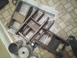

Picked up some used shackles for the rear.probably the best $20 I've spent in awhile.
Old Nov 6, 2014 | 06:45 PM
  #364
rustED's Avatar
Joined: Sep 2010
Posts: 2,716
From: Tri-Cities, Wa
Nice $core!
Old Nov 7, 2014 | 07:49 PM
  #365
Terrys87's Avatar
Posts: 11,787
Likes: 28
From: Anderson Missouri
Nice score on the shackles. I have always wondered what all was involved in doing a motor swap with a domestic motor to a Toyota tranny. The 4.3 is a great little motor and quite powerful for a 6 cylinder.
