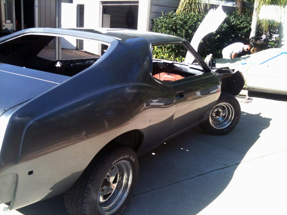

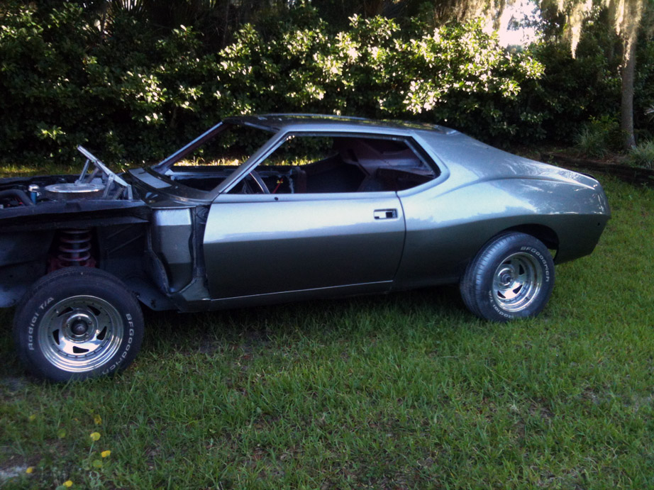

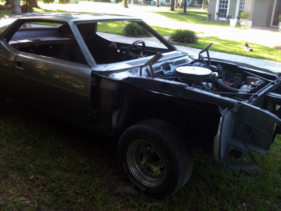

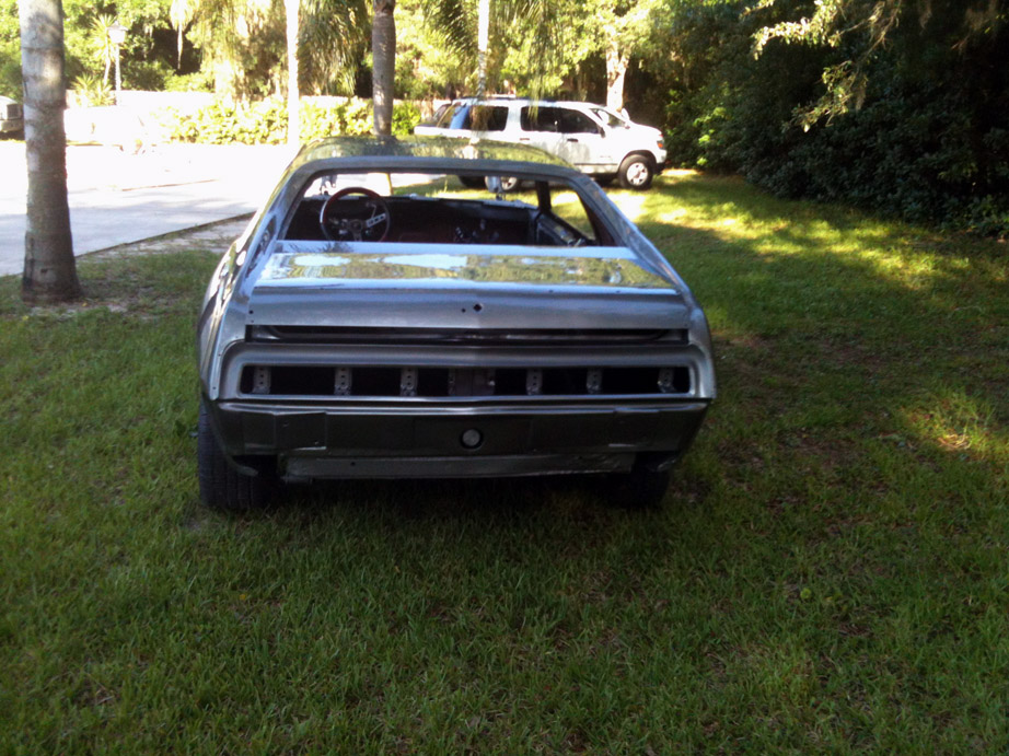

Terry as promised here are some pics of the Javelin:
The parts that were painted were stripped down to bare metal. The rusted out parts cut out and new sheet metal welded in place. the part that is tough it going to bare metal. This past week we spent getting the some of the front parts down to bare metal. Instead of sanding it down to bare metal the guy wanted to use airplane stripper. Works great, but don't do it in the sun. Dries to quick. Since the engine wasn't going to be pulled, I sanded out some of the engine bay, but the guy said he was going to sand blast it.
The paint job looks really good, he layered a pound of clear on there and then sanded 400, 1000, 1500 and last 2000 grit then buffed it. Looks really glossy and polished. very nice and hard shell paint job. if you want to see some of the body work and the sanding down to bare metal, i can get that from my buddy and post them just let me know.

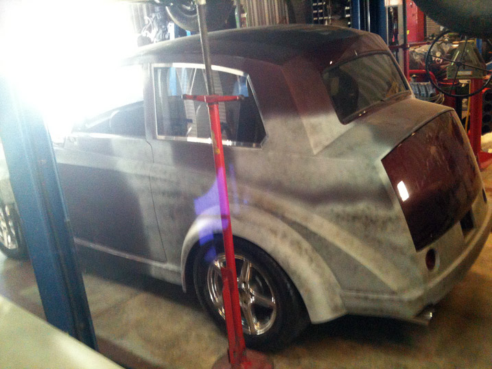

This was a Bently restored custom job... Someone has to have $ to do this I think he said it was over $$$,$$$.$$

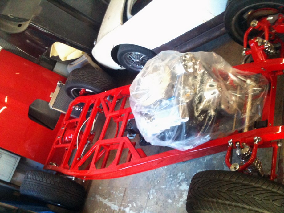

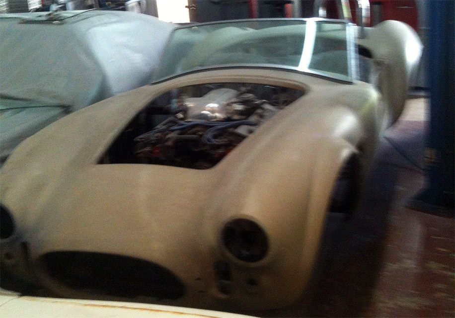

This is a corvette he is working on as well
And then there is this that he will be working on too, which is one of my favorites a 1966/67 camaro

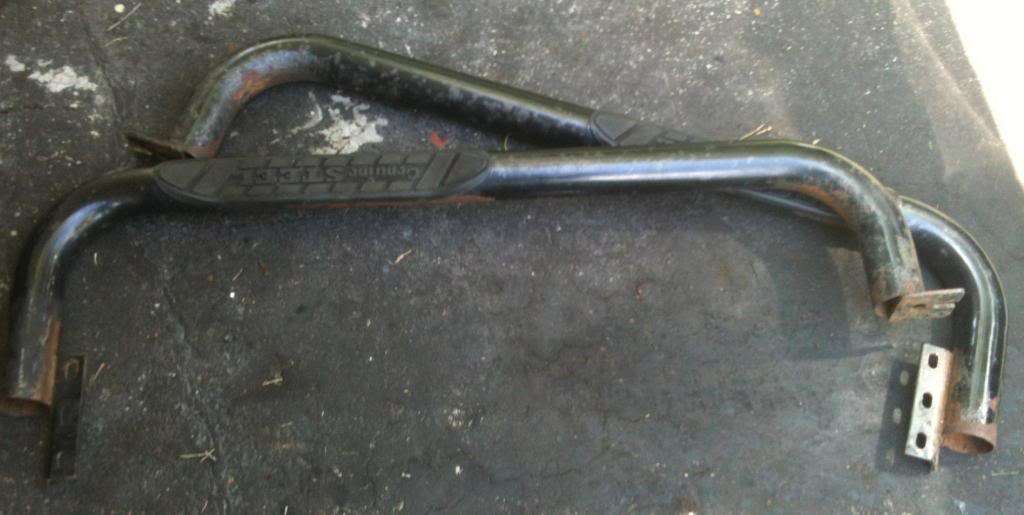

I also picked up a pair of nerf bars the ones everybody hates. I have always like steps on the truck as getting in some time wears the seats when you don't have that lift before seating. Couldn't beat the price of $15, just got to clean them up and paint them. Pics come later on them too.
Old May 23, 2014 | 06:04 AM

Here's a picture of the nerf bars I picked up this past week.

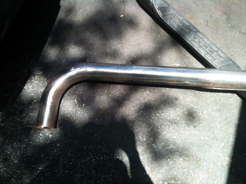

I thought it was kind of rusty in spots, but I was considerably wrong. It seems that the manufacture may have painted the bar when it was partially rusted and didn't prime it. The paint was peeling off, I started out wire wheeling it with my drill and that would take a heck of a lot time to get through an inch. I ended up grinding it, but will end up air sanding it down. When you strip the paint down, you can see rust under there in places that don't even look to have rust because it hasn't blistered yet.
Here's a pic of what I ground down.

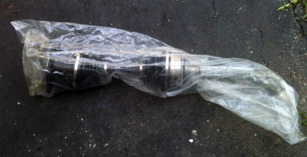

Here's the CV joint I picked up still in the package, the guy said the box got water damaged. could refuse to get it since it was only $30 sealed in the plastic.
