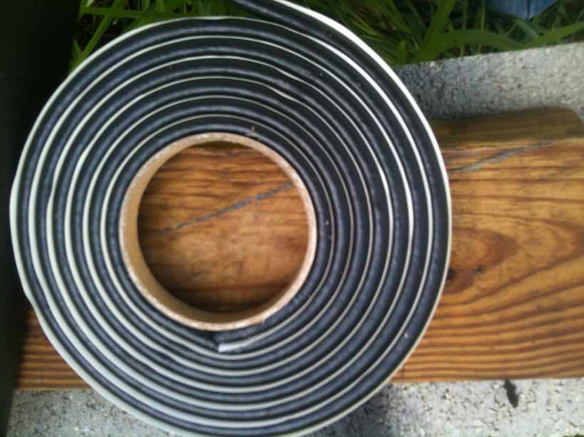

Finally got around to putting that butyl foam ribbon on the rear glass of the topper. I got couple of pics, not much I'll post them later. It seems that all I needed for the rear glasses was one roll of butyl foam ribbon. From that roll I have about 2 feet left over. That means I over estimated what I needed. I purchased a case which was cheaper than buying just one roll.

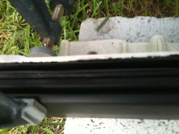

I thought I snapped a few pictures of the butyl tape around the open after I place it on there, but can’t seem to find any of those pictures. What I did learn since is that once the tape is around the opening it would be best to take a spatula and flatten it down a little before you put the window frame up. This helps prevent what I did wrong doing it hastily. Plus stretching it as you put it on helps as well, at least with the butyl tape I’m using, the stuff is great and it won’t hurt to stretch it a little as it is very sticky. I really like this stuck and can see why they used it. It is however a pain to remove/clean up without the right type of cleaner.
Since I didn’t flatten or stretch the butyl tape prior to putting up the frame (this is where it all went bad) I had to use some clamps to tighten it up. Works great, but if you not patient and in a rush you can make the same mistake I did which I will be paying for in the long run. Since I didn’t flatten the butyl tape prior to putting the frame on I should have put the clamps on and tighten them little by little as the tape soften and flatten out with the pressure and heat of the day. I just put the clamps on and cranked away big mistake very big in my opinion. I should have tighten a little waited and come back and tighten a little more as I did on the second window.
And here's what ends up happening when up just crank it up.
I showed it to someone and they said just bondo it up as it is just like a dent on the body. I’d rather later on just take them off and repair them the proper way, but that’s not happen for a while.
Now I have a little experience and learned a lot with this topper, that I can move forward and do a little better with the next one.

Thanks Gizler, I wish I could get more done. I'm having issues with that butyl tape the one that helped me crease the L-trim, it doesn't seem to be sticking like it should. I've contacted the company who sold it to me which I'm thinking is a shell company for the manufacture. The Butyl tape i used is also used for the rear glass on the tundra. The company replied back almost instantly and i sent them the information they requested and I'm just waiting for a reply.

You got a lot of work done on those windows. Sorry about what happened with the clamps. I understand your frustration, and also your desire to fix it right.
I always get in a hurry when I do things, and in the end , I typically end up re doing them again later.
