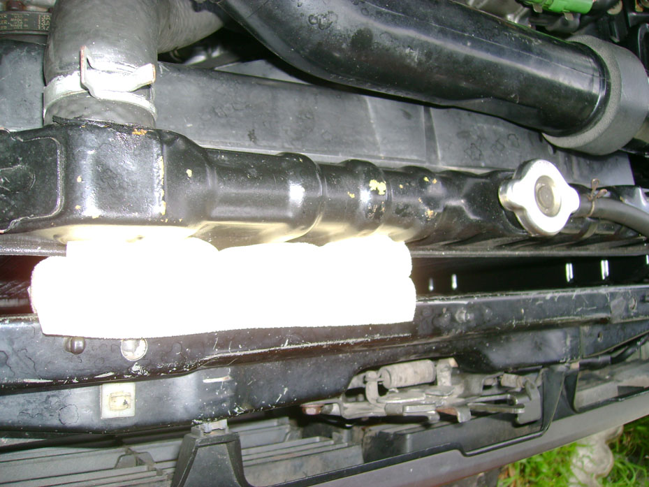

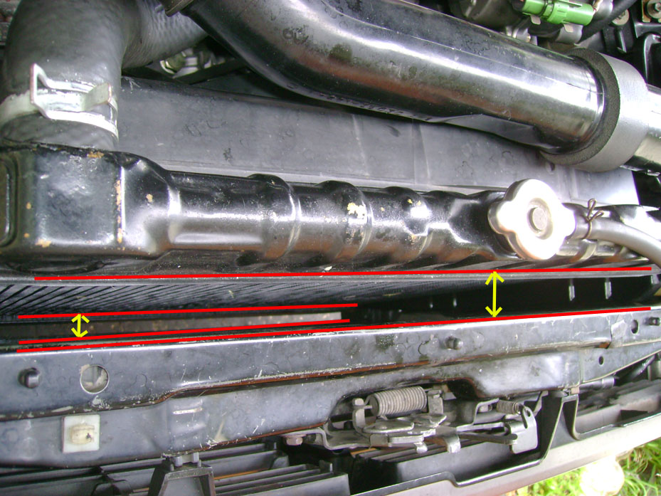

I just had time to get a shot of the gap between the radiator and the condenser.
You can see the gap with the lines I drew and the yellow arrows showing the openings. If left open the draw of air will seep through there and less through the condenser coil.
I found a small piece of foam to give you guys an idea of what I'm talking about.
Actually here's what I'm looking to get from the hardware store which is what i recall being similar to what came with my 86 4Runner when i drove it off the dealer lot in 1986.
Should somehow setup with this stuff on the top and the bottom to keep the flow going through the condenser.

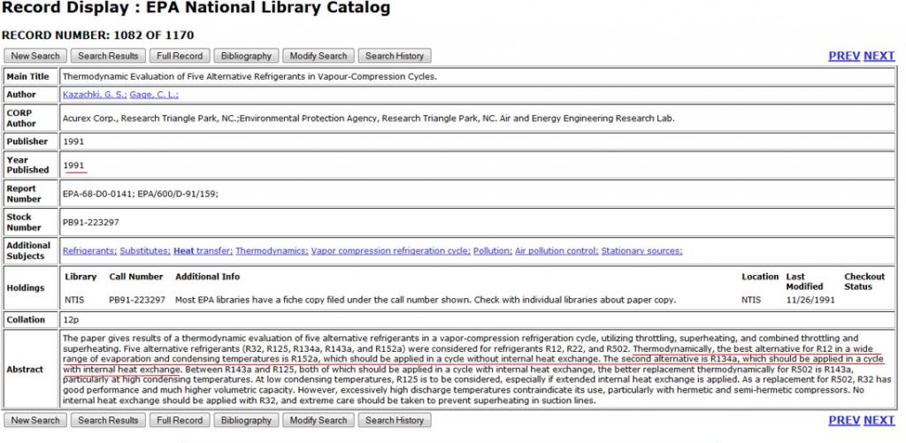

By the way here's a clip from an EPA report done back in the 90's on refrigerant. I underlined the part I was interested in. Check it out:
I did however find out that my expansion valve on my AC wasn't up to par judging by the erratic reading I was getting from the low side. I wasn't getting a reading from the high side so when I changed the valve I changed the schrader core. Once I did all that I got better reading and readings from the high side. I charged up the AC with the R-152a with pressures at 25psi on the low and 180psi. That used about 9oz of refrigerant which is less that calculated 11 to 12oz. Its cooling about 44-47 degrees at the vent. Pressures are low so if need be I can add just a hair more. I like the way it's working now, but I notice the other day it takes about 5 to 10 minutes for the truck to cool down. Still leaking air under the dash.
