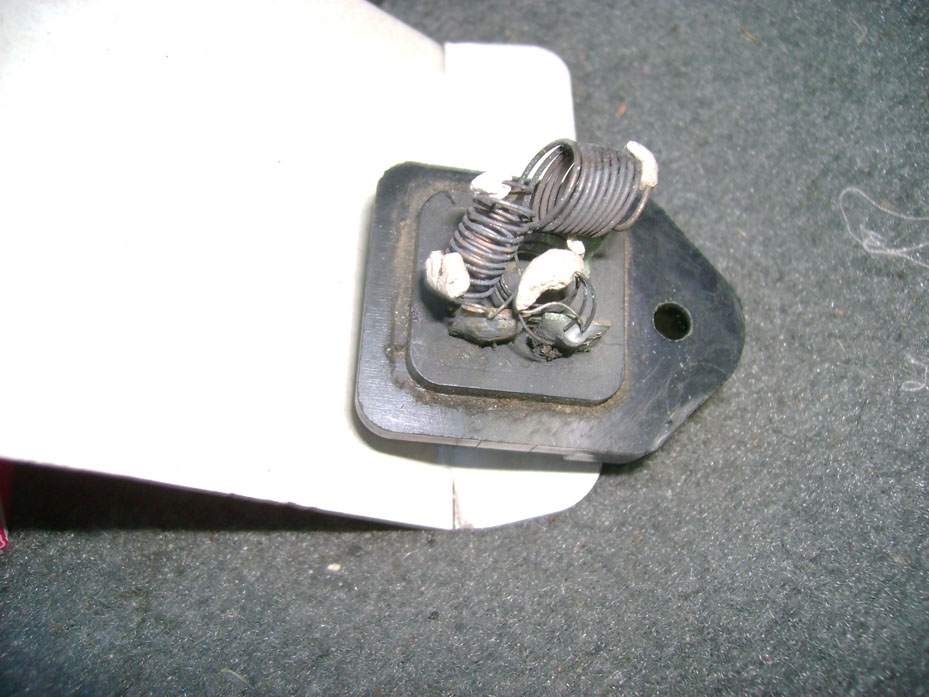

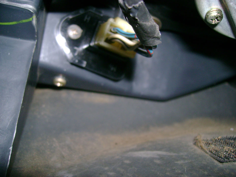

I know some of you here are interest in what i am charging my AC with which I have said numerous times i was going to use R152a. I received my can tap a lot earlier than what was said to be the ETA by USPS.com so I am very happy with that.
Today i had sometime to start working on the A/C. First thing I worked on was the Blower Resistor.
You have to be a contortionist to reach under these dashes to actually work down there. Here's a shot of what came out.
The old resistor:
Here's a picture of what was going in the new:
When installing the resistor you want to keep your fingers off the filament wire. I found out many years ago that the oil from your fingers or anything can cause these things to heat up more and shorten its life spans. Most older projectors were like that with those old bulbs and even those halogen bulbs you want to keep your fingers off or any greasy stuff from touching it.
Installed and ready for action:
The old resistor:

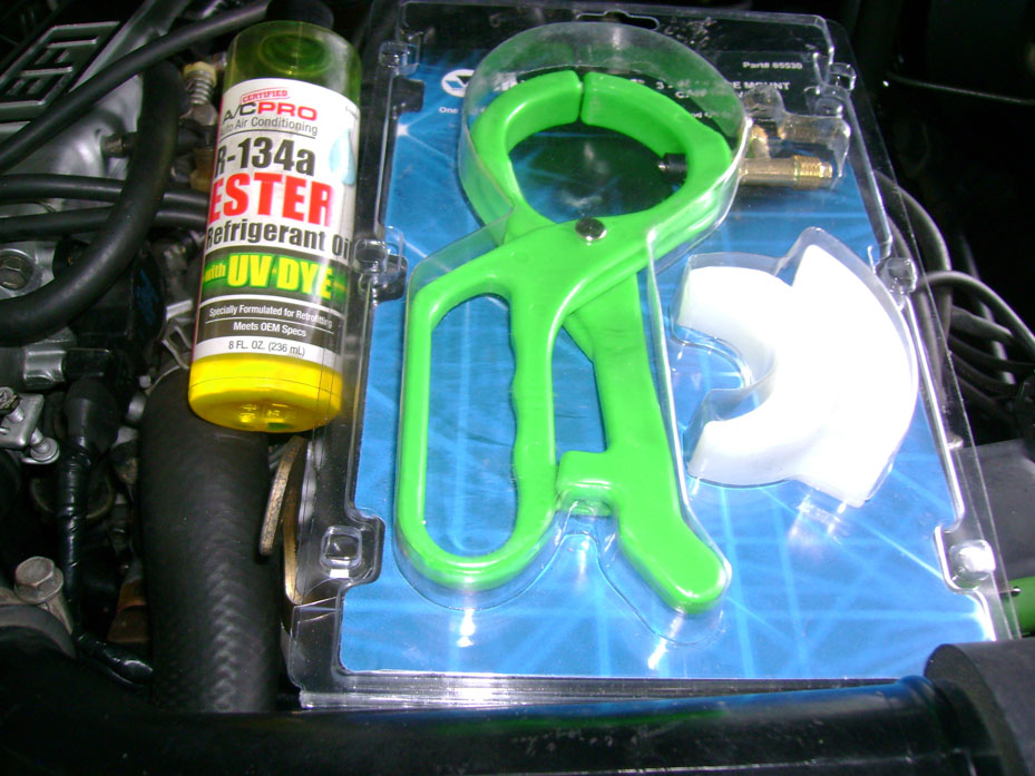

I got the Ester oil and the can tap here to show you exactly what i am using:
Took the compressor out and glad to hear the vacuum still in there after more than 5 days after I vacuumed it out. Took off the compressor because I needed to add the Ester Oil and purchased the bottle instead of the compressed can of oil. I figured I would do it this way as it better to pre-lubricate prior to starting up the compressor and a better to keep vacuum for the refrigerant rather than the oil. Once I filled the compressor up with about 3 to 4 oz of oil I mounted the compressor back up re-sealed the hoses and vacuumed again. Once I was set with the vacuum I setup a can of the DustOff (my R152a) with the can tap.
You want to slowly release it, i know some people are anxious to fill there AC's, but it works better this way. I started charging the AC with car off allowing only the vacuum to suck out the R152a from the can. Once that stopped I started the truck and turned on the AC full blast and rev the truck to about 2000 + RPM, this drew more of the refrigerant from the can. Once it was empty, I closed the gauges and took off the empty can and attached another duster can. I figured I lost a bit with the R152a being in the lines when I removed or replaced the can. Took another 2/3 or more of the second can and the compressor clutch was running. Went inside the truck and found it started cooling, but not as cool as I wanted it to be.
Once it was charged, I got in the truck and drove it around the block a few times and it did get cold a very comfortable cool. I drove over to my neighbors house to show him and he hopped into the truck and said it was cooling very good. He had handy his temperature gun so we start shooting the vents to see how cool it was getting.

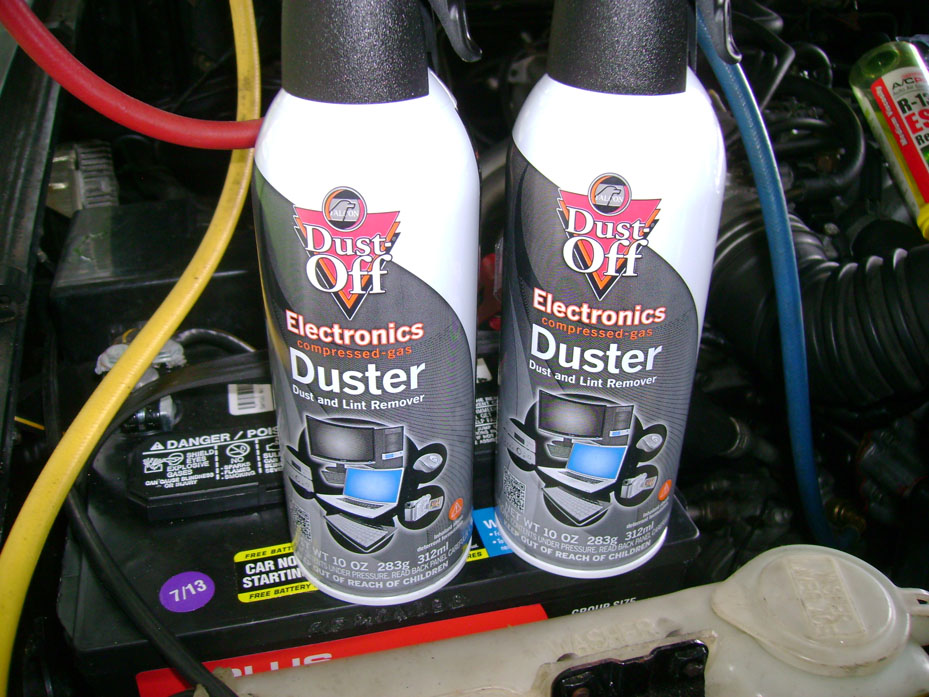

I forgot to mention the two cans of DustOff I purchased as a pair for a sub-total of $7.97. That's roughly $4.00 a 10oz can. Today a can of R134 will cost you about the cheapest I see is $14.99 for one 12oz can and you have to buy 2 of them that's roughly $30 for the 2. I wasn't sure of how much I needed so I decided to pickup (2) 2packs Dustoff for a total of $16.90. Heck of deal that is. If this really works out I'm thinking of getting this stuff by the bulk just to have around before they start taxing it like they are planing increase taxing R134 even as high price as it is now.
