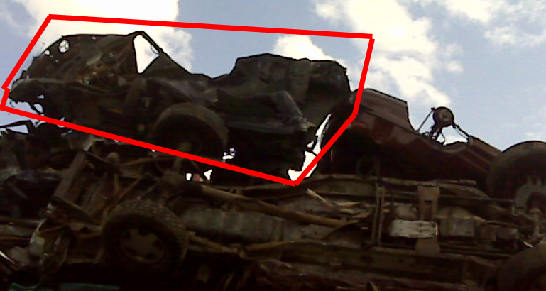

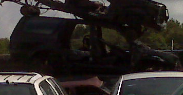

Was looking at the 90's 4runner to see if I could get some Male/Female adaptors for my truck as the one for the AC under the glove box was fried. When I looked inside the harness and everything was gone. I did notice a map light and was going to get that. I went over to the office to get some screw drivers and that was for about 15 minutes or so. When I got back the truck was gone.
Here's where it ended up.
It's like Fast and the Furious. They work FAST and crush like FURIOUS.
I thought I would ask them to bring it down, but it was crushed so bad and it was about 35 feet on top of the pile. Oh well, maybe next time.

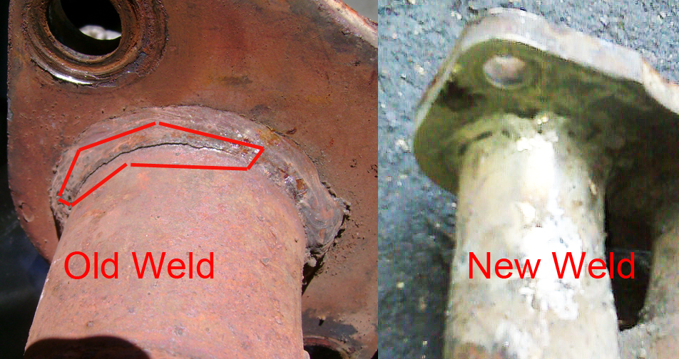

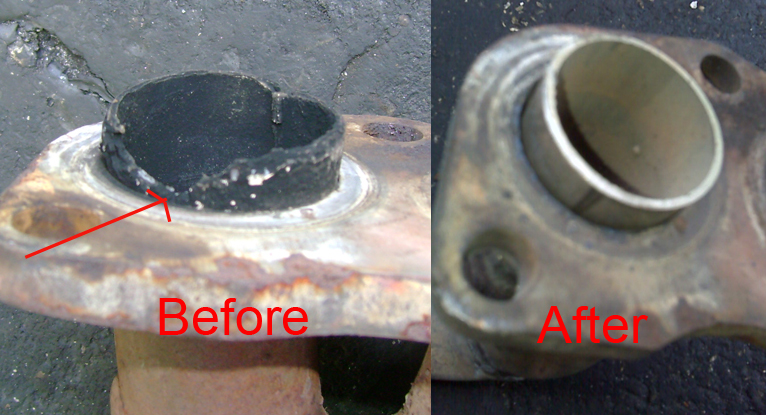

Got a little bit done on the Y-Pipe. My neighbor was going to roll a stainless steel sheet to make the 1 1/2" tubing, but found out it wasn't as easy to make it. Since I was out of town, he bought it at a stainless pipe company.
That's a 1 1/2" Stainless steel pipe replaced.

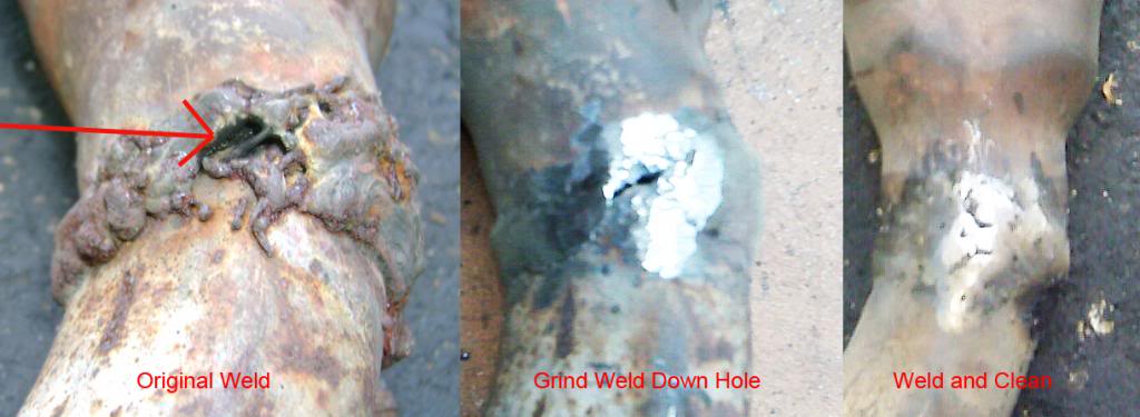

Here is what looks like welded up.
The weld that was there had leaks coming from it. Ground down the weld so we could see the area better and the leaks Here's a hole that it was leaking from. Closed up the hole and should be good at this point.
I will be bolting it up later today. Next week I think I'm going to pick up one of those after market mufflers, There is a rust hole in the one on the truck now, so that would be my next hump I have to cross next week.

Worked on the Y-pipe, leaked like a dragon... Huffing and puffing. Went down to autozone and picked up some new donuts/gasket, when I took down the Y-pipe I figured that the pipe coming through the flange on the manifold side maybe a little to long and maybe preventing me from sandwiching the gaskets properly. I cut back a little on the pipe put the new donuts on and bolted all up. Fired it and the dragon was slain.

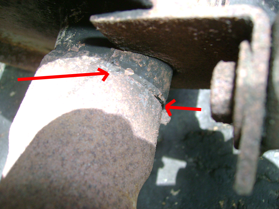

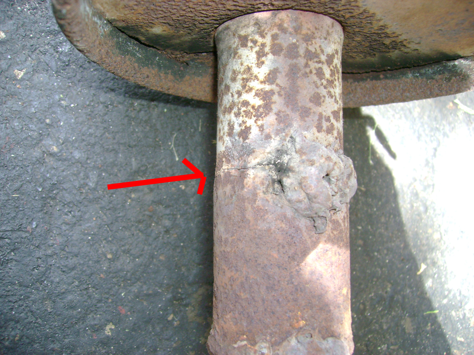

Been busy with other things here and there, so i haven't done much lately. I did finally drop the muffler and will replace it with an after market. The one on there now is a after market. Who ever welded it up di a terrible job welding it.
Here's a pic of the inlet side of the muffler:
It sort of looks like the pipe cracked and they welded part of the crack but didn't get all of it so it's actually leaking from that crack.
Here's another pic of the muffler exit:
Kind of makes you wonder if there is anybody out there getting paid and finishing the job. This exhaust system had leaks everywhere.
We plan on cutting out the old muffler and welding in a new muffler and I plan on make hangers that are like the OEM to hook as original.

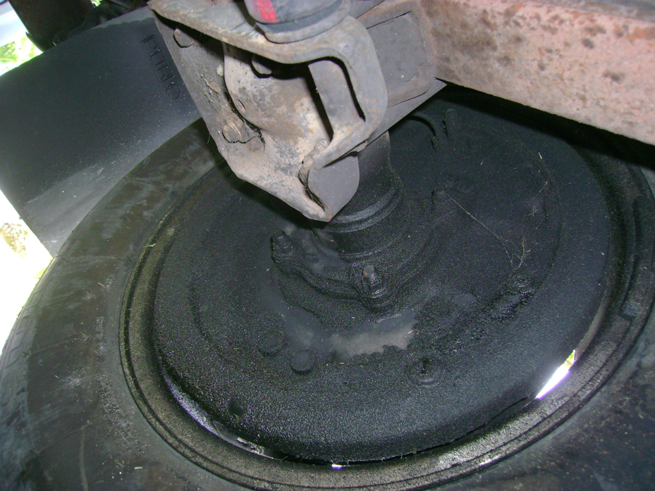

While I was under there working on removing the muffler I notice this:
Looks like we have a axle seal leak. I guess I have to get in there and replace both inner and outer seals.
