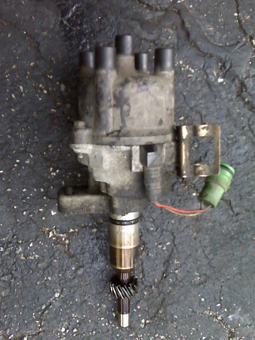

Hey all been trying to get this truck up and running. I thinking I may have to pull the engine out again and pull a few parts to get a better look at things. I'm going to do that yet with out looking through everything that is accessible to me at this point.
So far what I have done is work from right to left on the engine. I check all the spark plugs and cables and they look and read pretty good and check out good. I changed out the ignition coil with the coil from my 86 4Runner (no Luck). Sorry no picture of the 86 4Runner ignition Coil.
Here's a picture of the distributor from my 86 4Runner.
Reset the distributor several times (No Luck). Then took the distributor from the 86 4Runner (No Luck). Opened up the Valve cover to check the timing chain making sure it is timed correctly looks good TDC and check the basic gap settings and they look OK.

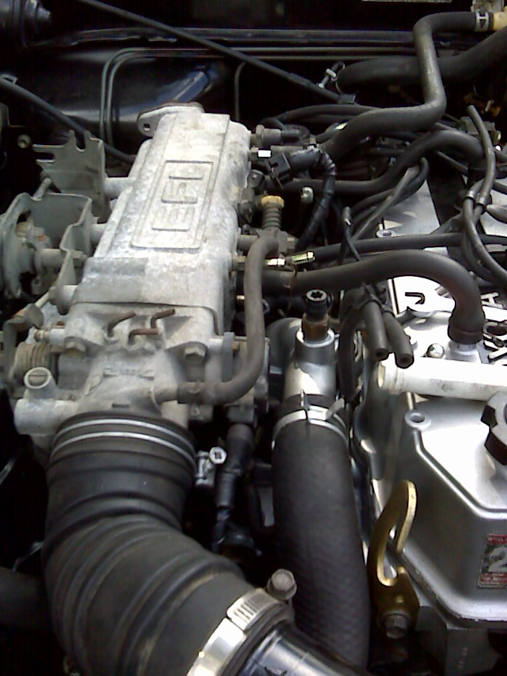

Moving over to the left of the engine, I decided to pull the the throttle and throttle body from the 86 4Runner and put on here just in case something was wrong after cleaning up this one. Still the same effect no thing. (Just a note on the 86 4Runner, after sitting for more than 10 years, the fuel has turned now to what smells like turpentine and it seems that some parts have rusted or corroded from the fuel sucking in moisture, meaning water in the line. I should have drained the gas from the tank just because of this it just means more work in retiring later.) Here's a picture of it installed on the 87:
Checked and changed out the fuel filter and still the same. Can't see the filter, but it's there in this picture:

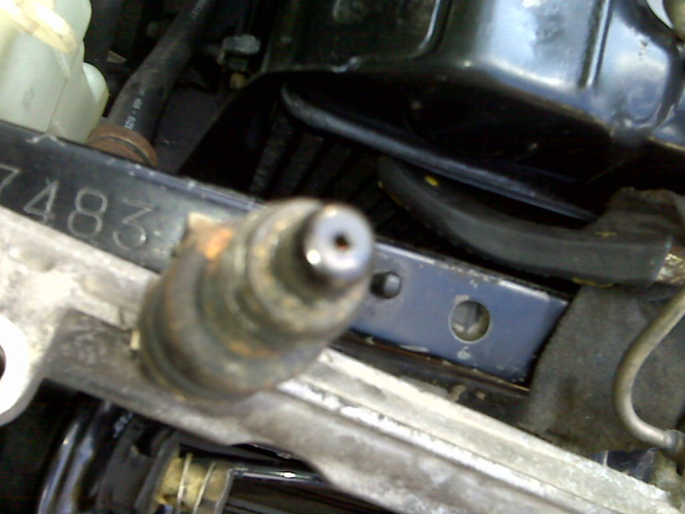

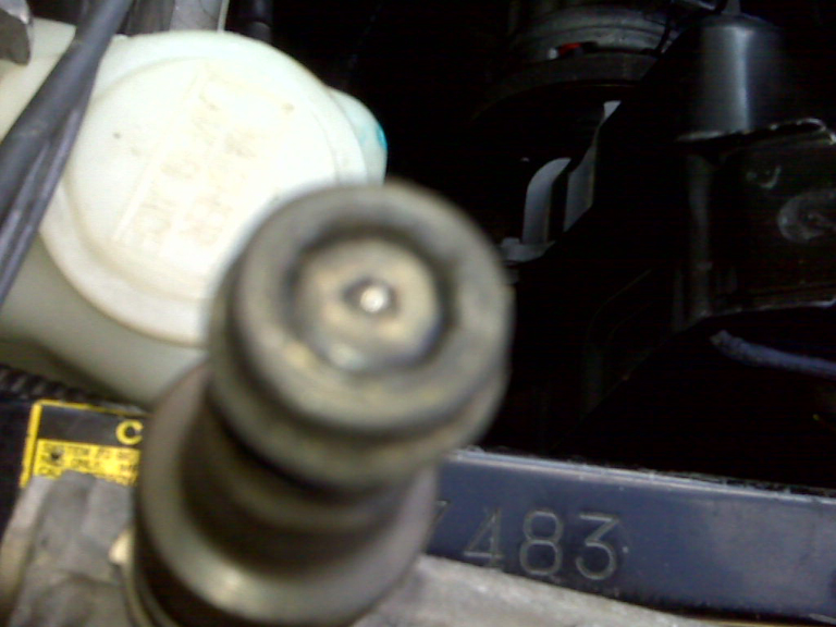

Swapped out some of the fuel injectors from the 86, but one of them I couldn't and it is noticeable. There is a pin needle like point on the inside of the injectors that is visible, but on one of them from the 86 you can't see it. I'm assuming it is bad.
Here's a picture of it.
One from the 87 as you can see looking straight down the center there is a point. (Note the ones that came off the 86 where much finer than the ones from the 87) Sorry for the blurry picture:
And here's one that looks bad to me:

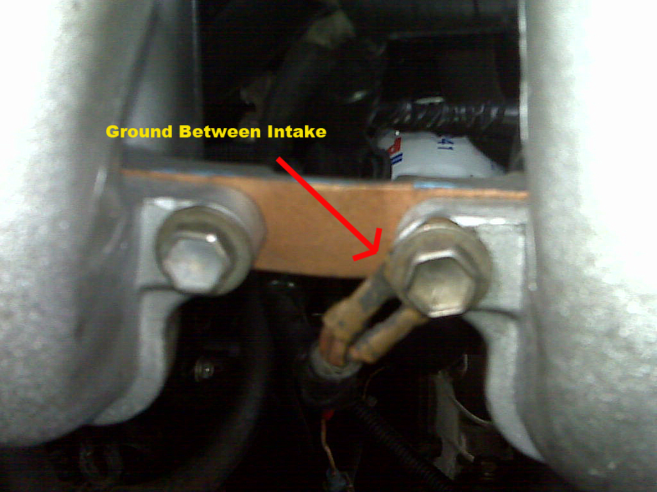

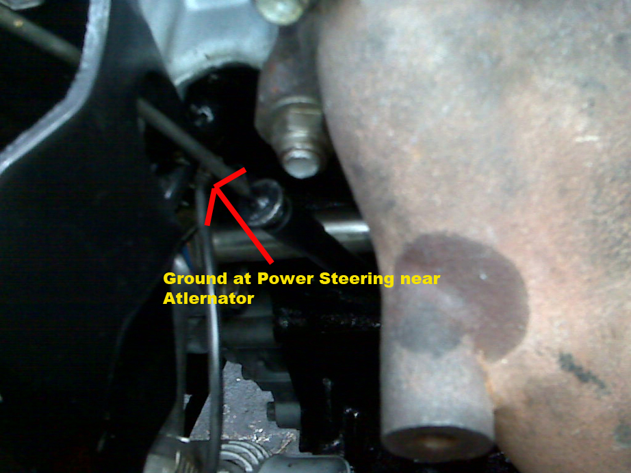

Hey All been playing around with the truck and no luck getting it started. Just to recheck myself I went over a few things again.
10 Ground:
Firewall to Head Check
Ground at Intake, Check

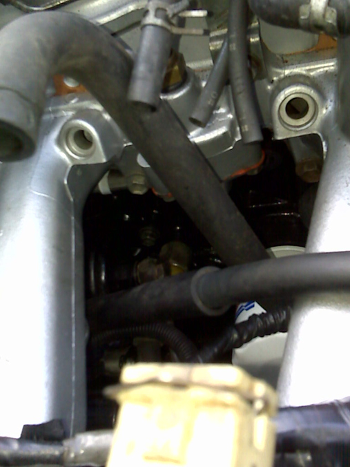

Ground just below Power steering and Alternator, check

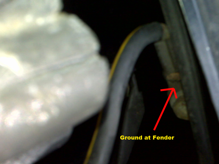

Ground at Fender just to the left of Battery

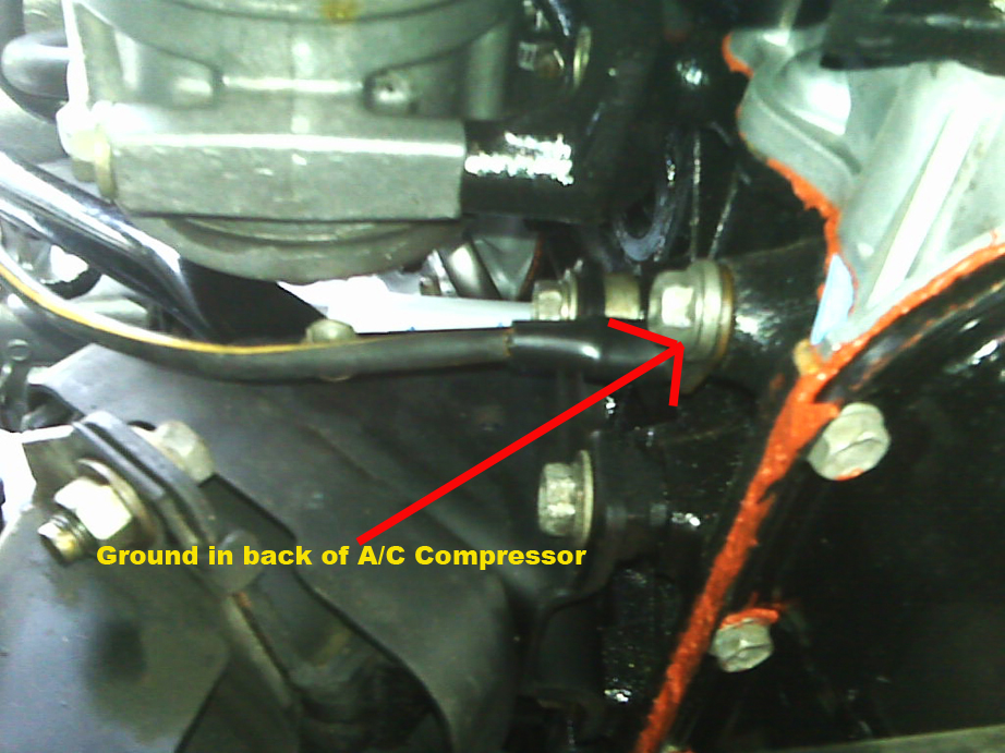

Ground just behind AC Compressor, Check

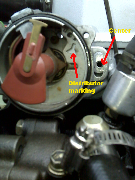

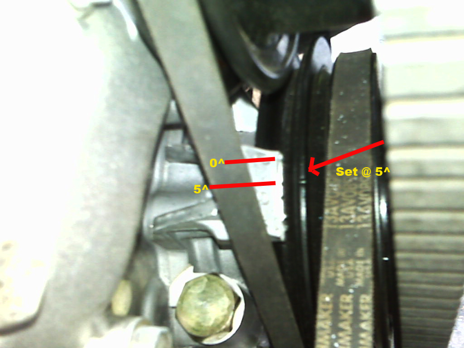

Next up was the Distributor:
Set the timing at 5 degrees.

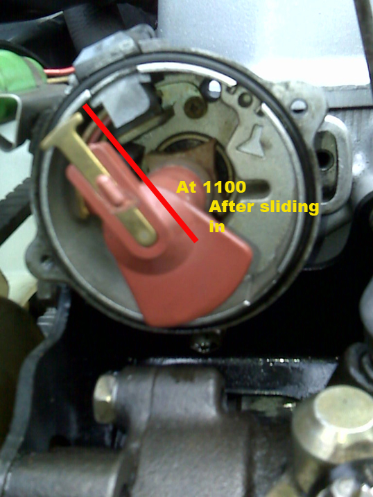

Before inserting the dizzy the rotor is lined up with the stamped image of the rotor and the set bolt nut hole is centered.
This is after inserting it it's pretty much at 1100.

Been Kicking my brain on this one.
Checked everything that I could think of. Looking at the chain I've notice the links are no longer set the way I had originally put it in. I suspecting the chain jumped or I must have moved it when I was putting things together. I have looked over everything, so I am suspecting this. here's everything I have checked so far.
1) Checked Grounding
2) Checked and re-checked Distributor (Checked with 86 4Runner Part)
3) Check for Spark
4) Checked Compression
5) Check for TDC making sure it's not off 180^
6) checked AFM (tested resistance) and checked with ignition on and flapper to see if fuel pump turns on.
7) Checked IAC (Checked with 86 4Runner Part)
8) Check fuel pressure
9) Check ignition coil (Checked with 86 4Runner Part)
10) Checked Solenoid resistor (Checked with 86 4Runner Part)
11) Checked Fuel Pump
12) Checked EFI Replay (Checked with 86 4Runner Part)
13) Checked Fuses
14) And I thought this would be important check for Fuel in Tank
15) Check Fuel Regulator (Checked with 86 4Runner Part)
16) Check EGR to Fuel Regulator
17) Check TPS
18) Check Injectors (swapped 3 from 86 4Runner)
19) Check Electrical to Injectors
20) Check ECU (Checked with 86 4Runner Part)
21) Checked all Vacuum hoses for leaks
All these things checked out pretty much to the best that i can check them (maybe better ways to check them out), but I'm thinking the Timing Chain maybe off. The only way to check that out is by removing the timing chain cover. I'd hate to take that head off, I will try the way some people have done so by taking only the timing cover off. Seeing as i put Copper seal spray on the head gasket it may be highly unlikely that it will come off with any success. I am ordering a head gasket to prepare for the worst. It doesn't matter if I don't use the HG as I will need it anyhow for the more I pulled out of this truck that will be rebuilt for the 86 4Runner.
Let's hope I am wrong, but today that will be what I am looking at the Timing chain.

Hey junk, why can't you just pull the valve cover and look at the dimple on the cam timing gear? It should be right about 12 o'clock with the crank at TDC, right? If that is correct, then you did not jump a tooth. So you can put the crank at TDC, check the dimple, then look at the rotor, if all of those are where they are supposed to be, then your chain is fine. I'm pretty sure that those bright links on the chain line up only when you first install, and then after that it would take you many revolutions of the engine to get those bright links right back where they go. Remind us again, does the engine fire at all ?
Old Apr 9, 2013 | 09:40 AM
  #140
junk4u's Avatar
Joined: May 2012
Posts: 835
From: South Florida
Hey Cory, hope you don't mind me shortening your handle. I've had some time free today so I was out pulling parts. Took off the Belts and pulley, PS pump, AC compressor, radiator, etc... Getting ready to try and pull the timing cover off. Got it all out of the way and set the timing at TDC pulled the Dizzy and then opened the valve cover. The Bright mark on the links was top center but don't know about the crank sprocket, but most likely it should be. Decided to check out the rotation to get the link back at TDC and it takes 4 full rotations on the cam sprocket which means 8 on the crank. When the bright link is at TDC and you rotated again the link is around 900 hours, rotated it again and the bright link can not be seen rotated again the link is at 1500 hours and the on the 4th rotation its back at 1200 hours. As far as i knew, it would take exactly 4 rotations to get the bright link back at the top.
So, I'm putting back every thing now that it doesn't look like it would be the timing chain, plus my neighbor the airplane mech came by and I showed him the way it set and he said it's perfect.
I'm going to run and get some starter fuel and spray it in the throttle body to see if it stays running longer. After that I'm going to try and spray in the engine bay around the vacuum lines to see if the engine cranks and stays running while I'm spraying. If that works then I'm going to have to assume that the injectors are faulty (even though they are from the 86) or there is a problem with the electric to injector signal(Need to recheck that). Other wise everything looks good (doesn't mean it is good)
sure am glad I really don't have to tear down that motor to at the chain again.
Oh and yes she cranks and runs for a few seconds, but dies right after. My neighbor said it cranks real nice for the seconds that it runs.
By the way haven't heard from that guy with the 4Runner for sale, he might of sold it.
