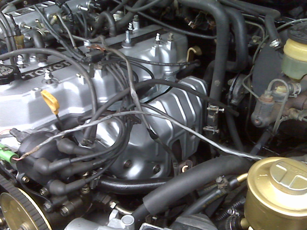

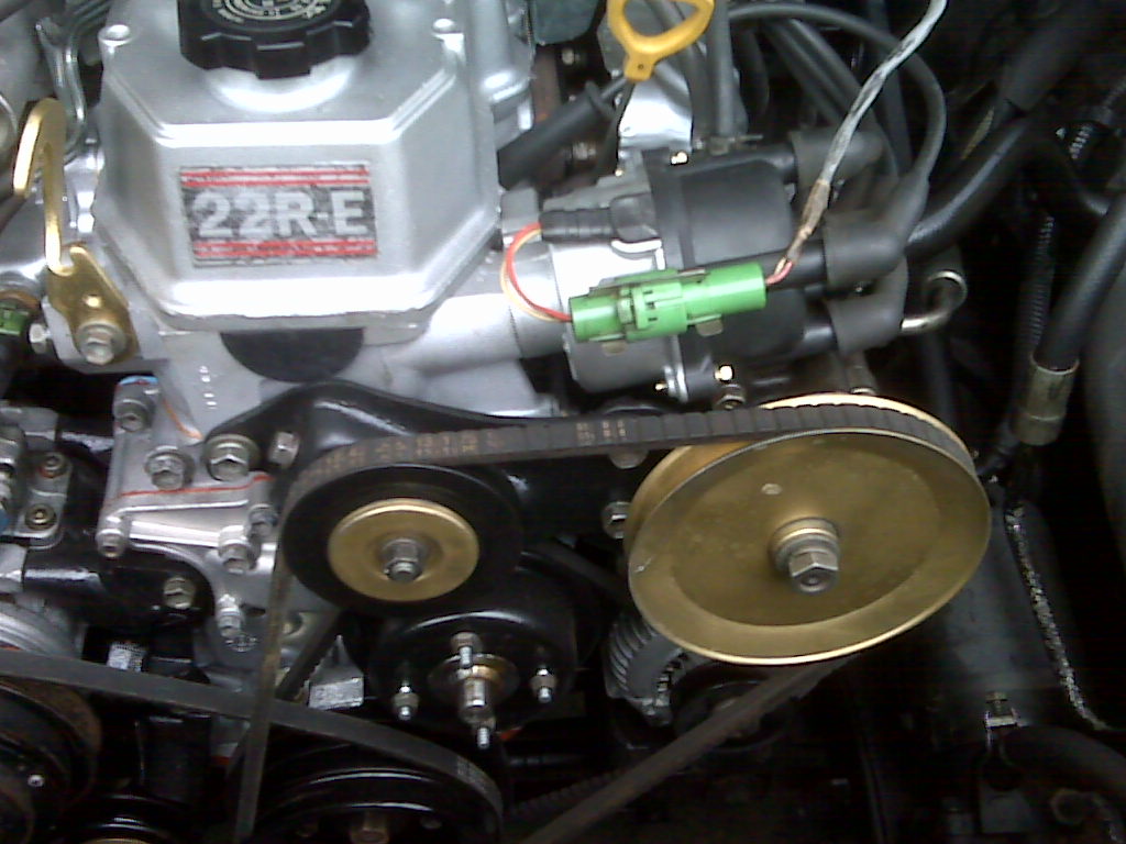

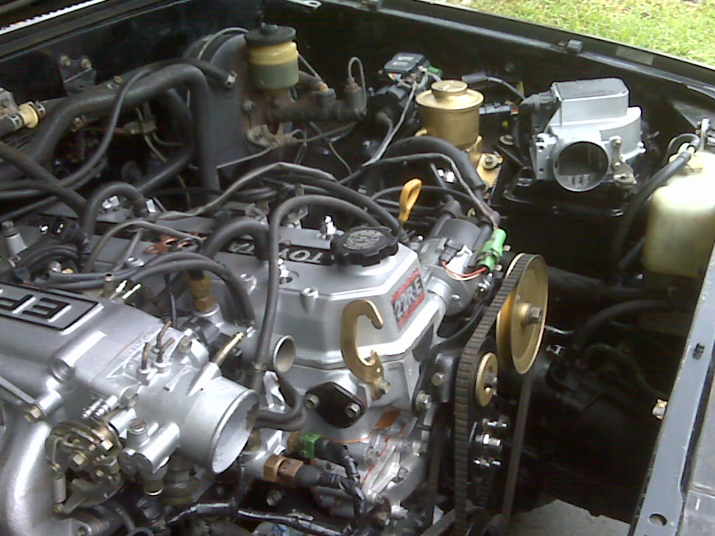

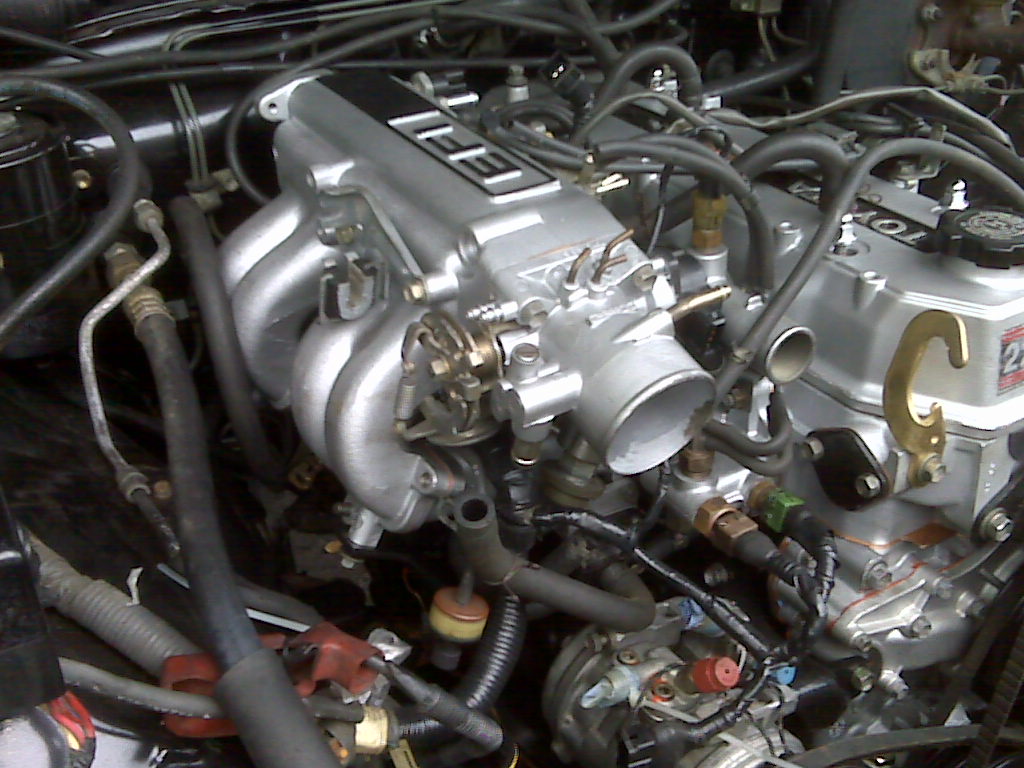

Clipped a few photos of where I am at now on the engine here are a few, so for the quality, I forgot to clean the lens on my phone as I keep putting it in my pocket and the lens keeps getting dirty, but you'll get the gists of it.

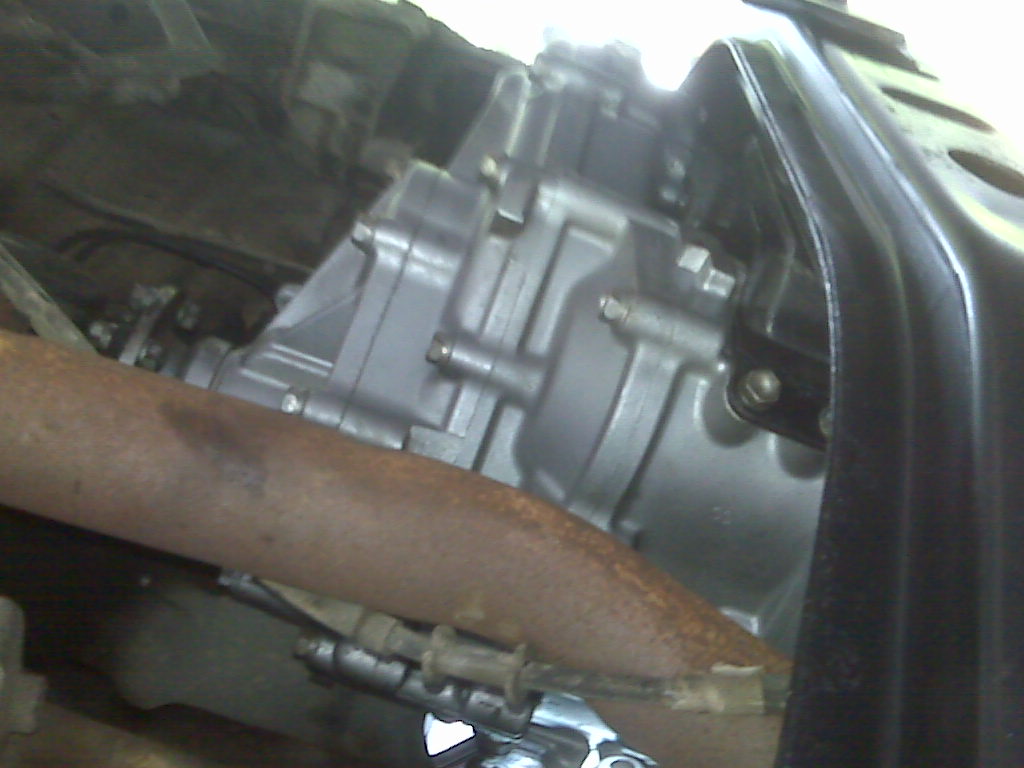

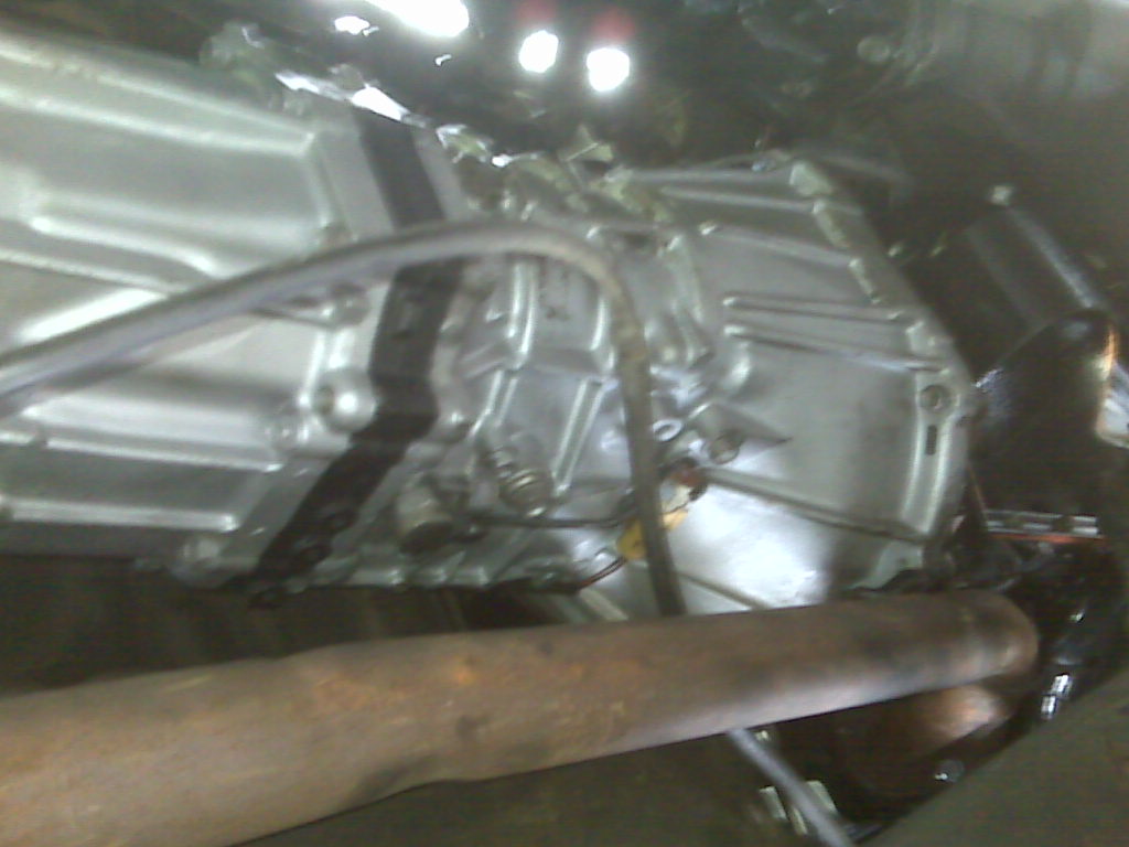

Picture of the Tranny installed
Sorry, i forgot to flip the photos they are of the me looking up from the side of the truck.

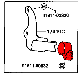

Okay, anyone have an idea if it would be a good idea to put a 1 3/4" adjustable pipe clamp on the exhaust pipe to tranny mount? It was taken off be one of the prior owner or mechanics and never replaced. Of course i would consider this to keep it from rattling and it would be stainless steel to help keep it from rusting.
Here's a image of the part in red that I'm talking about.

Let me know if anyone has any better ideas, as you can see the number shown is actually for the bolt and I can't locate a sku, besides I can see from my 86 they rust out pretty good so I'd prefer stainless any how.

Man that engine and transmission looks good! As for the hose clamp on the exhaust to tranny bracket, I think that would be fine.
Thanks Coryc85, looking to crank it up this week, but need a few things.

Engine and tranny look great. I like Castrol Oil and use the Synthetic blend. I go with what Toyota recommends. Some of these trucks have never seen a gear oil change and are still going strong some 20 some years later. Toyota did their home work on that. Hope it fires up for you and all goes well.
I think the clamp will work for you.
