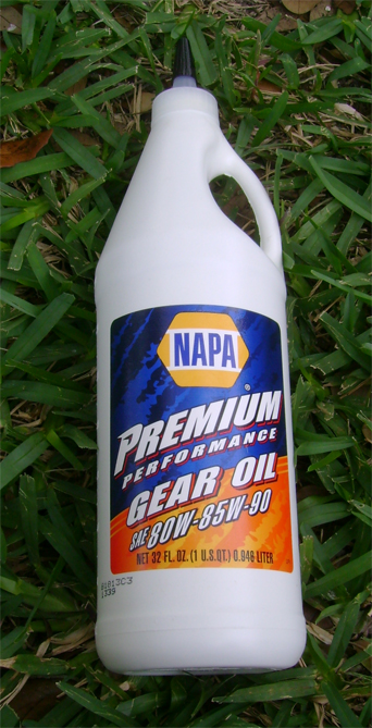

Hey thanks for the reply Jerry507, I check out that store as well that is listed as a dealer. Their website is down, but that is close to where I live and next to the toyota dealer and Napa as well. I ended up purchasing the gear oil at Napa for now as I don't know how the tranny is yet since it was purchased used and seems to be fine. The only issue I have is that the bottle states that it is compatible with GL-3, GL-4 and GL-5. As soon as I can get it all up and running and everything seems to be working out I'll check that store out. Napa Gear Oil was $5 and change a Qt. and its made by valvoline oil. I want this tranny to last for a while. As for the Transfer case Thanks for that info.
Originally Posted by cman1
Oriellys carrys GL-4.
Thanks cman1 for that info, but the closes Orielly store in in Kissimee, FL which is about 230 miles away from me. Sure wish they would open a store south of the border which for them right now is Kissimee, Fl.
