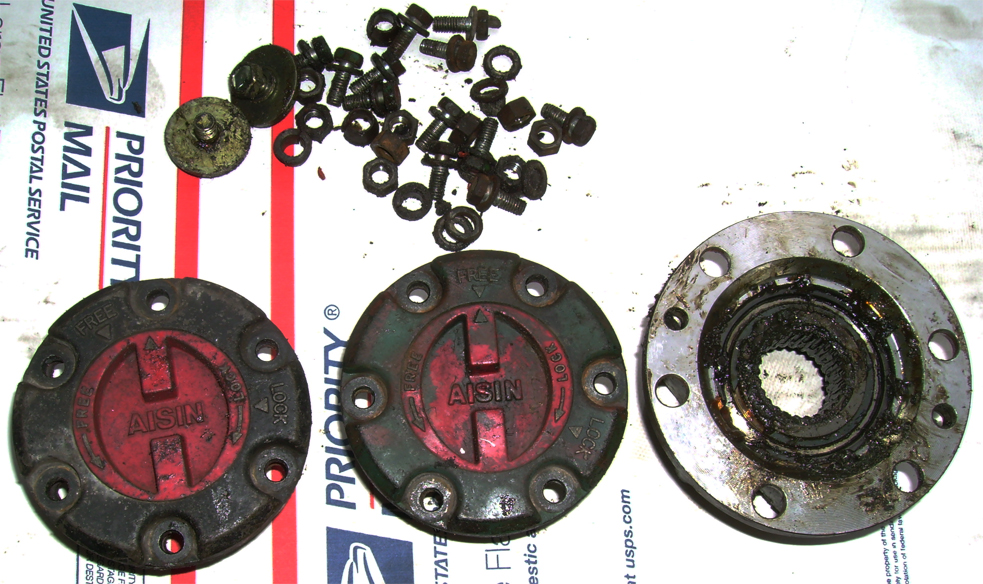

Been tinkering with the truck trying to fine tune a few things. I'm going to post a few items in a bit of stuff I'm going to start working on little by little sort of a check list.
But right now I started cleaning up these that I got back near the forth I reported, I'm just getting around to cleaning them up.
Eventually I would like to do away with the auto hubs and put these on, but without the other housing, I'm just going to have to wait till I find one.

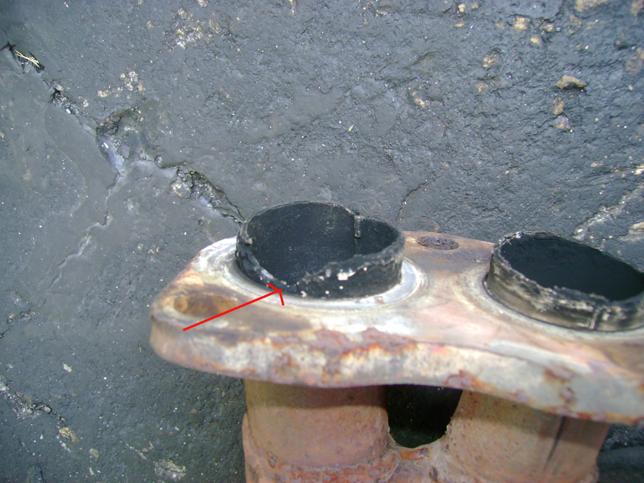

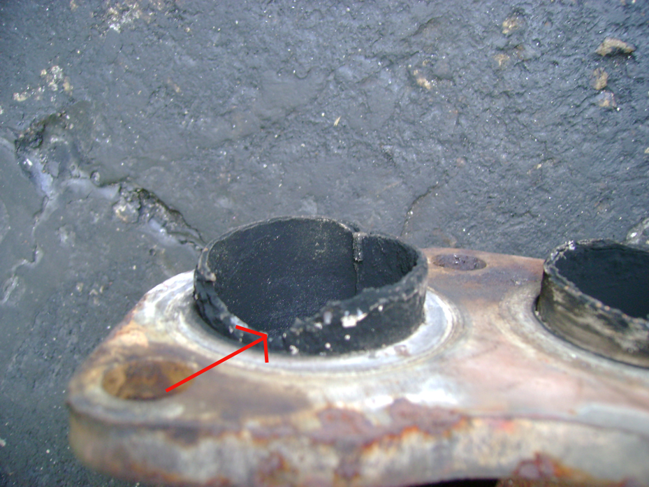

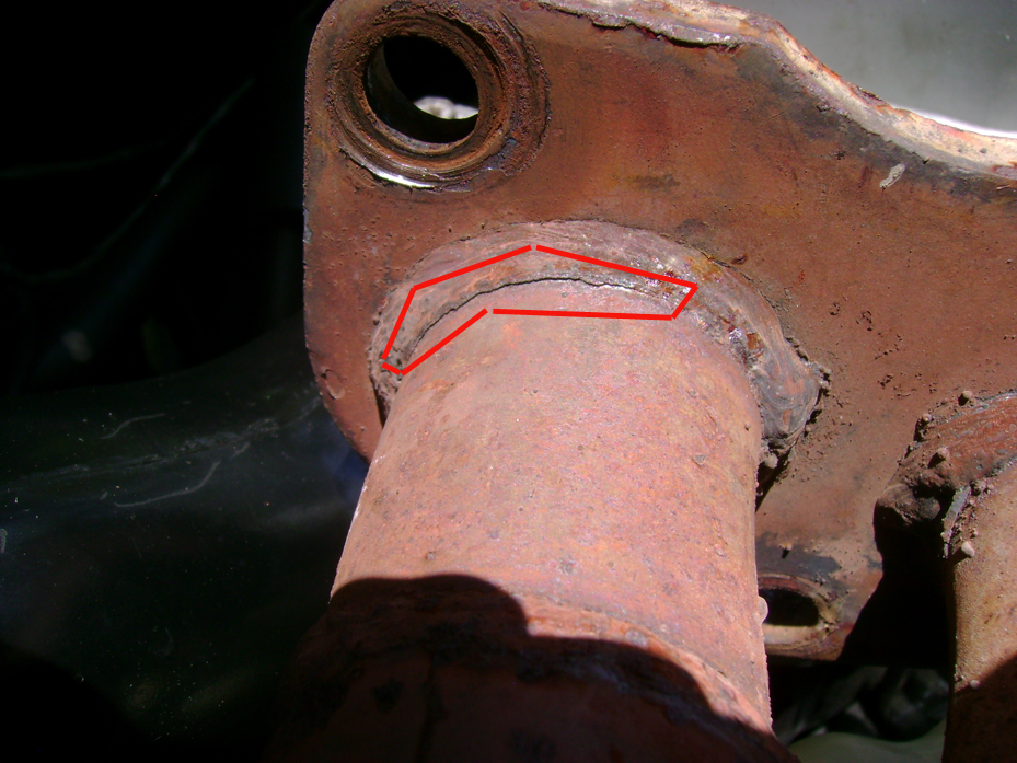

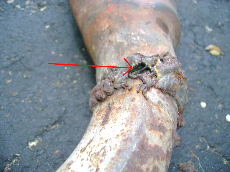

Today I took the exhaust down pipe off to if was can do something with it. Turns out more leaks were happening than originally thought.
Here are some pictures of the leak.
This is the the leak, because this portion is cracked or chipped, it seems to leak around here.
A little further look at this shows the pipe is cracked straight through seems like the pipe is brittle here, we started grinding it down to prepare for a little welding when we notice not only the welding separation, but the crack line running on the inside in the same direction and area.
Looking further down we see a weld not to good of a weld and we see carbon, it seems like it is leaking here as well, a very small leak, but a leak.
We tried to weld a lip on that flange that hold the donuts Gaskets, it didn't work because the piping was so badly cracked the pipe just keep falling apart. Called it a day and decided to go buy a small 3 to 4" - 1 1/2" OD exhaust piping, but no luck no place had that size. Went to 5 placed Advanced, Napa, AutoZone, Tire kingdom and Midas no one had a piece to sell or want to give me a piece. I also call a couple of places and none said they don't have any to sell. My neighbor said he'll try and roll one out of a scrap stainless steel sheet at his job.
