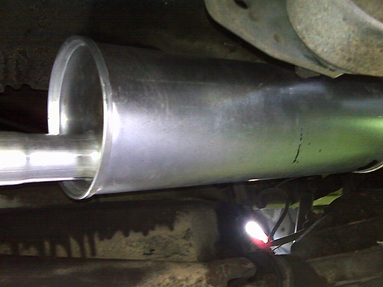

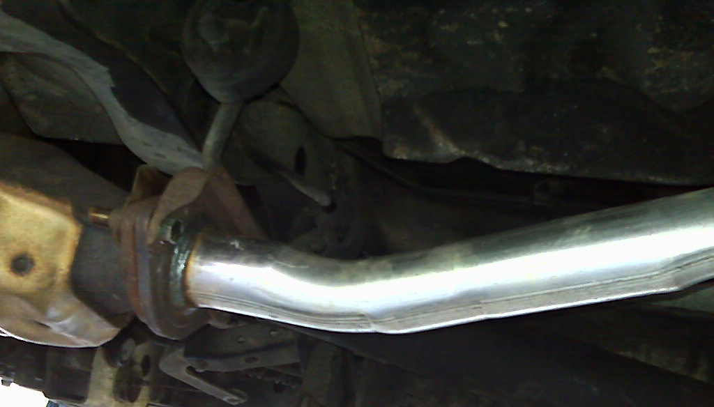

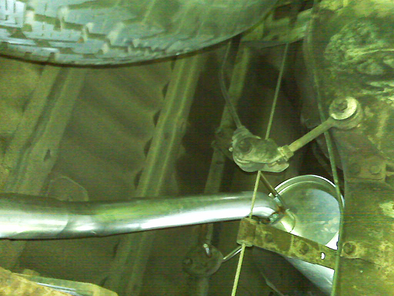

A little over due is the muffler replacement. If you remember I installed a after market muffler, it came complete welded from tail pipe all the way up to the existing cat.
This is where it fitted up to the cat.
This is the muffler which is actually shorter than the oem muffler.

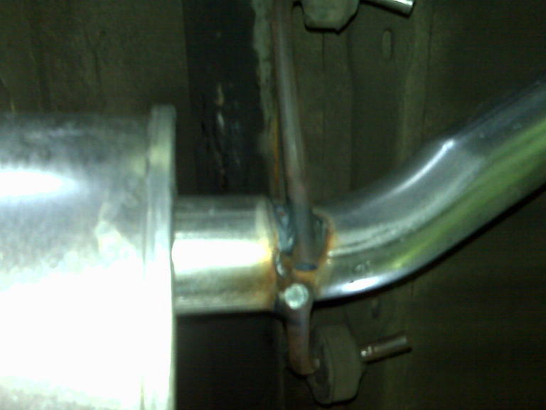

This is the hanger at the muffler. I believe Toyota OEM mufflers come with the hanger welded to the muffler not the piping. Hence the last remark smaller muffler.
This last picture is looking from the back. I really didn't like how they contoured the pipe as it sits to close to the leaf springs. I had to adjust it ao get it further away so it wouldn't hit the springs. OEM Pipe is curved further away.
The muffler works so far and its so much quieter than before with all those weld leaks and seal leaks. Can't beat the cost for an After market one, total cost for the entire setup was 70 bucks shipped.

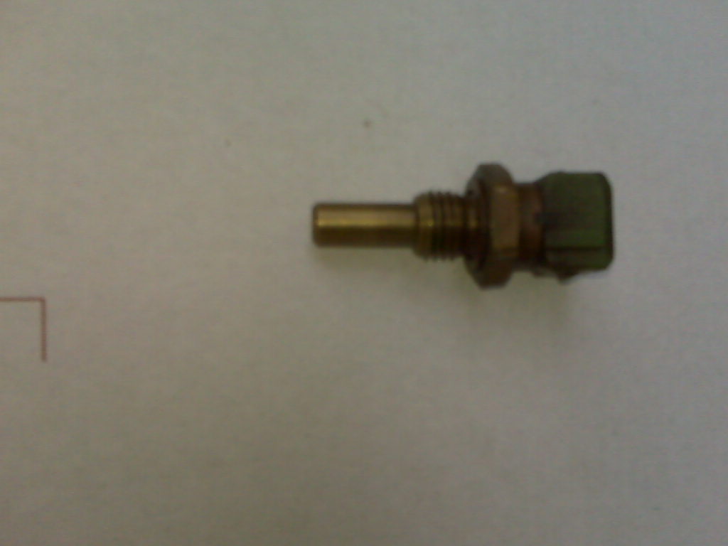

Replaced the Temp sensor here's the one i pulled out. You can see how clean it is. There's nothing wrong with it as the one I put in the truck is from the 86 4runner and it still doesn't change anything. I'm thinking of tinkering the TPS again to check it out, it may have slipped since I changed the screws to those hex type screw.

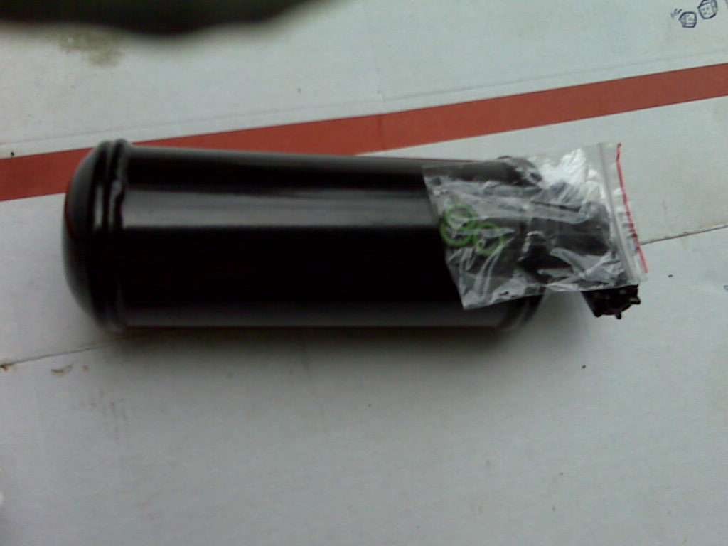

Ac work is moving along fair well. I purchased a drier from Napa Auto parts, it’s smaller than the OEM so the straps won’t secure tight when it’s on.

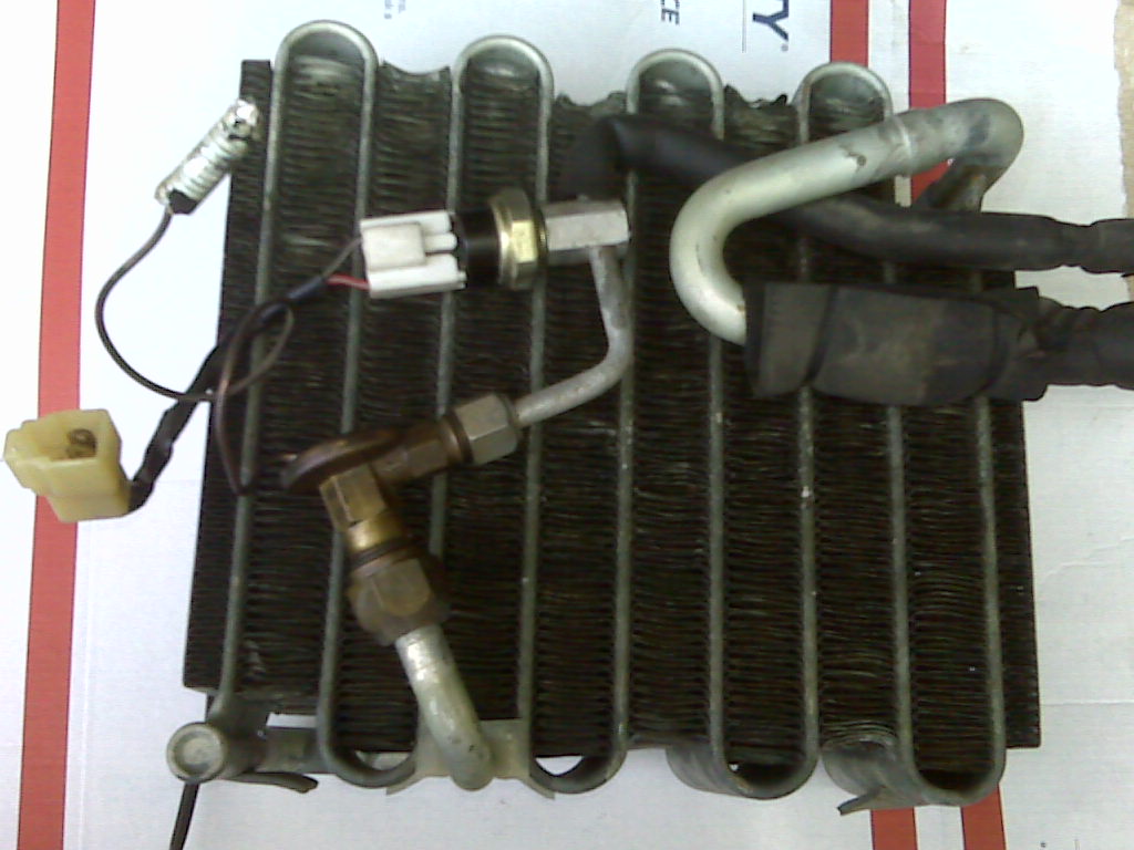

Pull the evaporator out and soaked it for a while, then blew it out.
Cleaned it up pretty good.

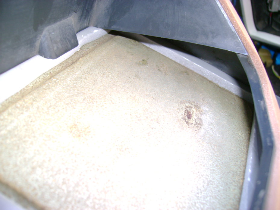

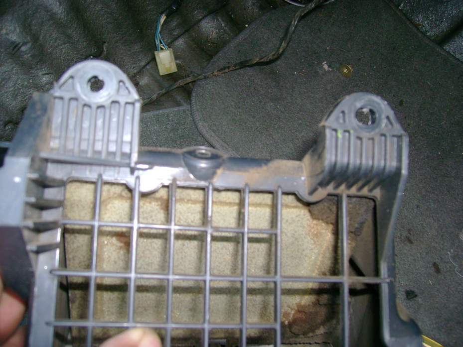

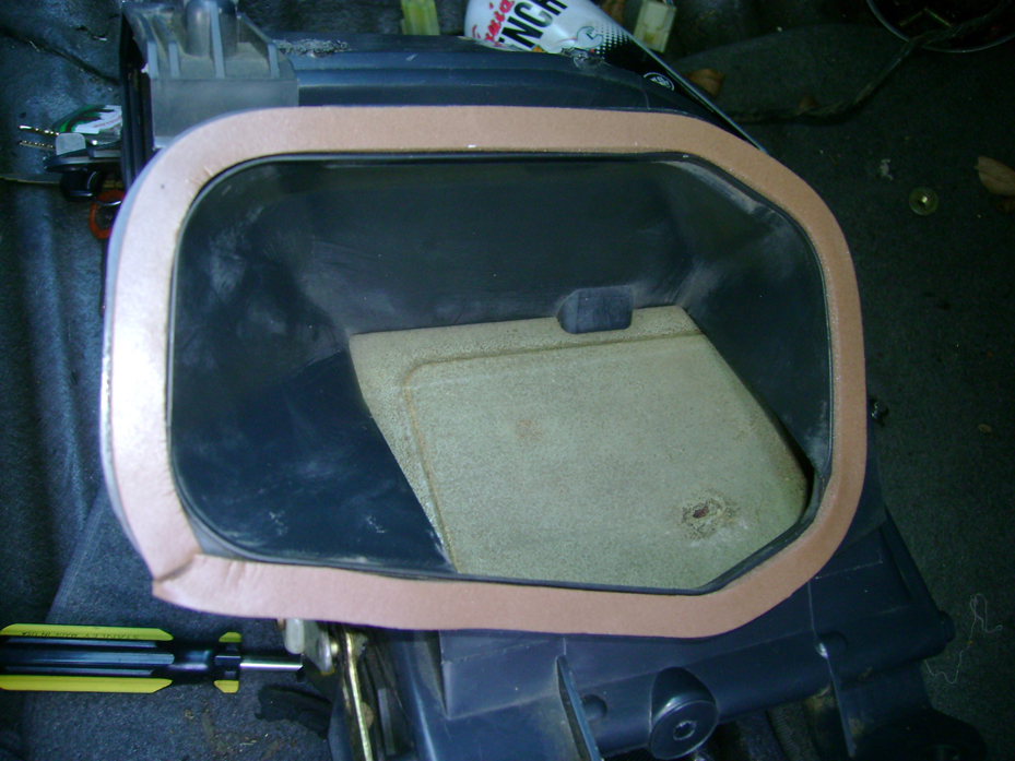

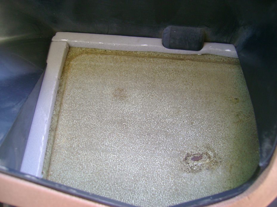

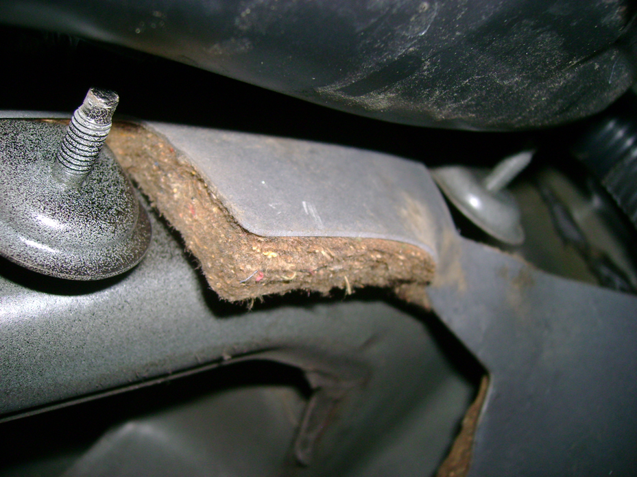

Cory I decided to pull the blower box out to see how difficult it is and try and take care of those foam seals. So, here are some pictures for you to see how or where the nuts and screws are for you to pull it out.
This is where the nuts are at the top of the box.
This is where they screw into, kind of difficult to reach up under the dash and could barely get a 10mm wrench in there. Good thing I had a ratcheting 10mm wrench it made a world of difference.

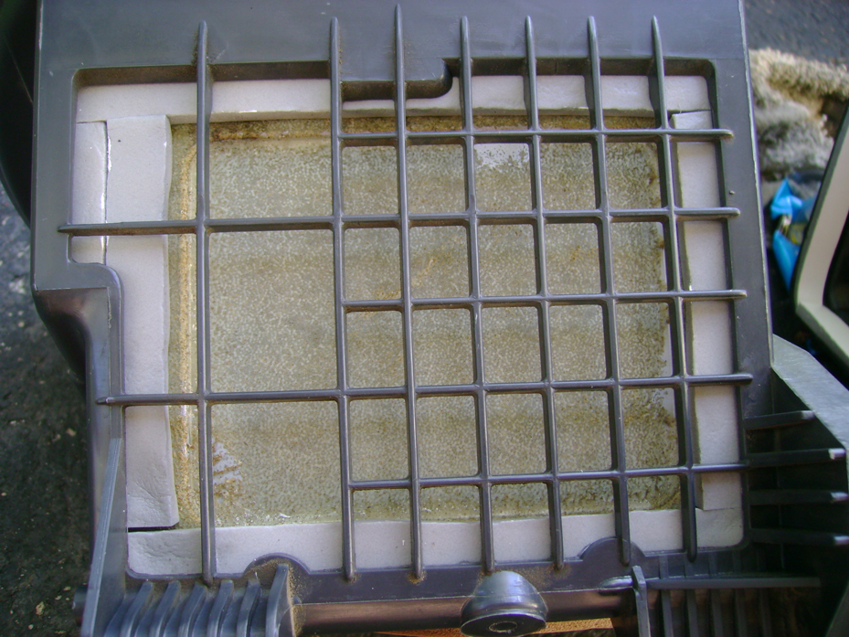

Once you get it out you can see the opening at the top has a foam seal which I redid with some weather stripping I had lying around. you can see that this side requires foam on the flapper, this is the side I am most concerned with as it seals the outside air from coming in.
As i mentioned before I re-foamed the seal at the top with weather stripping that I had lying around.
Here's the other side of the flapper that also requires foam when it flips to close the return air vent from the inside.

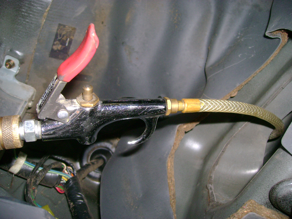

While I had the blower box off and the intake air hole to the cowl was free from obstruction I decided to reach up in and see if anything was in there. Good thing there wasn't a snake in there reaching around like that, Haha... I did manage to pull a lot of leaves out then I stuck a hose in there and blasted some air there till I felt air blow out the fender.
It did take a bit of blowing before i felt the air, but it seems like it clear of debris.

Okay I had a little time to play with this foam seal and it looks like it will work out okay only time will tell. I used this stuff i picked up at the local hardware store for door and windows weather stripping 1/4" thick and 1/2" wide. The had one that was 2" wide, but only 1/8" thick. I thought it would be to thin to work and as it looks I was right.
Hears what I got.
Tried running in a single length, but that didn't work on each turn it was either to short or would curl up, so i had to cut strips. Not the best of work, but it seals. I could of done better if the flapper would have come out of the housing, but the 2 part housing was actually sealed. On the parts that separated, they heat melted the seams so they are stuck together.
Here's a picture of the vent closed for outside air circulation.
It sealed up pretty good, I put a flash light inside and didn't get any light leaking through. And it compressed just enough to seal it, but not much to making it tough to close. I suppose I could have used something just a hair thicker maybe 5/16" or 3/8".
