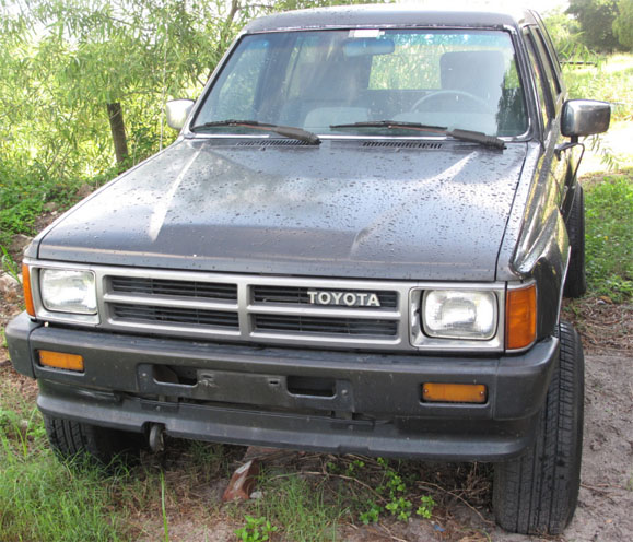

I found some pics of the truck by the PO:
Cropped out a section just in case(for the PO). Not the original paint, original was black, the First Owners painted it grey and did a bad job it even has a clear coat on it which in some places is peeling off. You can even see the original strips on the door as they never sanded it off. as I said before, the original color was Black, eventually I will paint it black again.

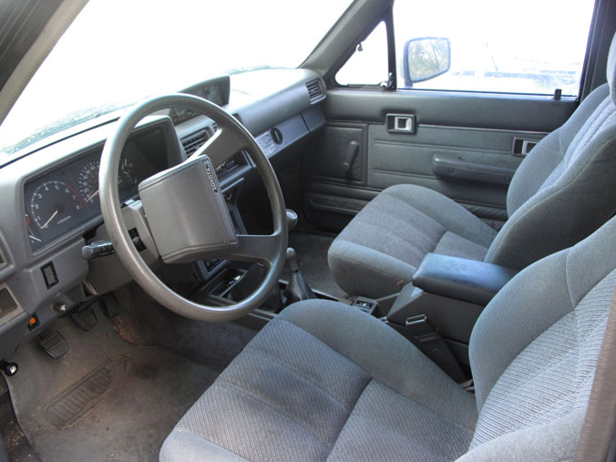

Interior is OK, but detail wise, there is a lot of things that need to be done. Heater lever is broken or needing repair. Why the Heater control valve is stuck and the original owners must of forced it to try and close the valve which didn't happen. The valve is still stuck today. Actually what I found out is if you want to keep using the old one you can take the valve off and look at the output end and see the actual valve which is like a plunger it's stuck because of rust. Grease it up and lightly tap it and it will slide back or on the opposite side the leg that sticks out give it a few taps after greasing up the inside and it should free up. Then work it by hand and PB Blaster. Does the job, but not perfect, you will have a small amount of seepage, but nothing major. Beats spending $107 bucks for a new one.
Shift cover needs work as well, that will come once I replace the transmission since it seems that 4th gear doesn't engage.

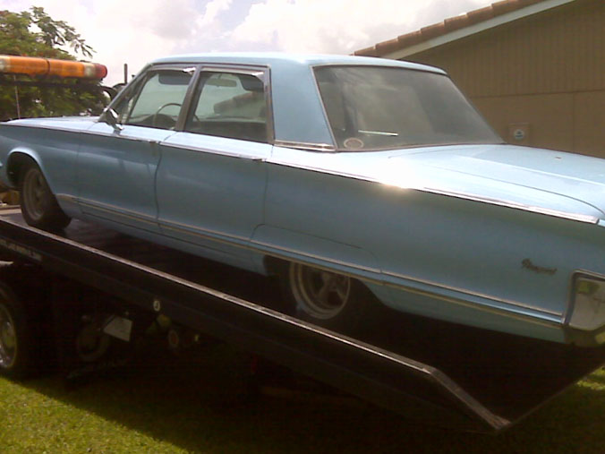

I was side tracked today because....
I was side tracked today because I got a call from a towing company. A friend of mine had a car and decided he didn't want it, so he gave it to me. The only trouble was he lives about 125 miles north of me. I live down in the Miami area. This way off the thread topic, and I hope you guys don't get upset, but its was a super sweet ride in its days.
Here's the pics:
Towed all the way down.

Needs some interior work as the seats need to be redone.
My son want to paint it black for a Batman look.
It still runs, just needs a battery and brake work to get it moving around.

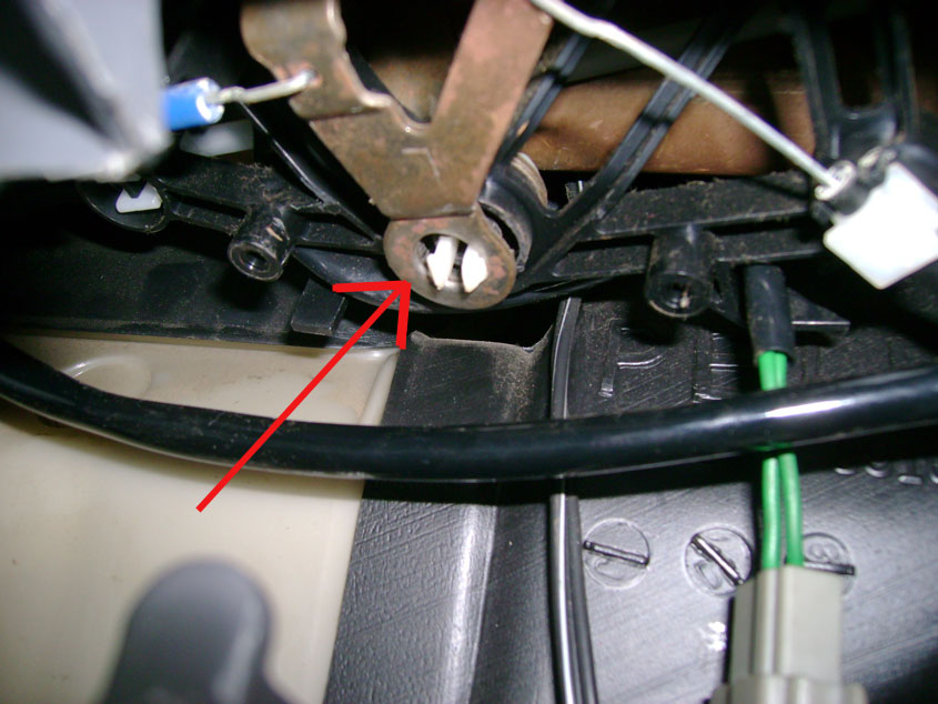

Took a look at the Heater control switch today to see how to fix the lever since it was kind of damaged by the Original PO because the heater valve control is frozen.
I marked off in red the lever I'm talking about here on this picture.
Here is the pivot point that need to be locked in place so it doesn't come off.
Anybody have any idea what holds it in place please let me know.

Looks like just a plastic pin in there now...maybe pick up a metal pin and cotter pin at a hw store and replace?

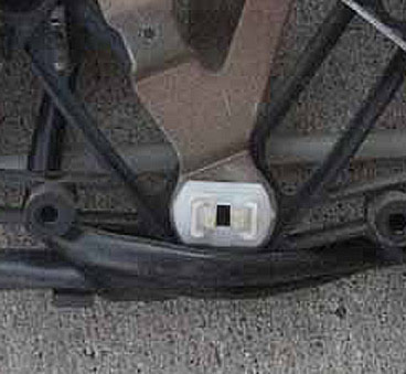

That's a good idea, after you responded and gave me this idea, I stared at the picture which is easier to view then laying down in the truck.
I think something maybe missing, here's what I'm talking about(see picture posted again below). There's 2 screw holes for something (pointed out in orange), must be a cover plate or something that maybe the PO may have taken out because the lever was stuck. Well that didn't help considering what is stuck is the Heater Control Valve under the hood.

Ahh, I see now. I think you're right. Probablya plate with 3 holes (2 outside for screws, and the middle hole is what that white plastic peg snaps into. I think a flanged, metal pin and cotter pin would serve the same purpose?
I'll let others chime in since I've never services this part before

Hey Thanks for the reply. Did some looking around on here found a pic and its a plastic piece that clips right over those legs and holds in place. Those screw holes aren't for anything they are just there maybe for some other make of toyota using the same mold.
Here's a clip.

Rather than replacing it with the same old clip or like, I figured I could rig something better up using a flat piece of metal and punching holes in it to fit those screw holes and legs holding it much more secure and stronger than the original.
Here's the idea, just a quick sketch.

I would just make sure that those 2 plastic holes you're planning to use on the outside of your fabbed piece are strong enough to support it. Or, just stick a metal pin in there
Good luck!

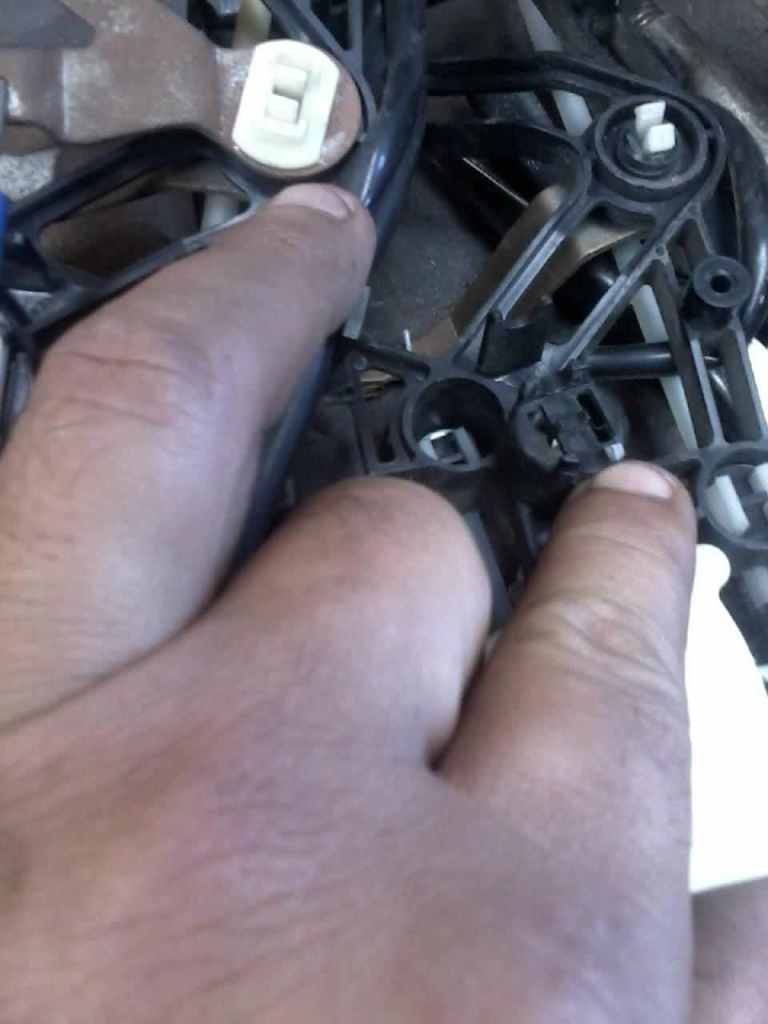

You got a solid looking little truck. Those heater controls do get broken. There is a center piece that goes inbetween the white clip. That is either broken out or the clip that holds the cable to it. Just got done working on mine. If you are just missing that piece, get a junk one out of the bone yard. It is a good idea to keep it for parts even if it is broken. These get brittle over time and if someone just starts forcing it, you will need more pieces.
Here is the center that usually gets broken.
I believe this is the piece you are needing. Where my other finger is, that is a common problem of the clip that holds the cable.

I am thinking that is a 65 or 66 Chrysler. Is it the Fury?

Good guess on the Year 1966 Chrysler... Its a Newport. It was given to me, but I'm just going to off loaded. It's got to much work that needs to be done to it. I would like to get a hand on a 72 Mach 1 or a 1972 Roadrunner.
It cranks, I just jumped the battery. Looks like I've got to run over to the gas station and get some gas.

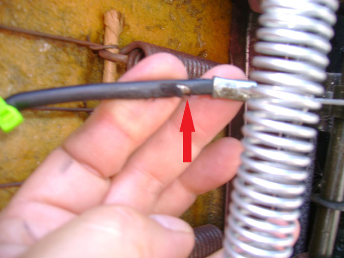

Front Passenger seat Repair.
Okay quick picture of what I've done with the passenger seat.
Blocked out in red, I got a spring for the seat. The PO must of removed it or maybe it just broke off. I went over to my 86 4runner and pulled the spring from it and ran down to ACE Hardware, they had an almost exact fit. I think they called it a #56 spring.
I've know this from the past as well, on my 86 4runner the cables always brushed the spring. After a while the cables would break and you would have to purchase a new one. Before mine breaks I tie-wrapped it as you see in the picture where the red arrows are.
Here is a close up of what must of been the reason for the removal of the original spring by the PO the damage already done.
