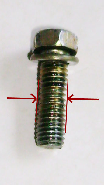

I'm kind of picky to how things work and some people call it being anal, but here's a picture of the rear housing for the oil seal looking down at it.
If you remember earlier Philbert said that the torque on these bolts is 9ftlbs, but I over tightened it 15ftlbs. Like a fool having the FSM i never referenced it because I used the closes thing the Hanes manual. I really got to thank
Philbert for reminding me about the FSM which is like a bible for these trucks.
Over tightening usual causes issue some where along the lines and it was bothering me. I kept thinking coned threads or stretched bolts etc... So today I took one of the bolts off and boy was i right in doing so. The one bolt I took off was stretched, so off to get replacements, hate doing that as Lowes or Ace carry bolts that aren't any where near factory specs even though they work.
Here's a picture showing one of the stretched bolt, look closely between the red line and the arrows.
Just pisses me off
that I didn't bother checking the torque before tightening. Well better to change it now then to have to remove everything just to fix a leak that may have happened.
Philbert for reminding me about the FSM which is like a bible for these trucks.Over tightening usual causes issue some where along the lines and it was bothering me. I kept thinking coned threads or stretched bolts etc... So today I took one of the bolts off and boy was i right in doing so. The one bolt I took off was stretched, so off to get replacements, hate doing that as Lowes or Ace carry bolts that aren't any where near factory specs even though they work.
Just pisses me off

but now you know for next time!
Be careful with the bellhousing bolts too....I learned the hard way. There are bolts that bolt into the block and those that bolt into the mounts that also bolt to the block....the torque is MUCH different on them....I actually broke a bolt (one that bolts into the motor mount bracket thing). Luckily I was able to unbolt the bracket and back off the broken bolt by hand...whew! FSM is the bible indeed - heed it!
Any particular reason you used FIPG red on the EGR on the back of the head there? Haven't seen that before.
