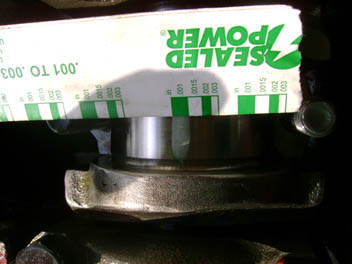

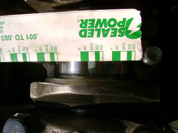

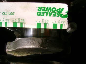

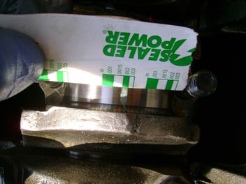

Just thought I would post some uninteresting photos of my recheck of the connecting rod journal when i plastigaged it for the 3rd time just to make sure.
I used Lucas assembly oil to lube it all up. As well I pour it in the oil pump. The stuffs pretty good some what like Honey thick and kind of tacky.

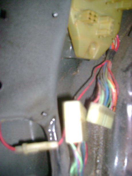

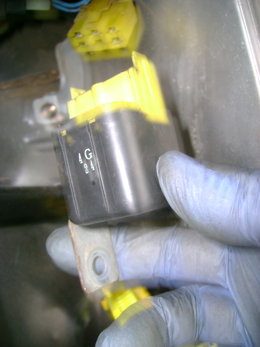

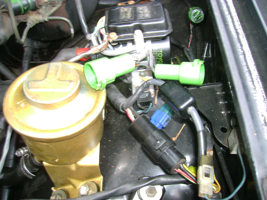

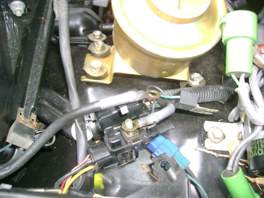

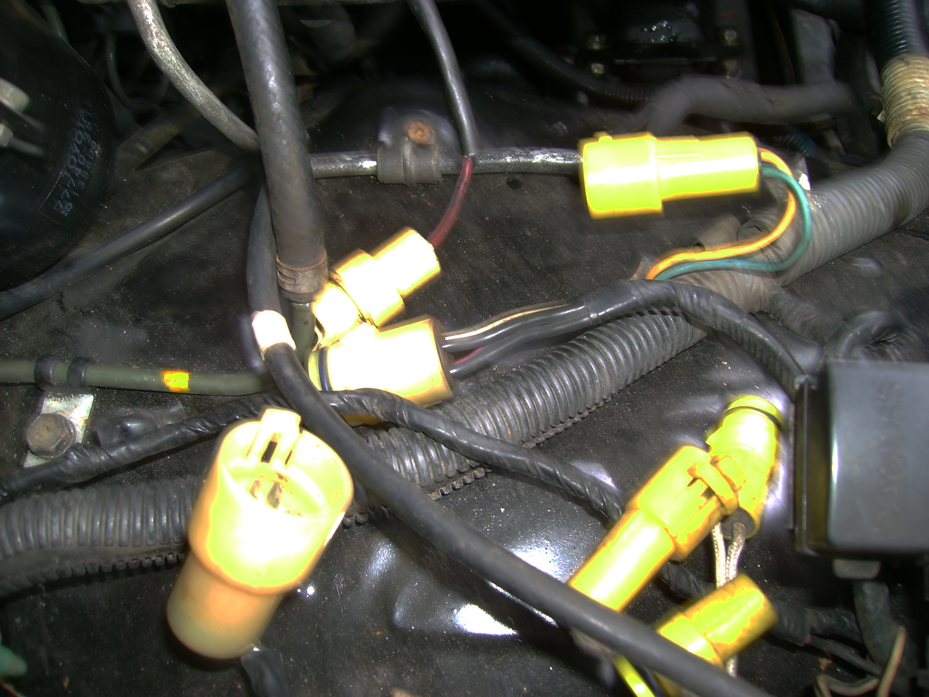

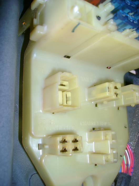

Okay as I mentioned earlier that I had finished installing the motor into the truck and got everything. Turns out I have another problem that I need to resolve. I have a electrical problem somewhere, what I thought was a short between the plenum and the valve cover was just the injectors clicking because of the electrical short somewhere causing the injectors to fire. I thought it may be in the harness, but I checked continuity and all seems good.
I disconnected the injectors from the harness and the injector’s resistor as well.
I disconnected the coil as well.
Heard the EFI replay clicking as well so I took it out then I heard a hissing on the fuse panel after I took the EFI relay off so I decided to remove all the relays.
Still saw the surging so I went and pulled the harness from the front side of the fuse panel.
Disconnected the ECM
Disconnected the COR
Went back up front and disconnected the Alternator just in case something was happening with that.
Then went over and removed the battery cable to starter as well.
Along with all this I disconnected the Fuel Pump at the pump. Disconnected the transmission and tcase cable as well.
Nothing has worked so far, but I guess my next approach is to check the iginition.
Here's a short clip of the surging, watch the voltage on the dash and watch red lights on the dash and you see how bright red they get.
By the way the truck is not running just the key in the ignition in the on position.
Any help on this would really be appreciated. Thanks

Okay, I have been through this in my head and actually Coryc85 maybe 100% correct my battery maybe the culprit on this electrical issue. Should have been the first thing that I headed for.
You are the MAN... crossing my fingers that this is the problem even though it would set me back a c-note/Benjamin. I will put the old battery on the charge by it self and charge it up (should a few, but still getting a replacement), while its charging, I will start putting parts back together.

Okay, The battery was on the charger for about 1hour or so starting from a slow charge. Popped it into the truck and tried cranking, after 3 tries the batteries dead. Off to get a new battery. CORYC85 was spot-on. Thanks...

Update 07/04/2013....
HAPPY FORTH OF JULY TO YOU ALL...
I have an update for you all. The battery was the source of the problem as Coryc85 originally point out to me. I thank him for this as I should have myself not been so blind to this simple issues even after disconnecting everything there was.
Moving on, I got things button up and the little stuff taken care of and cleared everything for a ready to crank and crossing my fingers. I crank the truck up and it starts on the first turn. Not bad, but I rev it just a little and what do I hear. Knock knock knock... at idle no knocking, nicely running rev it just a little and knock knock. It can't be the rod bearings on the first start can it?

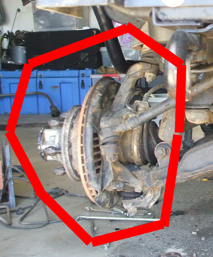

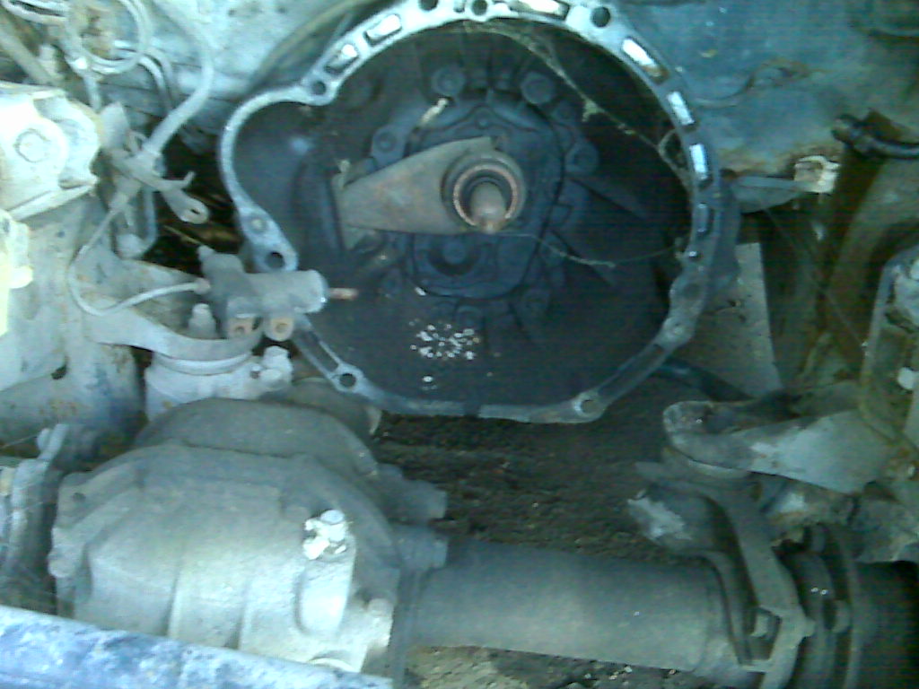

On a different note, I had to work this weekend up north, but i was able to score tranny/tcase for free off a 89 Pickup Truck. I was working at a scrap yard and saw this pickup truck there and it turned out to be a 4 wheel drive truck, pretty much much stripped out. Interior missing A/C, and heater core, (I thought i could get a few nicknacks off the interior, but not so, cab was actually crushed already and the interior was pretty bad, stripped. It still had the tranny so i tried looking, but since it only had one wheel it was hard to see. I got it pulled out with a Bobcat and lifted up to see. Looking good, the tranny was a W56-C forward Shifter. Still didn't know if it was any good. Based on what Philbert mention early on about rotating the drive and shifting, it spun pretty smooth. Decided to take good or bad as the parts maybe use full (gears).
Well Bolts were so badly rusted the thread where stripped and they didn't back out. Plus one of the bolts was welded to the frame as right next to the bolt they patched a rusted hole in the frame and accidentally welded the bolt. Got the guys in the yard to drag it about 50 yards close to the Torch they had and with the torch cut cross brace and removed the tranny mount bolts and the tranny just hung from the boots. i turn for a second to find something to cut the rubber boot and a guy helping me out grabbed a knife and cut and let the tranny drop. Didn't notice it before , but the tranny had cracked or better put chipped a 1" hole in the housing. Noticed when i was trying to take off the bell housing to put in the car. Decided not to take it home with me, but leave it up there on hold for me to pick up later. Doesn't bother me that it had been cracked because I was thinking I could convert this to a W56-B as I have that other pitted rusted gears tranny that I bought for $35 bucks last year and could use the housings and the shifters for the conversion.
Took the front differential as you see in the picture as well.
Also notice the Manual locking hubs on it, so i tried taking it off, but i only got one side off with all the cone washers. I would have like to taken the entire knuckle(the 54mm locking nut needed to be removed), but that was impossible. Tried to take the other side off, but no such luck, that side had a rim and being as I really didn't have tools or the lack there of it was impossible. I could have torched out the forks on the IFS and just be done, but time and tools was an issue in this case time since I had the torch at my disposal.
