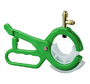

Just so you all know, adding R152a is not done through the conventional way, but through a can tap.
Here's what they look like.
You can sometimes find it at the local auto parts stores.

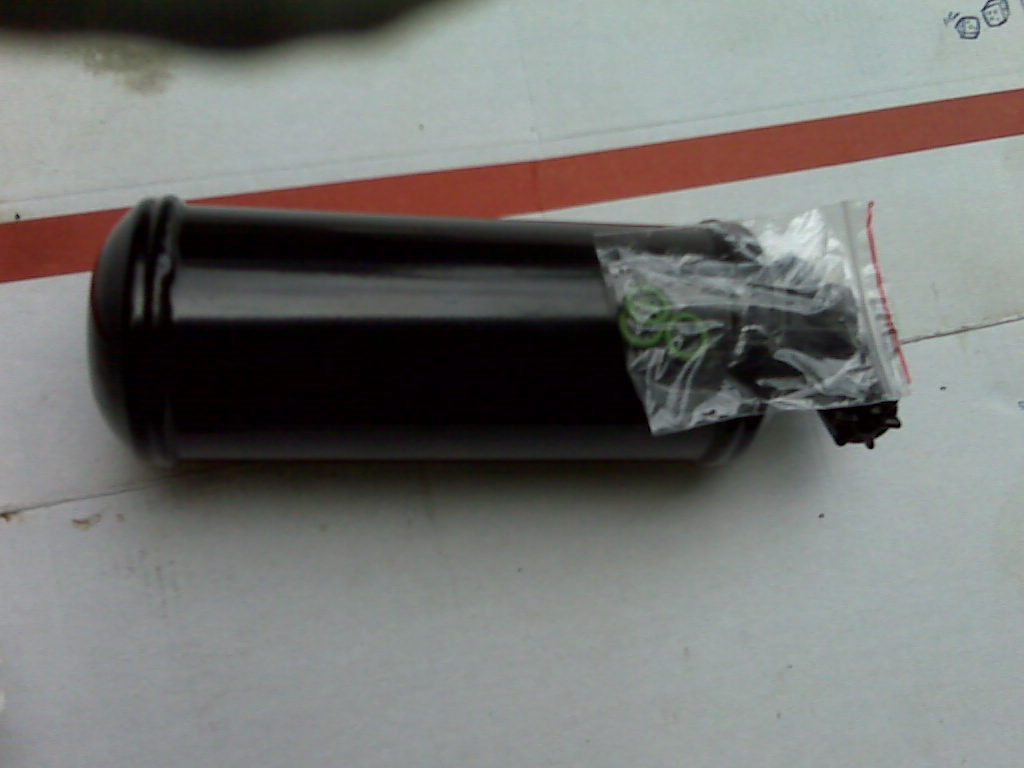

Next would be to replace the drier. Take 2-3 oz of the the ester oil and pour it into the new drier (some will say otherwise). use the new o-rings that usually come with the new drier.

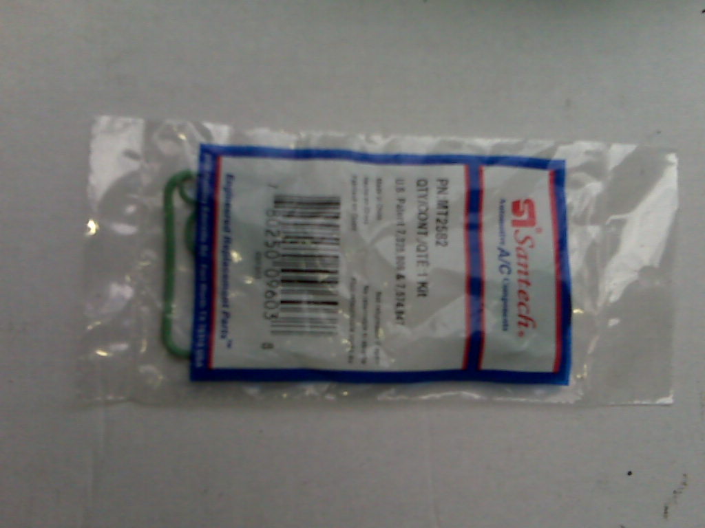

It may be best to purchase a o-ring seal kit for your truck I did even though I knew I wasn't going to use only but a few, it may come in handy if you do find a seal leak in the system else where.

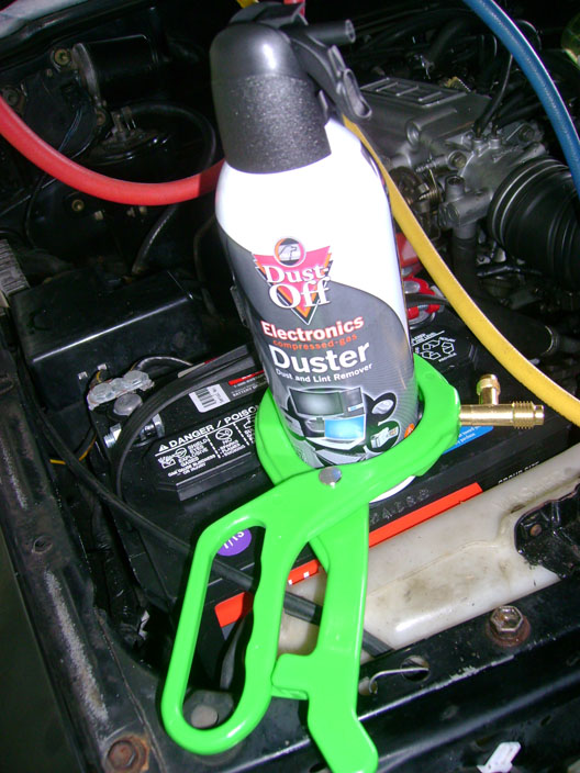

Okay I got my Can Tap earlier than expected on Saturday and today I was finally able to do a little with it on getting the R152a into my system. Just so you'll know I'll be posting the same information on my build thread as well which is located here:
https://www.yotatech.com/forums/f199...7/index19.html
Here's the Can Tap and the bottle of Ester Oil that i will be using:
Since I used the Bottle of ester Oil I had to open up the compressor and pour it in then close up the compressor and vaucum the system.
Here's what I used to charge the AC.
These cans contain R152a, they say they are 10oz cans, but I'm not totally sold on a full 10oz is in them just yet.
I hooked one of them up to the can tap which has both fittings for R12 and R134a.
First can went in without a problem and the engine was off not running about 2/3 or so went in. Then I cranked the truck up and rev the engine up to 2000 RPM's and drew the last oz out of the can. Closed the valve on the gauge and detached the empty can and setup a new Duster Can to the the Can Tap and slowly opened the valve on the gauges. You want the liquid so you don't want to open the gauges to fast. revved up the truck again to 2000 RPM's until the pressure reached about 28-30 on the gauges. Then closed the gauges. Took the truck for a drive around the block to see how cold it would get and and it did get pretty cold, running idle it didn;t cool very well, so i have to check out a few things like the cooling fan, VSV, Booster and make sure that the unit is not under charged.
Got my neighbor to take a drive around the block to see how it cools and he said its utterly unbelievable that it cools like it does. he had handy a temperature gun so we decided to check it out.
The temperature directly at the vent read +/-35 degrees, at one point it went down to 30 degrees (makes me think that the charge is low). Running for about 10 minutes, the temperature in the back seat area read about 71 degrees. That's comfortable for me, but I have to take into consideration even though the temperature outside at 6pm in the semi cloudy afternoon read 86 degrees, the temperature inside the car will be different when the sun is out and its 90 degrees. Over all I think I'm going to like R152a as my choice of refrigerant, just have a lot of tweaking I have to the truck and the AC.
