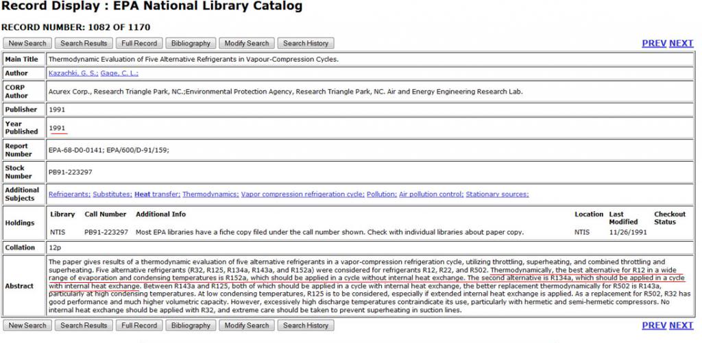

EPA had a test done back in the early 90's looking for the best replacement for R-12 I have underlines in red in the notes indicating the findings.
