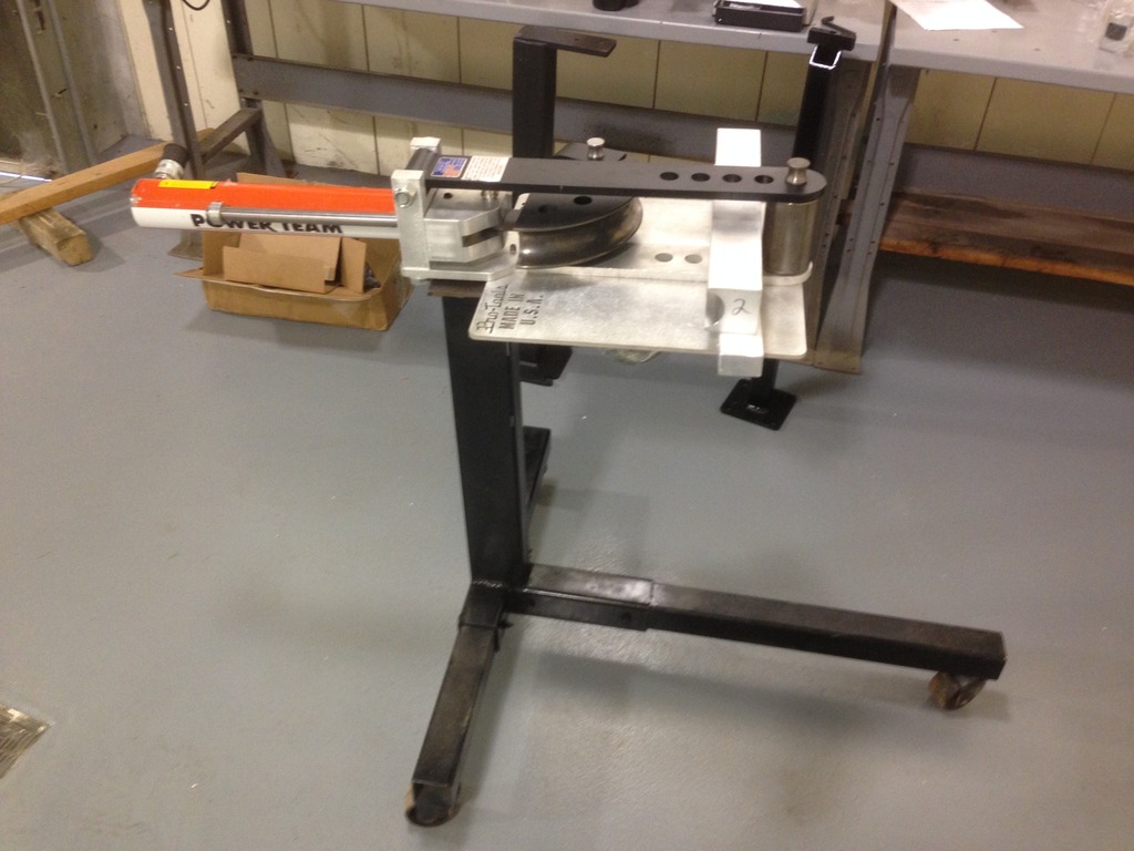

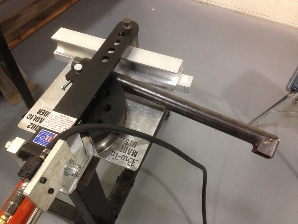

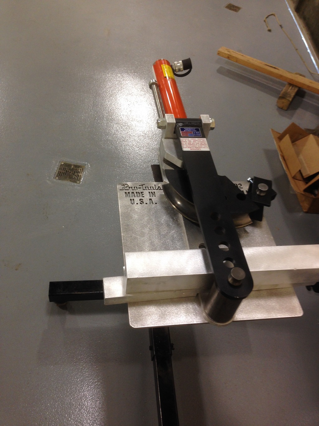

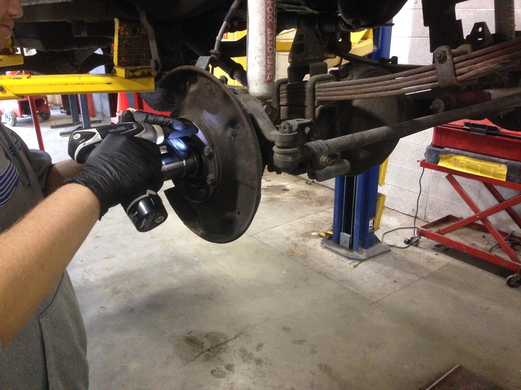

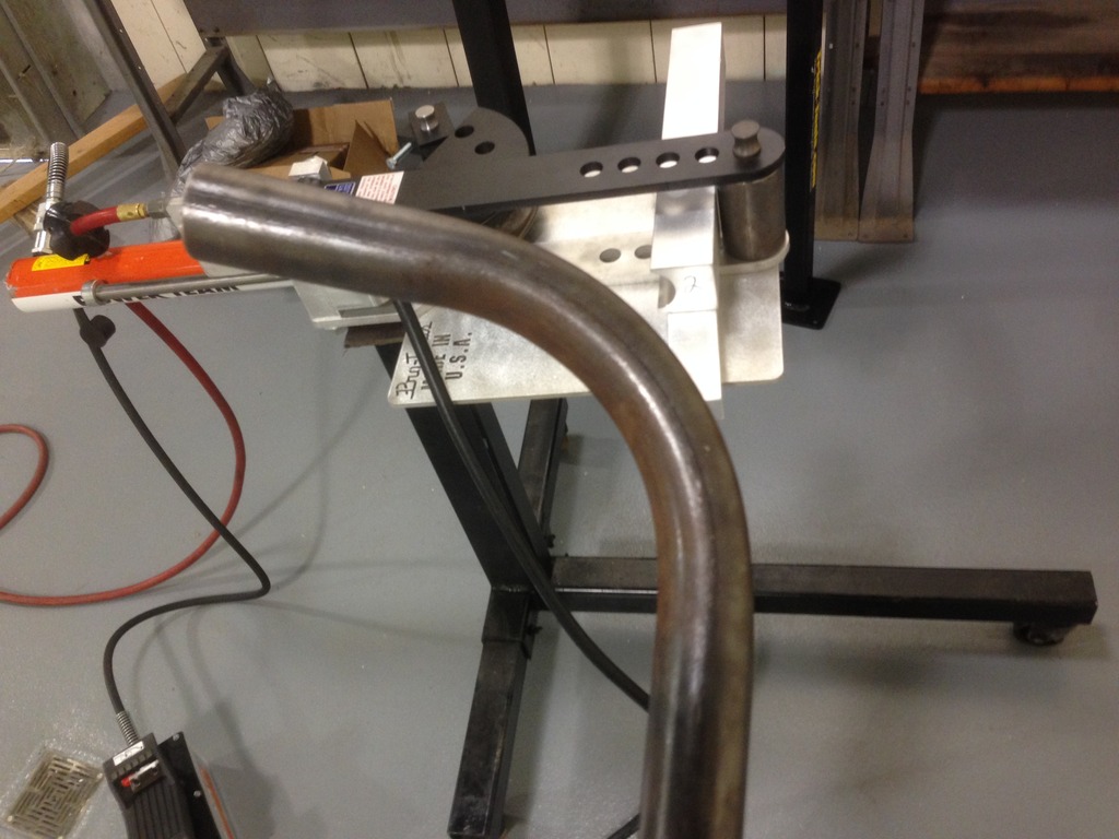

Got the Bender up and running today.
I had the kids modify an old engine stand so we could mount the bender on top of it, making the bender mobile now.
I did not want it fixed in one spot on the floor.
Here are a few quick pics I took of some kids using it for the first time.

That is a great idea making it mobile. I bet the tube supply shop gets busy soon. lol

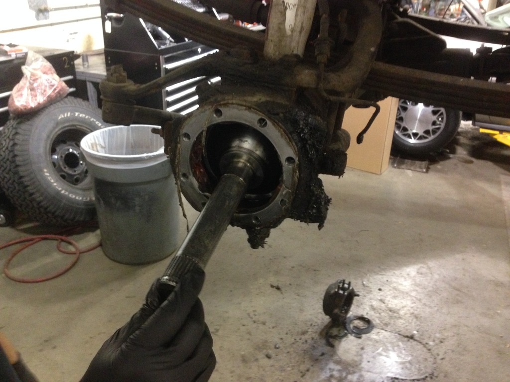

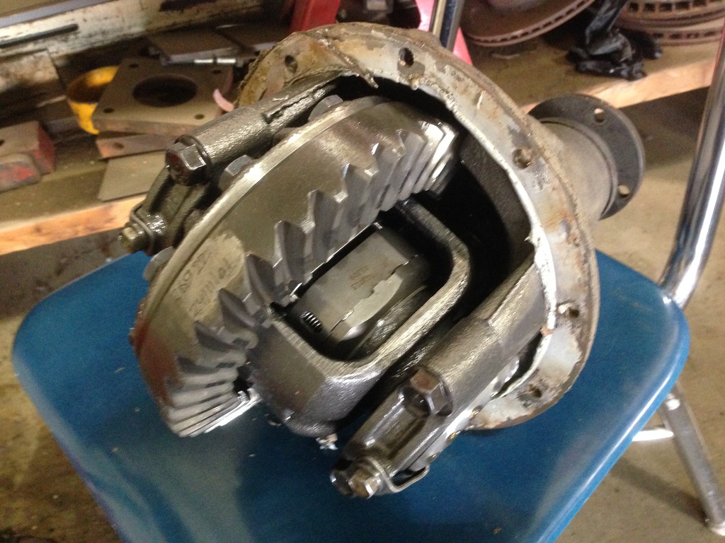

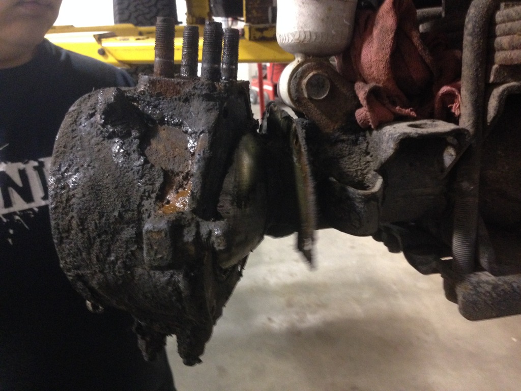

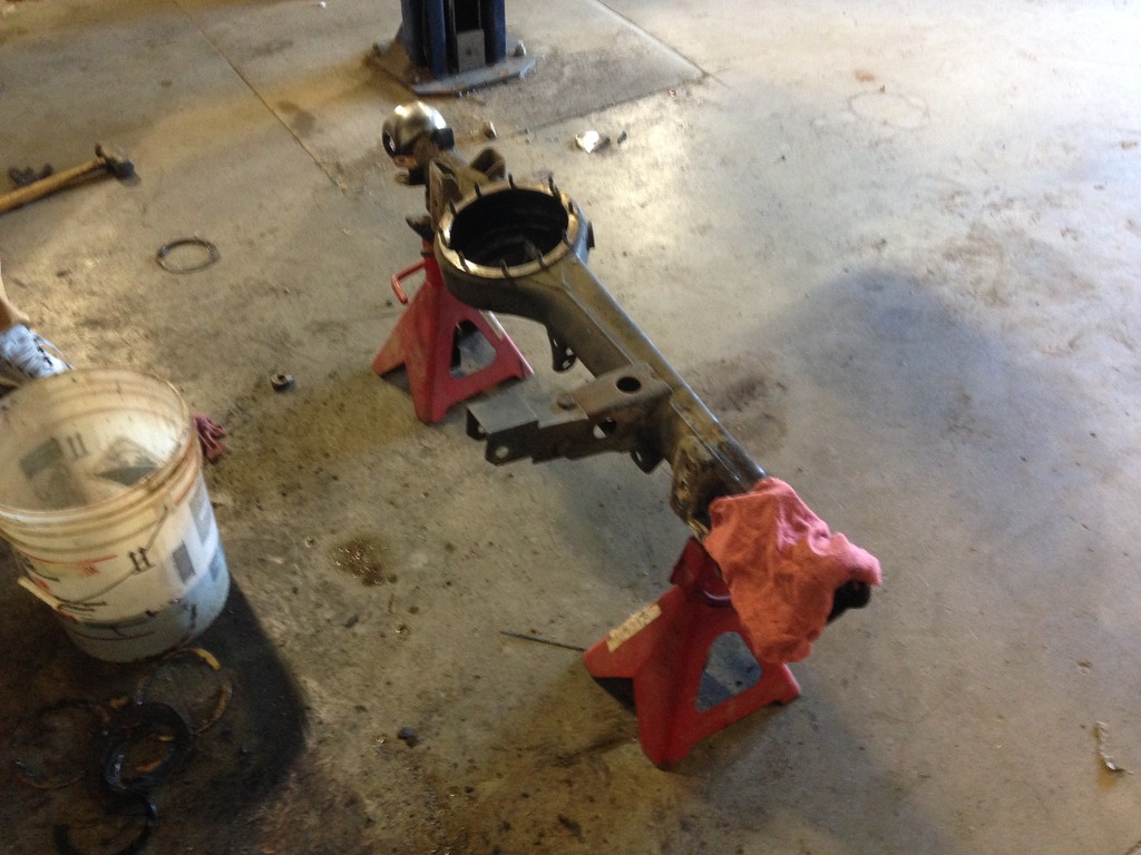

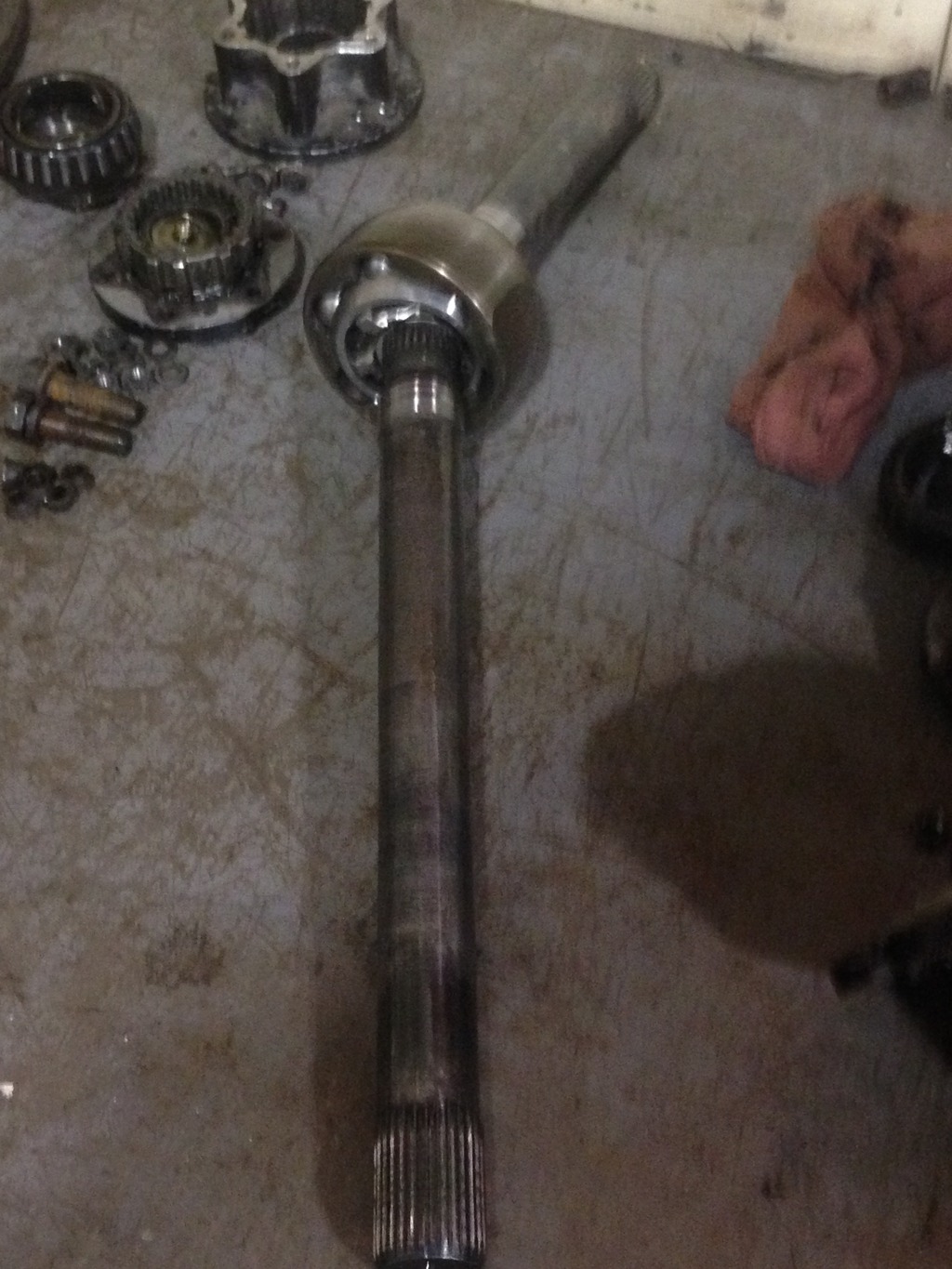

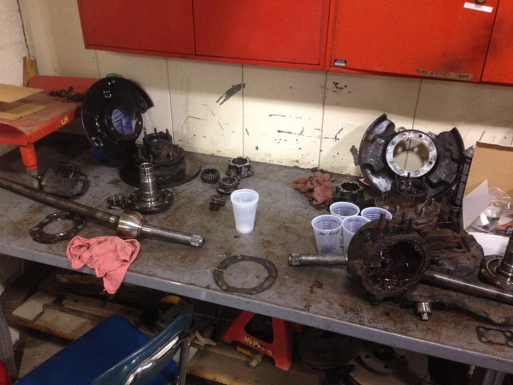

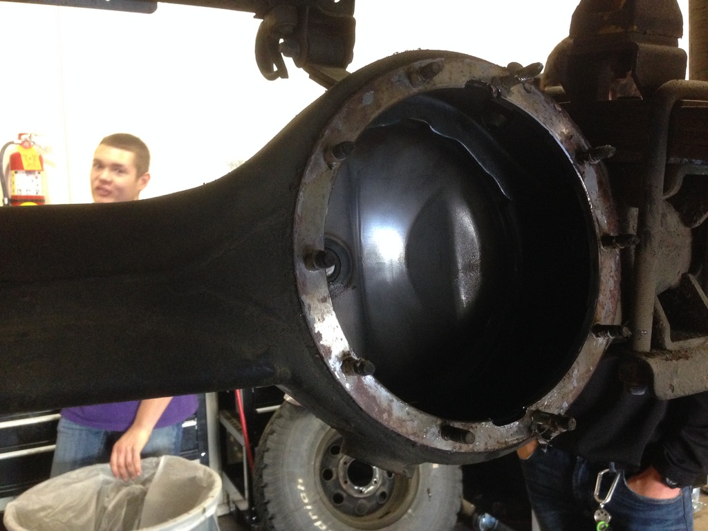

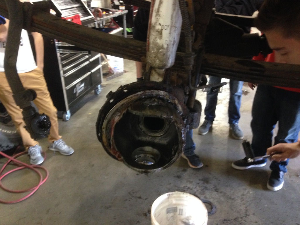

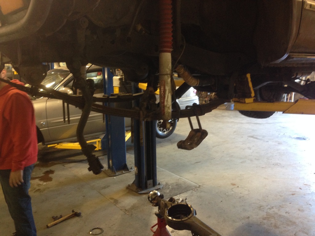

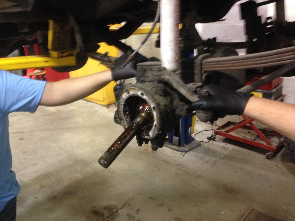

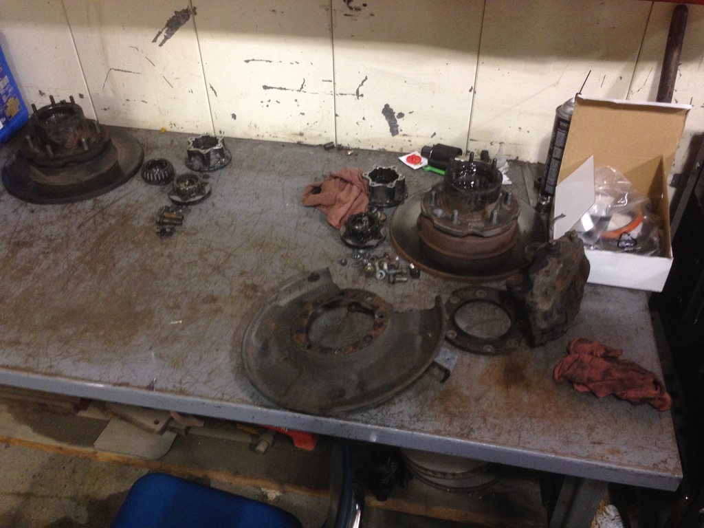

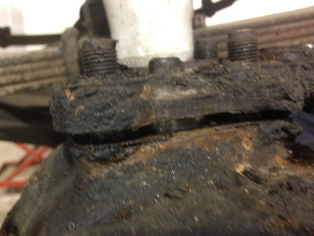

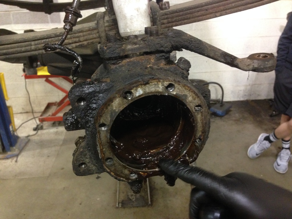

So after much deliberation and dragging my feet.........I have decided to tear my front axle down and put my marlin kit in.
I cannot believe how nasty dirty this thing is! I bet there is 30lbs of crud on the axle and knuckles.
I was showing the students how everything comes apart. A lot of them found it pretty interesting as they have never seen a front axle like it before.
Overall, everything came apart fairly easy.......but I was also using a hoist, and air tools.
I also contemplated on doing springs now or high steer............I decided to bite the bullet and get the High steer now and wait on springs until I can save a little more money.
Well enough talk.....Here are the pics.
Getting everything pulled apart and sorted out.

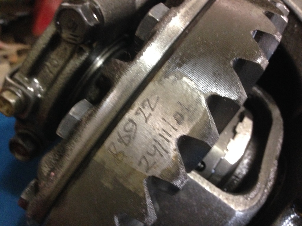

Surprisingly only one shim under each side. I figured there would be more.

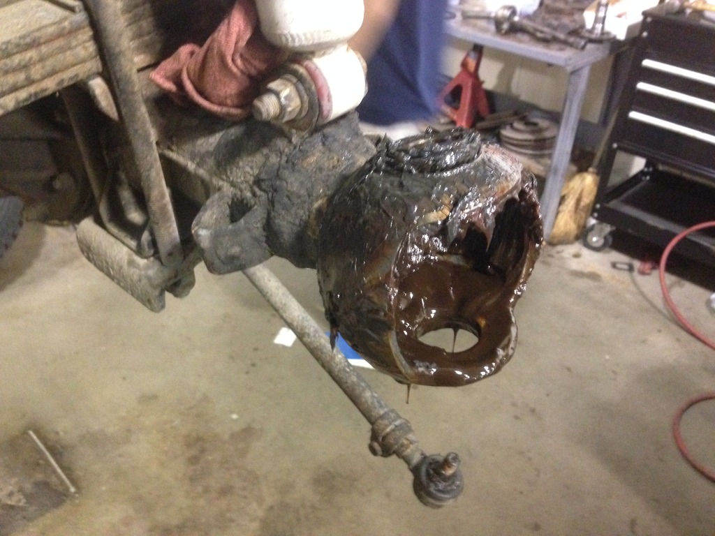

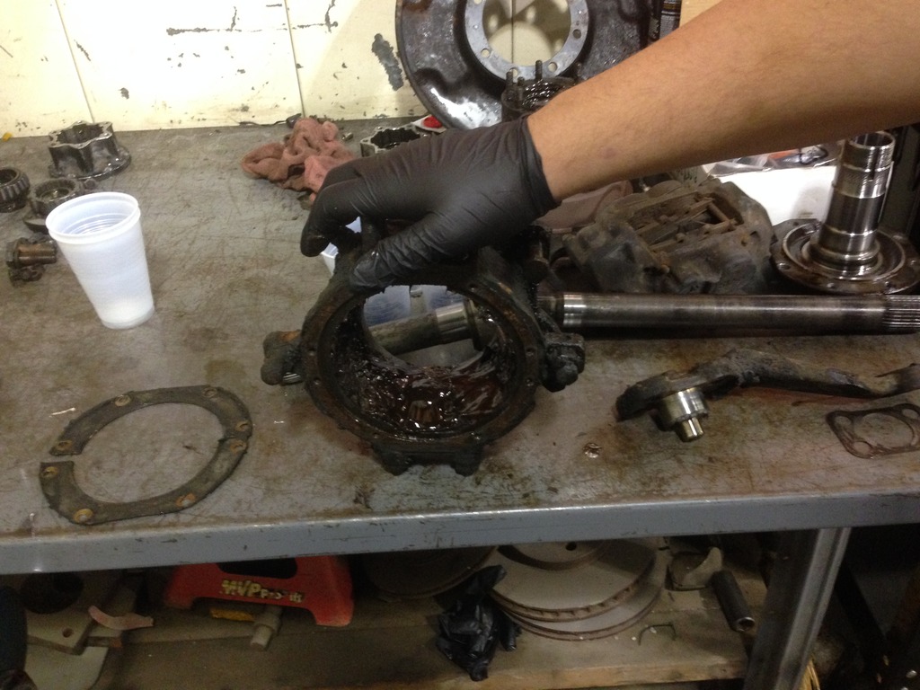

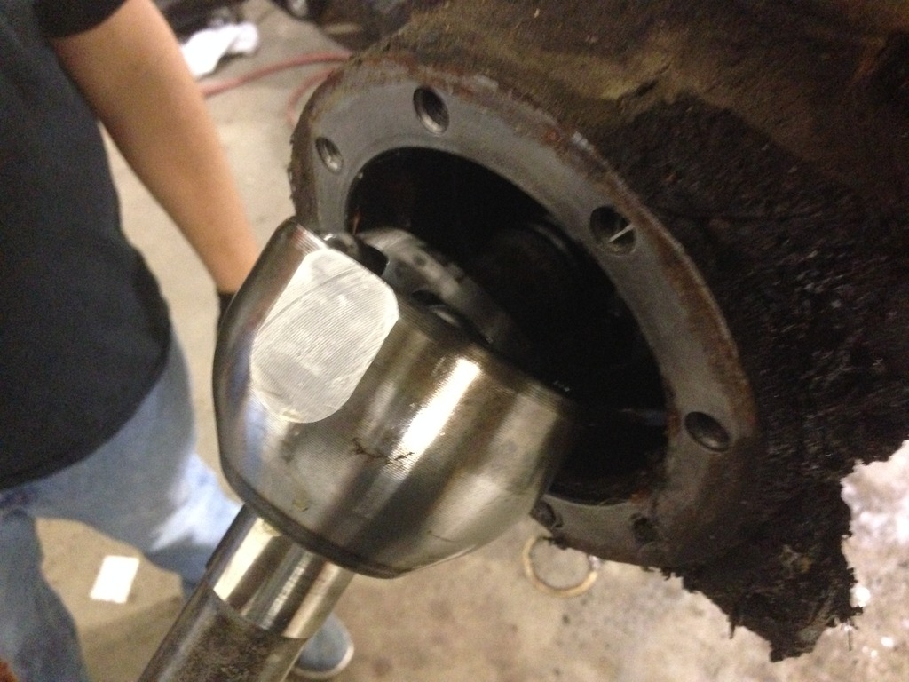

Drivers side was leaking so bad that there was almost no grease left in the knuckle. And the Birf came out clean.

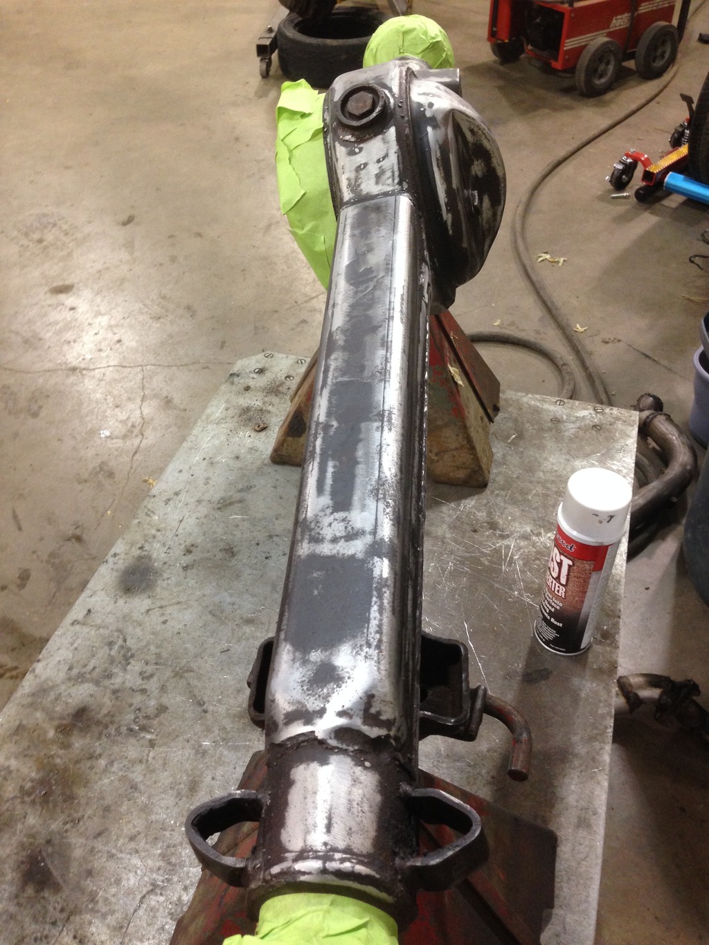

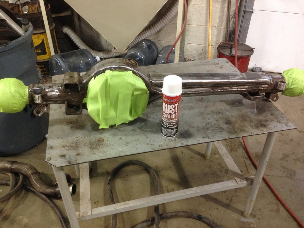

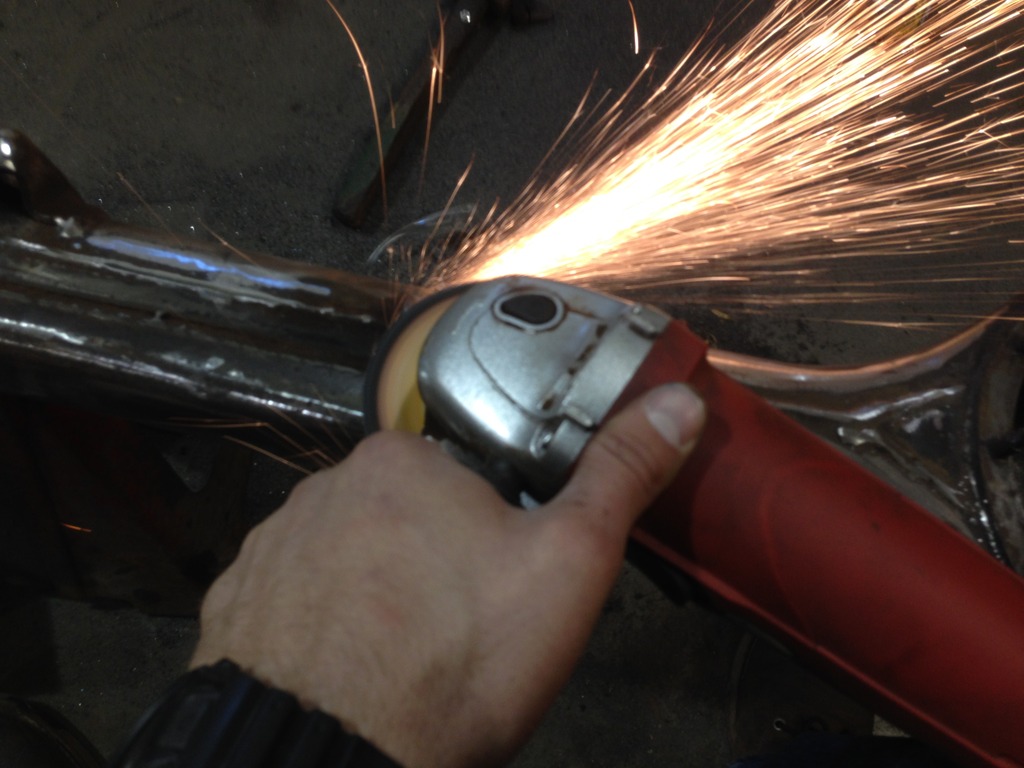

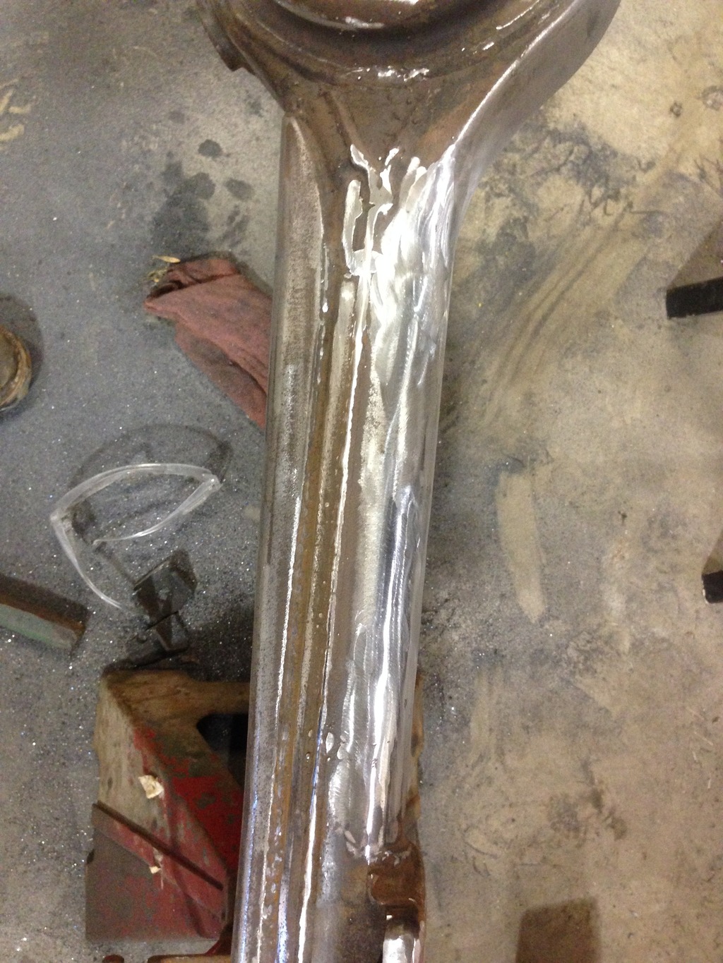

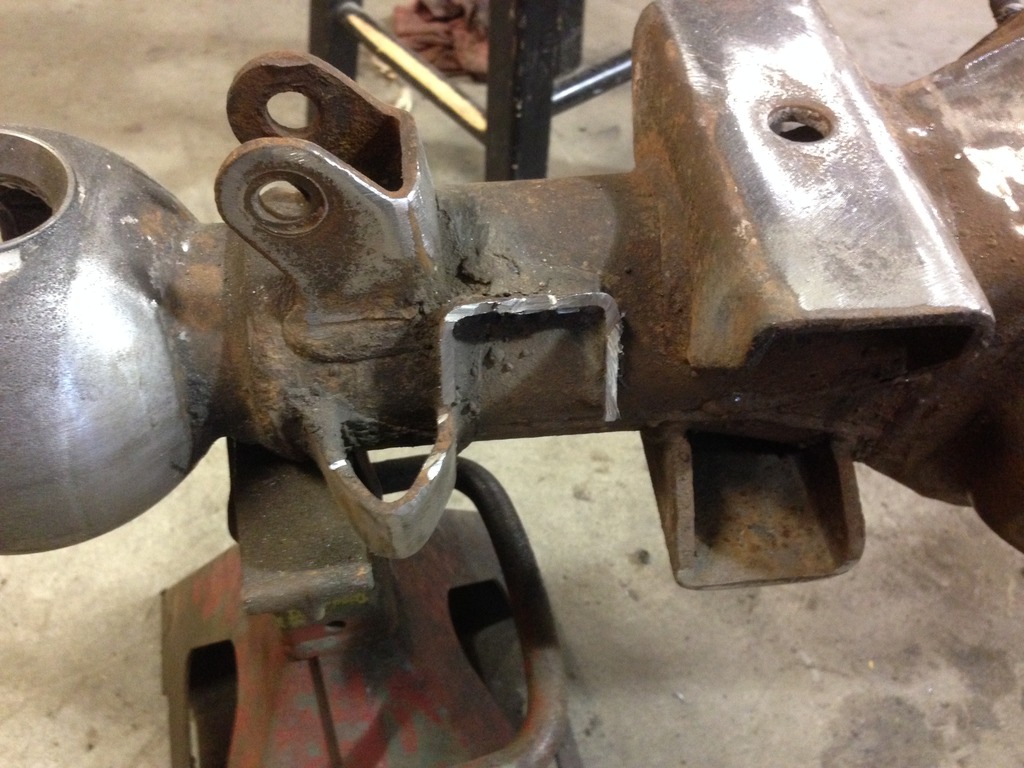

Off and on the ground for some good cleaning. I decided to take Terry's advice and use some Oven cleaner on the parts. It is soaking as I type.

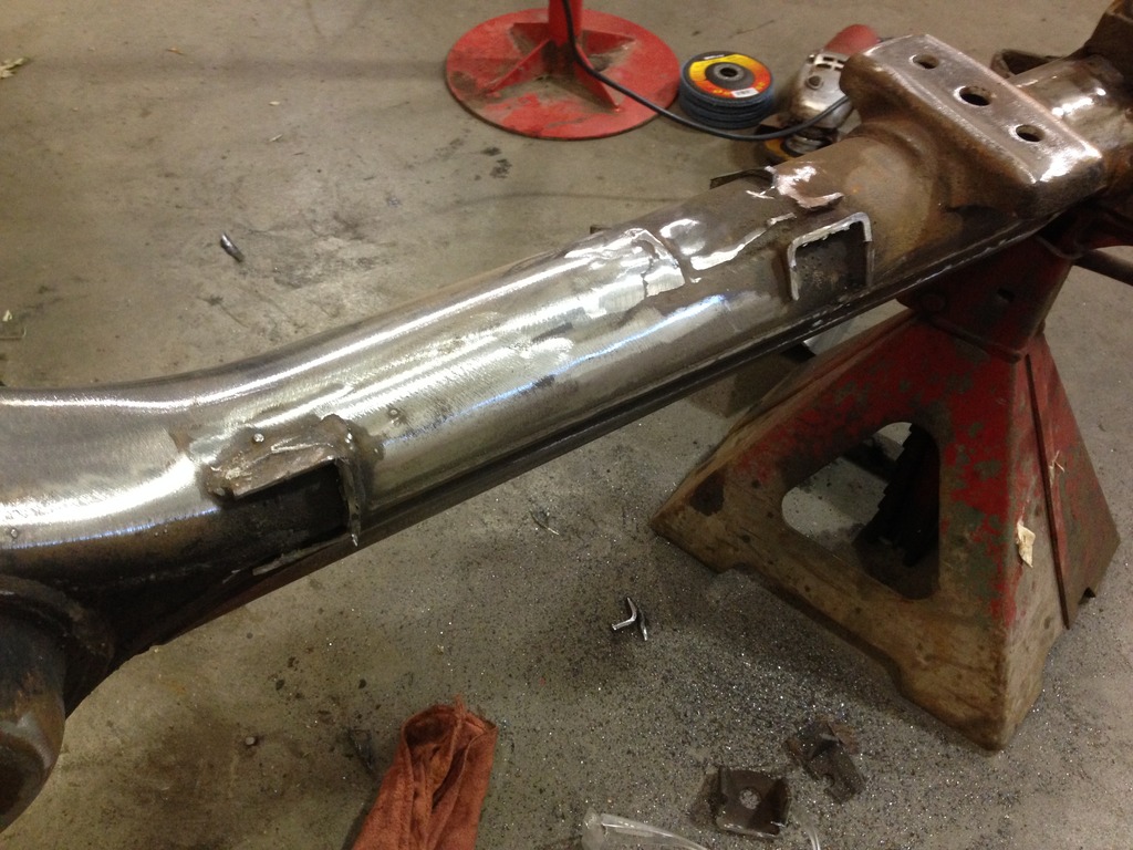

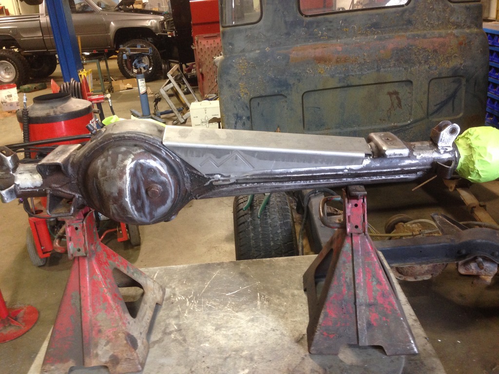

So hopefully the High Steer will be here next week. I also picked up an Axle gusset while I was online. I figured, I may as well put it on now while its apart.
I just need to figure out what I am going to do with the springs in the meantime. I absolutely hate putting old beat up parts back on!! Drives me crazy.
Also thought about adding a leaf to the front to give them some arch to keep from sagging while I am waiting to buy the replacements.
Thanks for looking guys.
Ill update with more pics and info as I go.

Cool man. I'm sure you know about the potential for warping your axle housing when welding on it. Or so I've read. Be careful.

Roger that buddy!

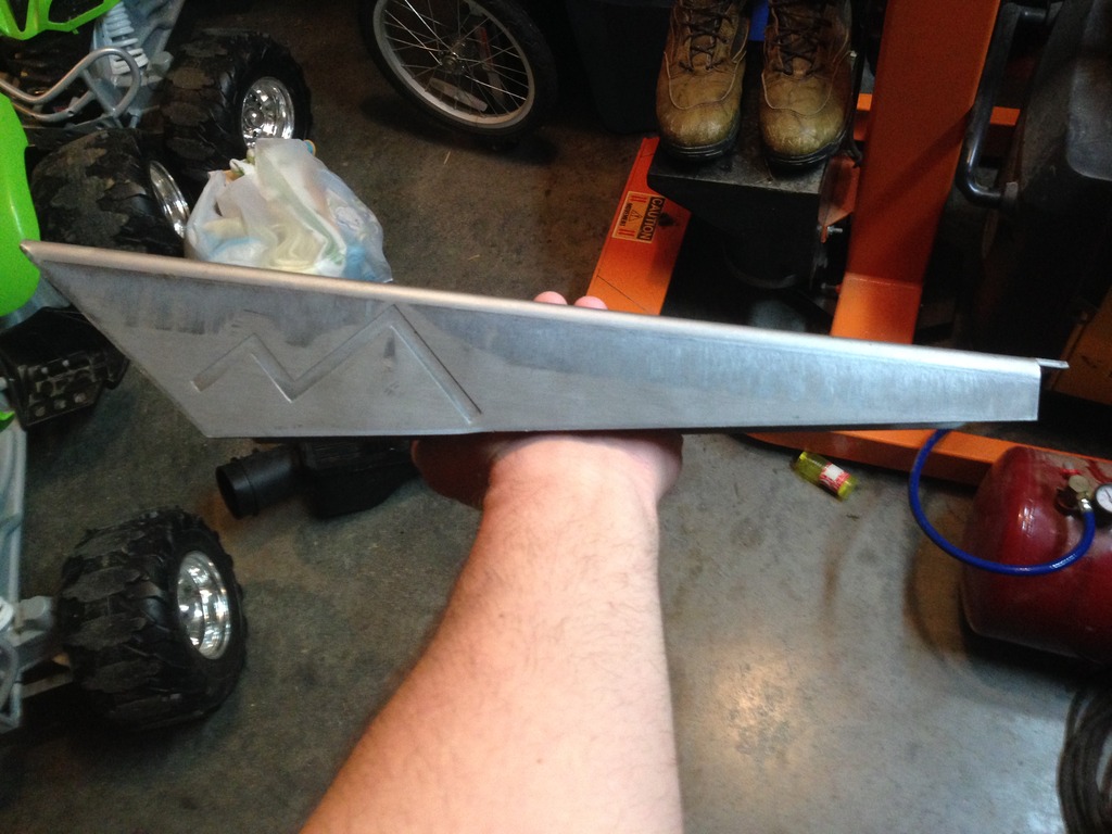

Gusset came today in the mail!!

Nice work on the front axel! I want to get an axel truss too....someday, lol.

Thanks Ed! I figured while I have everything out, I may as well do it. I know that I wanted one, so I bit the bullet.

Thanks Terry.
The easy off worked great. I also used the Rust converter to coat some of the surface rust that would not come off.

So parts started showing up this week, and I am trying to get this axle finished up. Just so much going on lately. Did an engine swap for a former student the last two days also.
But I ended up ordering an OME Front Greaseable pin kit, OME front springs, TG greaseable front Shackles, and a U-bolt Flip Kit.
So far the High steer showed up yesterday. So now I have the IFS Box, Brace kit for the IFS box, and High steer. Everything now is waiting to show.
Im hoping to get the axle back together by the end of the week.
I started to tack in the Gusset just now also.
Also cut off everything I did not need.
Enough talk here are the pics.
