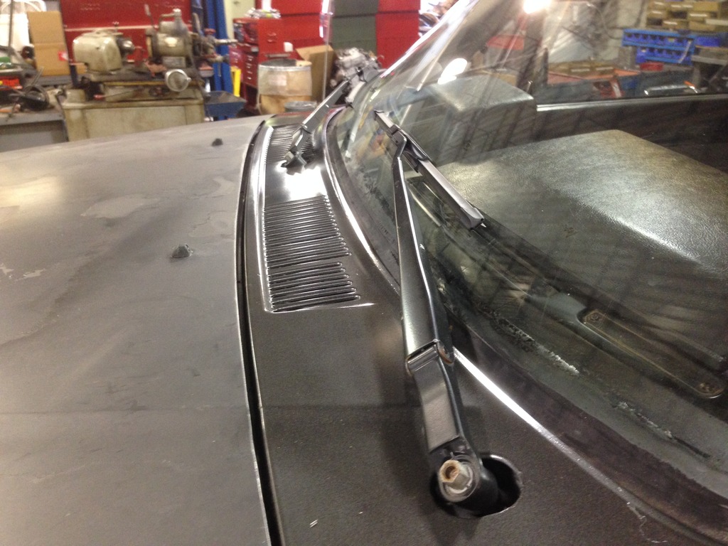

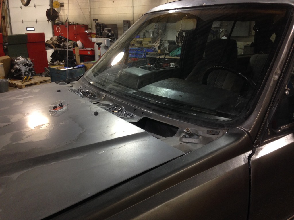

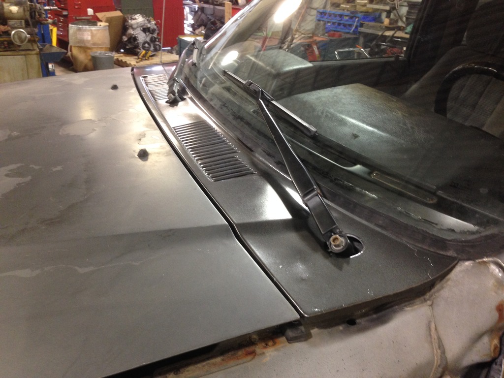

Staying motivated today. Painted the NEw to me wiper cowl for my Runner. I think it turned out pretty good.

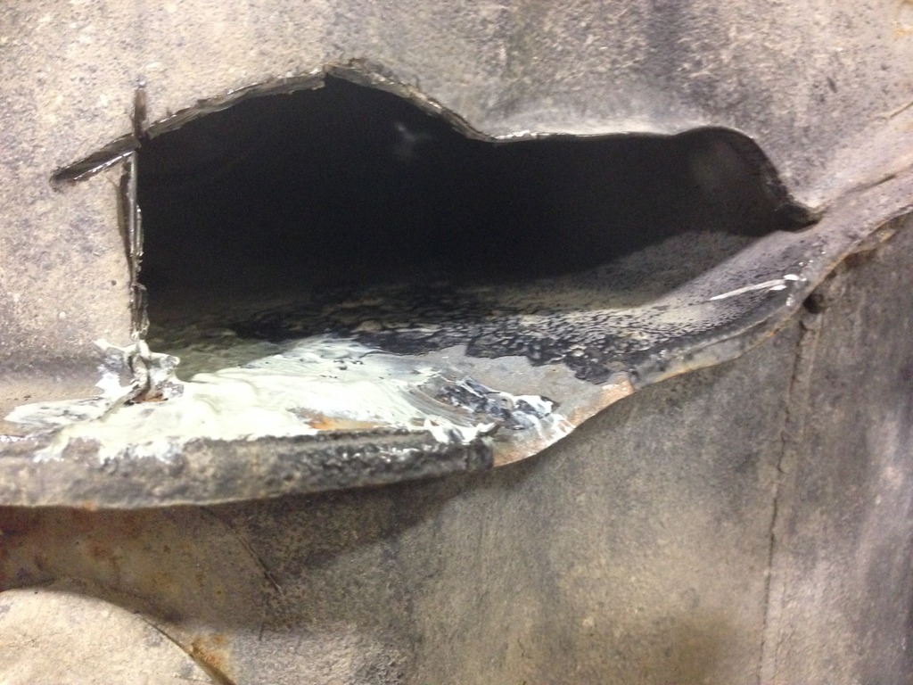

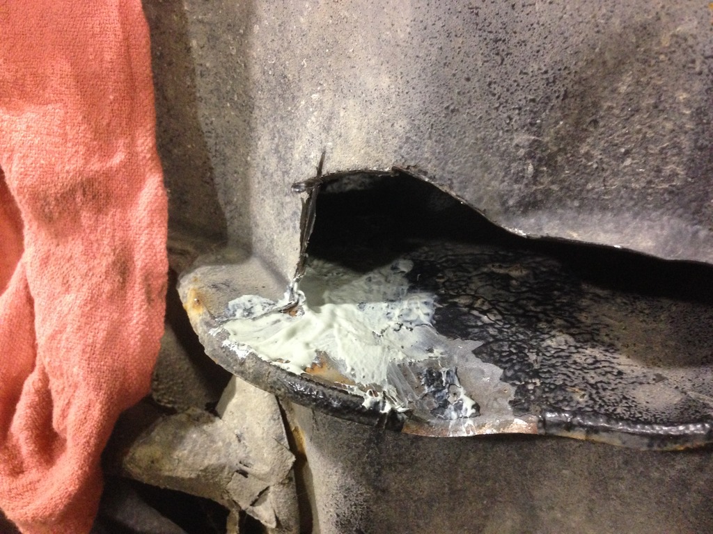

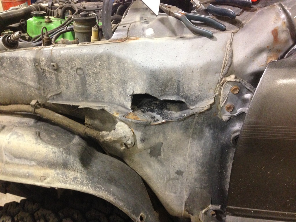

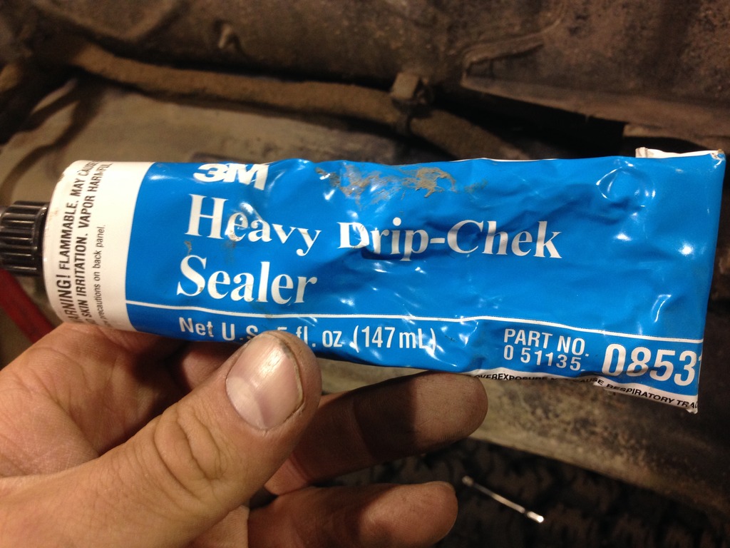

So after painting my wiper cowl and putting it on, I decided to tackle the cab leak once and for all. I had a pretty good idea where it was leaking from but getting to it was the issue.
There is a weird seam under the wiper cowl near the opening thats behind the fender. Its almost three seams together. Its actually right behind the bracket/hinge pocket for the hood arm.
There is no easy way to get to this to clean the rust out and seal it up so the water continues to run out behind the fender rather than leak into the cab.
I ended up having to cut the opening larger so I could scrape out all the rust build up and lay some seam sealer down.
I really hate to cut anything open to make a repair like this, but there was no possible way to effectively get at this area to seal it up.
Here are a few pics.

As you can see. I loaded it up with the sealer that kind of self levels itself in there. I also hammered down on the lip to help the water to get out of there easier. Hopefully.
With this cut, I was able to fully get in there to clean it all up and seal it.
I need to repeat this process on the passenger side.
I believe the main issue with this area is that stuff like leaves, twigs, and other small items get trapped down there not allowing water flow out into behind the fender. So what happens is that over time, the factory sealant that is in there breaks down and then the water takes the path of least resistance into the cab right above the fuse panel on the drivers side, and above the computer on the passenger side.

What you cut out wont hurt anything. I have done the same myself. It does make you cringe a little but sometimes just no way around it. Still better then dealing with wet floors. As soon as I get good at welding, I am going to weld in patch panels to get rid of the cowl just for this reason.

Seems like on these trucks, that would be a good idea.
From what I can see, it does not seem like it would hinder the ventilation system for the interior. I could be wrong but, I think it would still flow fine without sealed up.

nice work on fixing that leak, i have a leak in the exact same spot on the passenger side. i shot 1/4 tube of silicon in there in high-hopes of an easy fix, no good. i'm going to be doing something similar to what you did. thanks for the tip!

About the leak you posted above. Did you treat the bare metal before you sealed it? If you didn't put a POR15 treatment on the bare metal and rust expect to be repairing it again in the near future. Rust never sleeps. Don't want to be a nay sayer but I don't want to see you waste your time. Anyone that owns one of these trucks that sees any road salt or humidity should have a can of POR15 and brushes on hand at all times. Never ever leave metal bare.
And the issue with the rust in those spots are twigs and dirt being trapped as you mentioned, but the damage is done by the vibration of the running truck letting the dirt and debris eat thru the paint to the metal, then holding moisture....you get the picture.

Good idea on the cut out. I have POr-15 and I use it on everything. I was in a hurry and did not put any on there. I will for sure.
