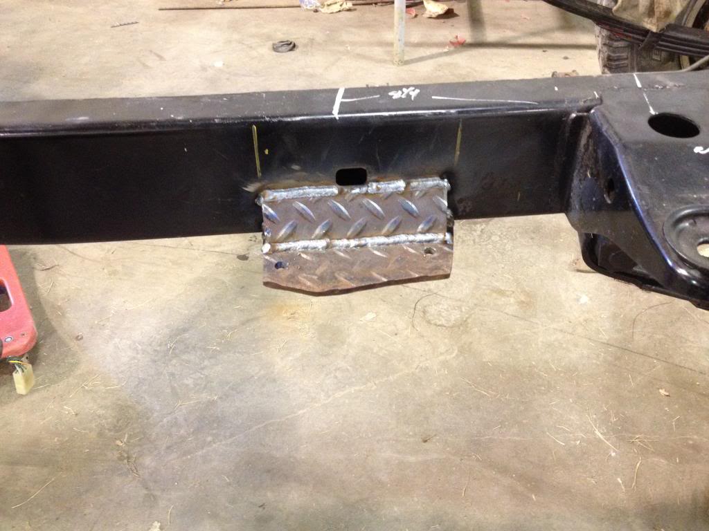

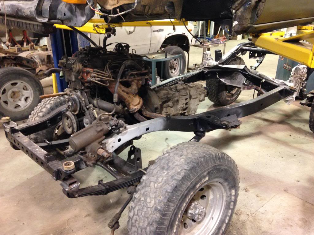

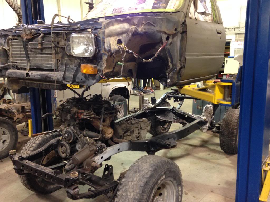

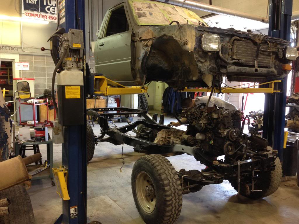

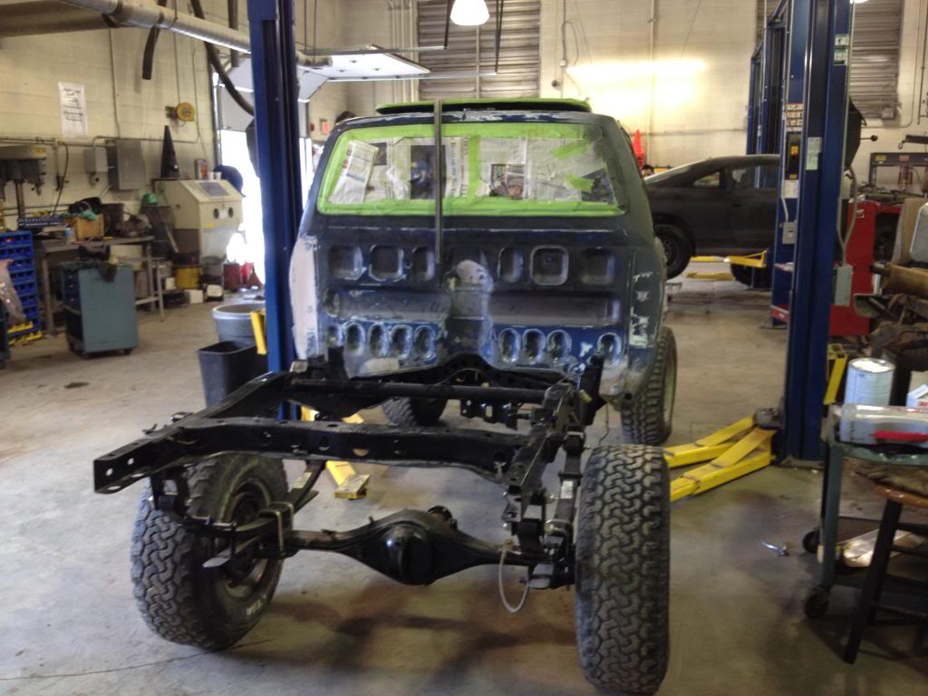

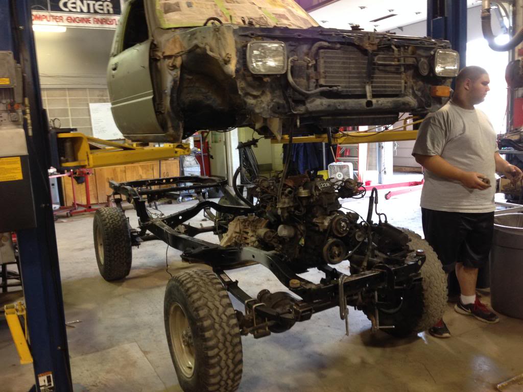

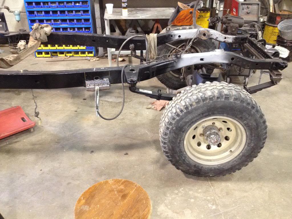

We got a lot done yesterday. Removed the engine and tranny again, to roll the frame over and weld the cross-member support.

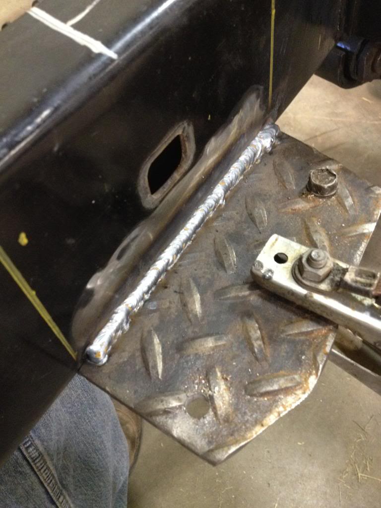

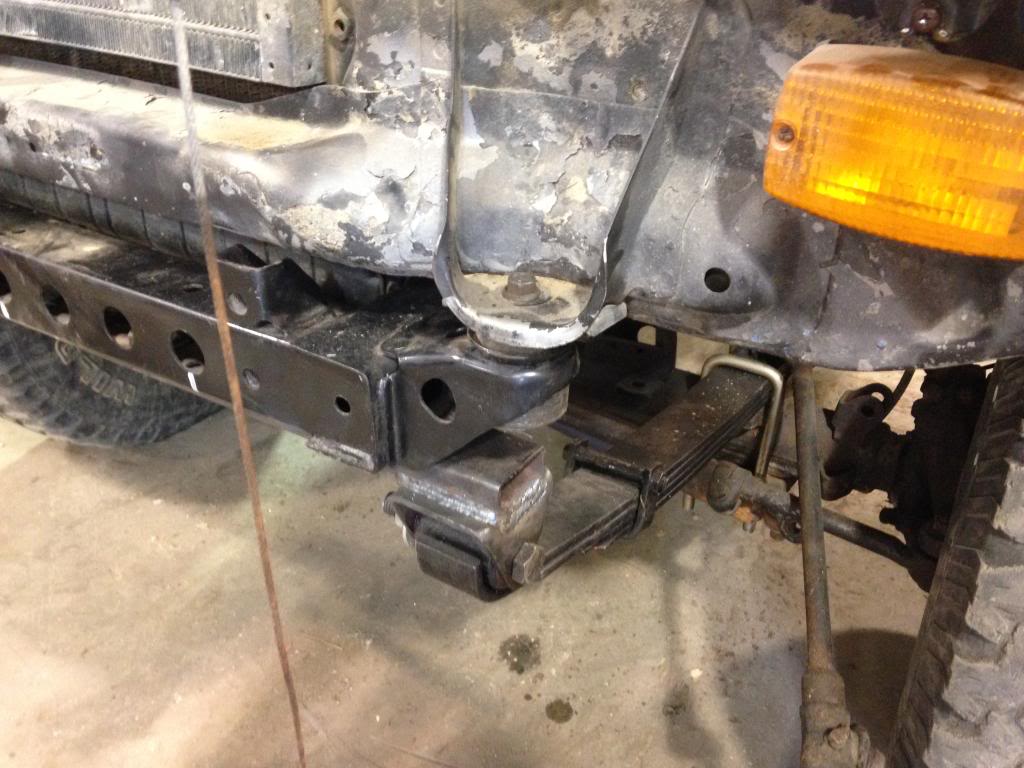

Had some Diamondplate 1/4" steel here at the shop that we use from time to time.
Added a support on top.

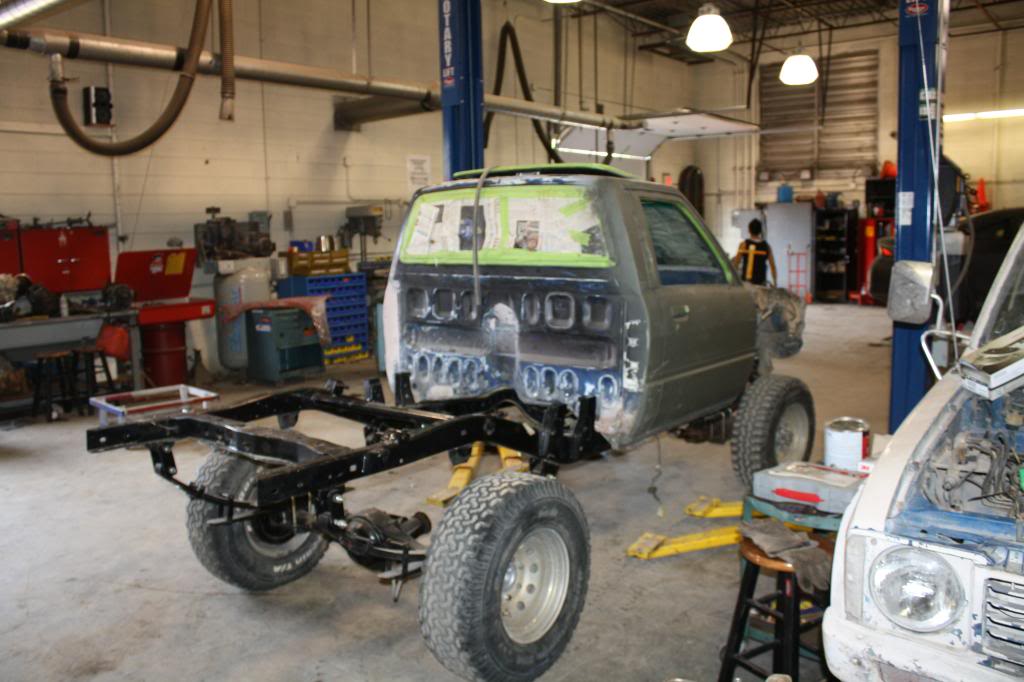

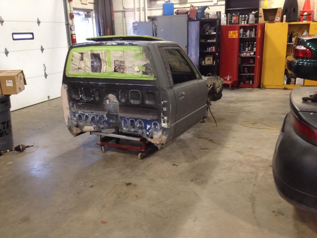

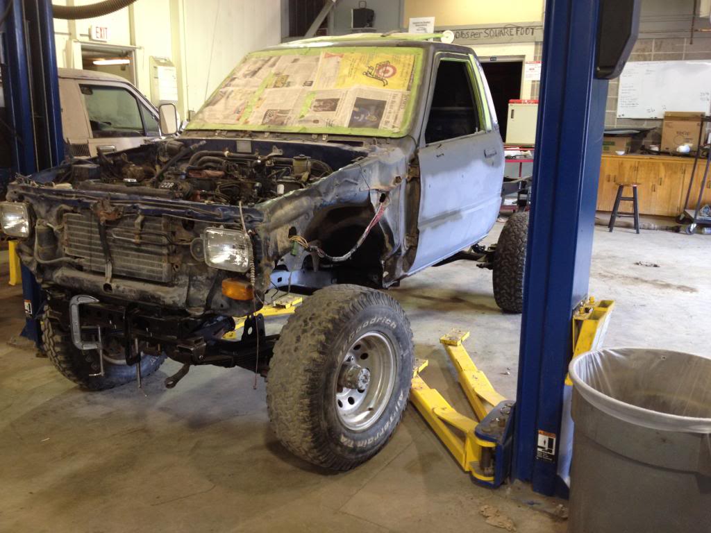

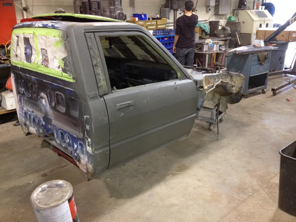

Also got the cab back down on the carts. Trying to finish up some odds and ends with the inside cab floor.

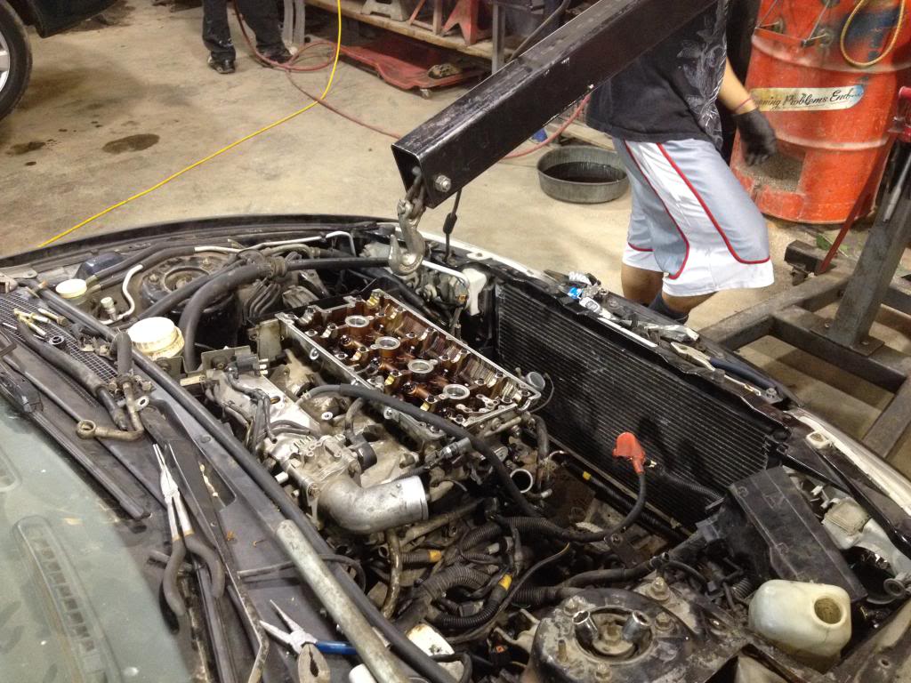

Also doing a little DSM work. Kids are Pulling the engine out of a GSX eclipse. It needs rod bearings, so we are going to do a full rebuild.

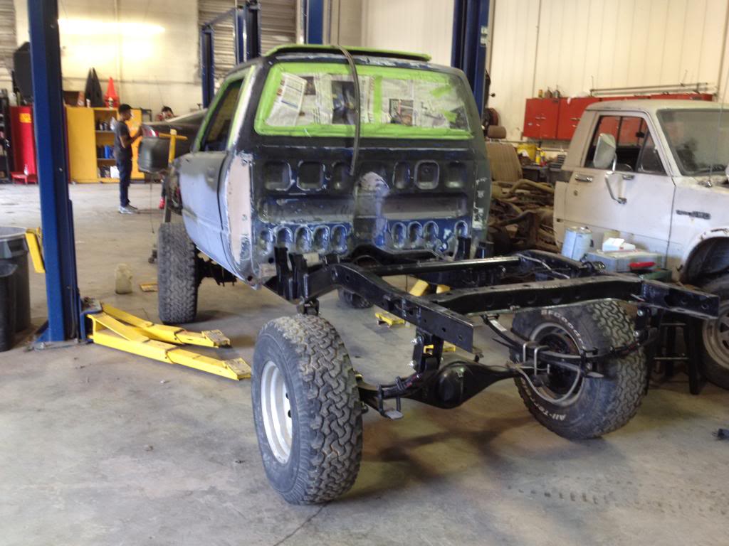

Im hoping to get the cab on today for a test fit and to see where that puts our shackle angle with the weight of the cab on.

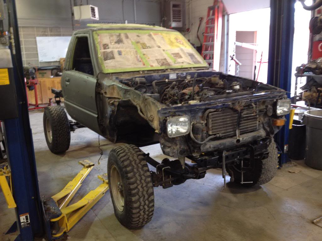

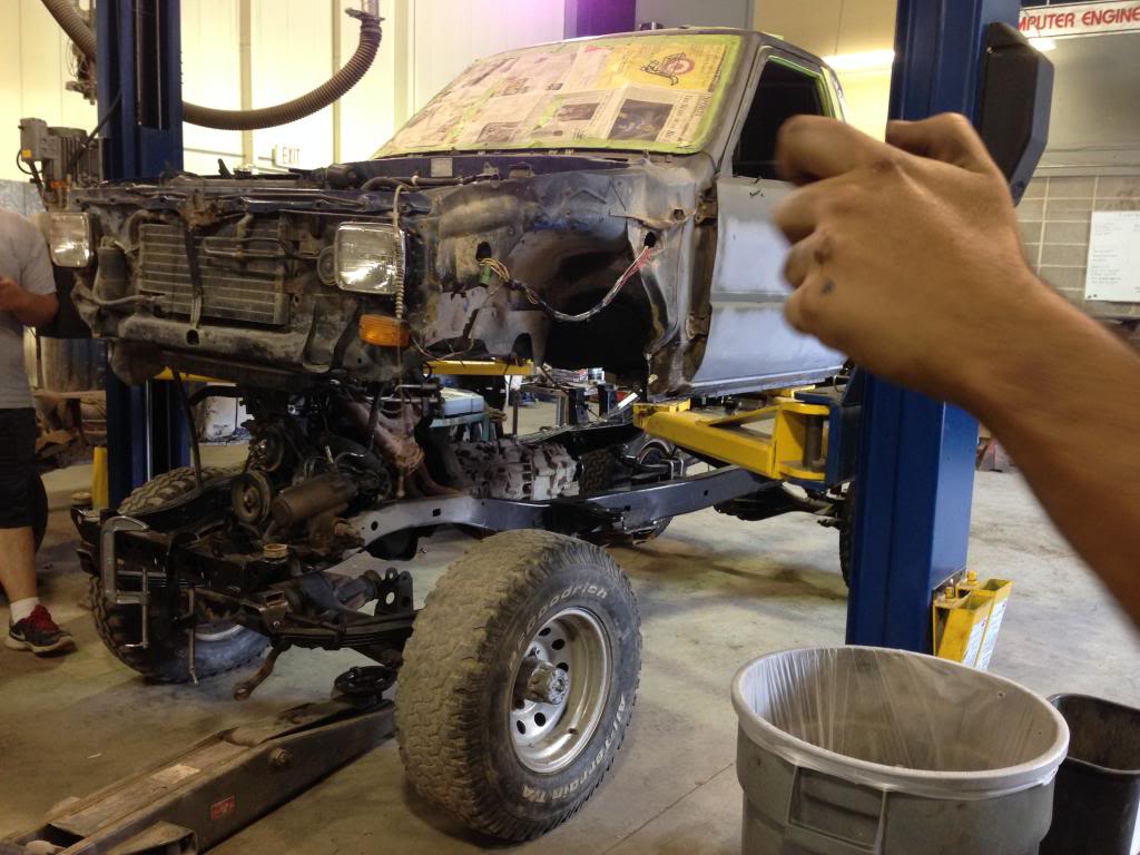

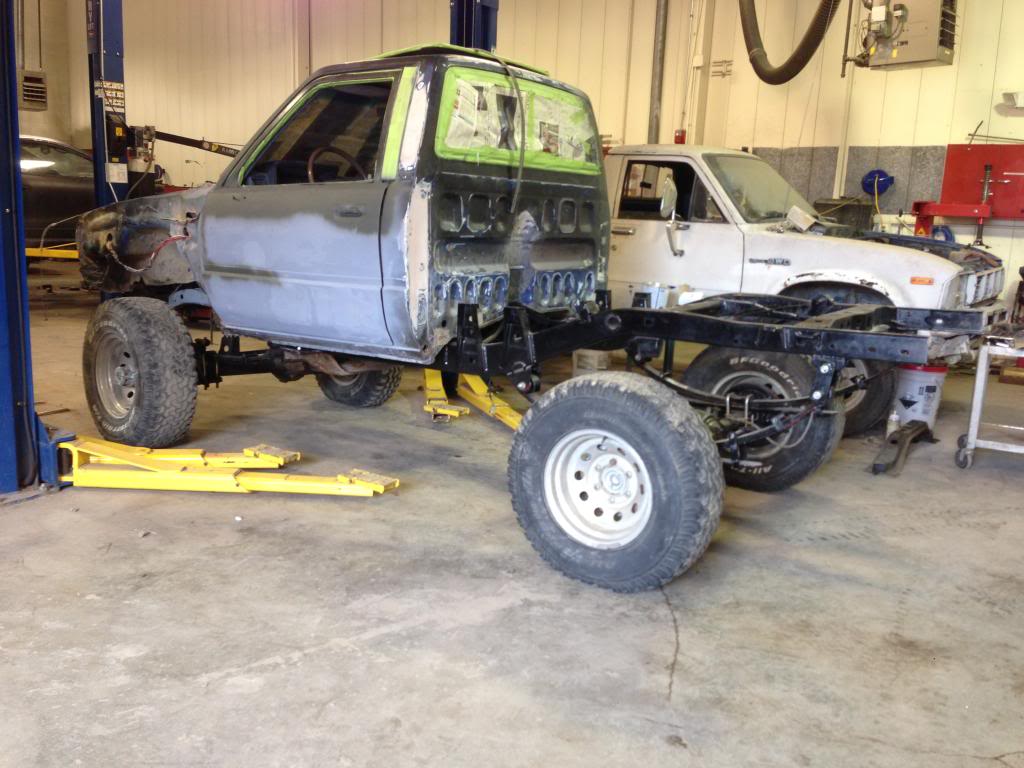

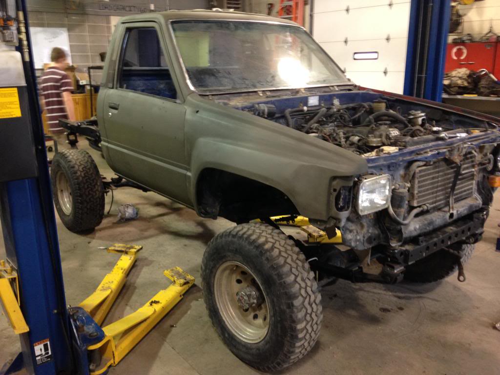

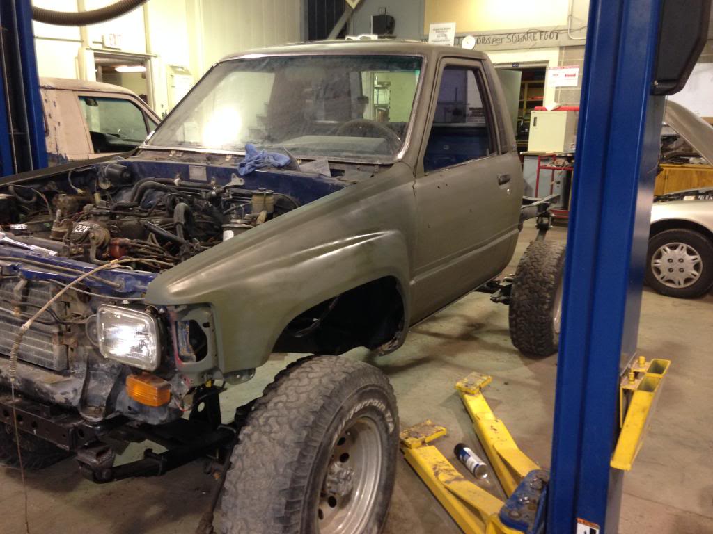

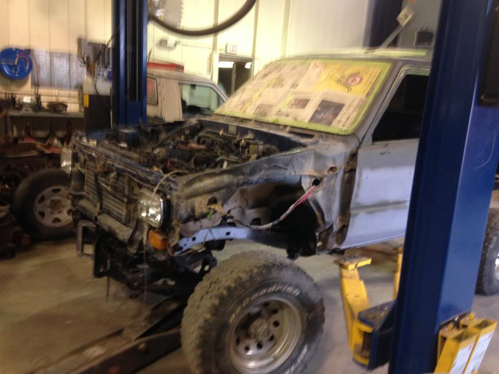

Test fitting the body onto the frame to check shackle angle and see how everything lines up.
Needless to say, the kids are pretty pumped to see it looking like an actual vehicle. We still have a long way to go. Going to try and finish up the interior sections of the floor repair, prime the front fenders, weld in the front spring hanger, etc...

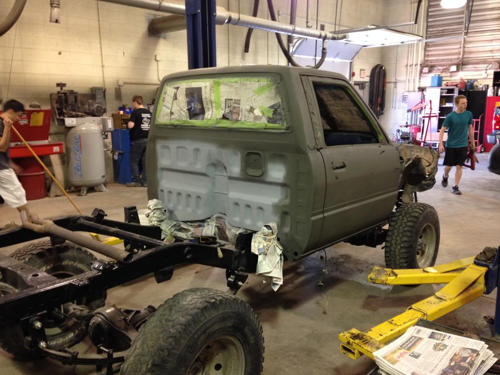

Removed the cab again to finish up things like putting the right bolts in the motor mounts and crossmember mounts.

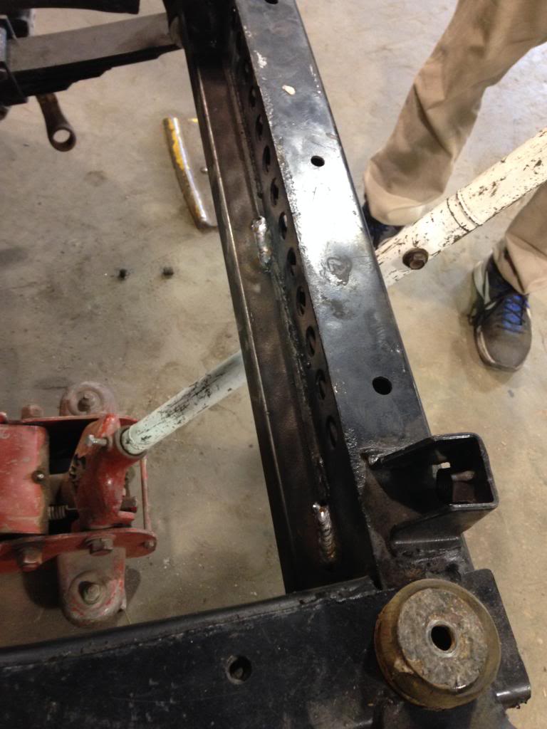

Tacked in the front hanger

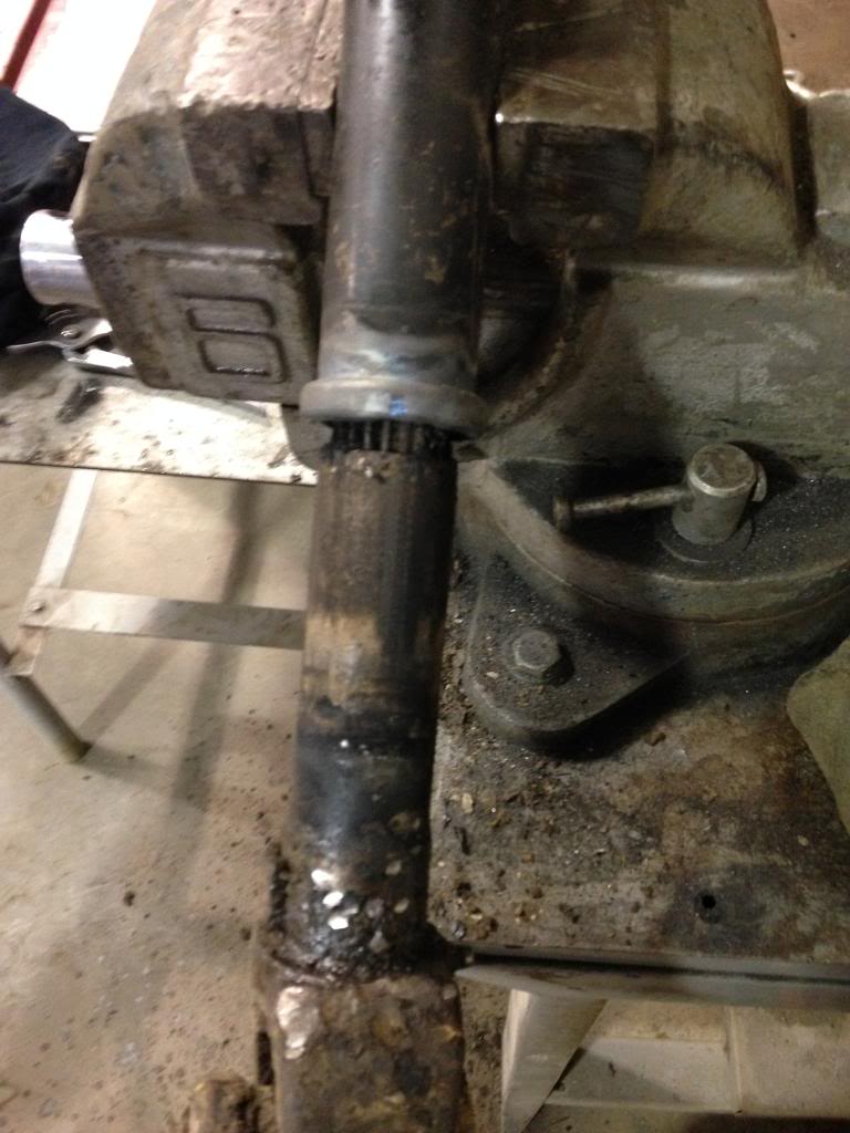

Took a lot of heat and manipulation to get this to break free.

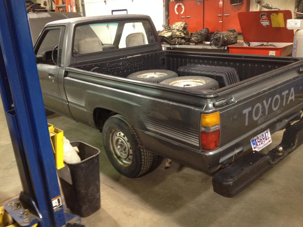

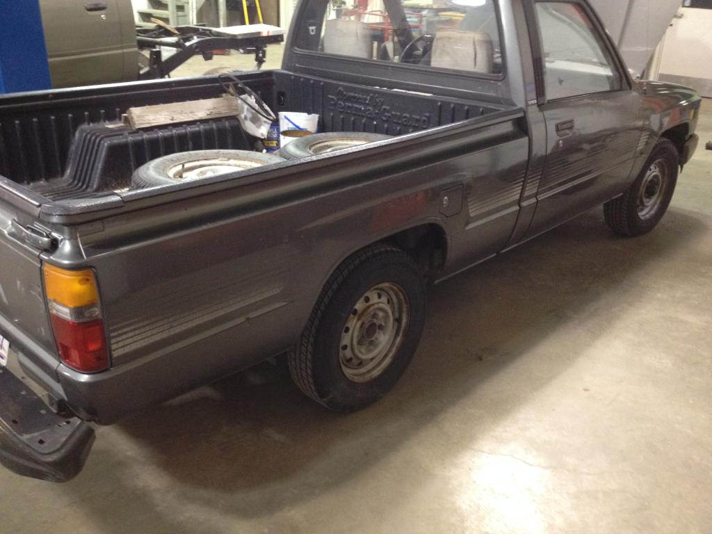

But I picked up a parts truck to supply a lot more stuff that we needed for the build.
Perfect bed
Gas tank
Wiring
Lights
Etc...
