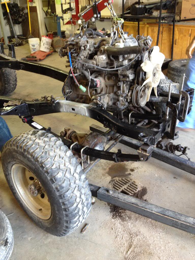

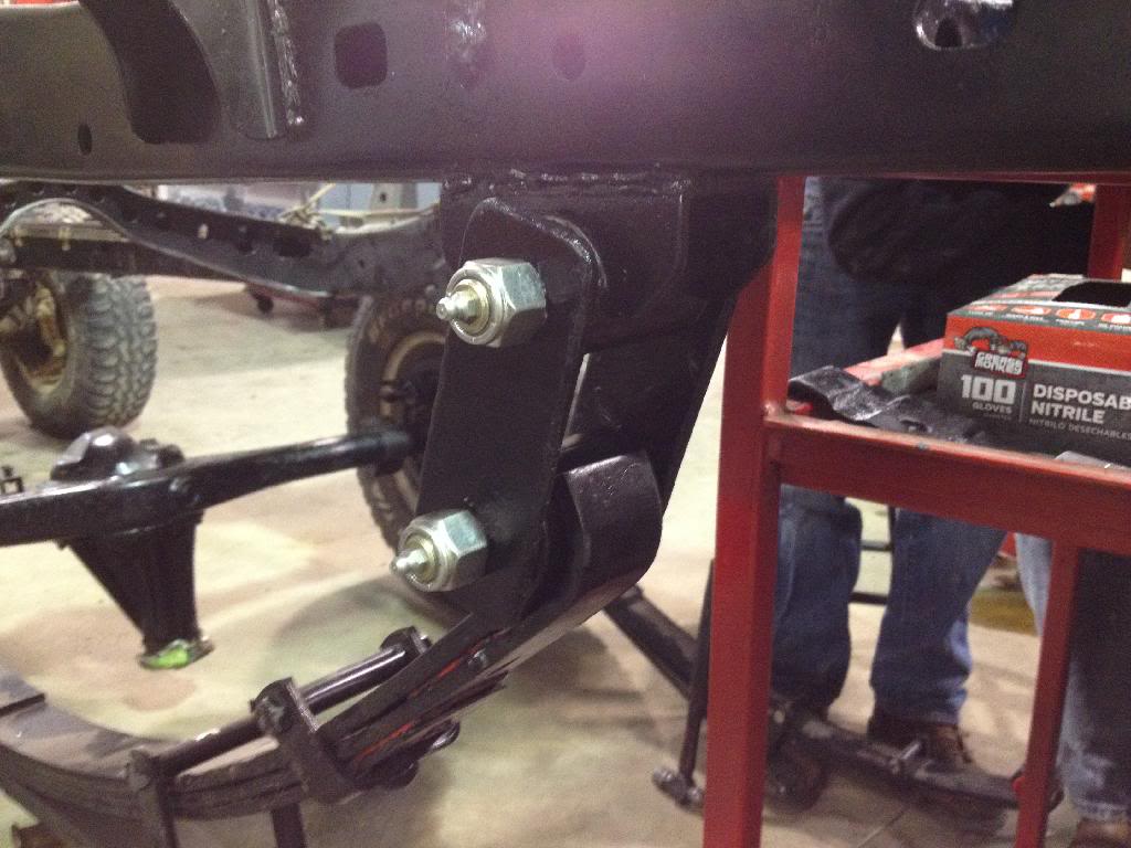

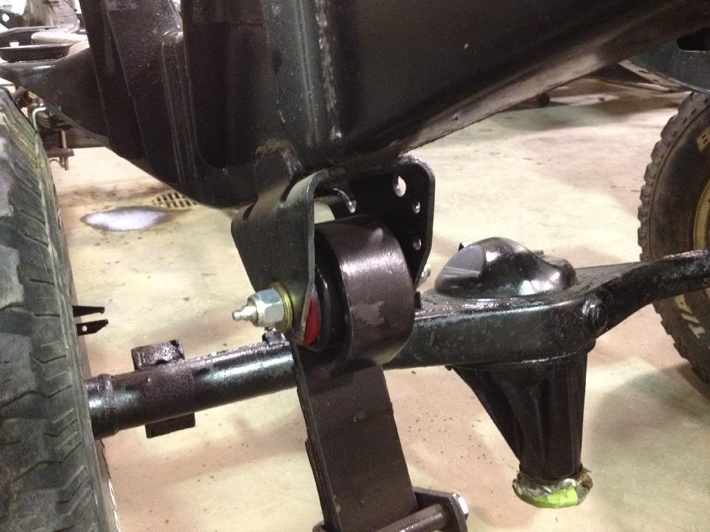

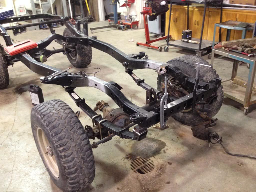

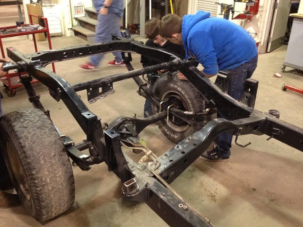

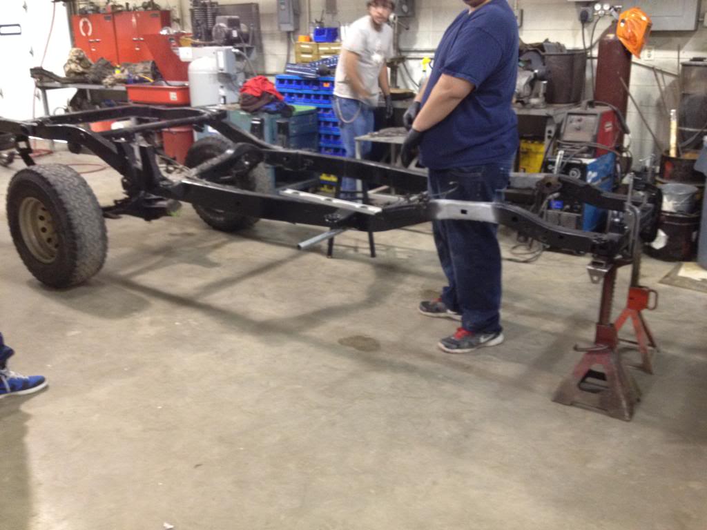

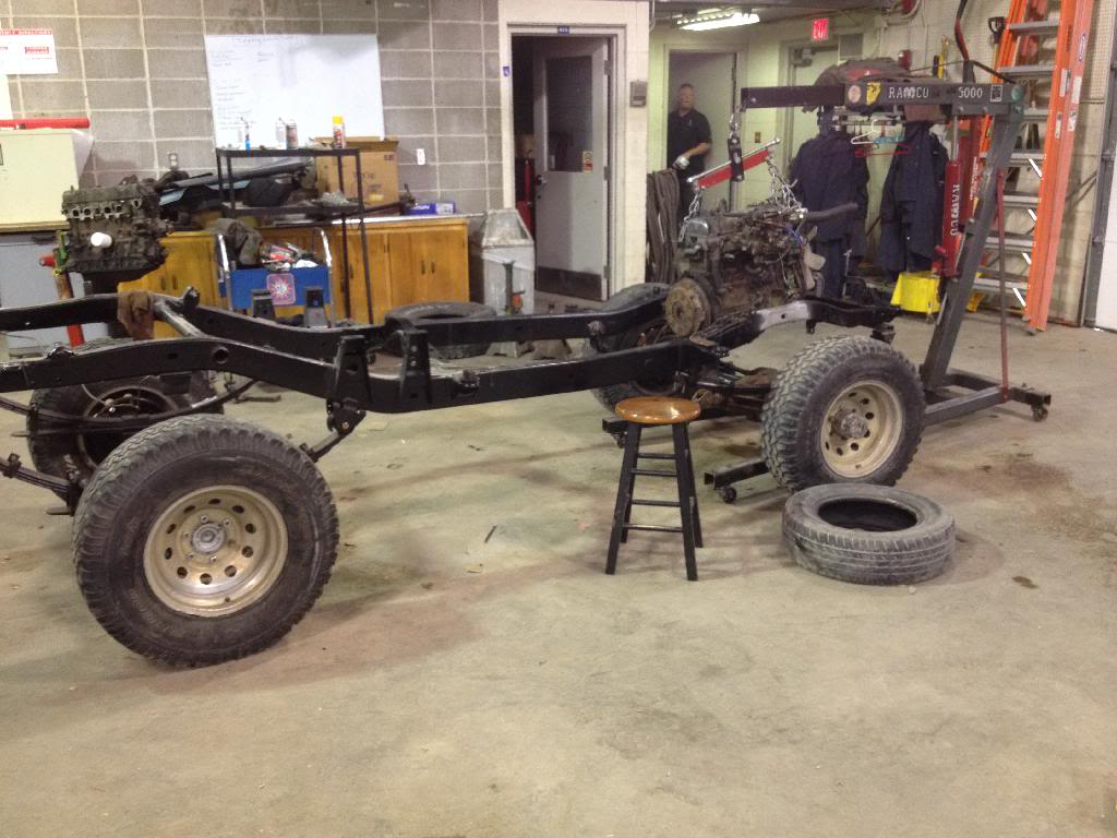

Had the kids out some weight on it with an old engine we had laying around. Trying to get these shackle angles figured out. Still had the wrong angle with the engine set on it. Might try to get everything some to set the cab on it soon.
Still waiting on NWOR shackle and leaf pins to arrive. Been over a week and still nothing.

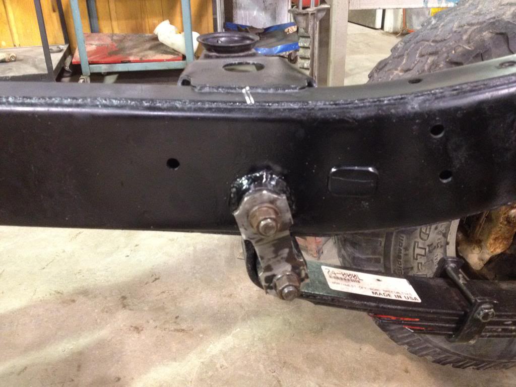

Update 4-30-14
NWOR Pins came in last night!!
Heres a few teaser pics.

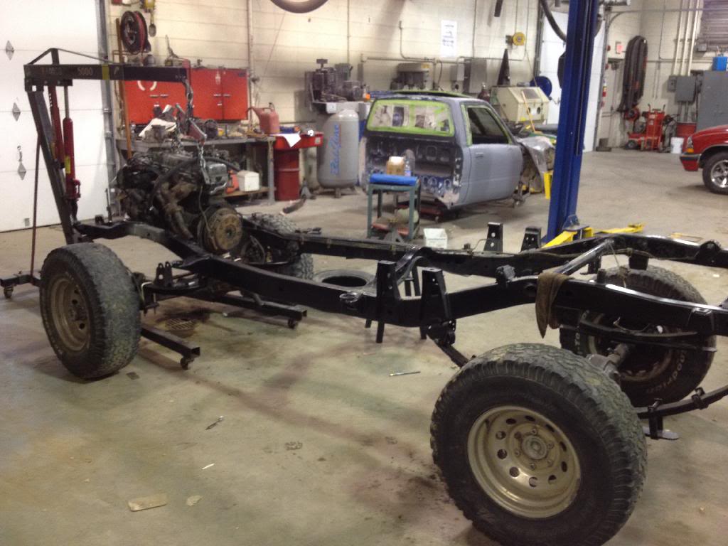

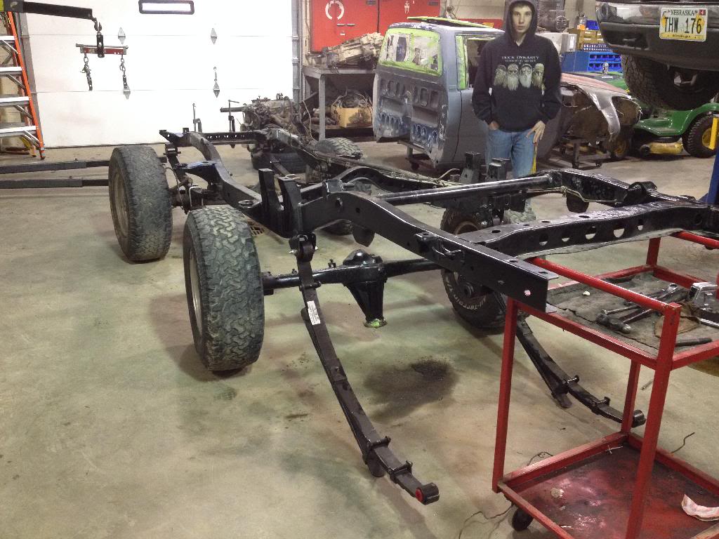

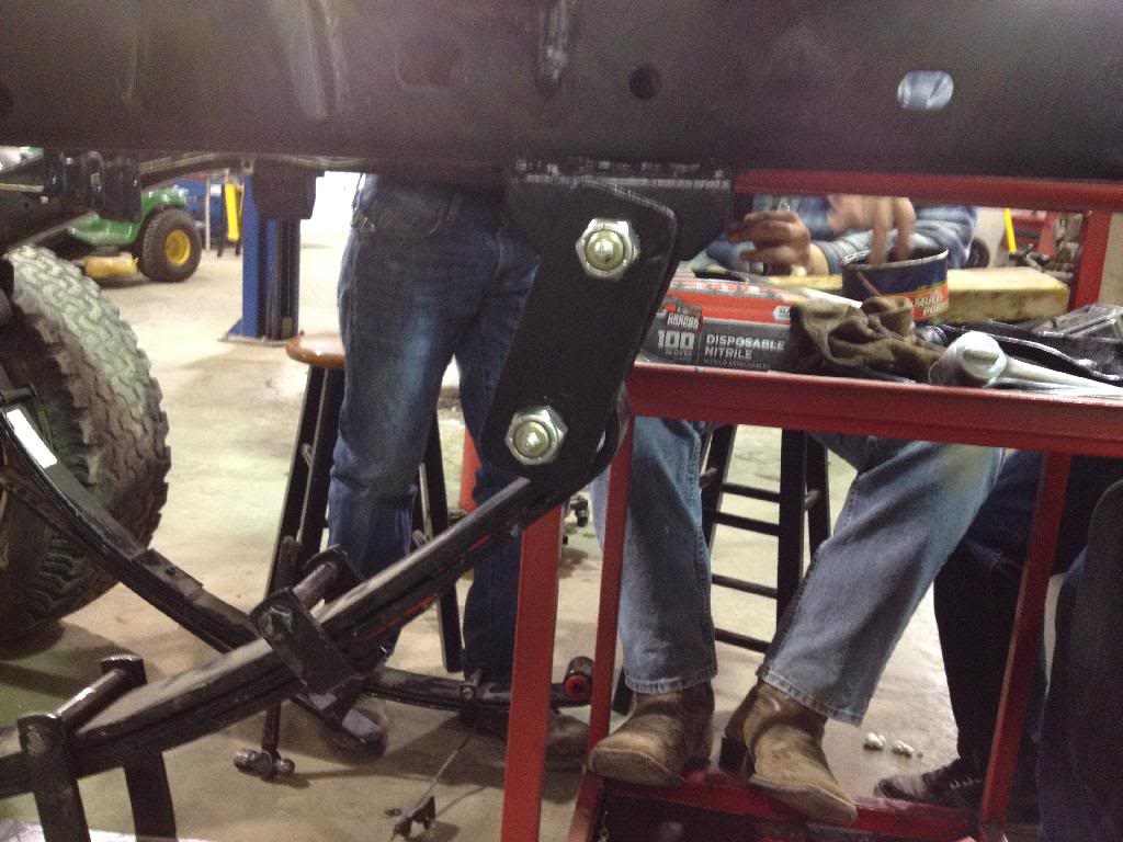

Update #2 4-30-14

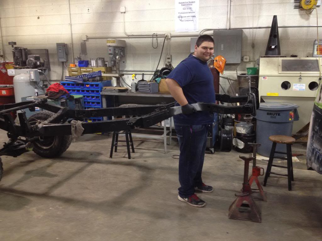

After we buttoned the rear axle up, we disassembled the front again to weld the tubes. It was funny because the kids didn't realize how many times you will assemble, disassemble, and do it all over again.
We got it all taken apart and moved over to where the 220 Miller is.
One of them decided he wanted to get a quick workout in. Nothing like some frame shrugs.

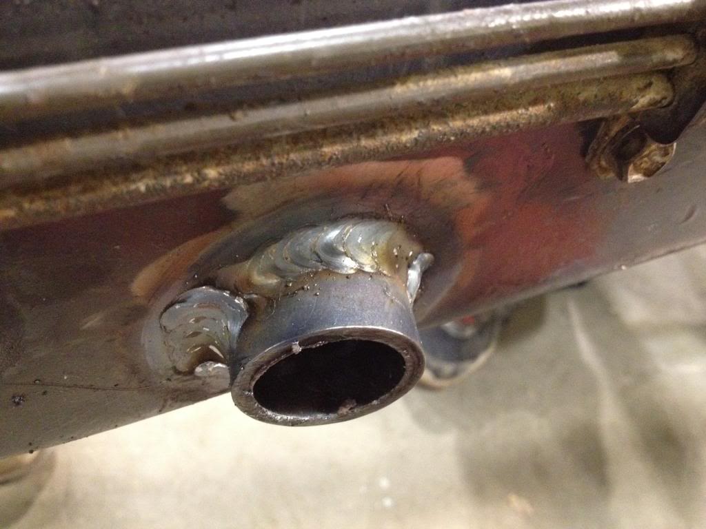

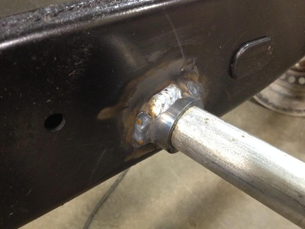

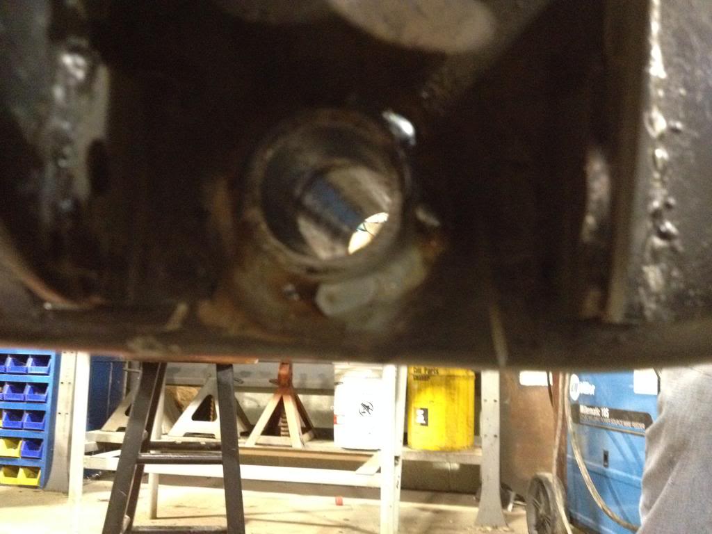

Got the tubes burned in. Set the miller pretty high to make sure I had good solid penetration.
Picture is not great on this one. But man was it ever hard to weld the outside with the body mount in the way. Especially with the larger miller MIG gun.
All done and painted with the front springs back on again.
Here it is as I am leaving for the day.
Tomorrow we are going to pull the engine/trans out of the 81 truck and set it in the frame to see where we have to make out Transfercase/tranny mount on the frame. We are going to make it out of the 1/4" plate that we have.
Also going threw a list of things together that need to be done as well
Rear brake lines
Rear harness that feeds the brake lights
Hook up the rear brake valve
Get a 2wd gas tank from u-pull it
Get a shortbed rear Driveshaft
Shocks front and rear
Repair the drivers side cab floor
Finish body work and paint cab
Figure something out with the steering.
We are nearing the end of school for the year and I want to get this up to the point where I can get it to my buddy with just a few minor things to take care of. Like fine tuning the engine, and interior, etc...
Also on another note. There is another student that is going this Saturday to look at a Reg cab 2nd 87 4x4 Toyota. Its so funny how many of them are starting to want these things.
Thanks again for looking guys.

nice welds!!
