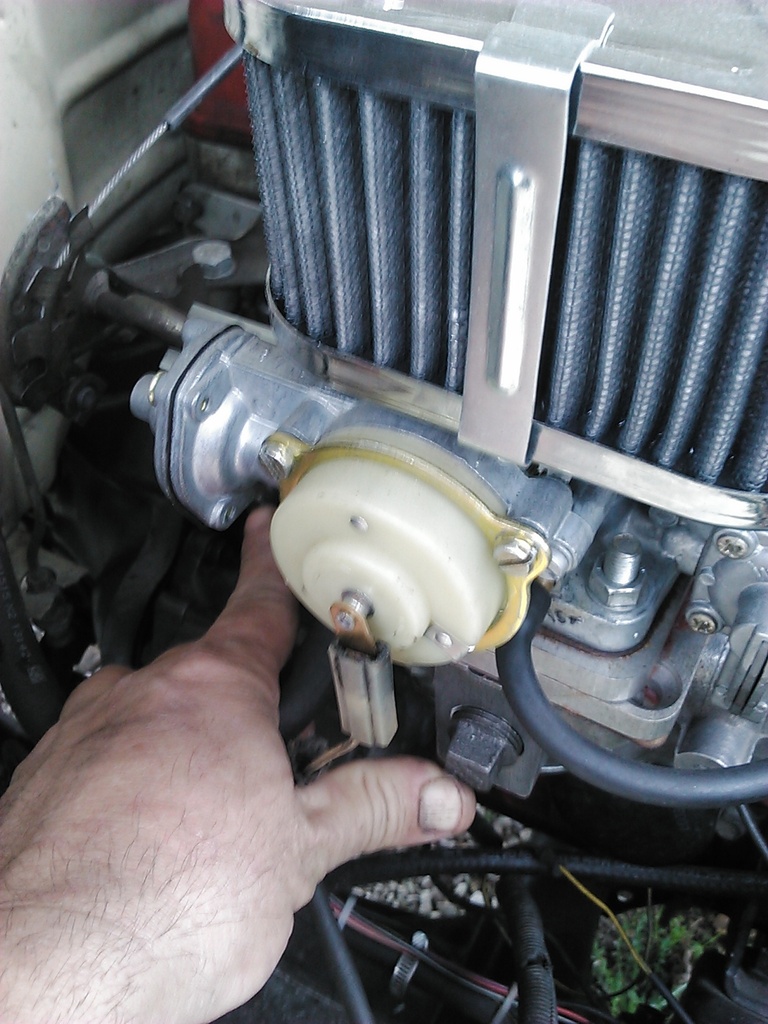

Where my thumb is you can get a metal pipe fitting and remove that big vacuum assembly. I for get the sizes but you can plug the little one off as well.

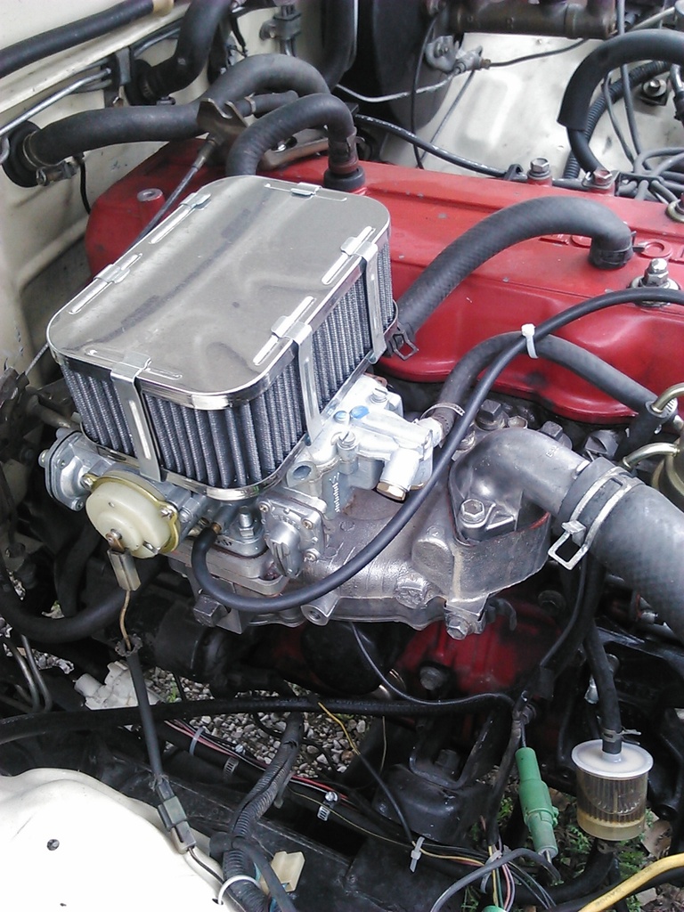

Here is a view of my set up. I moved the fuel filter to the front of the motor instead at the tank. Just a couple of vacuum lines and one hot wire for the choke,

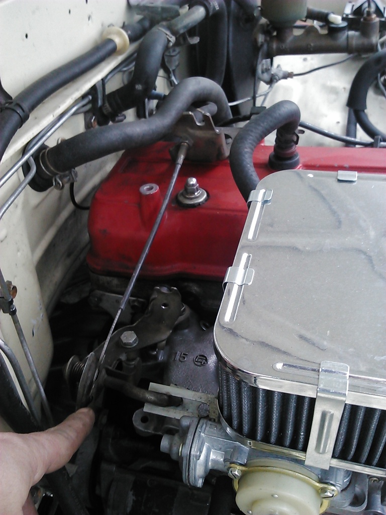

Make sure you get this correct for the throttle cable and ligned up right. I too used to stay away from carb trucks but now I really like them over the EFI trucks. EFI is great but once you get gremilins, you are always chasing something on them. A friend of mine says with some different springs in the distributor and a header and you would be shocked at how much power these 22rs can put out.

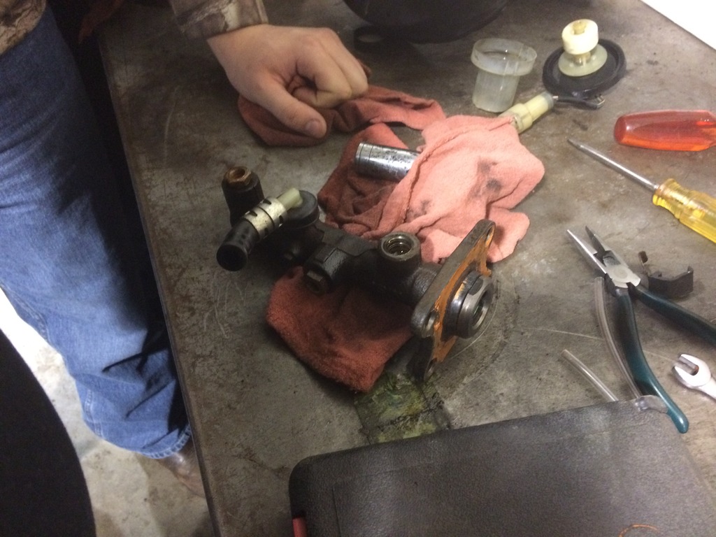

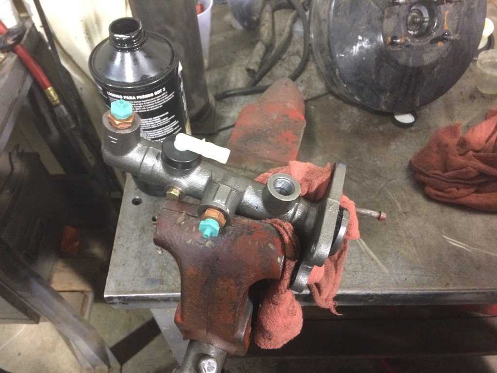

Had to replace a Nasty Master Cylinder and shes was ready for the Road.
