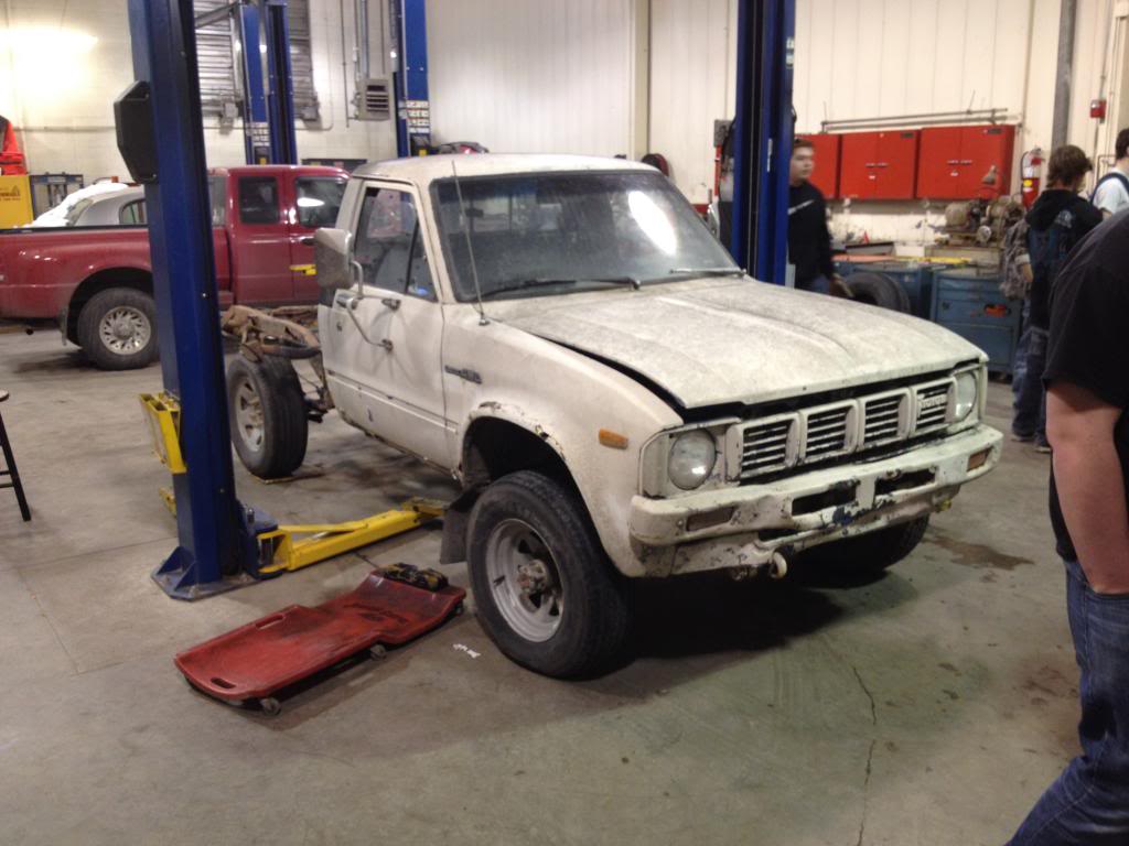

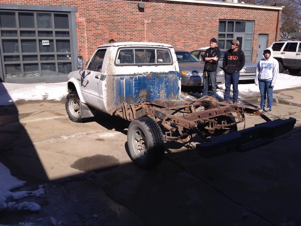

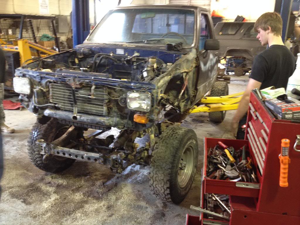

We started the build a few weeks ago by getting the original truck to the school, and tearing into it.
Her she is.

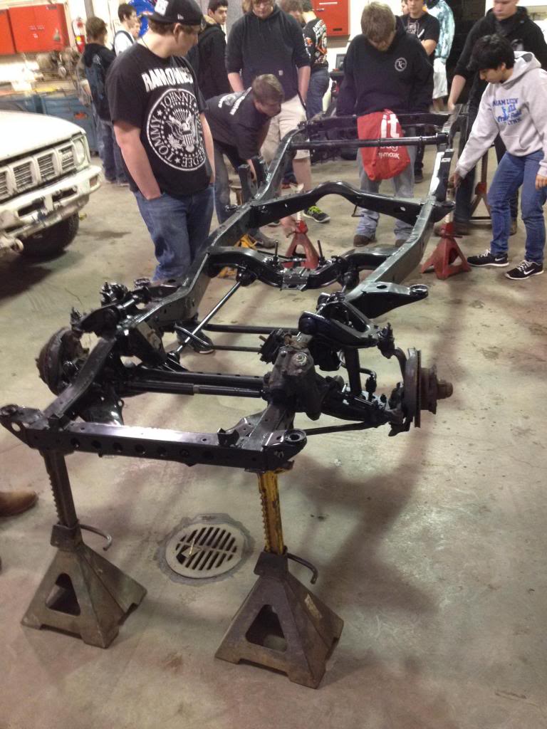

The plan was to find a frame, and swap the cab, and drivetrain over to the frame. Well as fate would have it, the 1st gen cab was pretty roasted just like the frame. All four cab mounts were severely rusted out beyond a reasonable repair.
So I ended up finding a nice 2wd Frame in St. Joe, MO that the owner of the project picked up and brought to me.
Nice frame with no rot or rust anywhere!

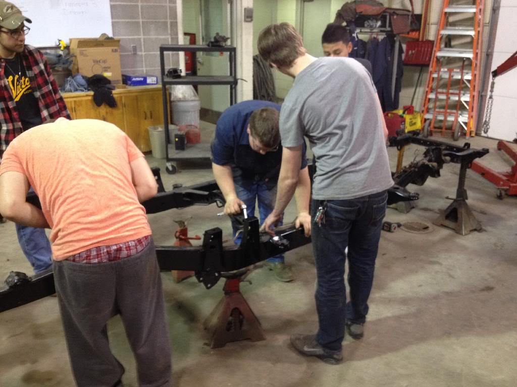

Had all the students help carry it in and quickly get it setup on some stands.

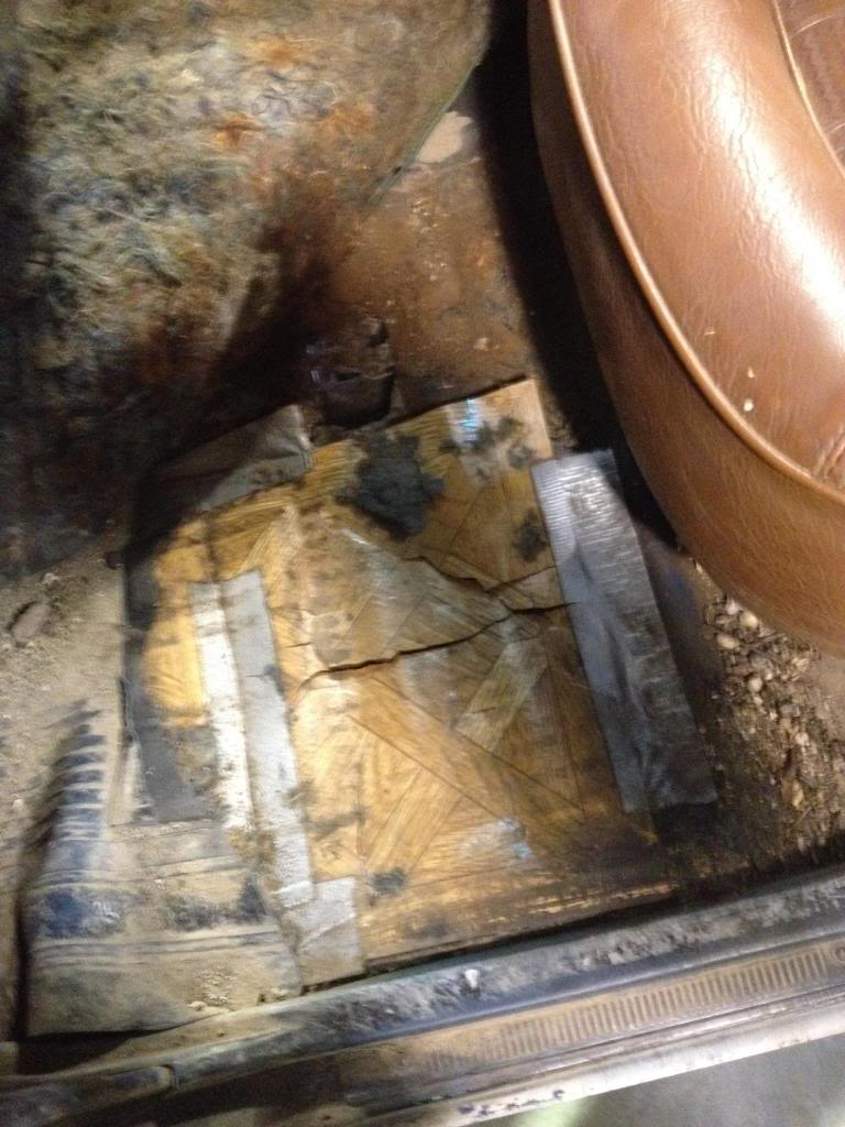

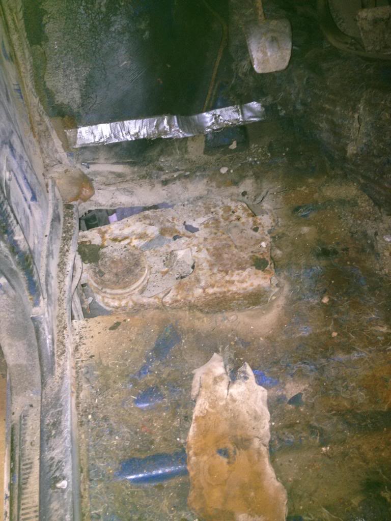

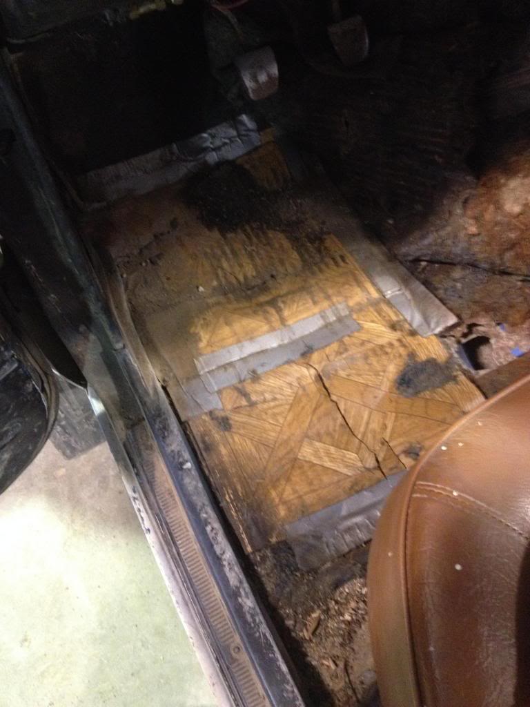

Then we came to find that the floor was worse than we though. But hey It has hardwood floors!!

Kind of a bummer for everyone, as we wanted to see this build with the nostalgic 1st gen cab.

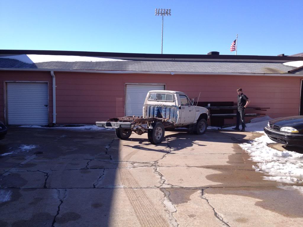

But the hunt was on for a decent 2nd gen body, since they are easier to find than a 1st gen.

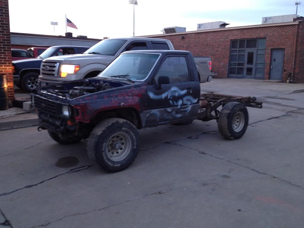

Low and behold, Chris (kornhuskerwizard) has a buddy that was looking to part with a basically complete 84 regular cab pickup.

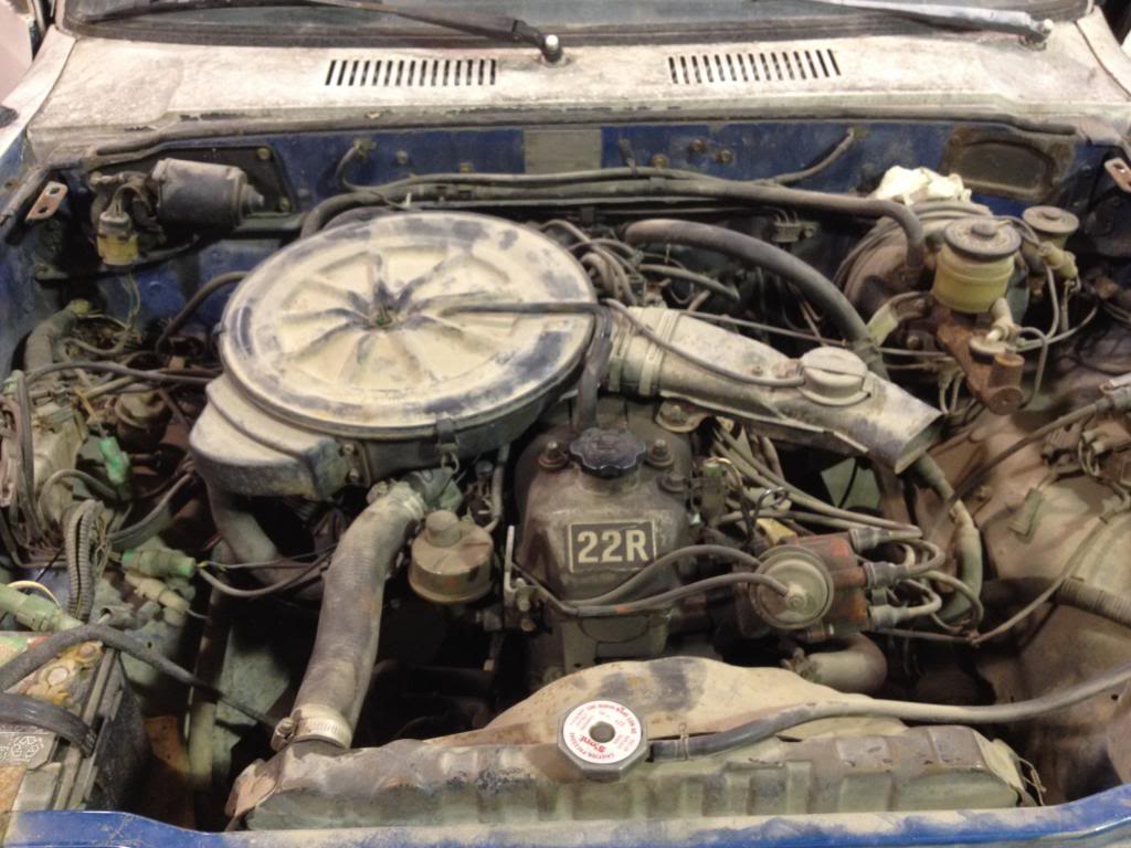

We got the truck this last Sunday 3-9-14, and started to plan a few things out.
Basically a complete truck minus the bed, tranny and transfercase. This truck had a way better cab with a little bit of rot on the drivers floor board. Plus the axles are in way better shape than on the 1st gen.

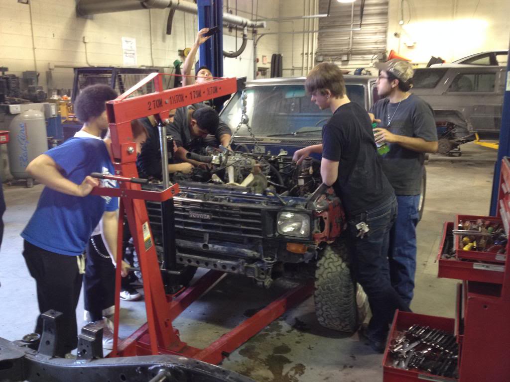

Monday morning:

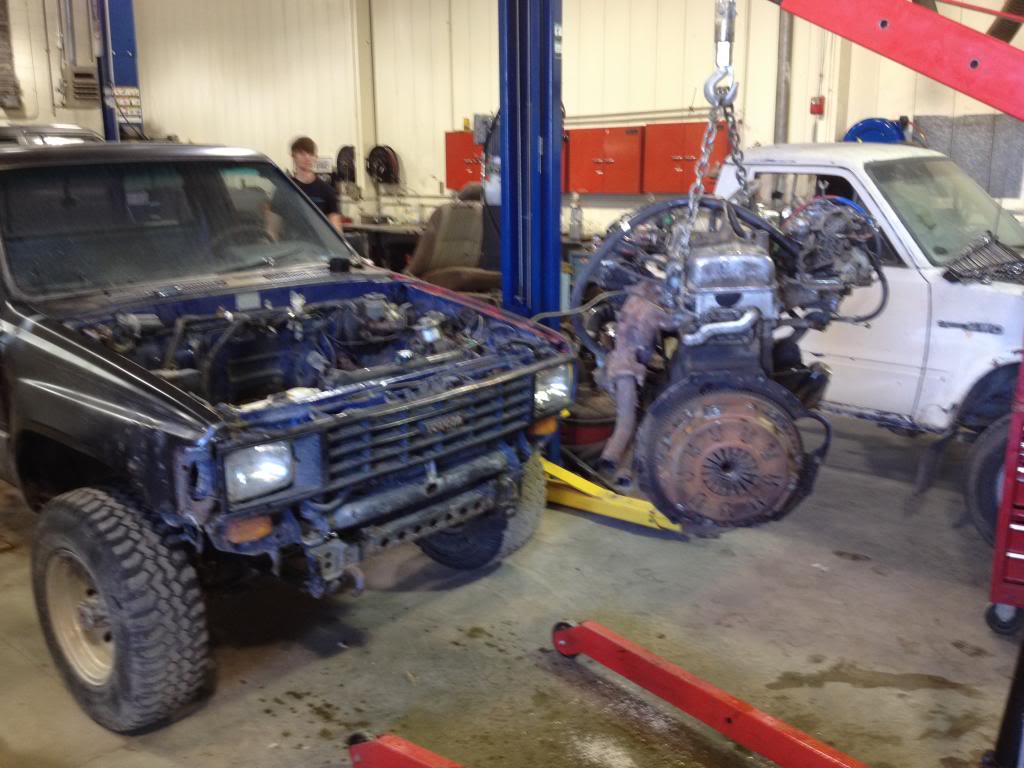

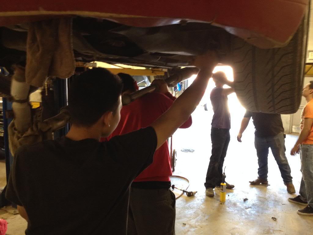

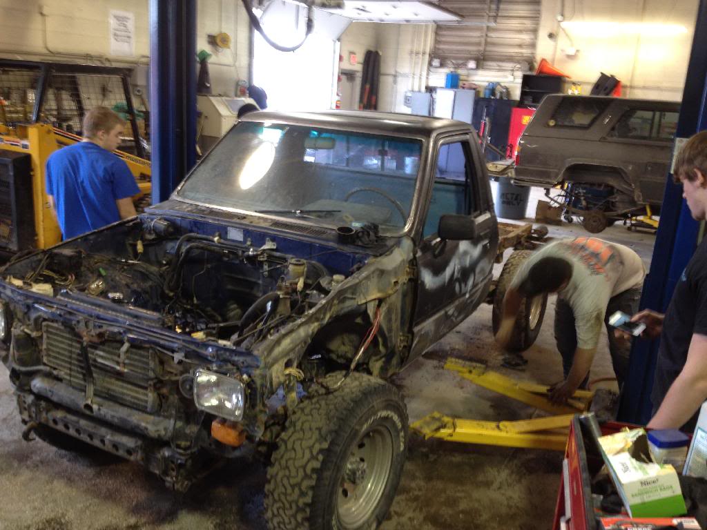

Yanked engine out and started to make progress on getting the cab removed.

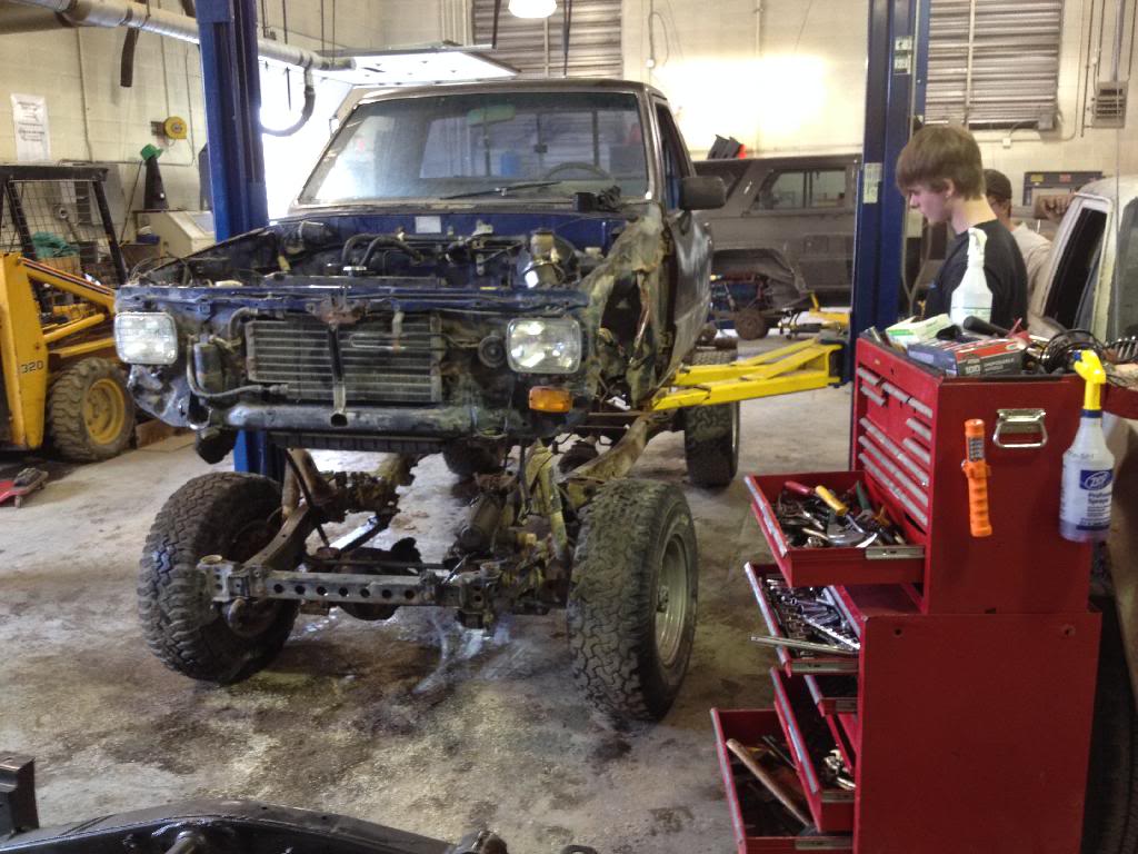

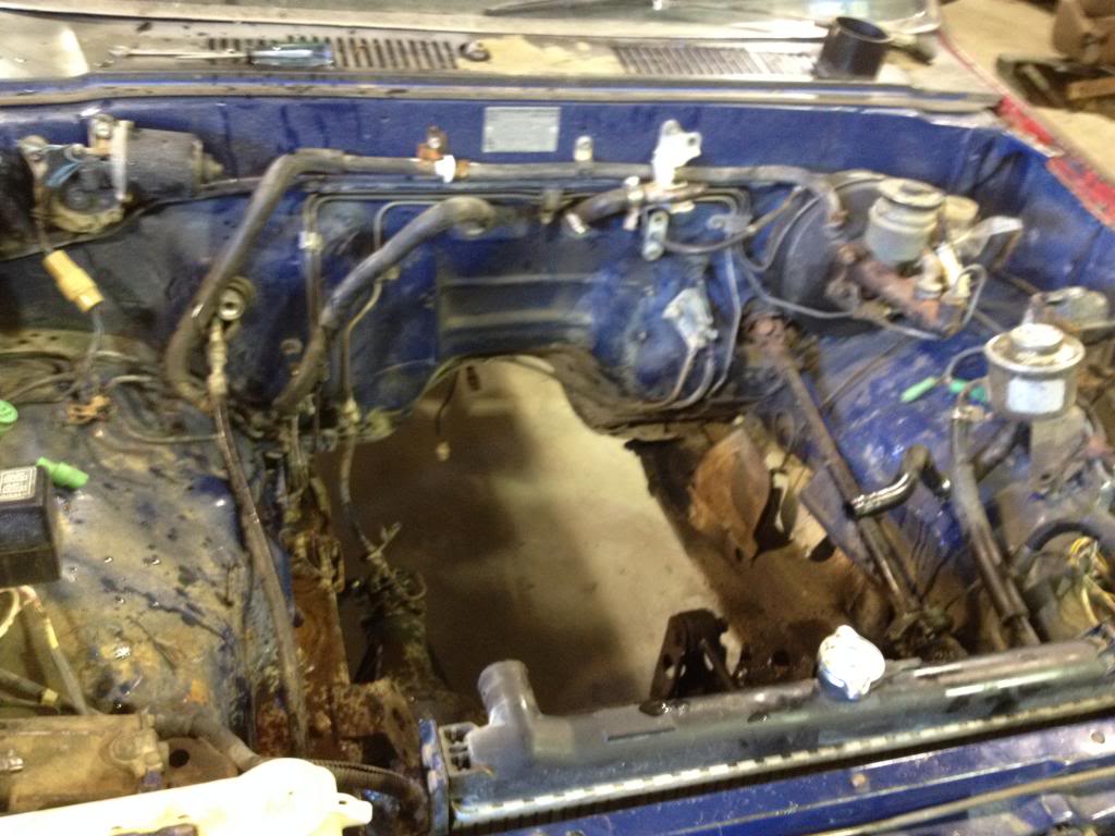

Monday afternoon

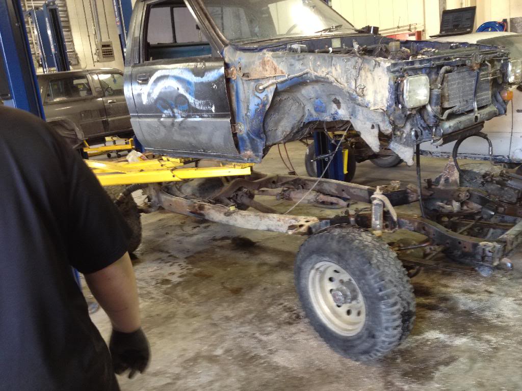

Had all the body mounts out and everything disconnected minus the e-brake cable.

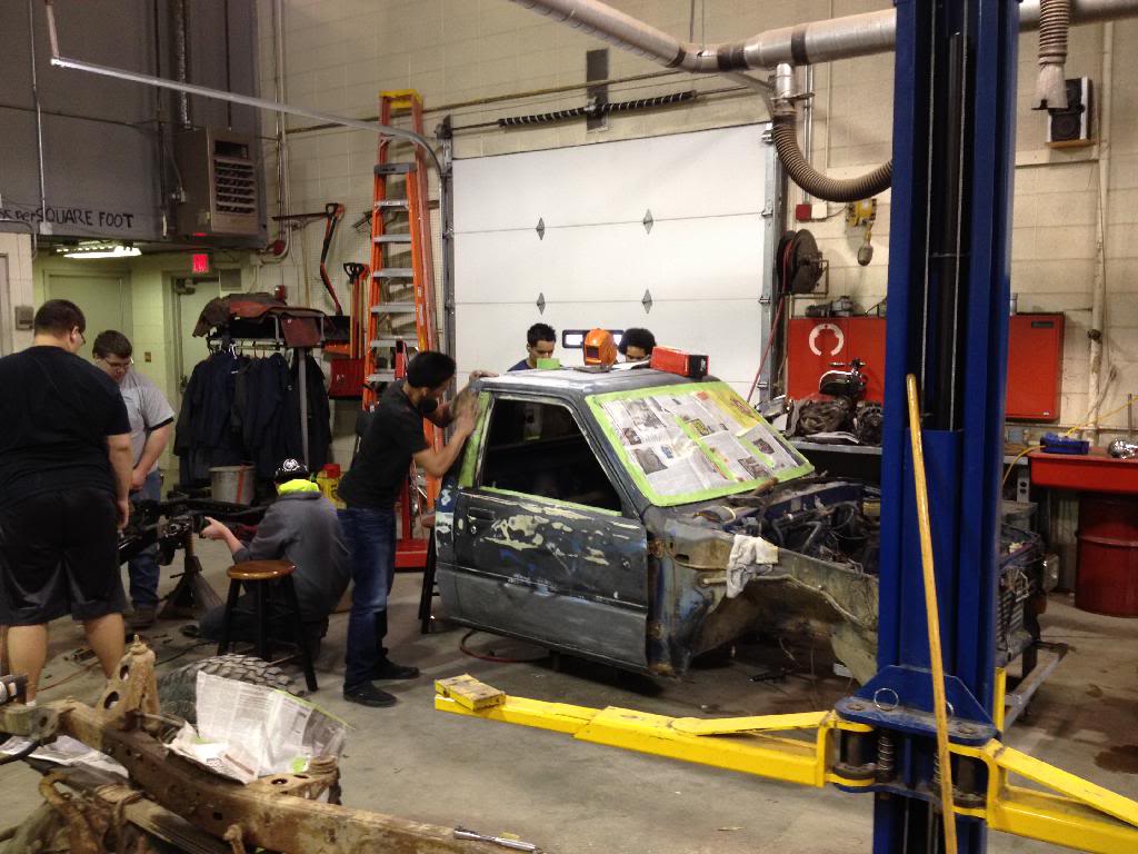

Tuesday Morning 3-11-14

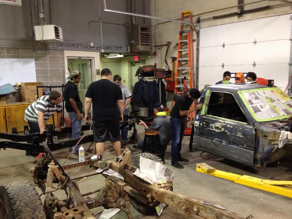

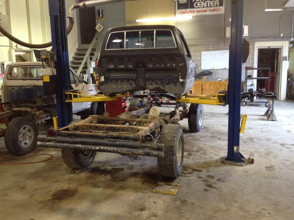

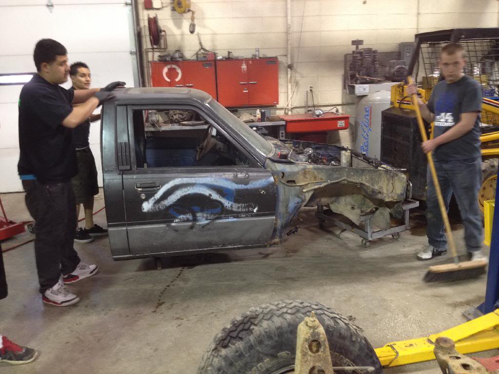

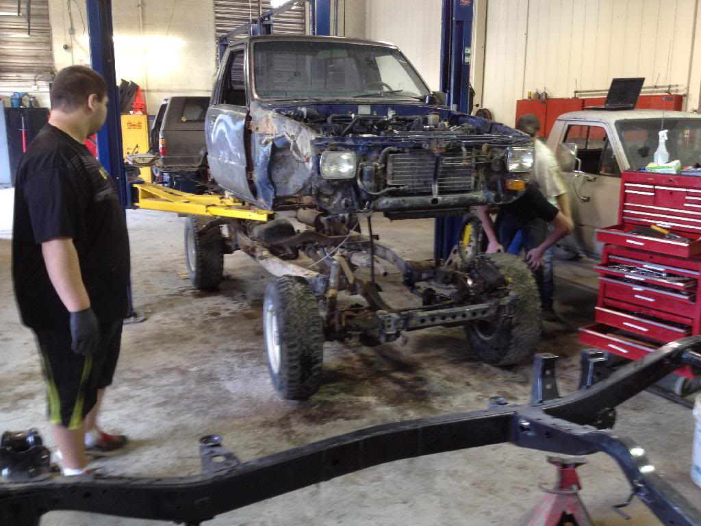

Got the cab down off the lift and onto some dollies I had the students make last year for cradle drops.

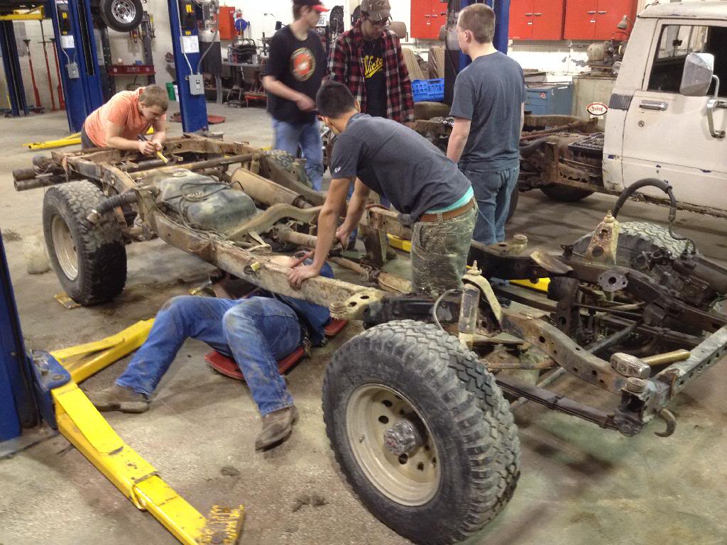

We were able to get all the useable brake brackets and lines off of the 84 frame and swapped onto the 2wd frame.

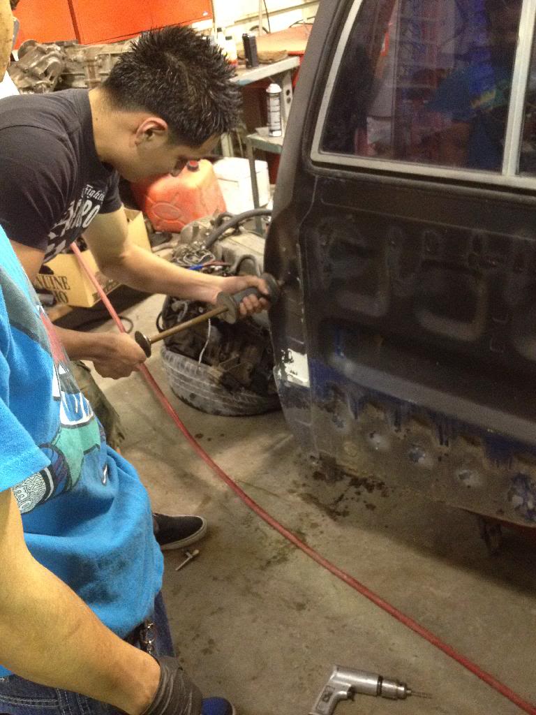

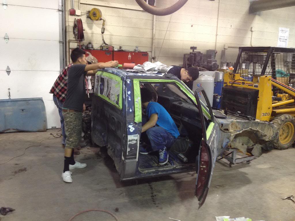

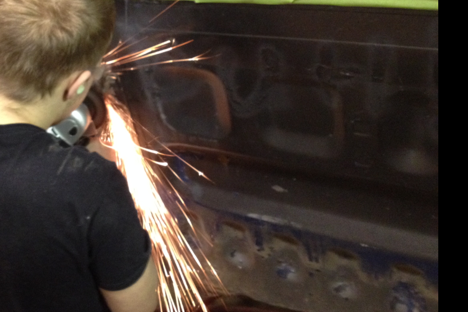

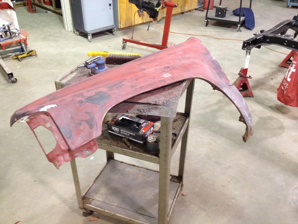

The kids mentioned doing some bodywork to the cab, since they wanted to learn. And I know enough to get myself in trouble so we started tearing into that.
I have some older body work tools that we started using to pull a larger size dent on the drivers side of the cab.
I am going to have some of the kids weld the holes up from the slide hammer tomorrow.

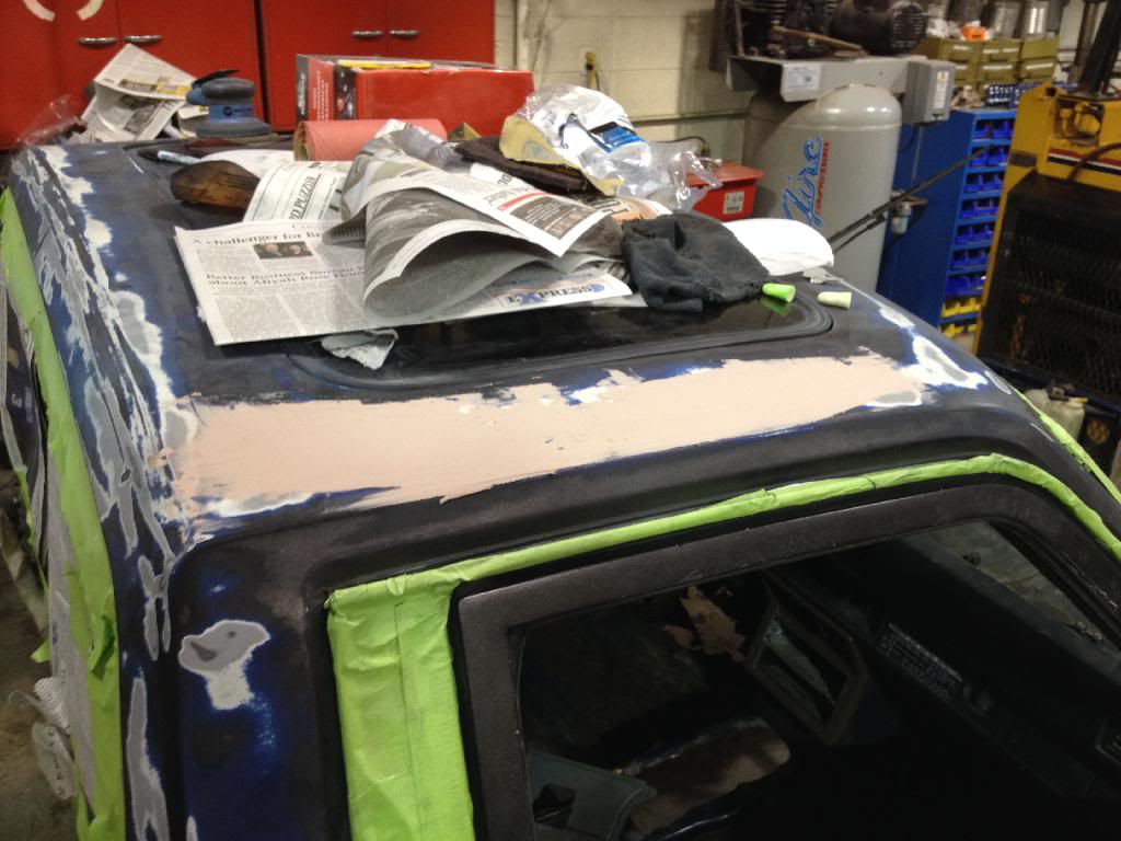

A few of them were anxious to see how to mix body filler and spread it. So I showed them how to mix and let one of them spread it on a small dent on the passenger side roof.

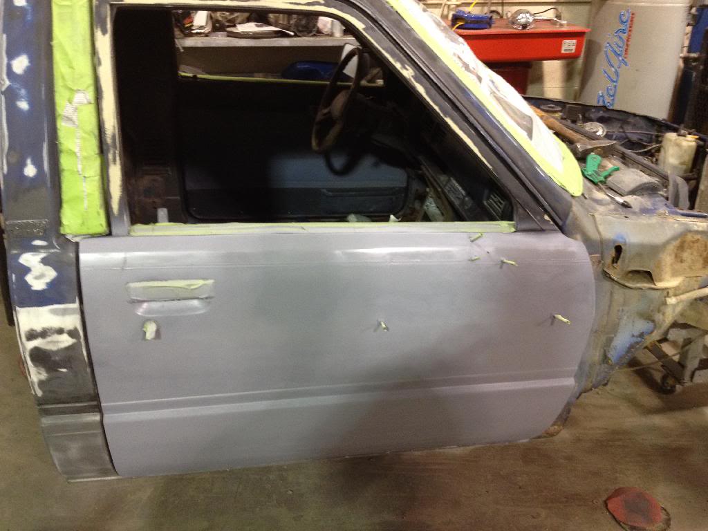

We were able to get some more bodywork done yesterday. I had them using an older style slide hammer to get out a big dent on the back of the cab. Then I showed them how to fill the holes with the 110v MIG welder that I have. We were able to go over the different wire sizes and feed/voltage settings and how they effect the weld.
They also got to experience the Thin Toyota metal. haha

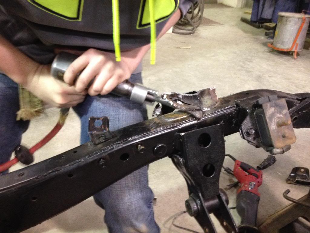

We were also able to get alot more of the 2wd brackets that are welded to the frame off. The kids could not believe how tough that stuff was.

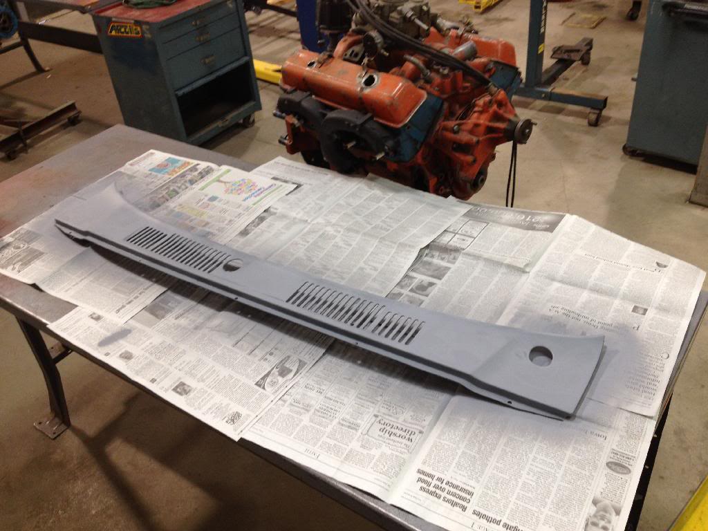

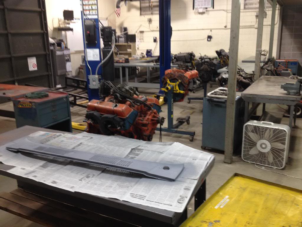

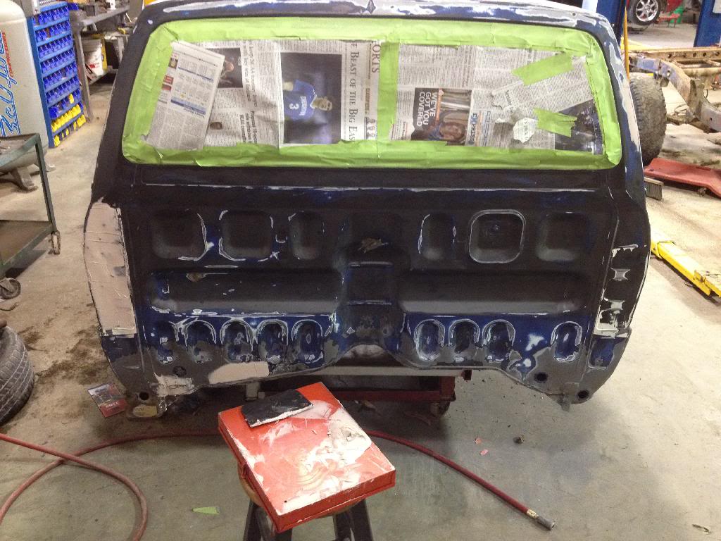

We were also able to get some primer down on the Wiper Cowl, and part of the door.

Did a little more body work today on the back of the cab. I had a few different students mix up the body filler and spread some on.

And started sanding down the fenders, as well as filling a few holes from the PO dent repair.

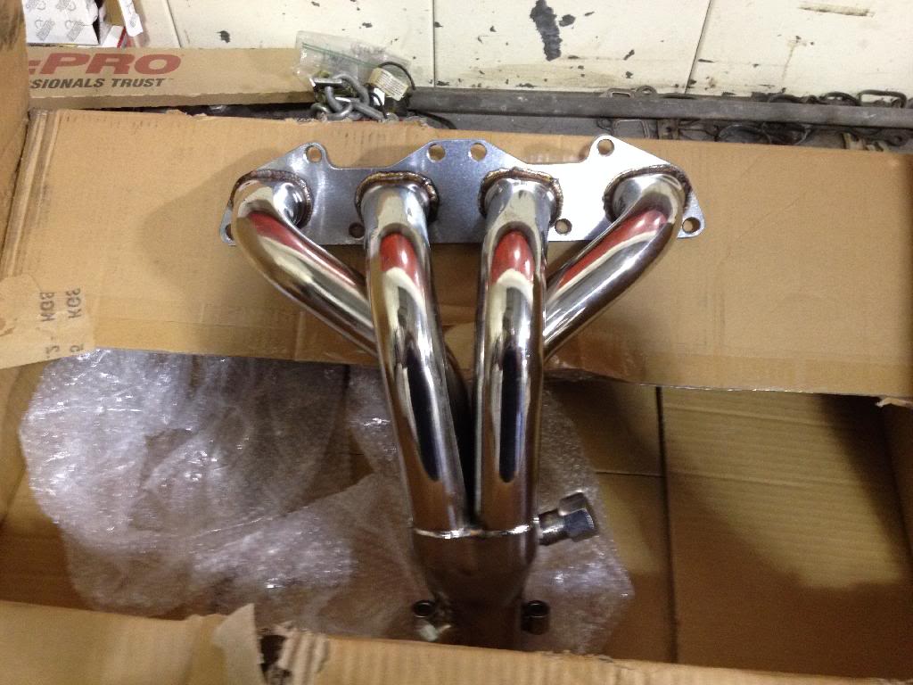

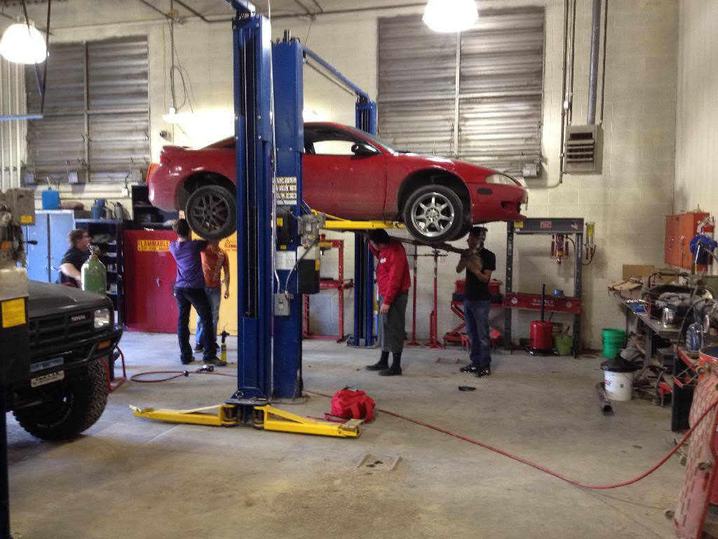

We were short handed today and waiting for parts, so we worked on one of the students cars.
It is a GS eclipse. He bought a header and down pipe for it. I surprised him with a Turbo Back SS exhaust that I had from a GS-t a few years back. We are going to have to make a piece to fit in between the down pipe and the rest of the exhaust tomorrow.
