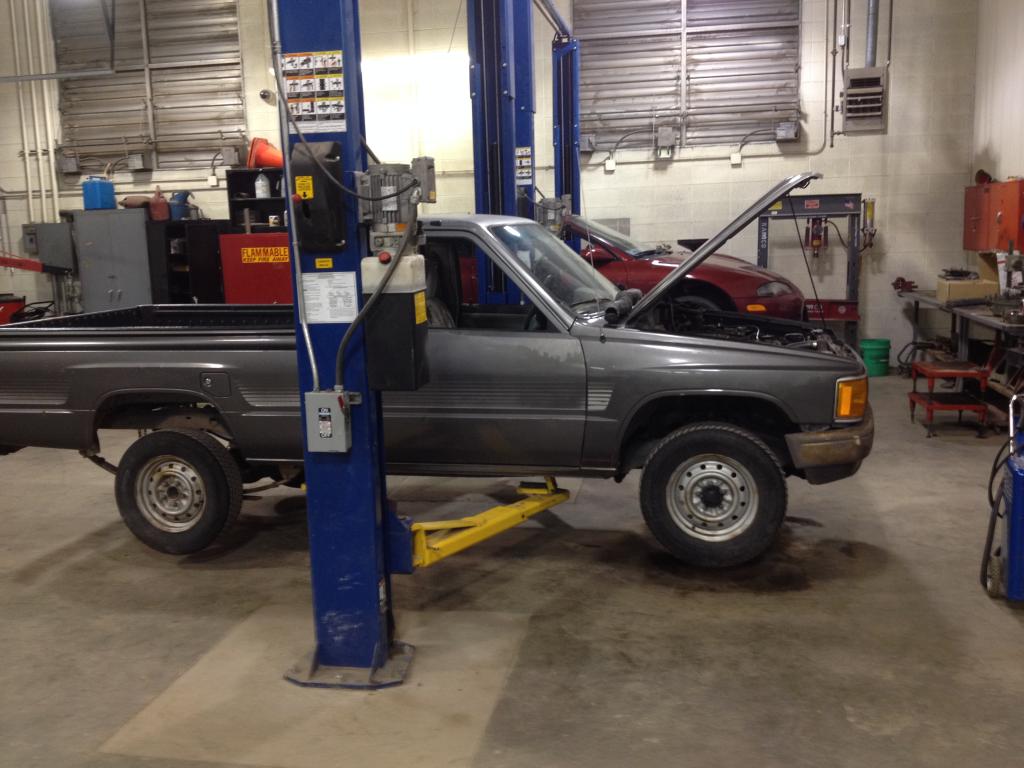

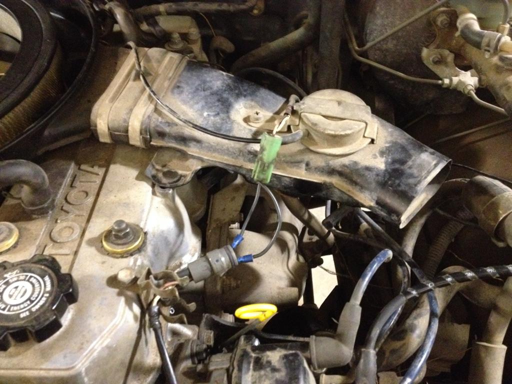

Update 9-3-14
Not much going on yet with the build.

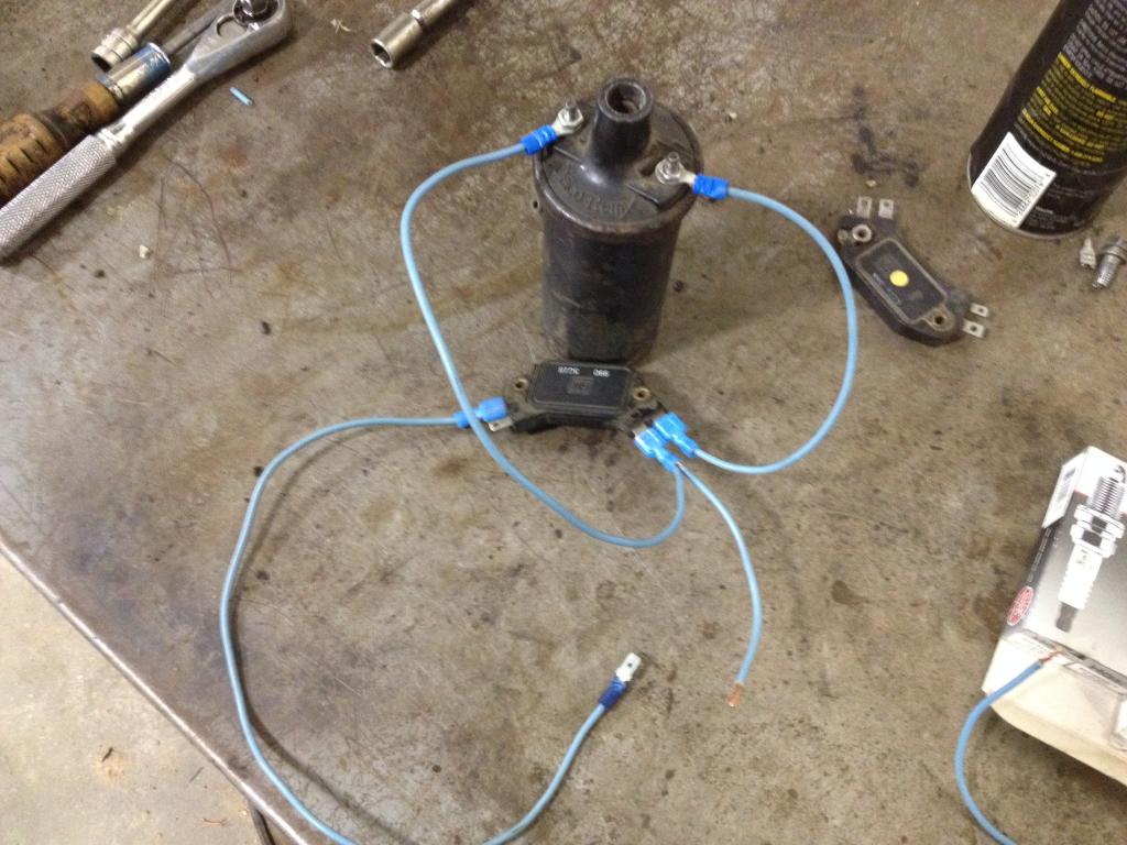

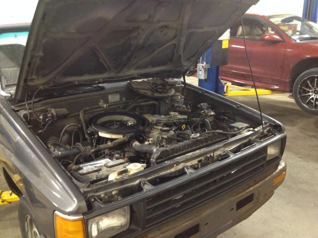

I am trying to to a little tinkering with this 2wd engine before we tear it apart.
So far there is no spark from the coil. I had a quick spark and then nothing ever since.
There is alot of goofy stuff on this vehicle. A mechanic shop in CO did the most recent work to it. Timing kit, timing cover, head gasket, etc..
But as I dig into this further, I find that none of the grounds are hooked up, wiring is not hooked up or hooked up wrong. Just little odds and ends.
I am only trying to get it running to see what the condition of the engine is.
Back to the no spark...

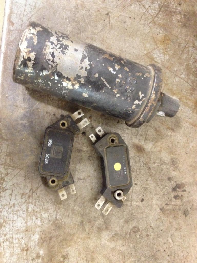

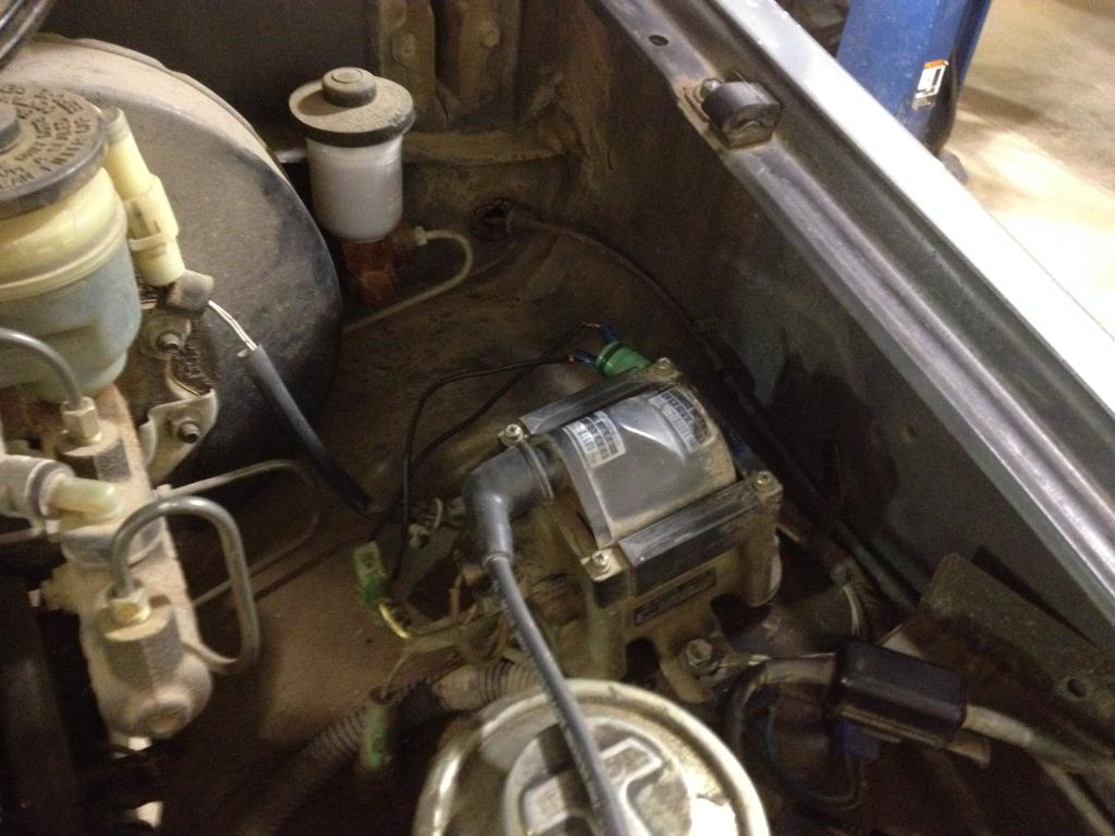

I swapped in a known good igniter with the same result. So I have resorted to doing the GM ignition conversion. I am in the process of wiring that up today.
Enough talk... here are some pics.

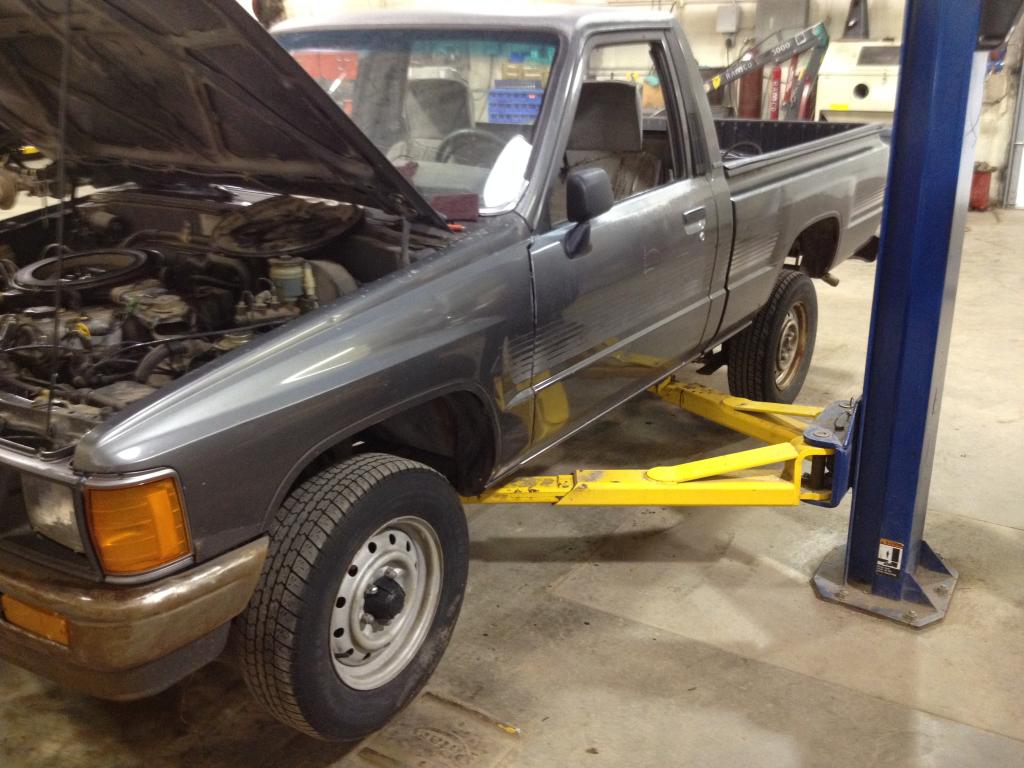

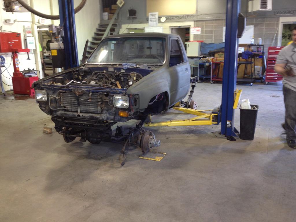

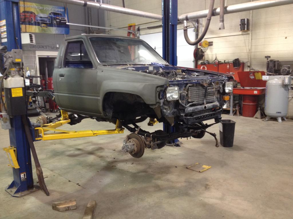

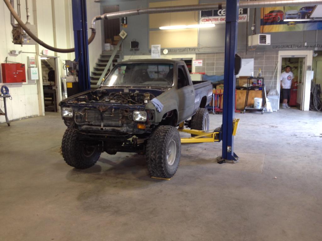

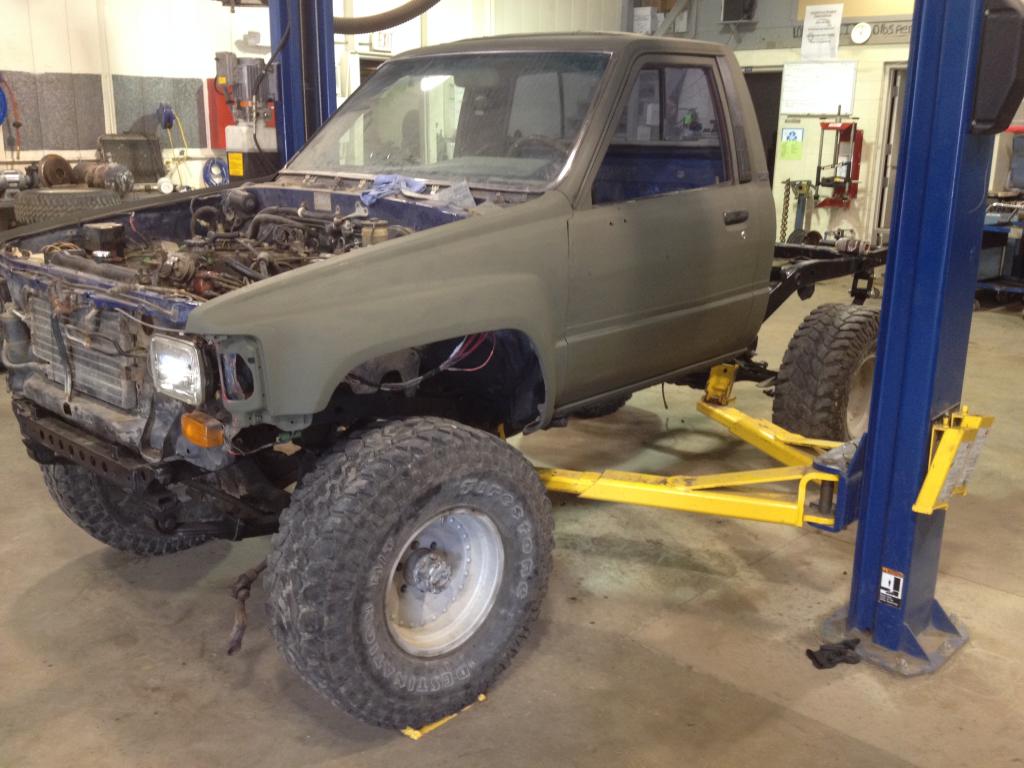

Took the tires off. My friend is bringing up some 33's on rims that he has for this truck.

Had the kids jumper up the other igniter since some of the connections were different.
The GM goods.

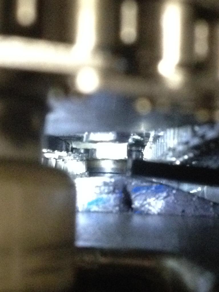

Here all i thought the igniter and the coil were bad, and started to wire up the GM ignition.
I decided to see if the rotor was turning and sure enough it was not.
I pulled the VC and only to find the timing chain jumped off of the crank gear. Never saw that happen before on these engines. Explains the quick spark then absolutely nothing after.
Looks like Im going to be taking it out and trying to fix it.

I can see the problem. Looks looks like who ever did the timing kit, installed the crank gear backwards.
Causing the gear to be too close to the block. The chain looks to be at a crazy angle. As well.

Yeah I know it's crazy. He took it to a shop in Colorado and they did the work
It's hard to see but if you look close you can see the cam gear. And the chain hung up and at an extreme angle.

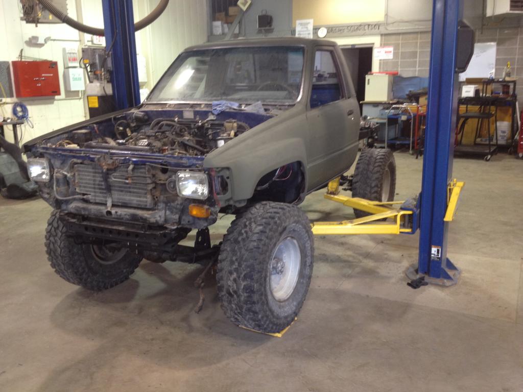

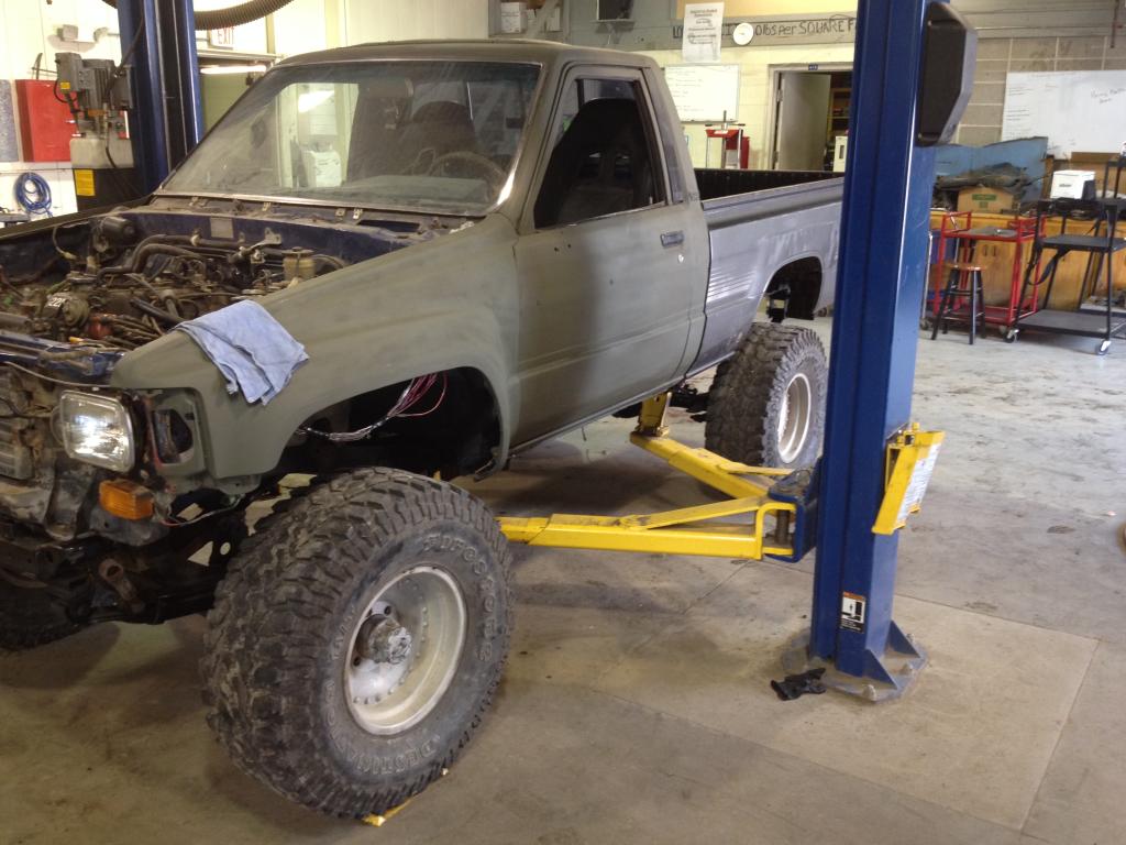

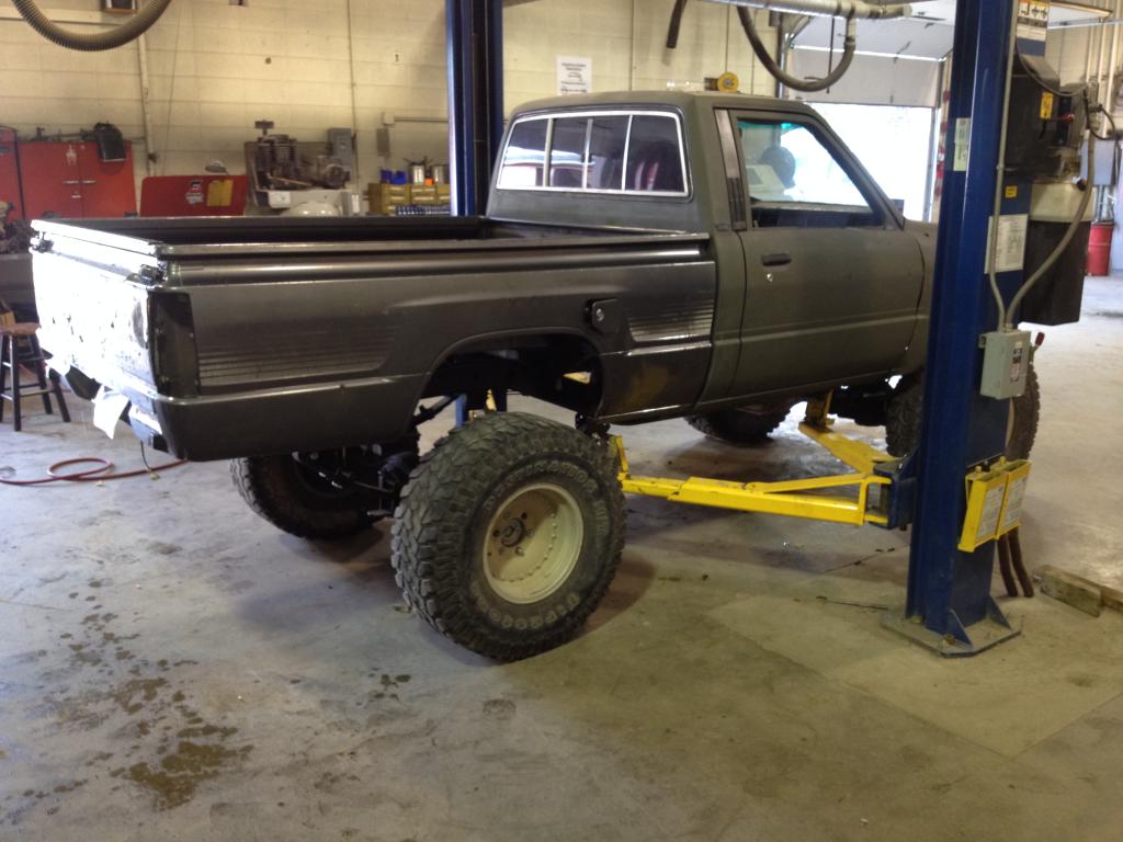

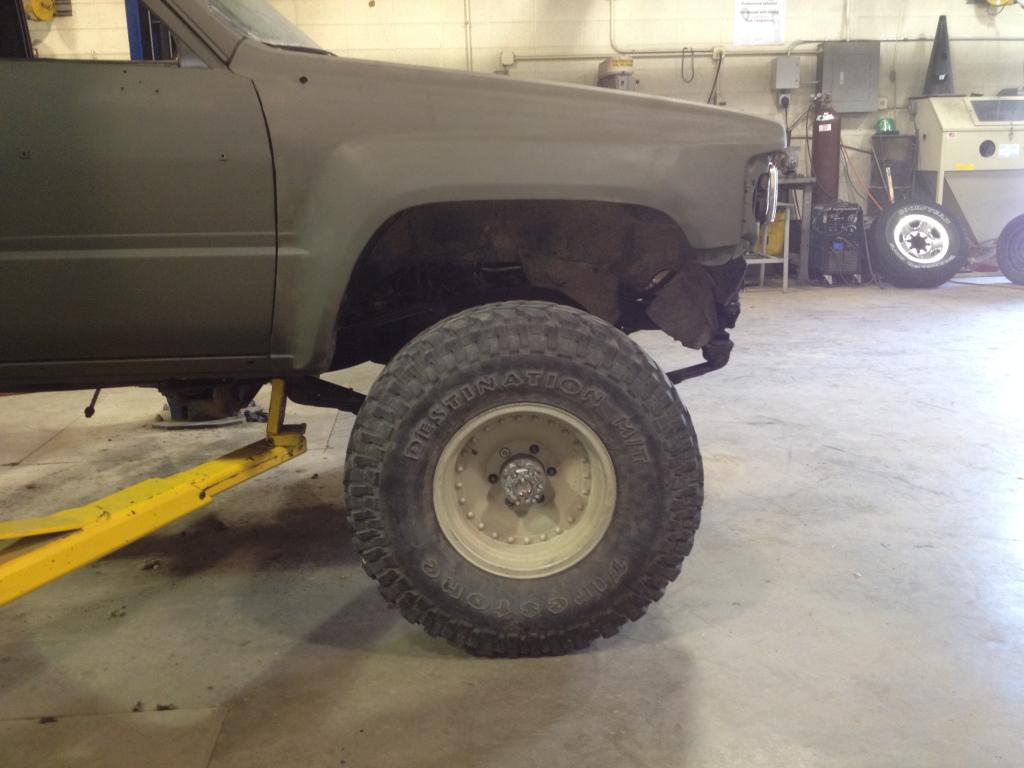

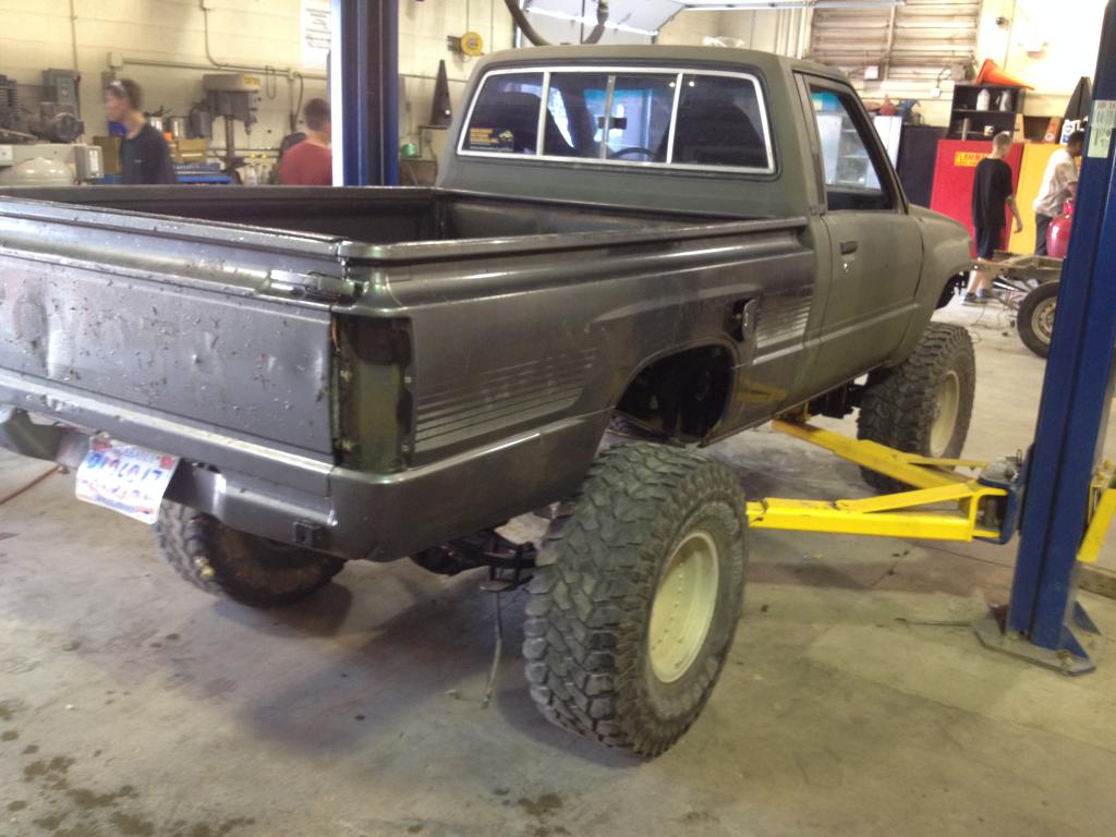

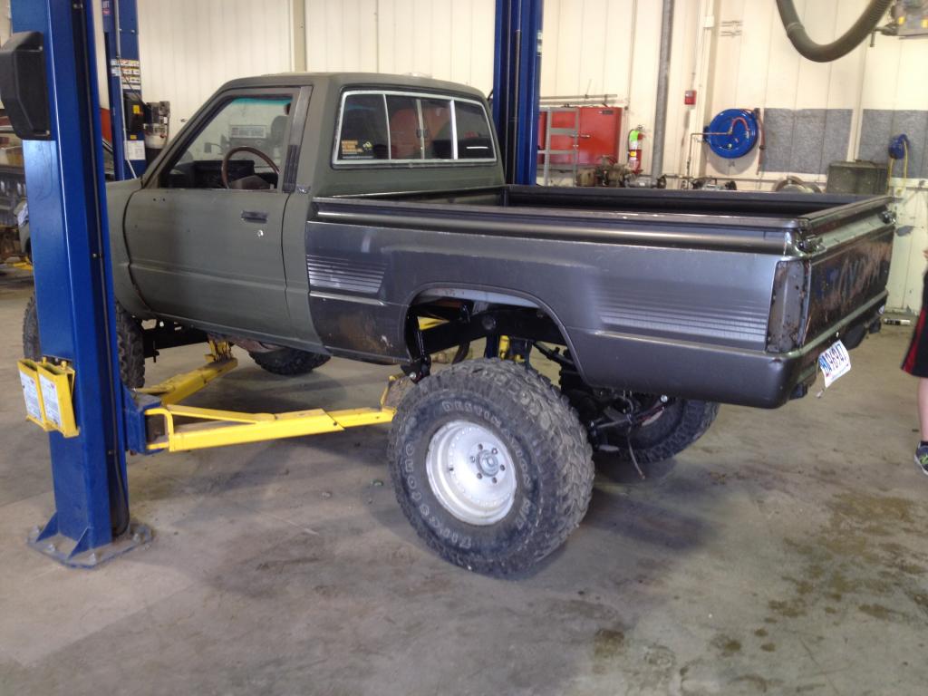

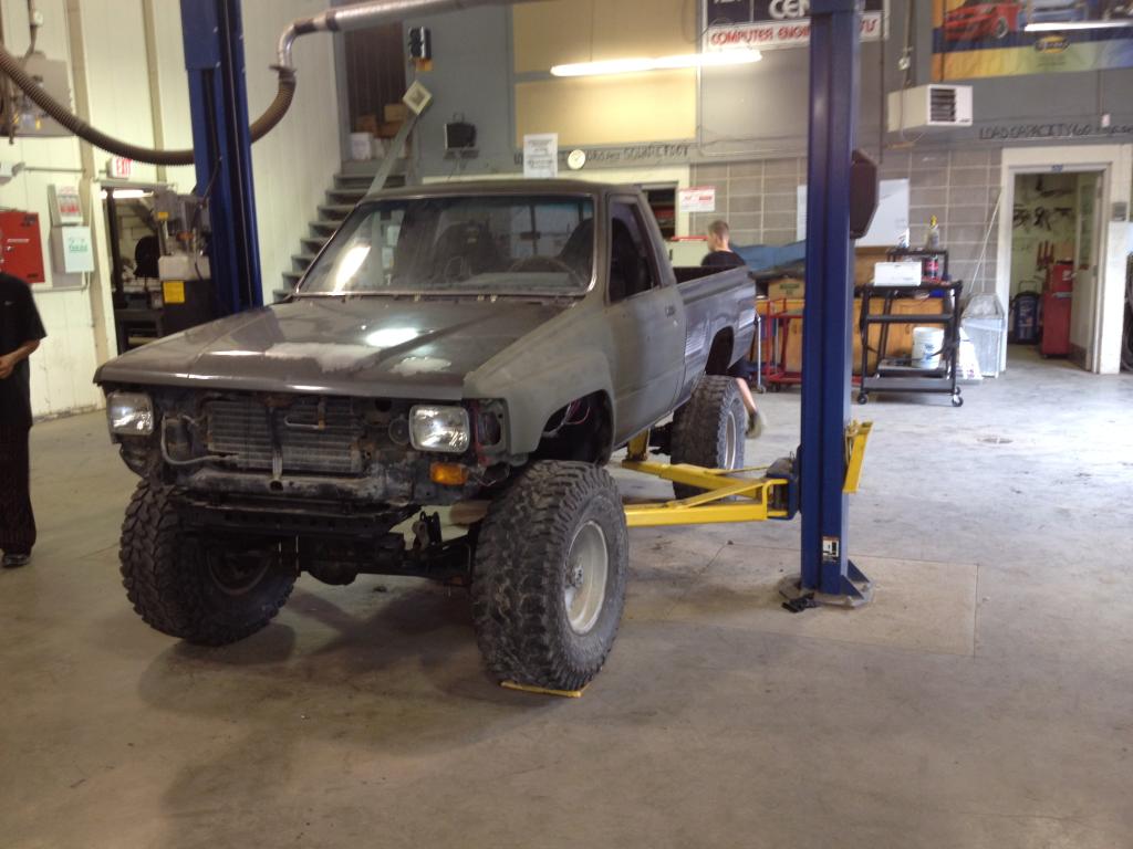

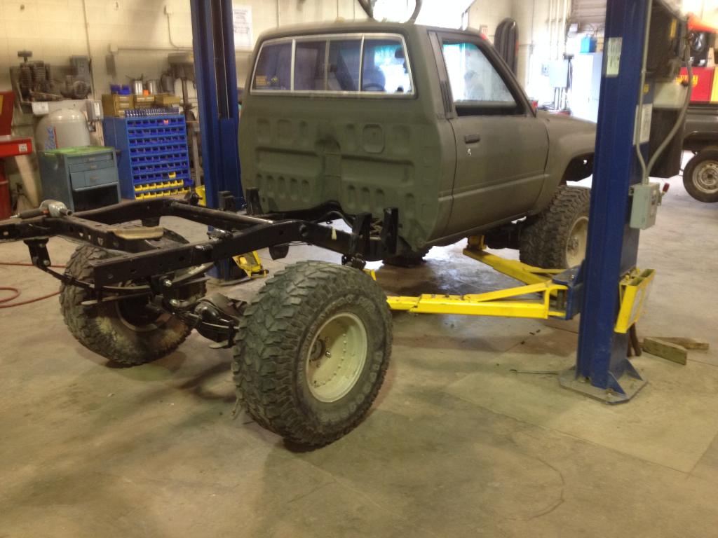

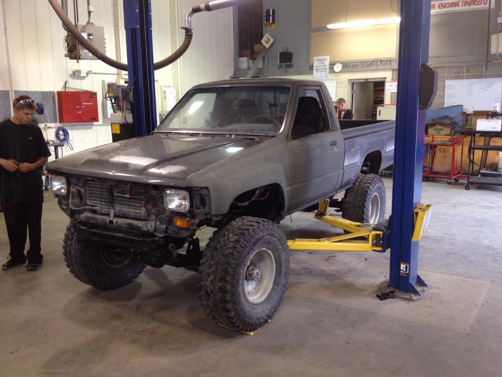

33's are on and set down. This thing is pretty stout. Can easily fit 35's. Name:  FAB63C1A-0028-4A6A-80E3-9A0CE156C53B_zpsackwet6q.jpg
Size:  90.3 KB Name:  5C28245D-0F05-42FC-89E9-43262427F8EC_zpszjoisa3w.jpg
Size:  71.8 KB Name:  76AB00BA-306A-4A4C-AB4B-8AFC743143F5_zpslptfszyp.jpg
Also got the steering box nut from Chris!! Thanks buddy. It was an IfS steering nut. Totally fit on the push pull box.
Going to try and get the bed removed from this 2wd tomorrow and set onto the truck to see how it looks.

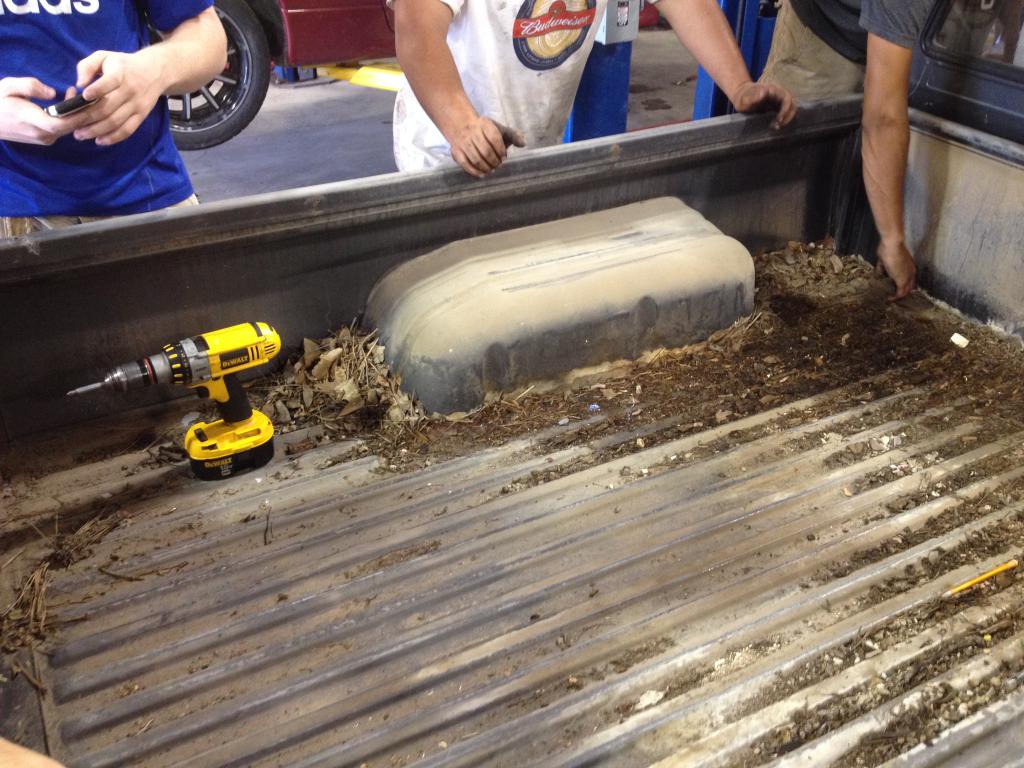

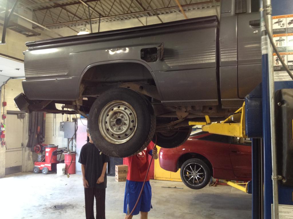

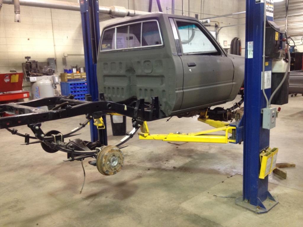

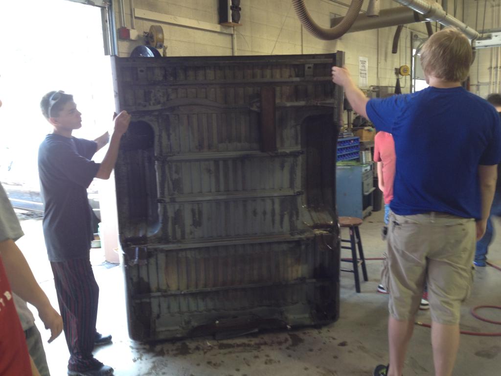

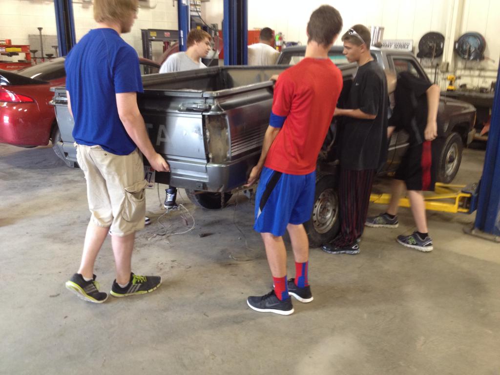

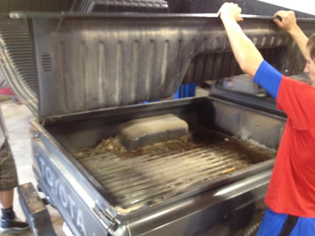

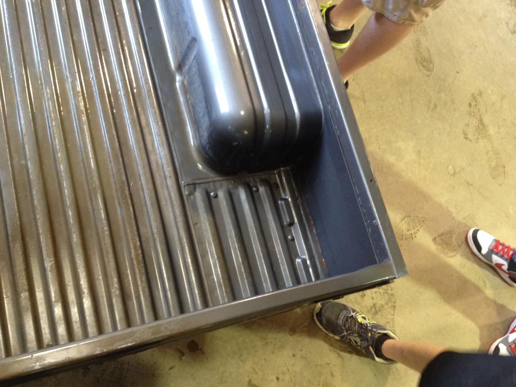

Started removing the Bed today from the 2wd pickup. It is so nice working on a truck that has minimal rust underneath. Makes the removal that much easier.
Lots of hands to get the bed off. Surprisingly this is the lightest Toyota bed I have ever dealt with.

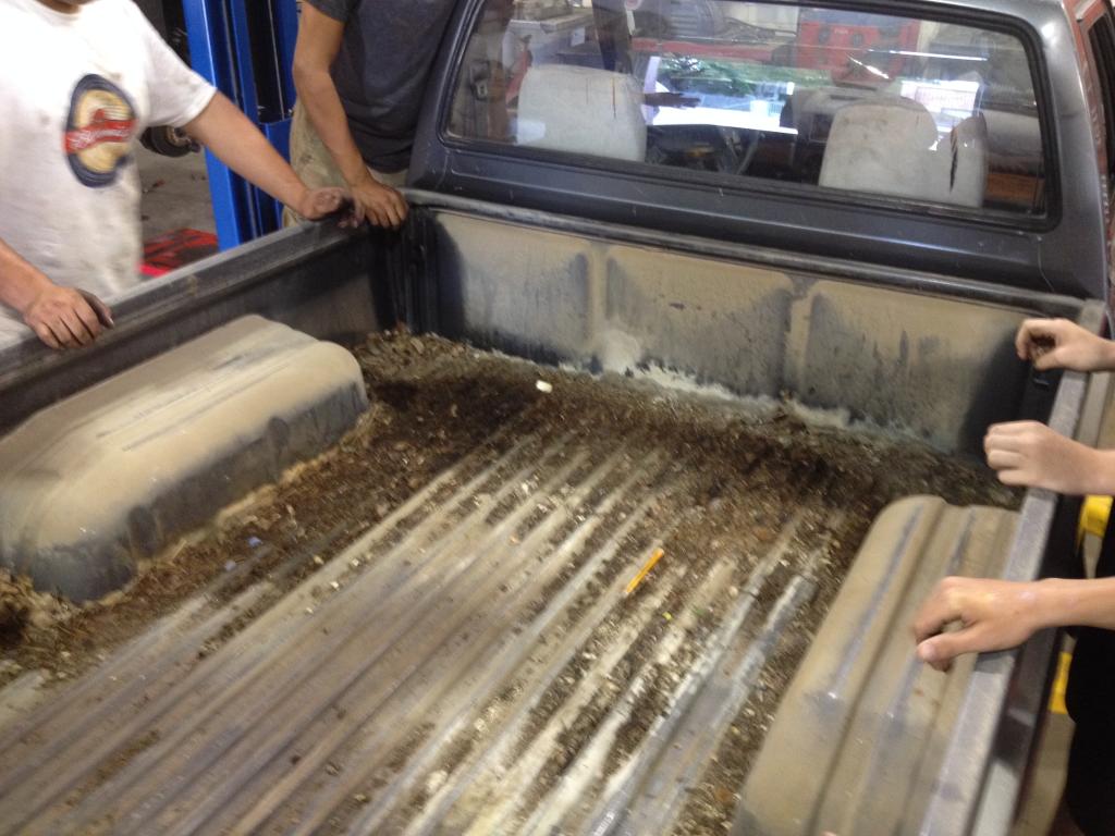

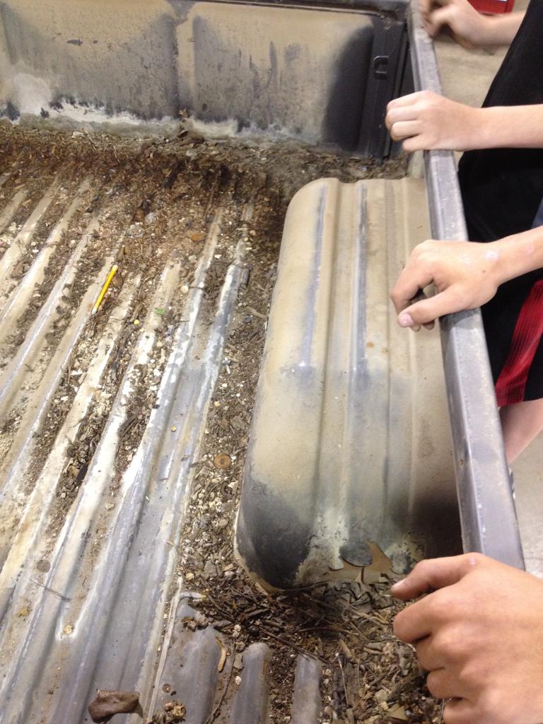

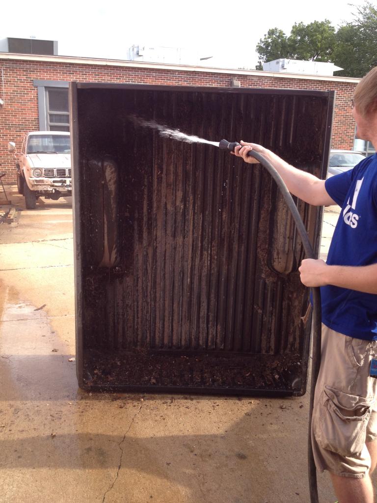

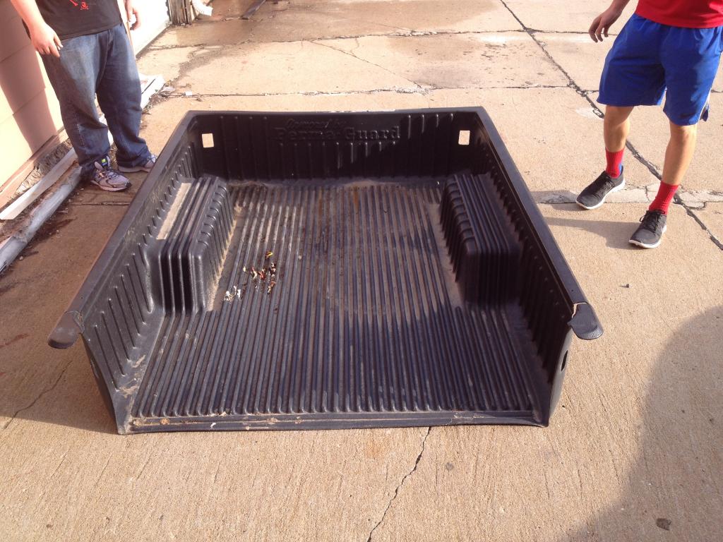

Here is why you NEVER EVER use a plastic bedliner.

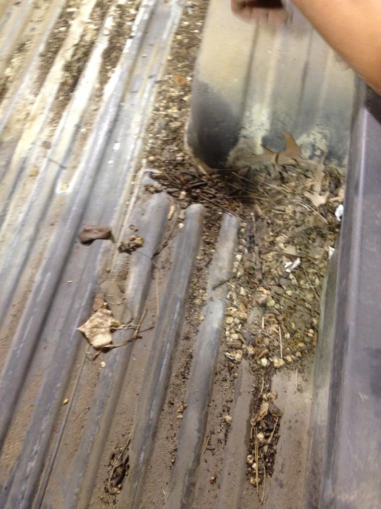

Look whats underneath. Literally a wheel barrow full of rust inhibiting junk, mulch, dirt, leaves, etc...

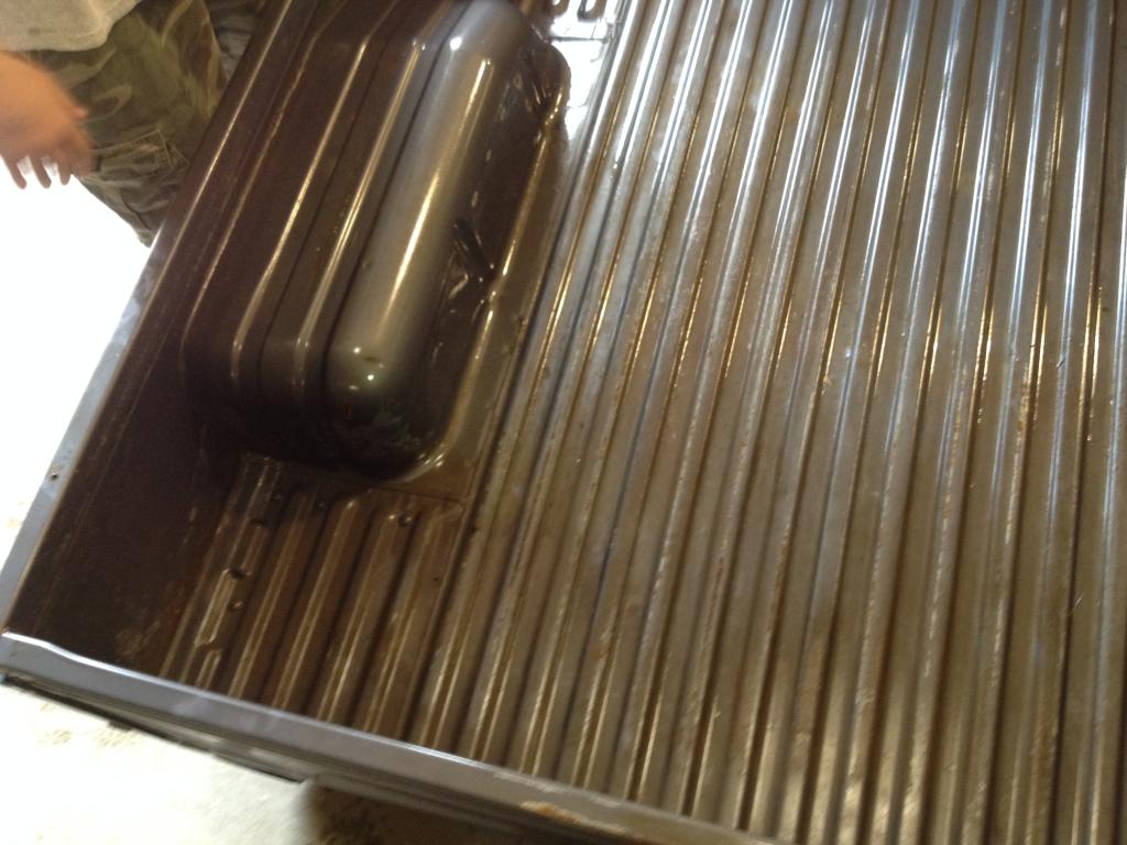

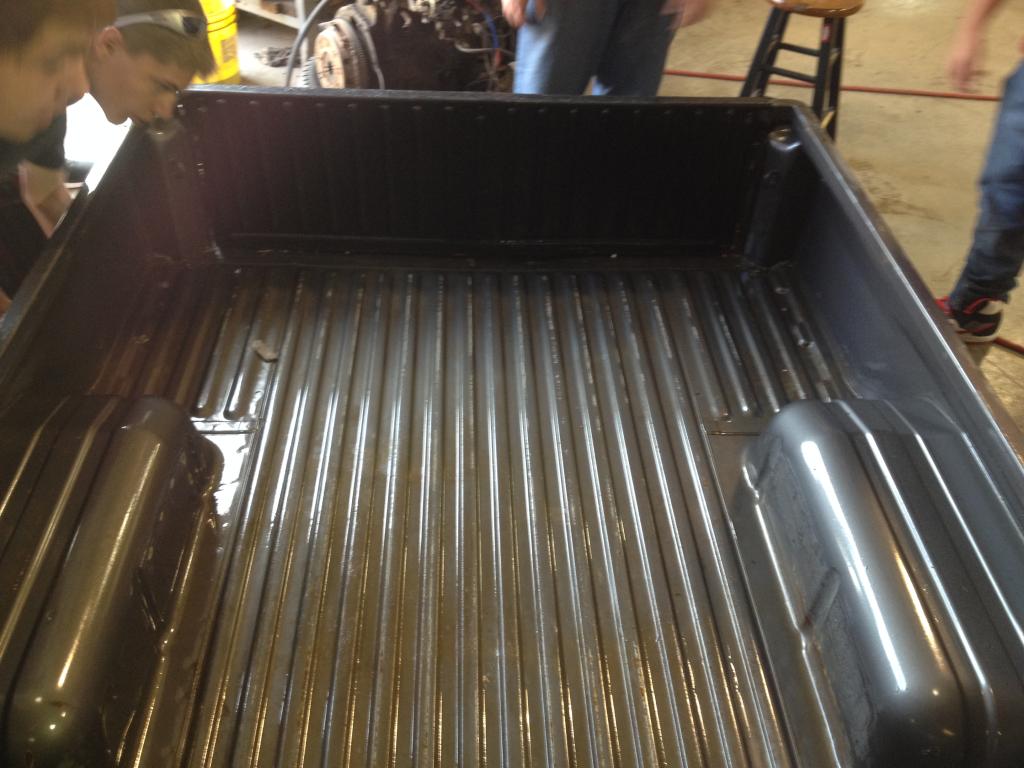

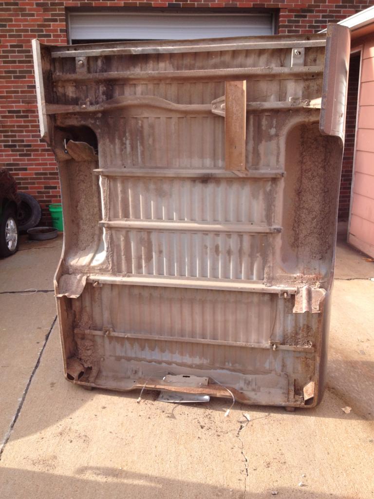

Luckily underneath of all that dirt and grime, the bed was still pristine. Must have caught it just in time.

Now the best part!!! This thing looks amazing with the bed and 33's on. I want it!! Haha.
Let me know what you guys think.
Also got the hood on from the 2wd.
