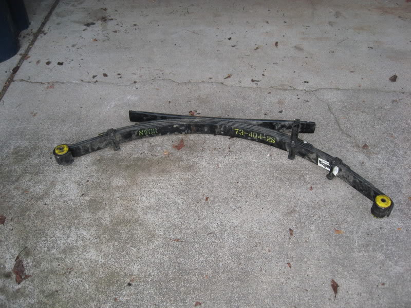

i hope you guys have better luck with the NWOR springs than my brother in law...he ran their rear springs for 2 weeks before finding something else due to the rough ride..
this was several years ago so maybe they have changed..
i ended up with them and traded them for some random parts

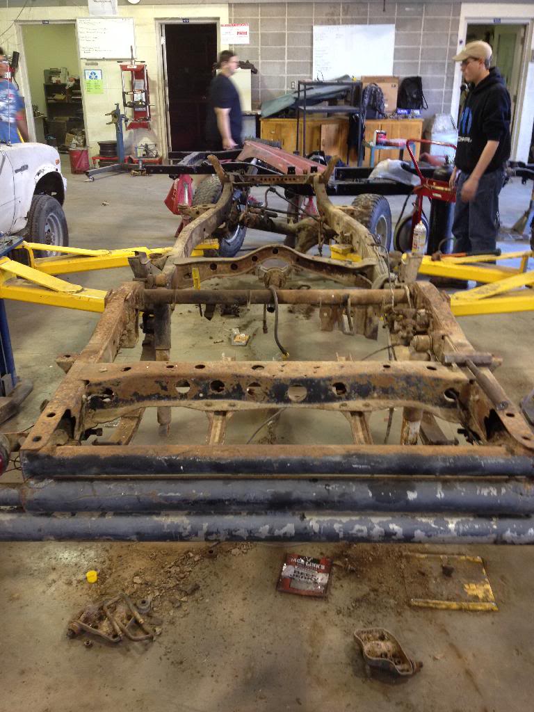

Update 3-23-14
Still waiting on the NWOR springs to show up.

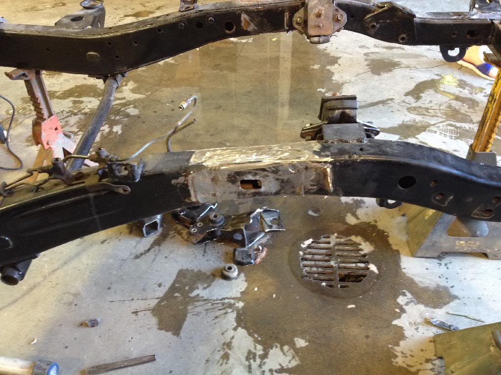

Finally got all the from 2wd stuff cut and ground off. I let the kids do this however they felt was the best way. Seemed like it took forever but they got the job done. Mostly used a sawzall, grinder and a hand sledge to do the work.

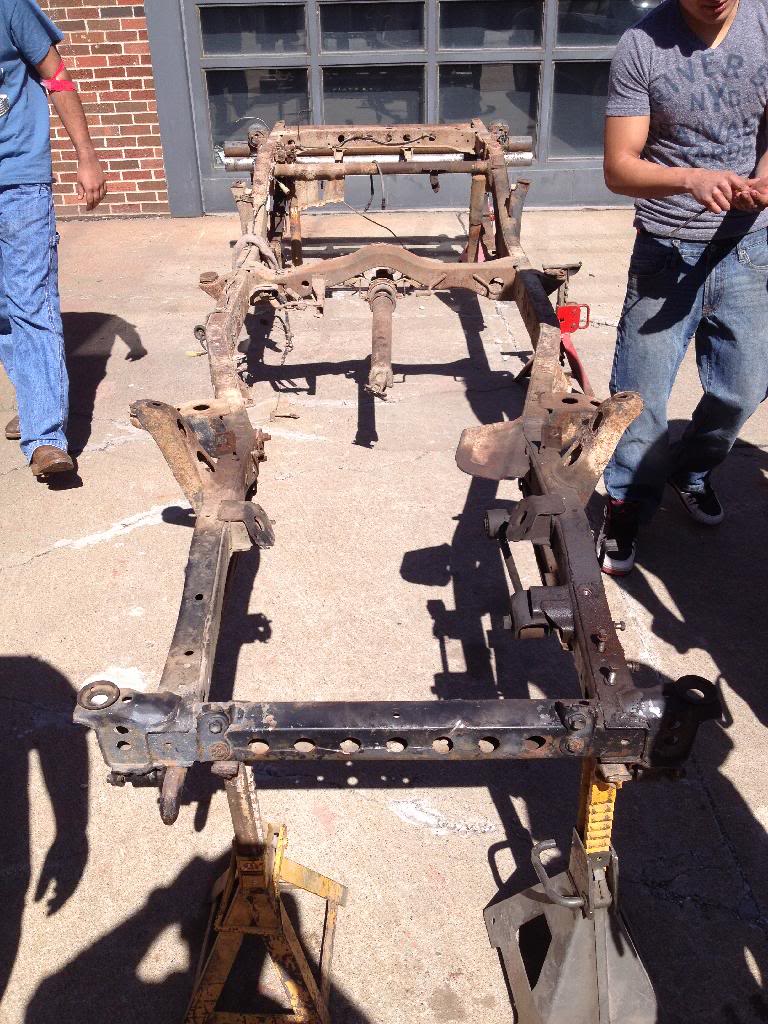

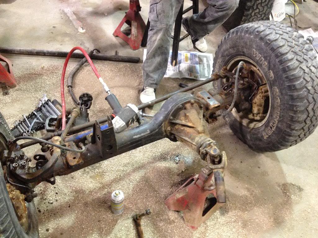

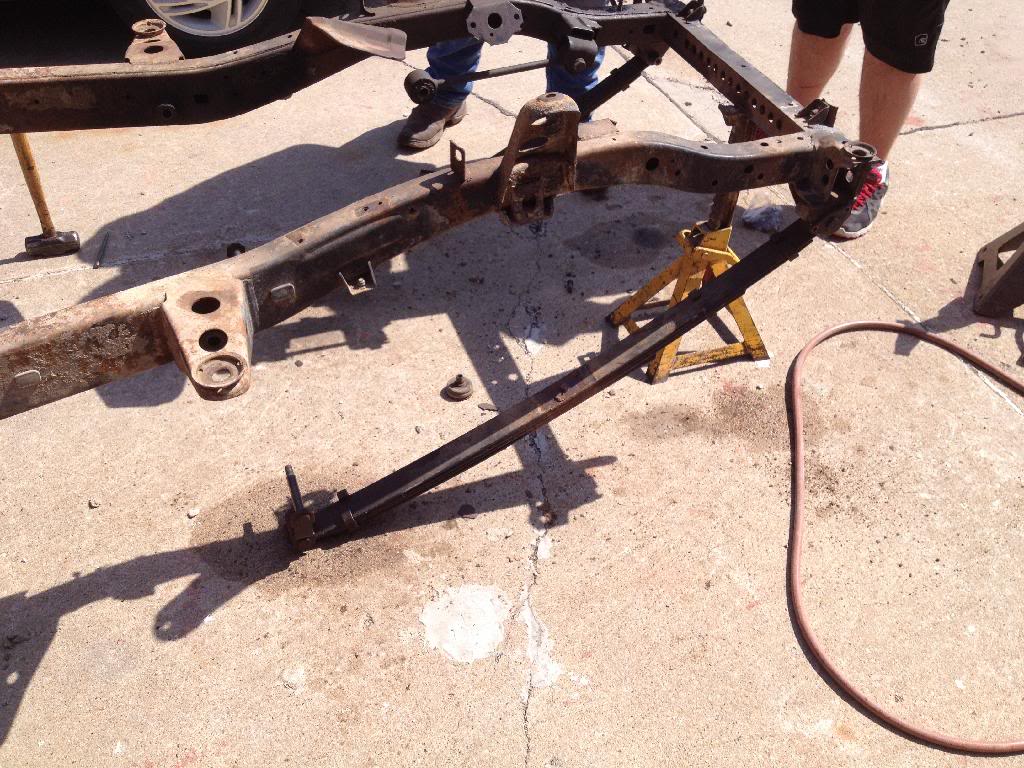

Also ended up getting both axles off the frame and sent the frame outside so we have a little more room.
I had them using the Hotsy to clean up the axles and get all the nasty mudd off of them. I think that we are going to try and paint them tomorrow or sometime this week. We might as well make them look nice while them are out.

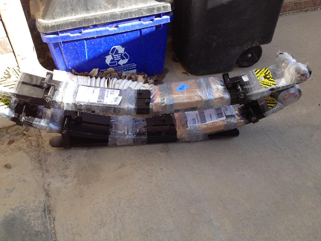

They are here!!

Things are finally coming together. The NWOR springs and u-bolts showed up yesterday and were waiting at my front door when I got home from work!

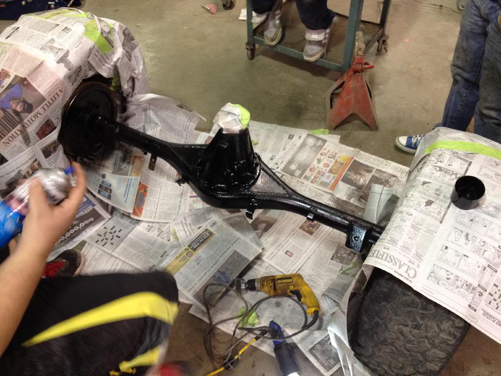

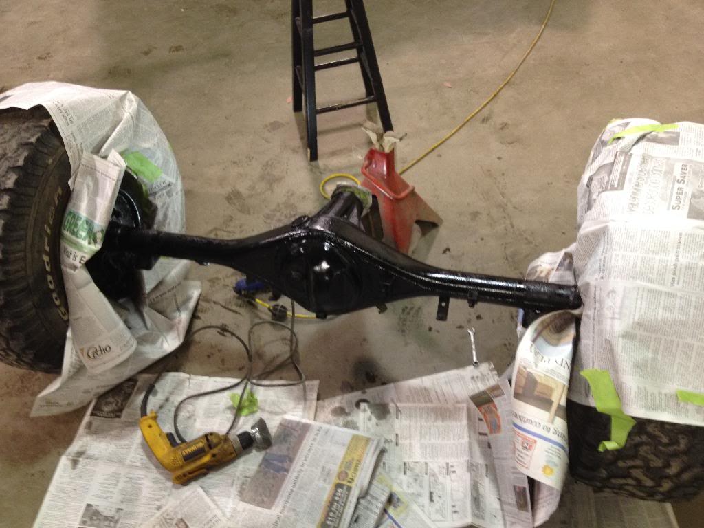

Rear axle has been wire wheeled and painted with some universal black paint that we had. Something just to make it look nicer while it can.

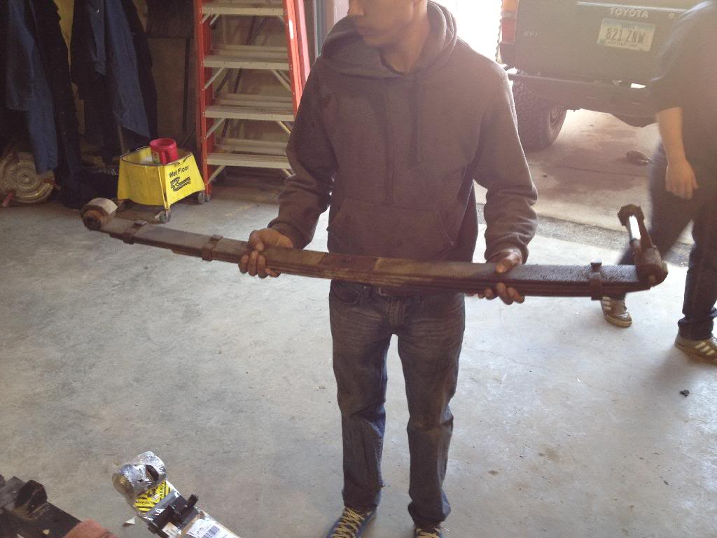

We were able to get the old front leafs off without damaging the front shackles. We are not going to use them, But I always like to try and remove things properly. You never know when you might actually need them or end up using it as a reference.
A couple of my really good solid workers hammered the rest of this out and got the leaf packs totally off of the frame. We are going to start pressing out the OEM shackles today.

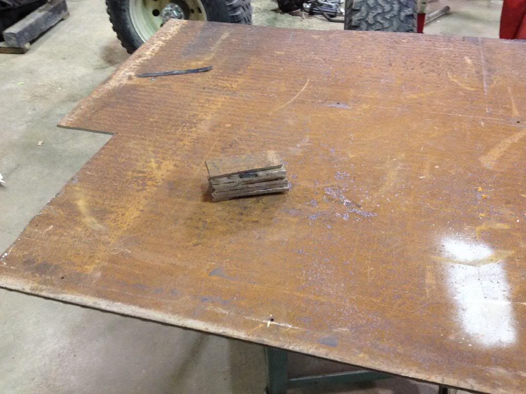

Still going at it hard over here. I had the kids cut out some steel for the shackles from a piece of 1/4 that I had sitting around.
Heres after they were finished cutting. They were able to get out 8 of them before the day was out.
Thata about all we were able to get done yesterday since we are going through Ncarmen91's truck in the shop as well. But we should have his finished up by the end of the day today.
