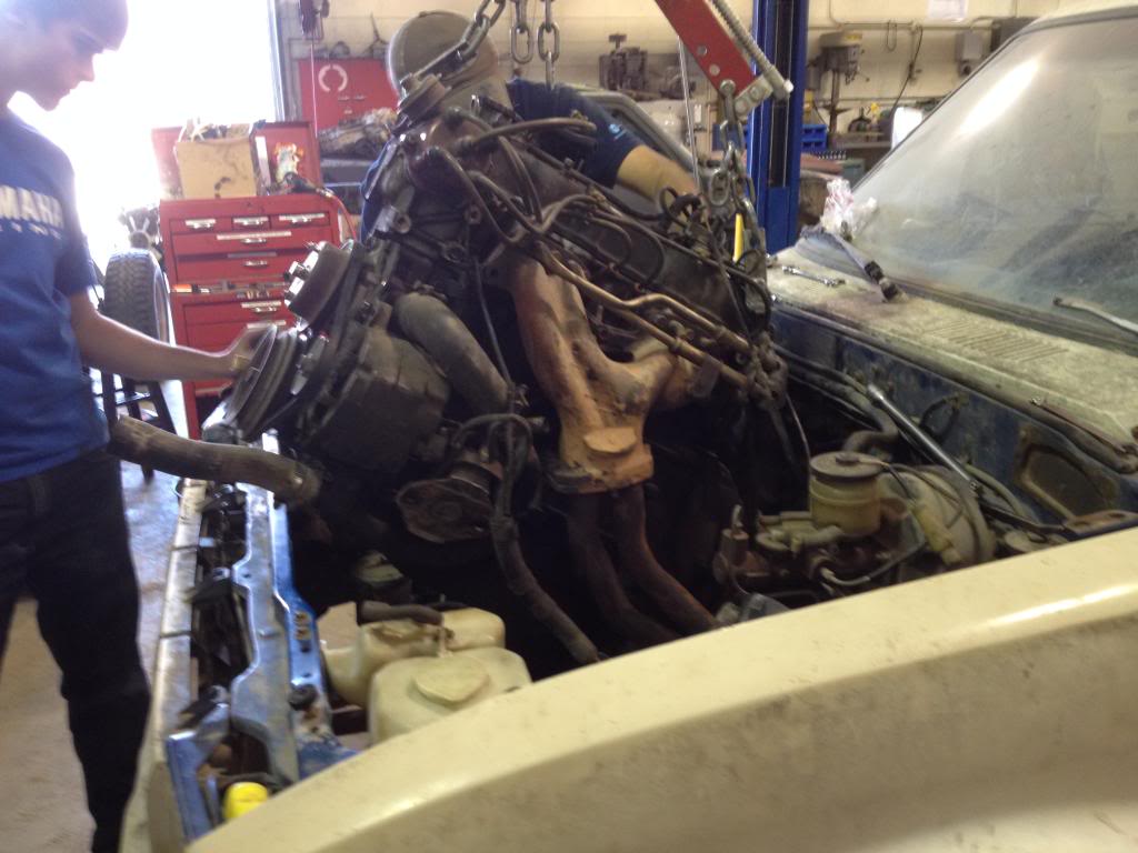

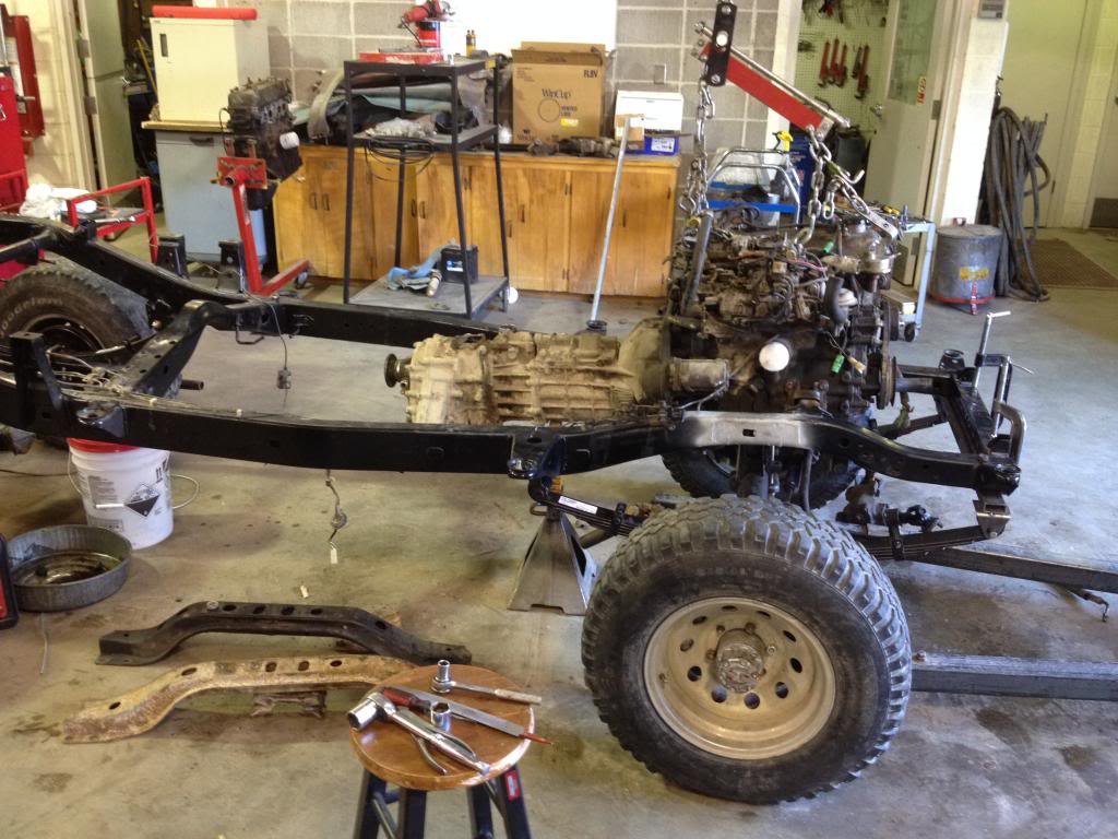

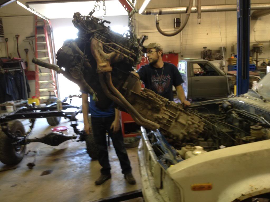

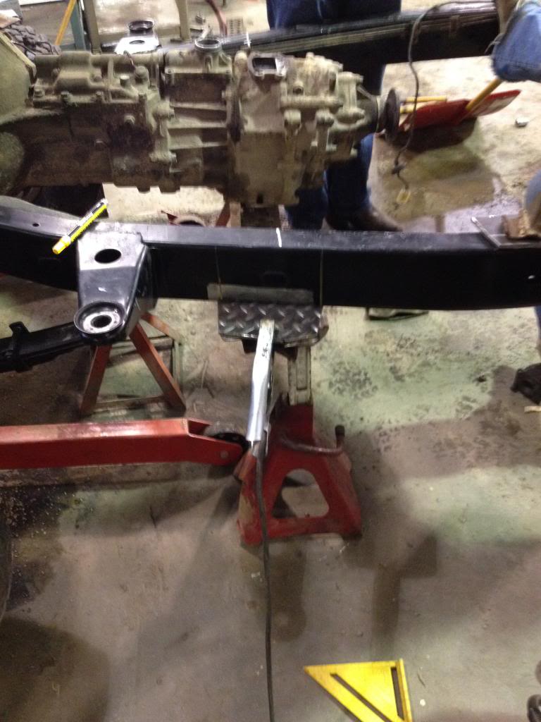

Update 5-8-14
Haven't made an update in a few days. But we have been getting alot of work done on the frame.

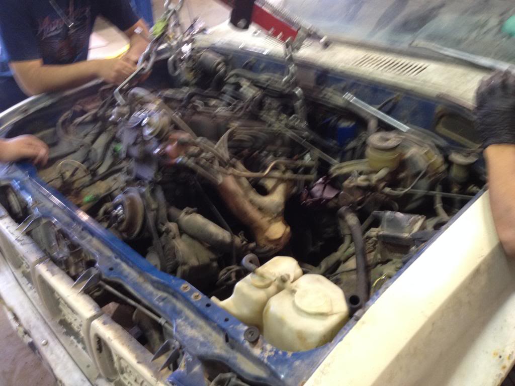

We finally were able to pull the engine and tranny out of the 81 pickup last week and set it on the frame to take some measurements.

So now we are measuring and measuring to make our mounts for the transmission. Came to find some information that I did not previously know. The 1st gen transmission is about 4" shorter than the 2nd and 3rd gens. This was throwing me off for a few minutes when we were taking the tape to the frame. Not until I compared it to my runner and the 81 frame did I realize it.

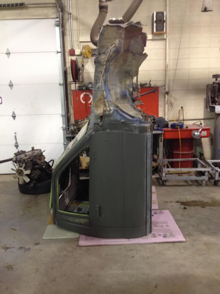

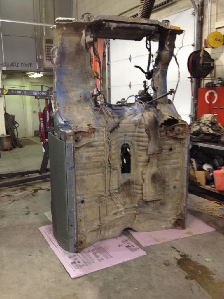

We also got the cab upright and started to cut out the floor for a repair.

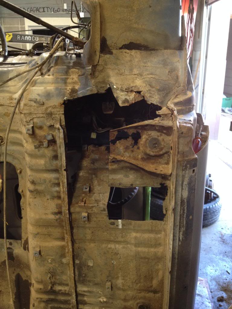

I had the kids start cutting out the rot in the floor so we could figure out a patch piece.
Yesterday was a hot one here 95 and humid as ever. Especially in the shop since there is no AC. One of them was spot weld cutting in a tank top trying to get the body mount out. HAHA
A quick photo of the Engine and trans on the frame to take measurements for the mounts that we have to make.
Coming along pretty nice.

Looking great. I have seen some of the first gen trucks transmissions that are shorter then that. Look like a Model A tranny on one that I seen.
If you are going to modify a crossmember, they look the same but are different in different generations. Just to make you aware of some differences in them.

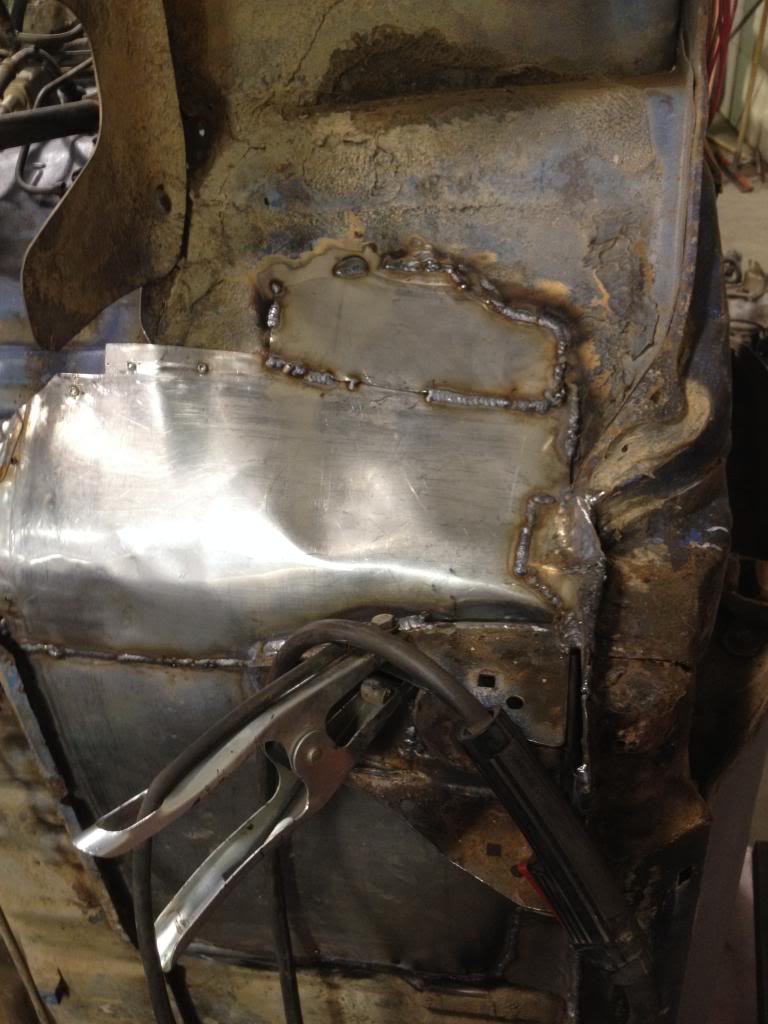

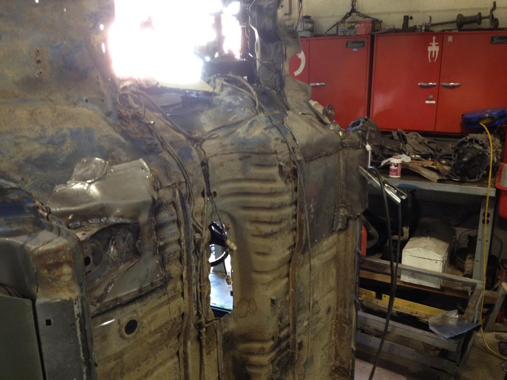

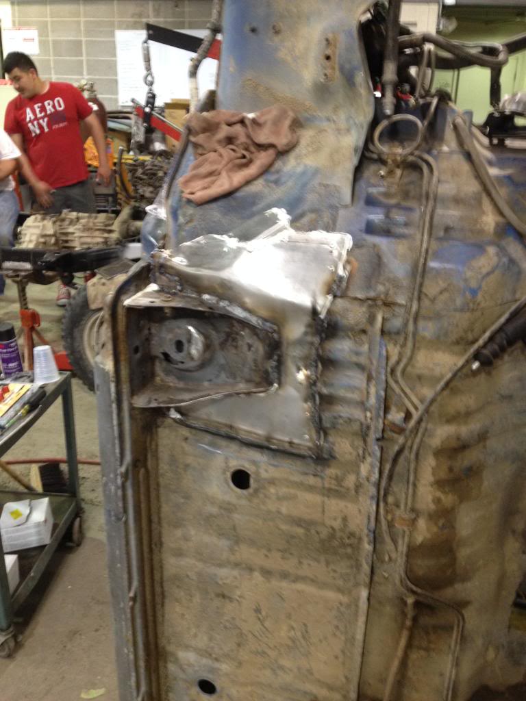

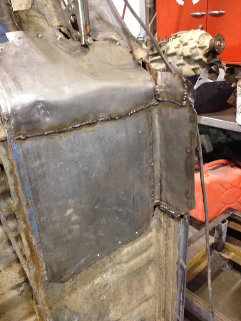

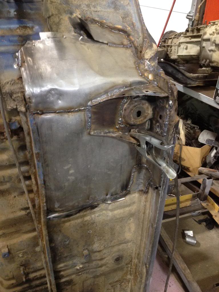

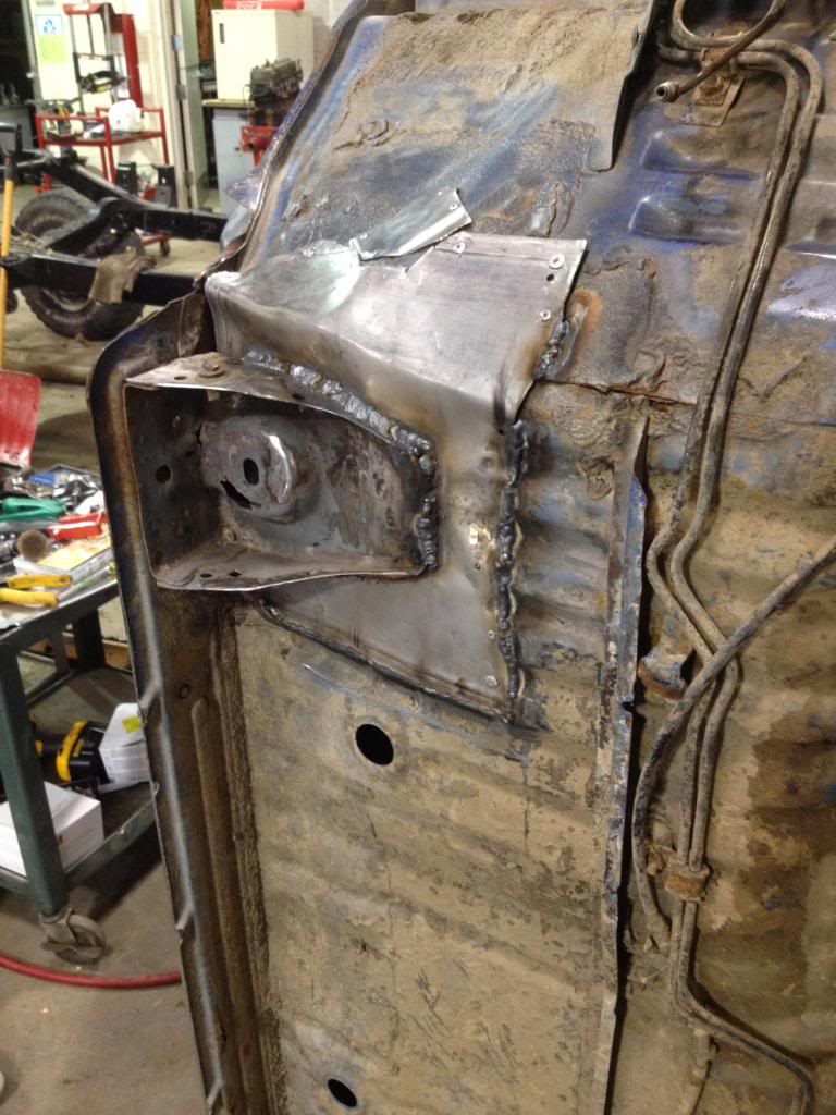

Update# 5-22-14
Sorry guys for not making an update sooner. I have been extremely busy the last few weeks. Between end of year stuff, my own family, and everything in between, it has been hard to make updates on Progress.

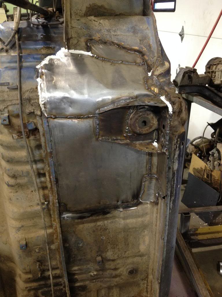

We have successfully patched the driver and passenger floor on the cab. Now I am going to put some sealant/ coating over it to protect it.
I had some Stainless laying around that was going to waste, so I let the kids have at it making patch panels .

I also had them cut out the old mount and rebuild it for re-installation.

Had them stitch in the panels.
Finished product with some seam sealer where needed.
Its not perfect by any means, but I think its darn good for their first time and what we had to work with. Ideally I wanted to go to the U-pull it and cut floor sections out, but I simply could not find the time to do so.
We also started fabbing up our cross-member mounts yesterday. Hoping to have those finished this morning and burned in.
