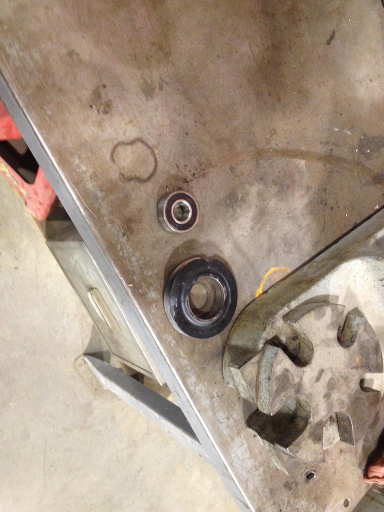

I believe you can just replace the bearing on the tensioner rather than the entire thing...
Yep. That's what I did with mine a few months back. I have the part number in my build thread. Just need to go back and look.

Forgot to add a picture of the bearing pressed out of the pulley
Picked up the new bearing today that they will press back in and install on the engine tomorrow.

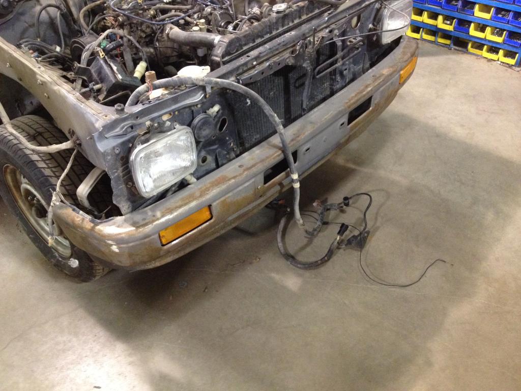

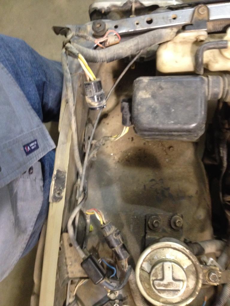

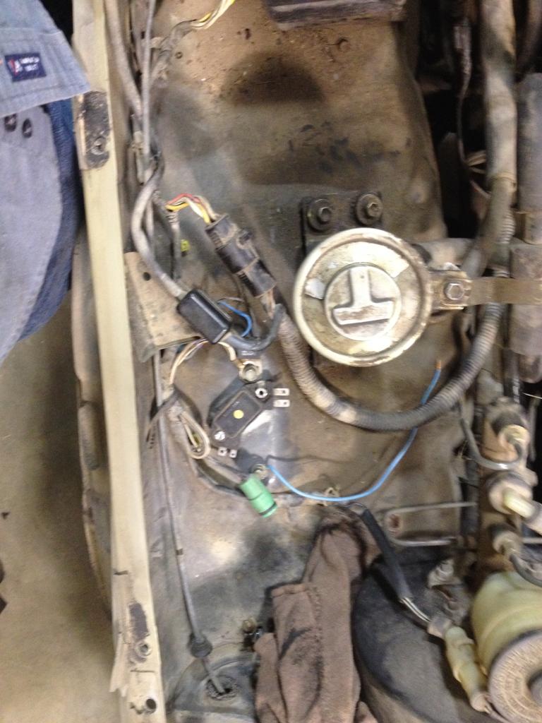

Also making progress with the wiring. We decided to pull the entire cab harness out of the 88 2wd donor truck that I have and swap it over to the 84 cab. Everything on this 84 cab is pretty hacked up as far as wiring goes and its hard to decipher what is going on. So if we can make it easier on ourselves then thats what we are going to do.
Started pulling the harness on the 88

This is where we stopped today.

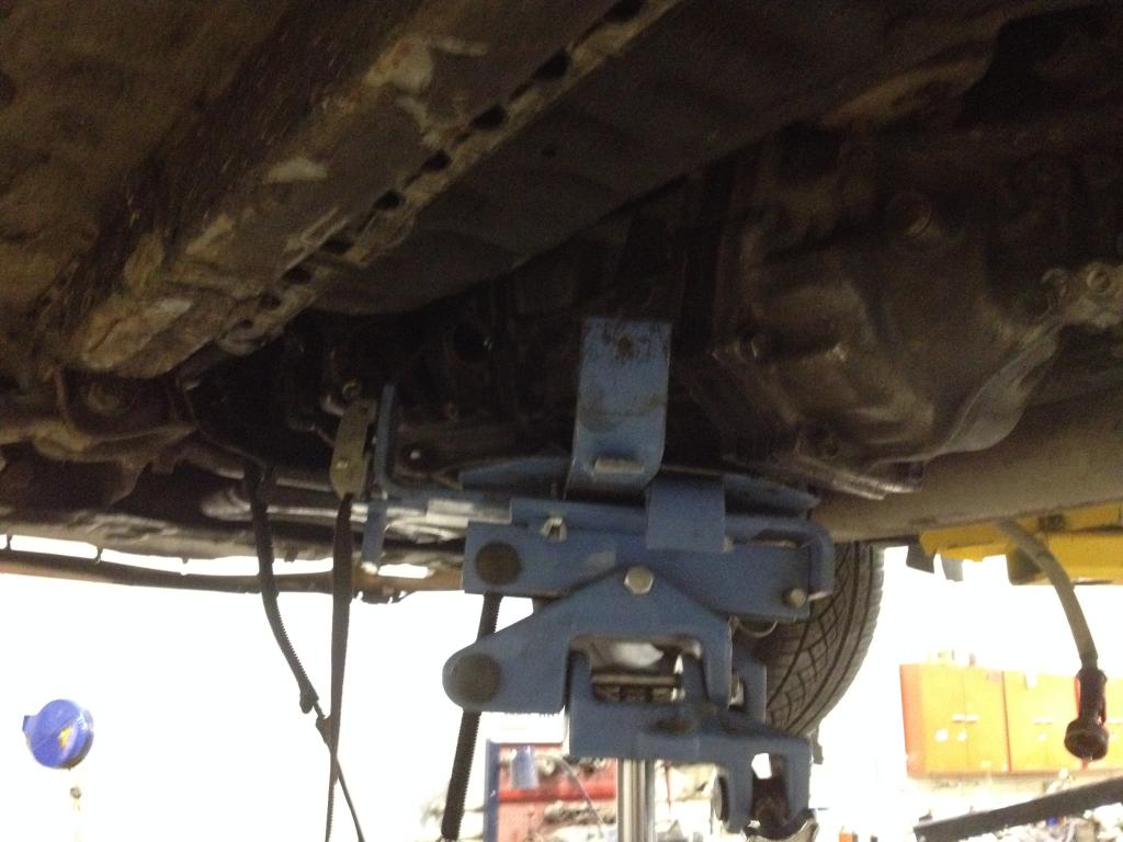

We were also dealing with this 89 supra at the moment. It is kicking out butts a little. We tore into the tranny for a clutch replacement and its being difficult.
The supra does not have the 7MGTE but rather a swapped in 1JZ twin Turbo. Now the goofy part is that the R154 trans will work but with a different bellhousing. Our problem is that the tranny does not want to drop down and clear the tunnel enough to come out. So tomorrow we are going to either slightly drop the cradle, or try and loosen the motor mounts while the crane is attached and lower it the 2" we need to get it out.

I started reading around on the forums and there are a lot of people who do not like these supras because they are a pain to work on. Im starting to see why. Haha.

Pulling the harness is a big job. Looking forward to your results. Here is a thread that might help if you get in a bind>>> https://www.yotatech.com/forums/f116...4-88-a-278925/
Thanks for the Link Terry!! We are going to have to most likely modify the harness in some areas to accommodate a few things along the way. Its not going too bad thus far but tomorrow could be a different story.
