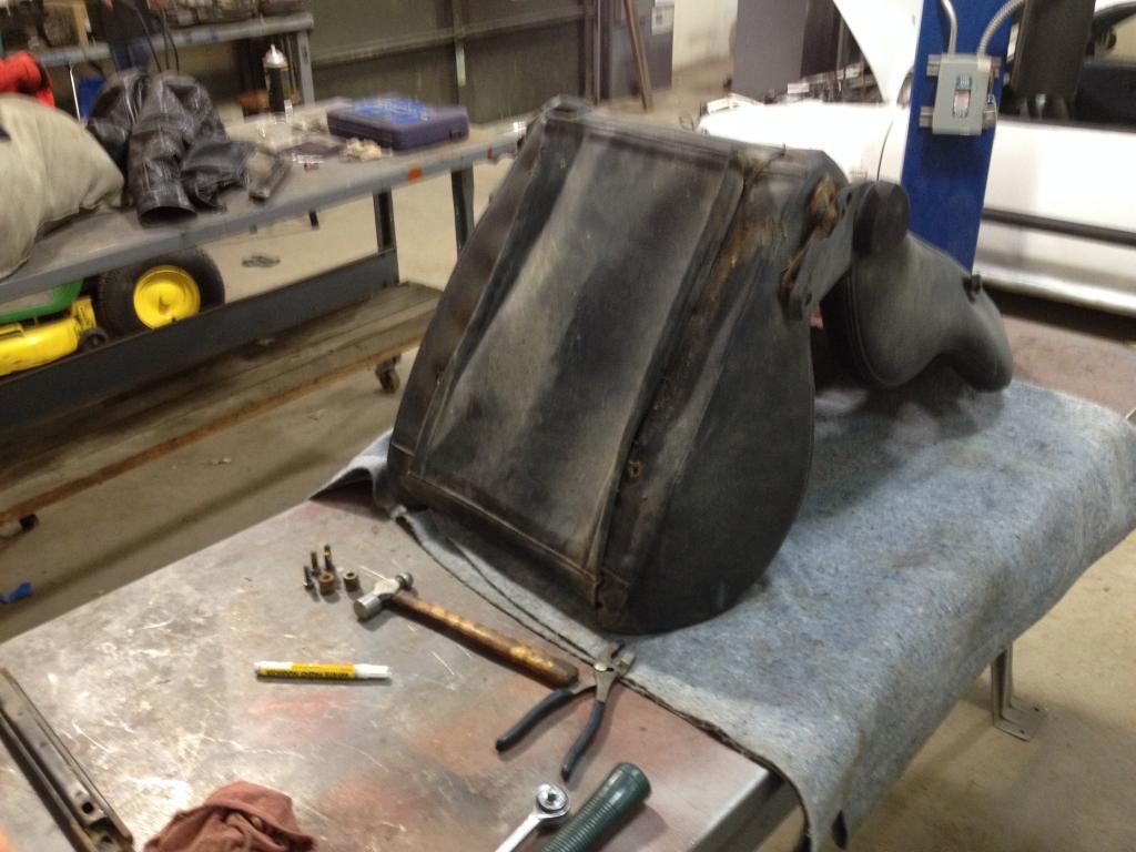

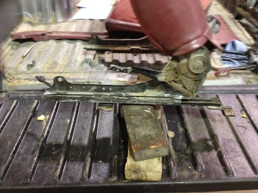

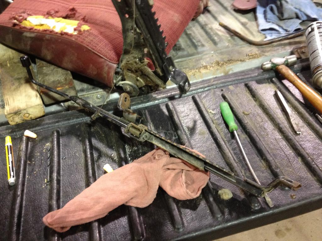

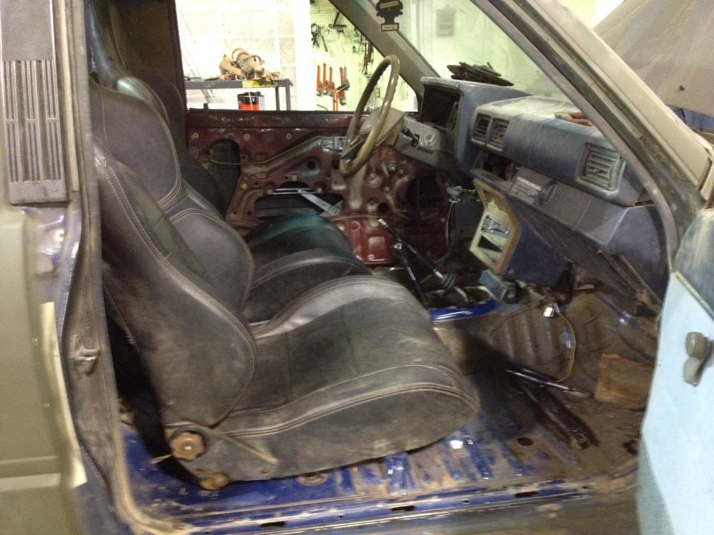

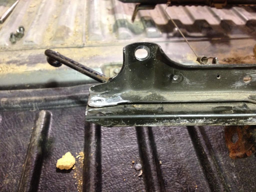

Most recently they have been trying to retrofit the new (used) seats into the cab via the stock mounts. I had an extra set of seats up stairs that are trashed and came out of my 4runner when I purchased it.
I have them cutting the old brackets apart so that we can attach them to the stock sliding seat brackets.
Kind of an Idea on where they are going to sit.

Separating the old brackets.

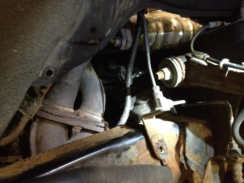

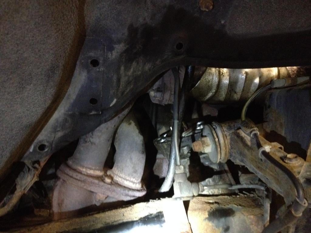

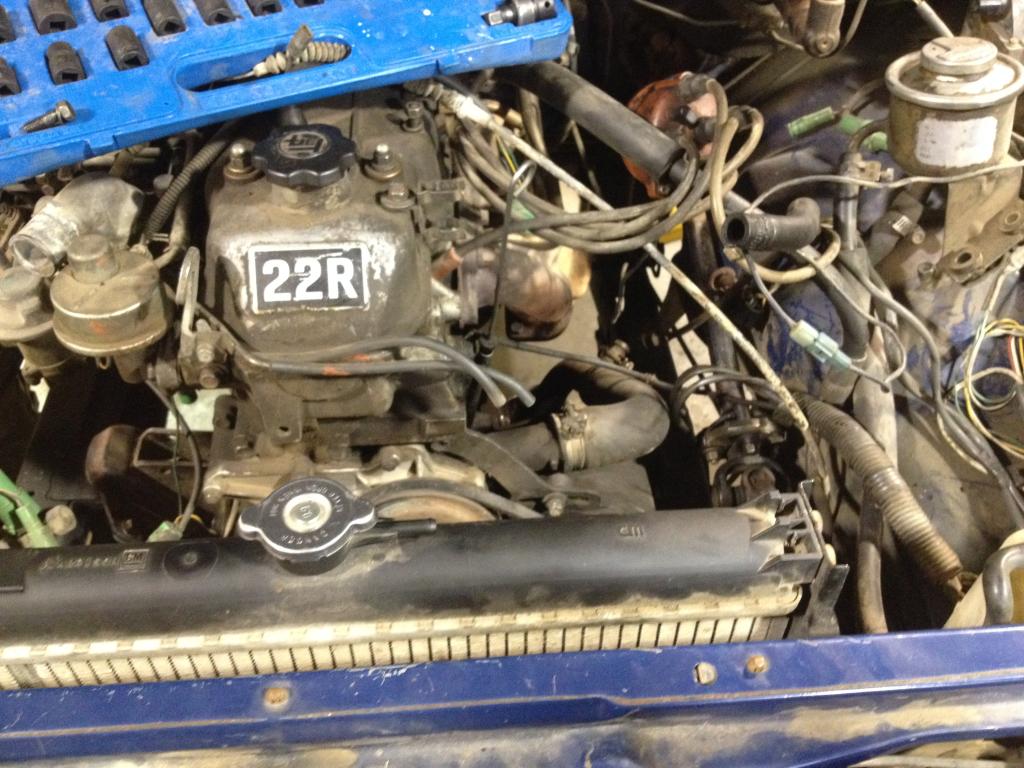

Most recently on another vehicle (99 4runner) has been the starter removal

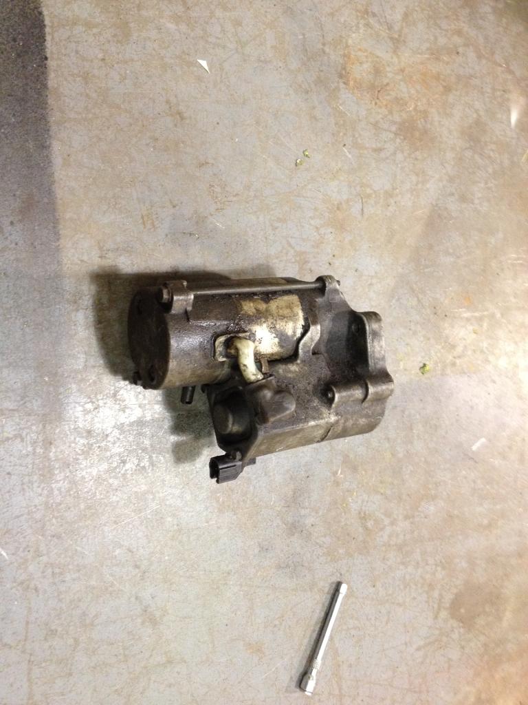

This was my first time removing a 3.4L starter. Let me tell you, it was kind of a pain.
Not very much room. Had to disconnect the brake likes on the frame and move them out of the way. Also had to loosen the tranny dipstick tube so it could be moved. Then disconnected some PS lines and was able to get it out.
I would seriously not like to do this on the side of the road.

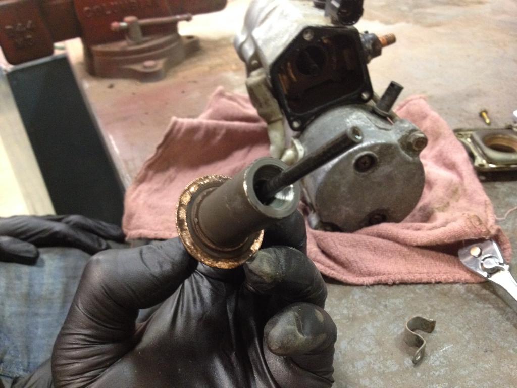

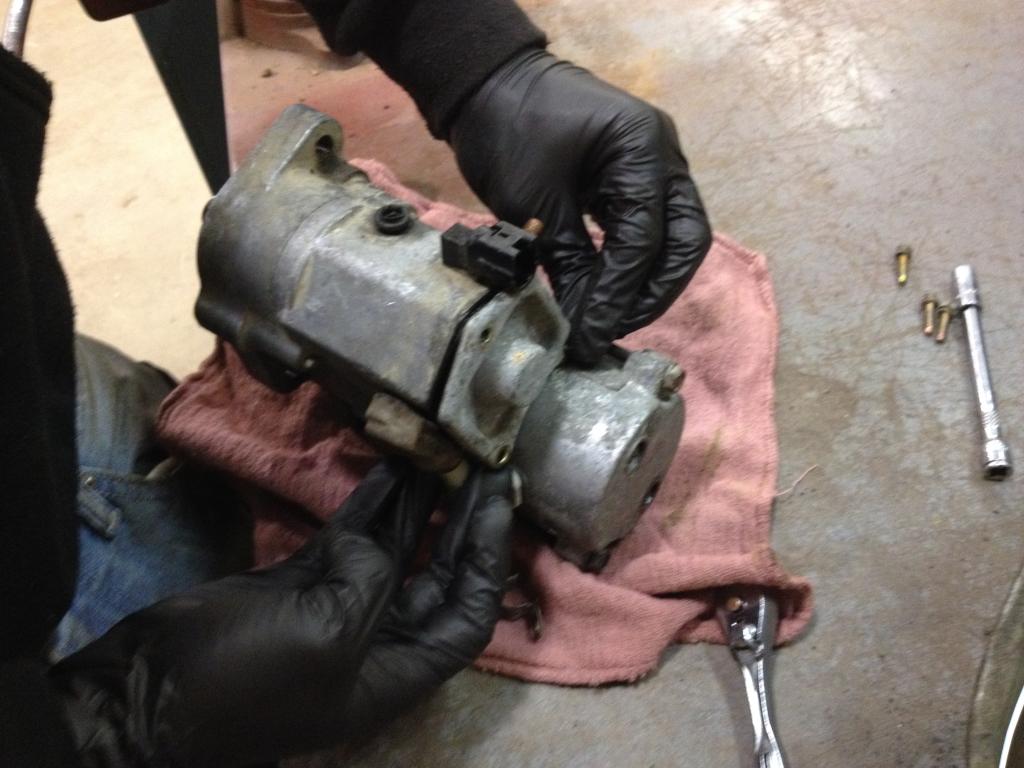

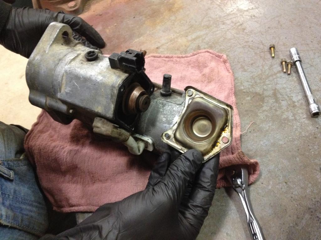

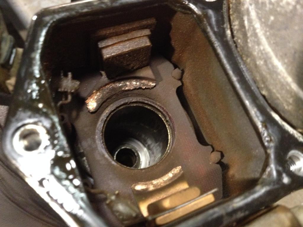

Finally got it out and started to tear it apart.
As I suspected, the contacts are all crusty and need to be replaced.

I need to get new contacts and a plunger assembly. I have called around everywhere and non of the local parts houses can get them.
There is a specialty place in Omaha. Old school guy that rebuilds starters, alternators, and generators that I am going to go talk to. Hopefully he has some stuff on hand.
Otherwise, I am going to have to order everything online and wait a few days to get it.

Seats look good,that sucks on the 3.4 starter replacement!

Thanks ED! They are Leather and look to be a recaro seat from the 90's or early 2000's. They are not in bad shape just need cleaned.

Thanks Chris! I really like the look of the seats also. They are super comfy too.

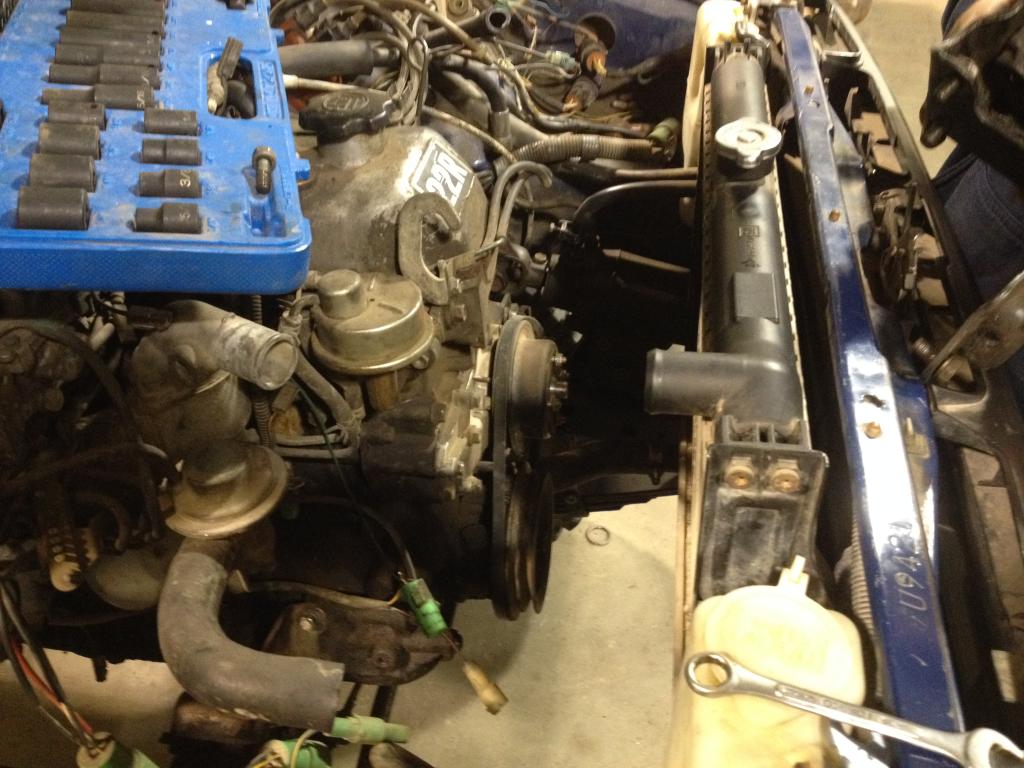

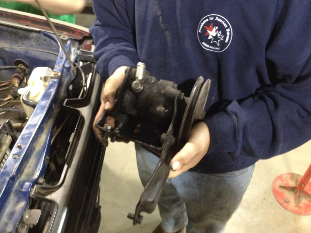

Also got the Power steering mounted up to this block from the donor one that we had. The old 81 truck did not have power steering and definitely going to want it with this truck. So we swapped the PS bracket and pump over to it.
One of my better students tackled the job in no time at all. Hes a bit of a wild child everywhere else but is great for me. Works really hard too no matter what the job is. Im hoping he continues to stick it out and I can try and get him fixed up with a job.

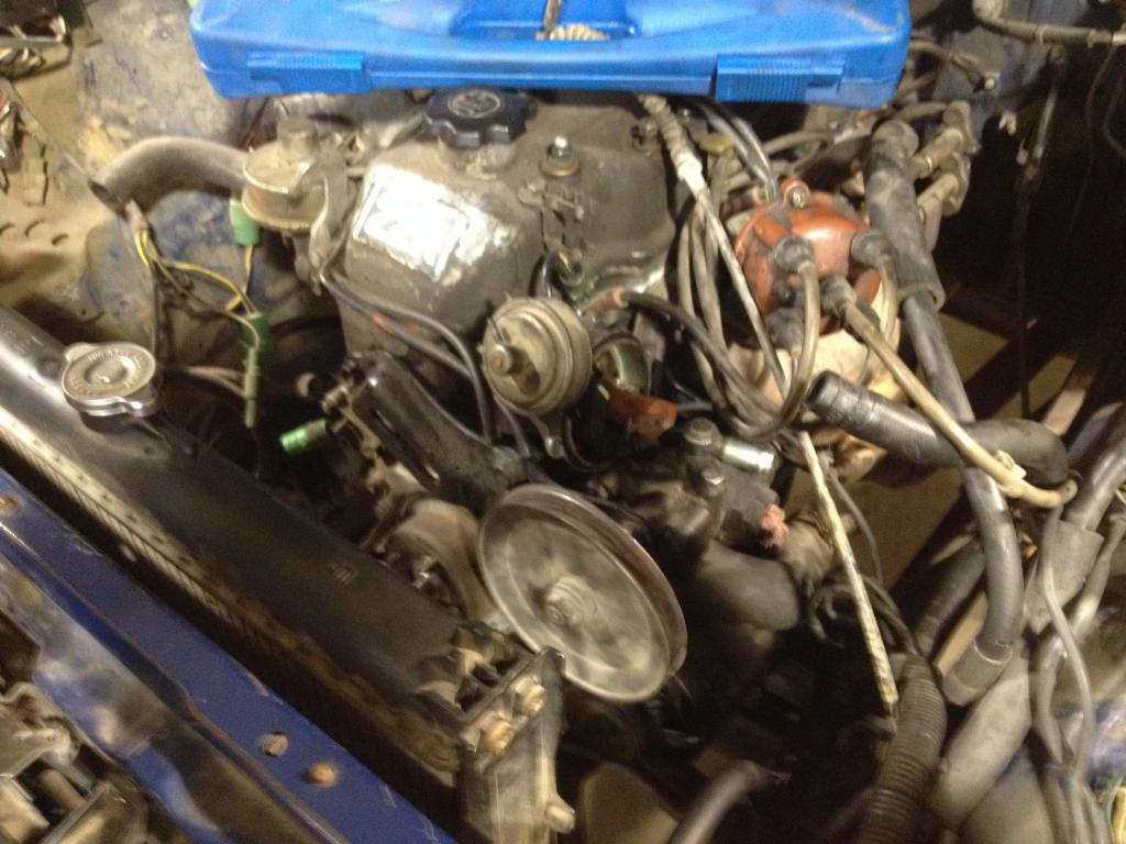

Installed
We need to get a new bearing for the tension-er pulley and it will be all done and ready to go.
