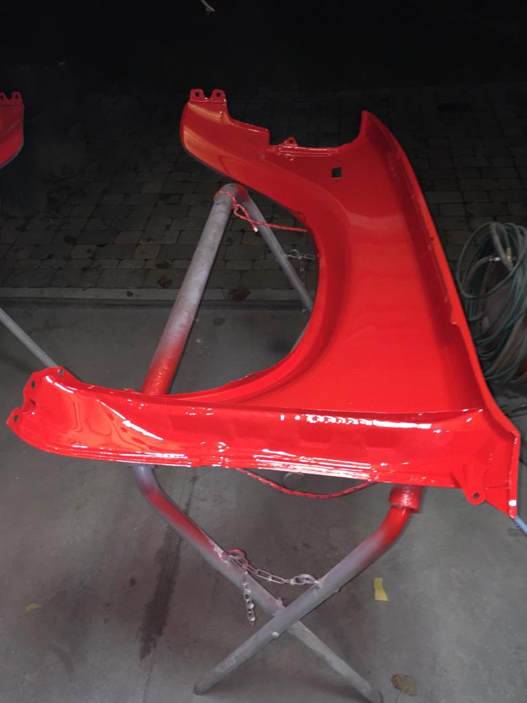

More photos for your viewing pleasure...

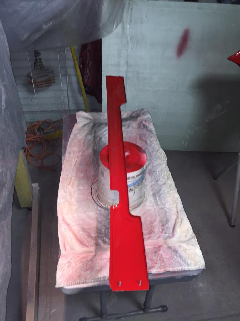

Seam sealed the folded edge of the fenders. I just used brushable seam sealer and masked the edges to get a neat straight line. Also seam sealed the back side of my plug welds in the emblem holes since they'll never be seen and I didn't feel it necessary to grind them flat:

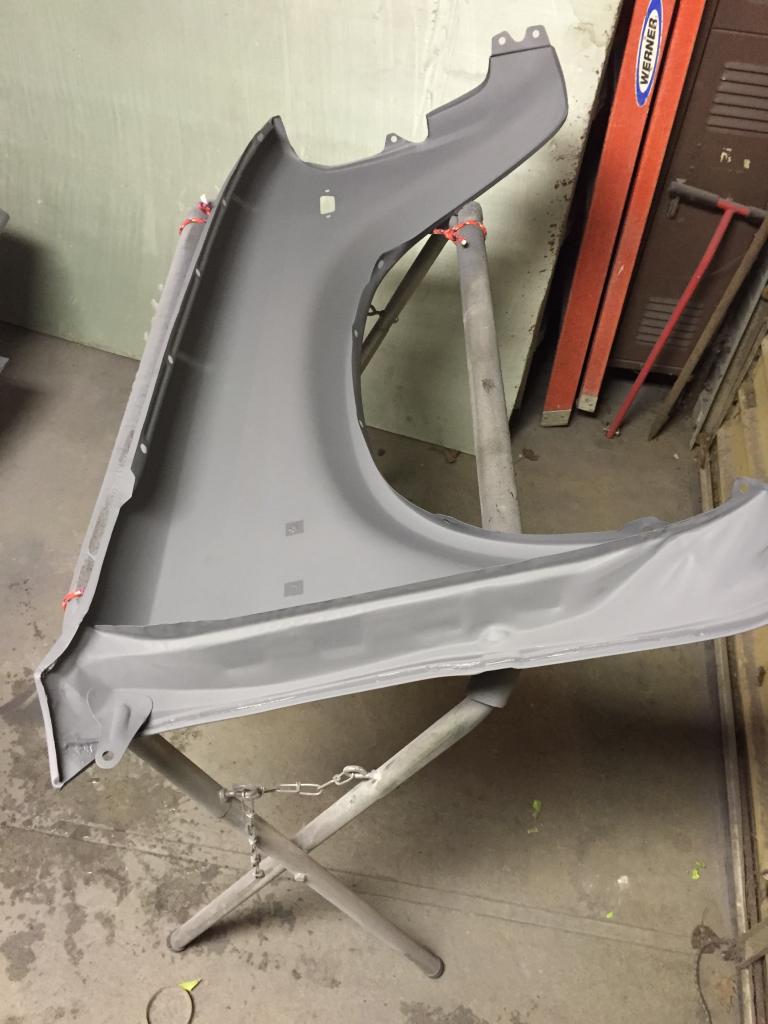

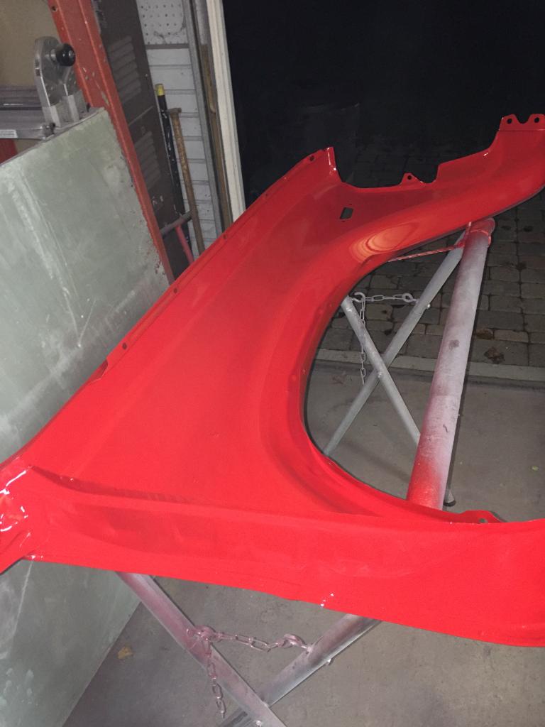

Then some color. I laid down three coats since I mixed up a little extra paint - at least it'll be some extra protection:

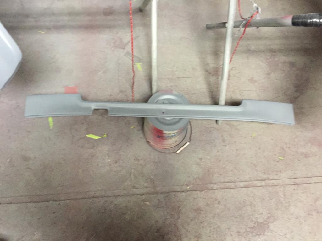

And the backside of the valance got some love too:

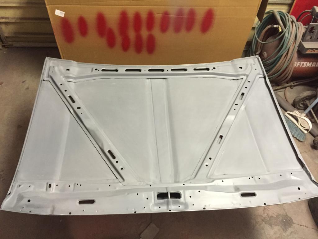

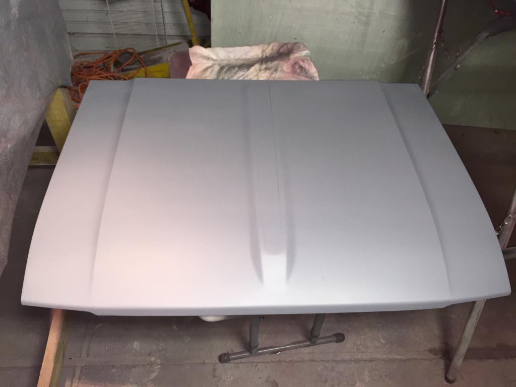

While I was waiting for the fenders to flash in between coats, I shot the hood with some urethane surfacer (perks of having multiple guns). My panels are pretty straight and I'm not looking for that perfect "laser straight" show car finish on the concourse at Pebble Beach so it's not absolutely necessary to spray surfacer, but it does help eliminate any small pin holes I may have missed and sands a lot easier prior to top coating. Plus it helps with color hold out and uniformity.
I have to wait for the paint and primer to cure so I'll probably give the hood and fenders a couple days rest before proceeding on them. Meanwhile, I'll likely tackle the seam sealer on the doors and inside of the cab.

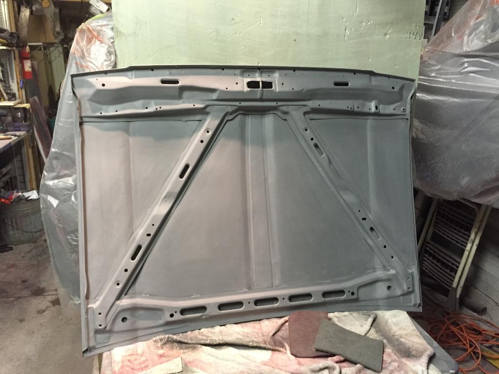

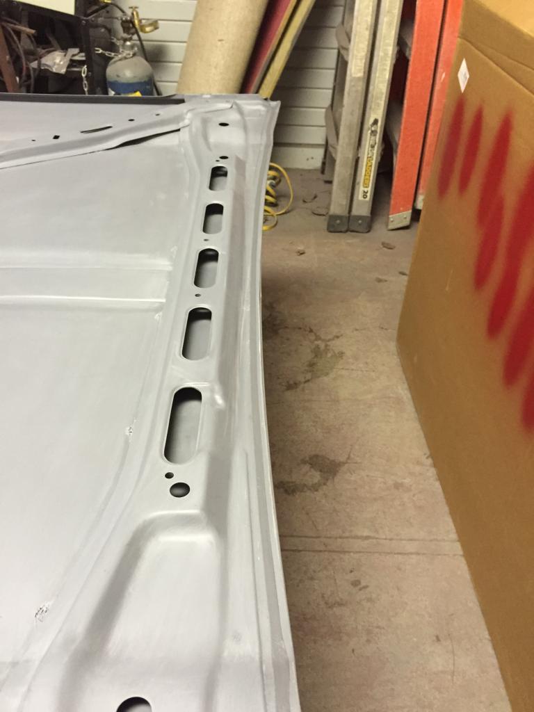

Underside of the hood sanded to 320 grit dry and then to just shy of 600 with a grey scotchbrite pad:
What a PITA! All the nooks and crannies of the braces and such took a while to get completely sanded, but it's ready for some color - hopefully tomorrow night, but the O's are playing game 1 of the ALDS so I'll have to wait until at least after the game.

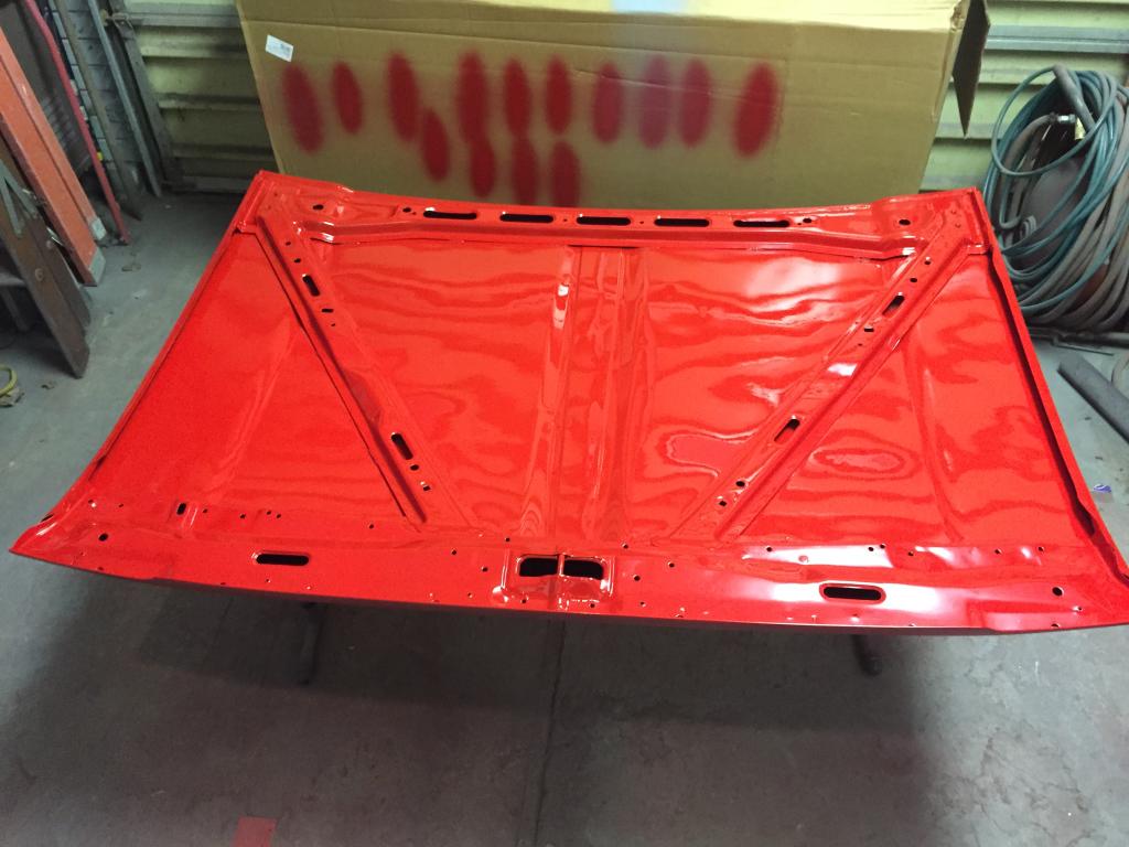

Here we go again...
Seam sealed the hood:
And colored between the lines a little:
Paint laid down reeeeeally nice, but unfortunately I had some dust trapped in the braces that ended up in my paint. Despite blowing it out and tack clothing it for nearly a half hour, it still happened. Luckily it's just very light sanding dust so it will wet sand out really easily, if I even worry about it at all - after all, it's not like it's the top of the hood so it won't be seen much. Knowing my OCD behavior, I'll end up sanding and polishing it smooth....

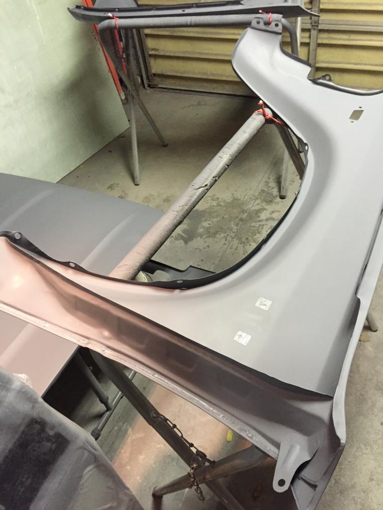

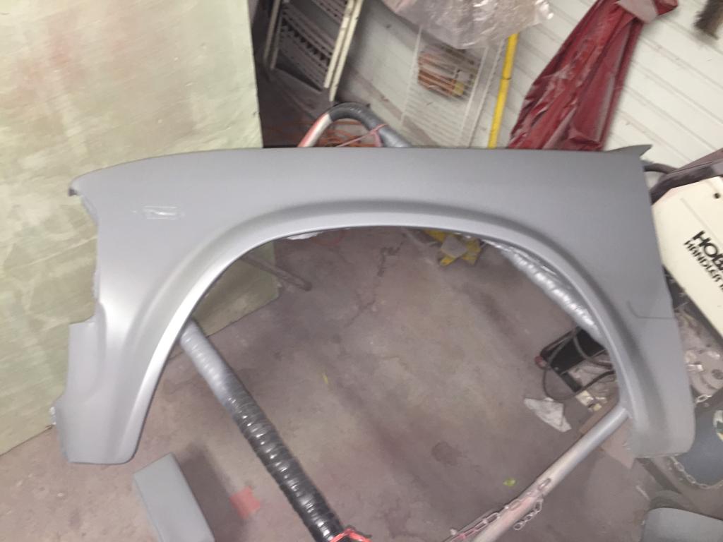

Epoxied the outside of the fenders tonight:
The valance also:
Tomorrow the surfacer will go down. I must say, this really sucks painting piece by piece - prep, spray, flash, spray, clean up... Over and over and over! But it's the only way I can go right now so I have to deal with it I suppose
