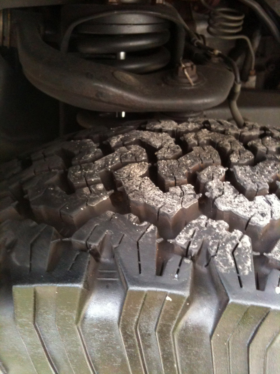

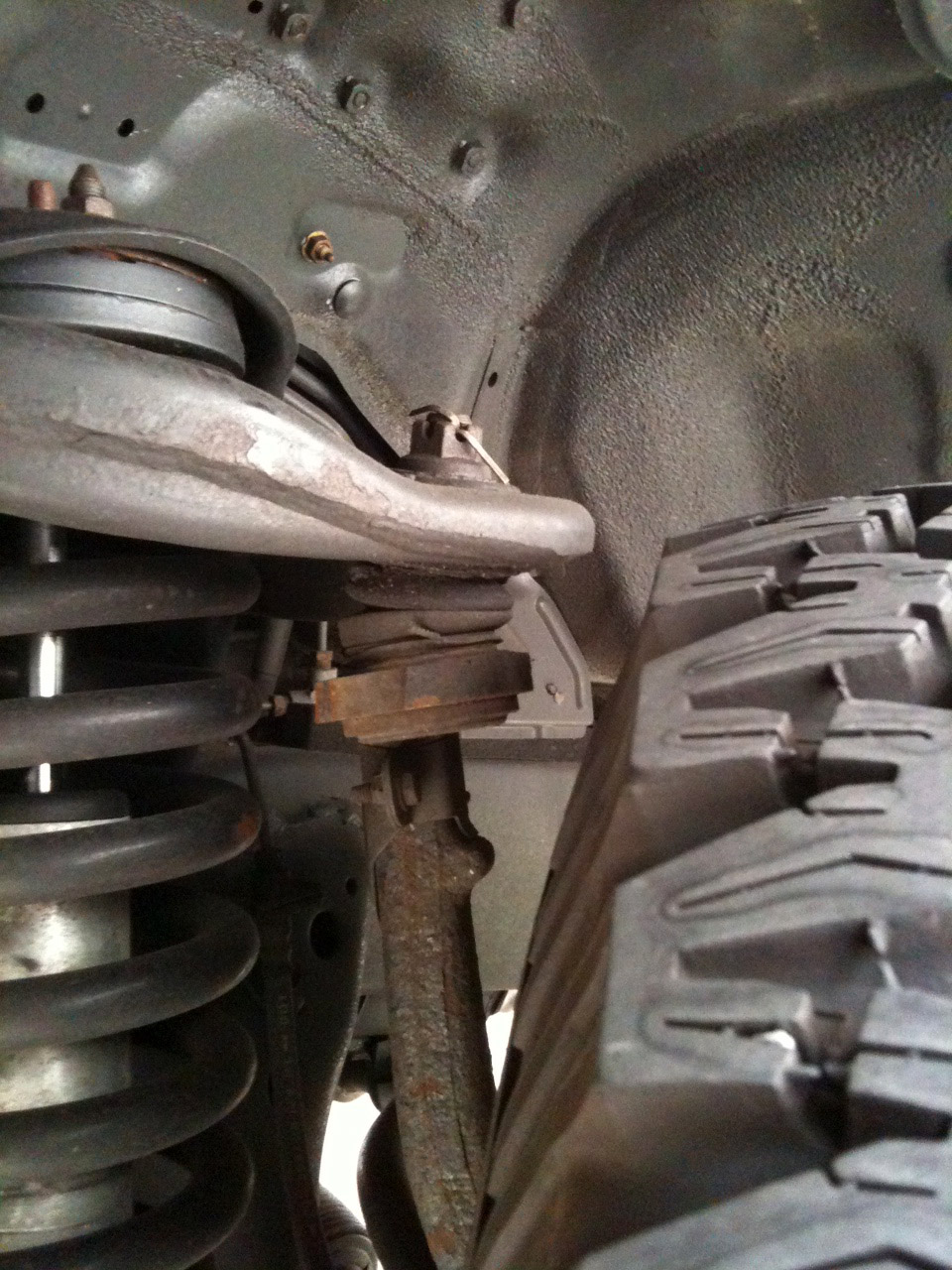

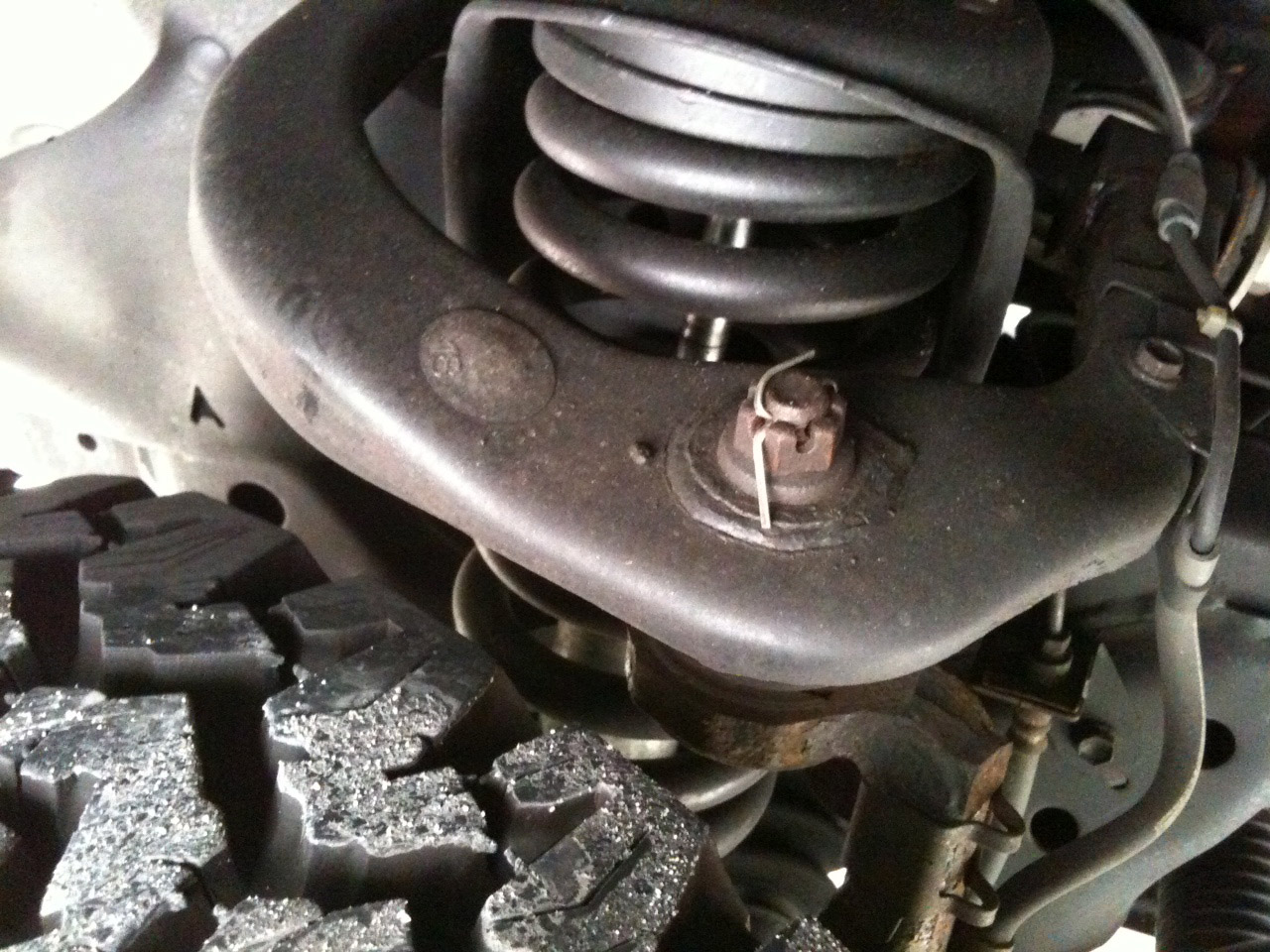

I have the Sonoran Steel System 7.2 Suspension on my 2002 4Runner -
About: 2.5" Front & 3" Rear.
http://www.sonoransteel.com/index.ph...&products_id=4
I currently have on the BFGoodrich All-Terrain T/A KO Tires 265/75R16.
My question is can i go up to the next size BFGoodrich Mud-Terrain T/A KM 255/85/16?
Will they fit without any rubbing? I live in PA and wheel spacers are illegal. I have attached a few photos with my current tires.
With 255/85/16 tires can i get away without re-gearing?
Some photos of my current tires and the space i have right now -
http://4.bp.blogspot.com/-LwMrytalKi...NER-tires1.JPG
http://1.bp.blogspot.com/-dStLvnf8oU...NER-tires2.JPG
http://2.bp.blogspot.com/-IUYh7ILp7Q...NER-tires3.JPG
Thanks!
- JON

Best answer is to measure and see on the tire fitment:
http://www.4crawler.com/4x4/ForSale/...it.shtml#FAQ10
As noted, make up a little measuring block out of a scrap of wood or cardboard. The size will be 1/2 the added tire height and 1/2 the added tire width over what you now have. Why the 1/2 factor? Well tire diameter is twice the radius or distance from the center to the outside. So half the added height is below the axle and half above. Same idea on the width, half the added width is on the inside of the tire and half on the outside, measured off the wheel center line.
With block in hand, move it all over the face of the tread, edge to edge and find where the tight spots are with the fender and wheel well. For the front tires, try turning the wheels side to side and find the worst case condition with the edges of the tread the the wheel well and fender. And finally, try to flex the suspension by driving up on a curb or some ramps and turn the wheels to get an idea where rubbing might occur, if any. If you find adequate clearance all around, you should probably be fine with the new tires. If there is some minor rubbing, this may or may not be an issue, depending on the new tire and how true to size it is and even what it's shape is when mounted on your wheels. Some minor rubbing might be solved by doing some trimming/bending inside the wheel well, most often this involves the standing seam where the firewall and fender join in the back of the front wheel well. This is behind the plastic liner and is easily hammered flat to gain extra clearance.

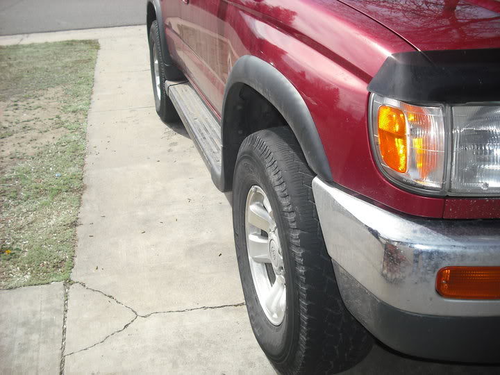

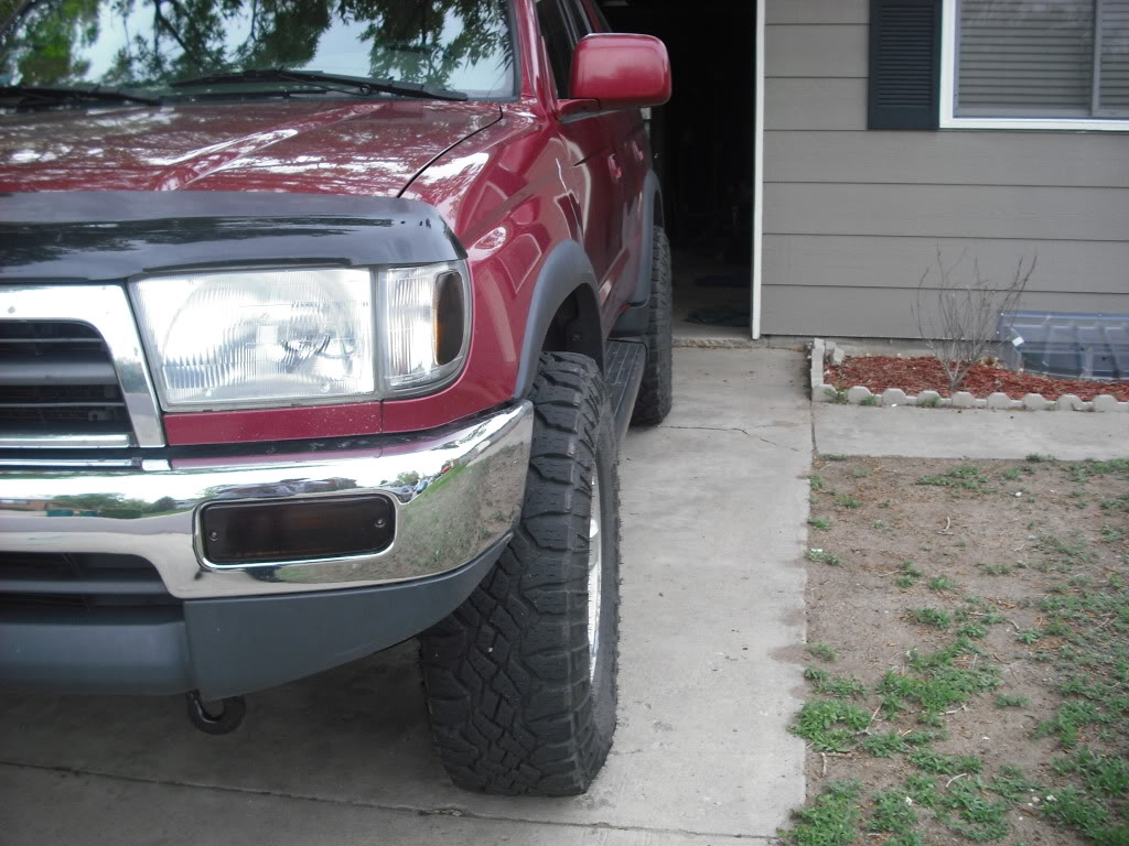

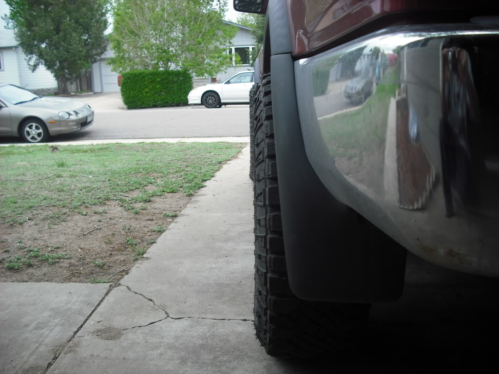

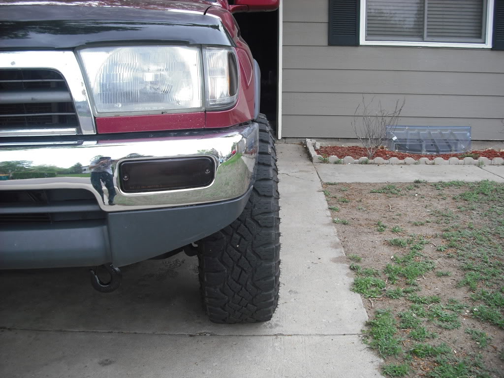

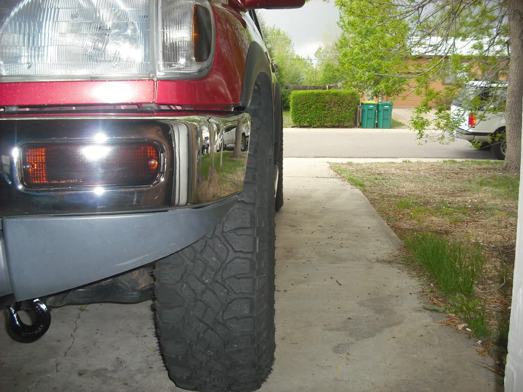

I think this may be the correct thread to post this on.... I have YET to find pics (and i have SCOURED the internet) of a STOCK suspension, 3rd Gen 4Runner, with 265/75/16.... WITH SPIDERTRAX wheel spacers..3rd GEN 4RUNNER w/ WHEEL SPACERS... i DID it.. HERE are the pics. I skipped pics of installation, we all know how to put wheel spacers on right?
BEFORE
AFTER
AFTER
BEFORE
