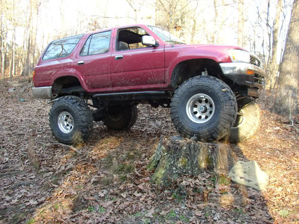

Finally got an updated picture. Its not the best and kind of dirty. Should have all the part I need to finish it in the mail other than the seat covers. I bought another truck today for some reason. Looks like im going to have to sell some of these toys.
