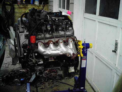

I picked up the engine yesterday. It is a 04 5.3. After trying to test fit this I am wondering what in the world I was thinking. The engine without a fan is 28.5" and from the radiator to the firewall is 29".

Old Mar 28, 2007 | 04:44 PM
  #37
mastacox's Avatar
Joined: Dec 2003
Posts: 2,893
From: Fort Worth, TX
Sawzall Time!!!
