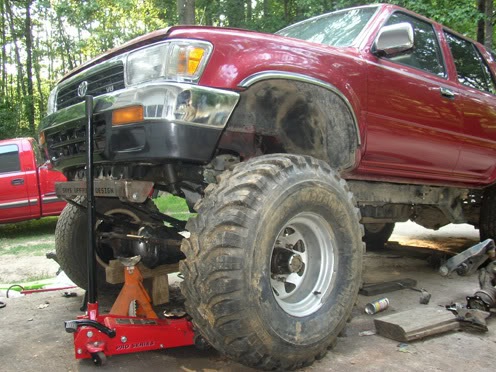

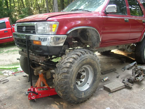

Old Jul 4, 2007 | 02:54 PM
  #80
blazerboy72's Avatar
Joined: Feb 2007
Posts: 193
Finally got the front axle in and the body lift on. I bolted on one of my 38's from my blazer just to see what size tires I need to be looking for. Now its time to start on the rear.
