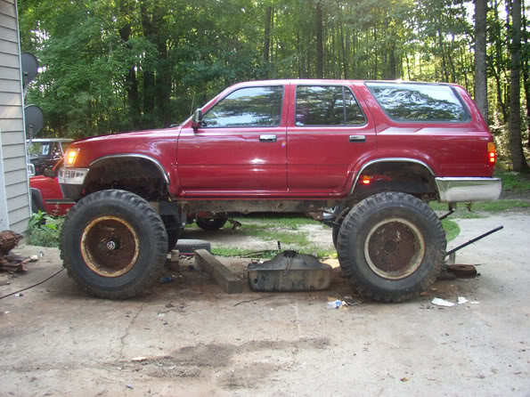

I test fit some 42's today. Looks like i will be running atleast 38's.

then after your tires you need to invest in a ladder or you pole vault into that hehehe looks badass thats for sure

holy mother of weird looking wheels! lol.
Go 38's with some 16 or 17" wheels so it doesn't look so awkward.

lol. The are off of a tractor trailer. My dad had the recentered. That was back before 44's came out when he was mud racing and this was the largest tire readily available,

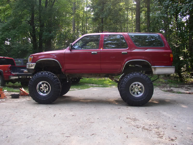

My tires and wheels came in today.

HOLY big tires batman!!!!
