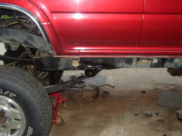

Here is the best picture of the fan I could get:

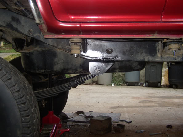

and two pictures of the raised gas tank:
With the 31's on it has 24" of clearance under the tank, so with the 38's I should have around 28"s.

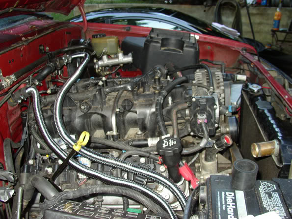

Im making progress, just very slowly. I got the heater hoses and the lower radiator hose done today. Why do the make stainless steel radiator hoses in every colr but black? I am the only one that wants a black radiator hose? The upper hose, gas pedal, tac modulem and some other stuff will be here this week. After that is all done I will have the steering, brakes, and driveshafts to finish. Here are the latest under hood pics (yes I know the hoses are ugly and I still have a mess to straighten out):
