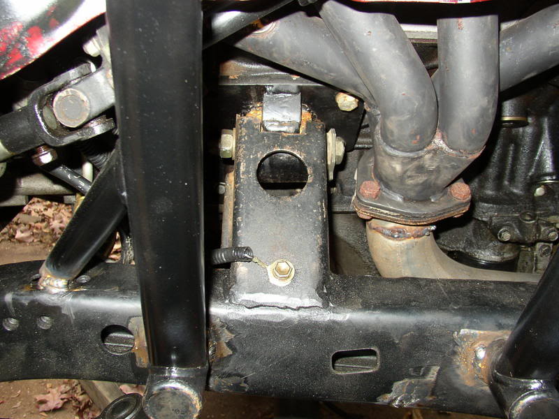

can you e-mail me some good pics of the clearances of the steering and the motor mounts....also did you use the Toyota accessories or the Chevy??

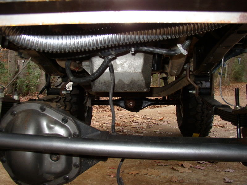

how'd you lift the gas tank? any pics of mounting/brackets?

I cut the brackets in half took 3 inches out and rewelded it. For the front I made a new bracket to go on top of the crossmember instead of under it.
Here are the pics of the motor mounts and steering. The motor mount is the stock control arm mount off of the rear.
