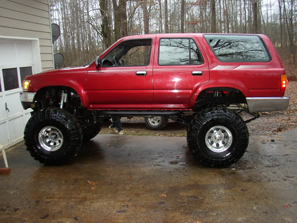

Finally got some clean pics. (dont tell anybody there is a water ban in georgia)

Took it for its test run yesterday. Everything worked better than I expected. The lockers take a lot of fun out of it but they worked great. I never had to use 4wd but I did once or twice just to see what it would do.

awesome. hows the flex?

it seemed pretty good. I never got it flexed all the way out but it did better than I expected. Everyone wanted to ride no one would take pictures so I dont have any pics.
