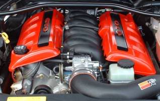

Here's my LS1 :

Originally Posted by rdlsz24
Here's my LS1 :
Rob
Yours looks better than mine, and appears to be an ls2. I wish I could afford one of those but I will stick with the lm7 for now.
That's the LS1 in my '04 GTO. I painted the fuel rail covers myself.
Rob
