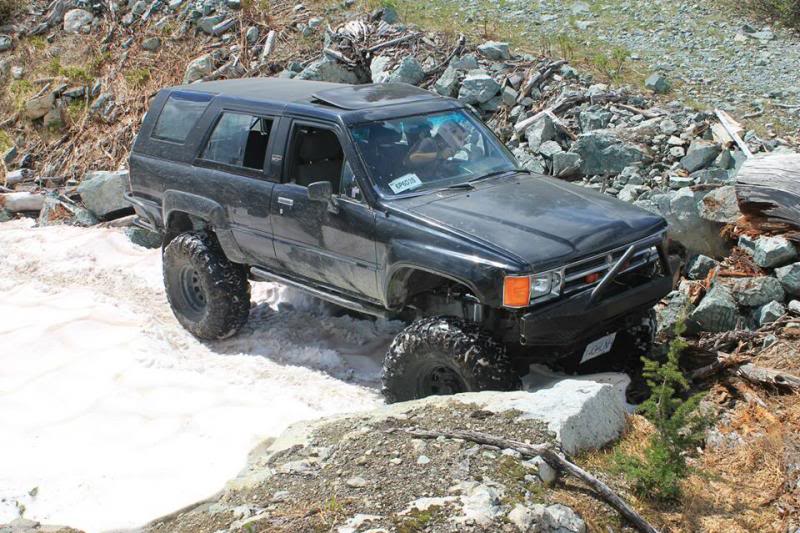

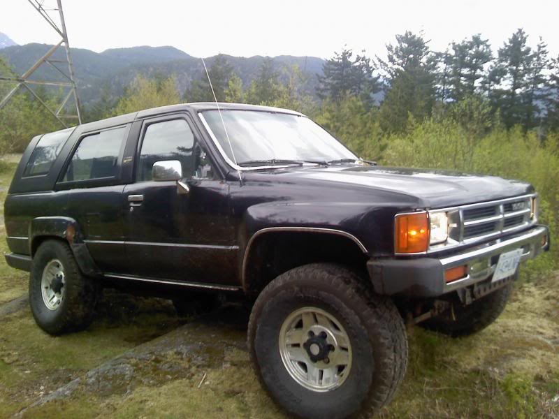

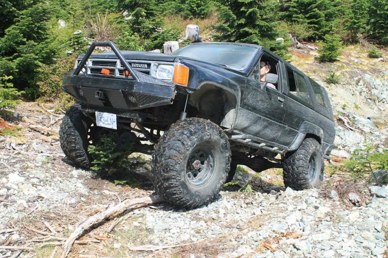

Sas Vol.2.0
Front:
Sky MFG hanger kit-1" position
44044 springs up front with a leaf removed
Sky boomerang shackles
RS-9000's
TG High-steer
Dirty 30's
5.29s with a Lock-right
Rear:
TG 5" springs with 2 leaves removed
6" shackles
BDS shocks
Manual proportioning valve
5.29's and a spool...
4.7 geared T/Case, TG rear bumper, Slider's, Diff armor
Custom fabbed front bumper...I sure do miss driving the 4runner, should have worn that helmet.. Not much longer

dang thats one beefy front bumper. did you build that yourself?

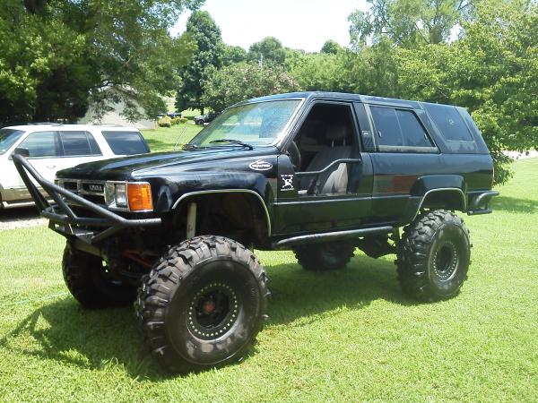

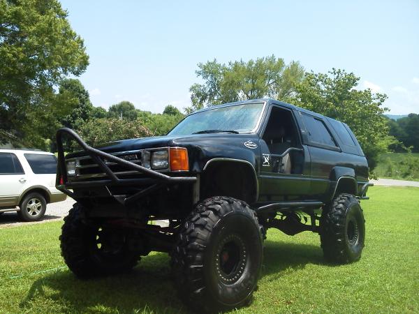

Shine runners 87 sas
trail gear front kit with 3" front springs with leaves added and removed, 5.29 with 38-12.50 TSL, long spline schdl 40 front shaft and schdl 40 rear 4.7 with duals trail gear bumpers and sliders pro comp 4" rear springs with leaves removed and others added,rotated rear housing,and lots of other good stuff. i still got to cut out the rear fenders
Attached Thumbnails Post up your SAS pics and specs-shine-runner-albums-shine-runners-rig-picture30957-img-20130712-124601.jpg   Post up your SAS pics and specs-shine-runner-albums-shine-runners-rig-picture30956-img-20130712-124529.jpg

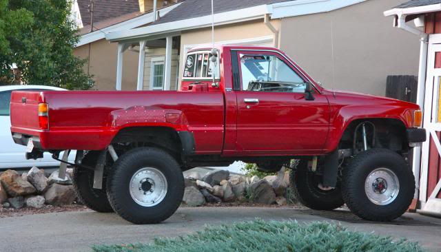

3 inch Trail Gear SAS front, 3 inch NWOR rear + added leafs and 6 in shackles.Name:  2013-07-18184705_2_zps3b698e28.jpg
5 days completed.

Looks great! What size tires you plan on running?

Eventually 35's . And some steel rims, black.

Nice rig man. Yeah I think those wheels are killing ur truck bud. What are those center lines?
Why do all these SASed trucks sit high in the front?

They are high, but the springs should settle 2 inches or so. What can I say. 35's when I can afford it.

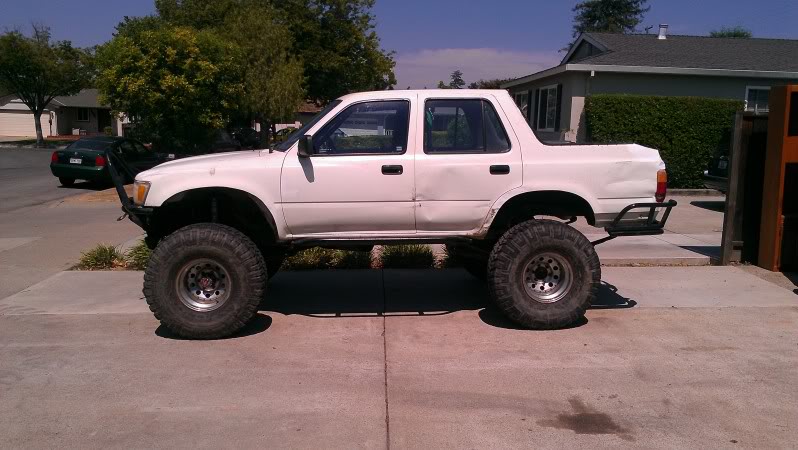

Here is my latest...
TG 3" front/4" rear
37's (with trimming)

Nice! I like the bobbed 4door runners!

Thats a looker

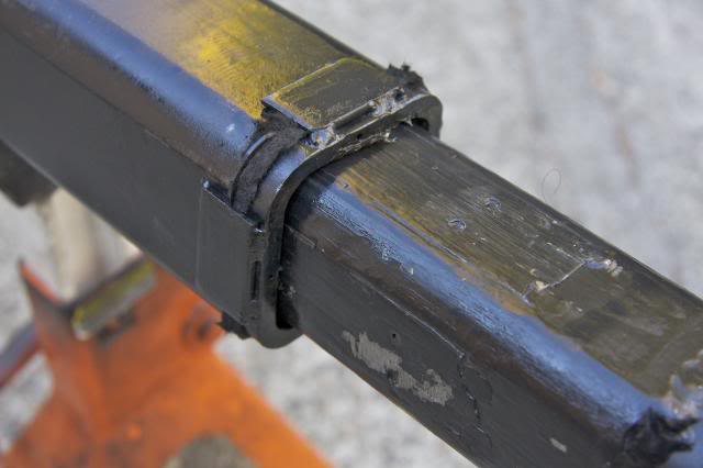

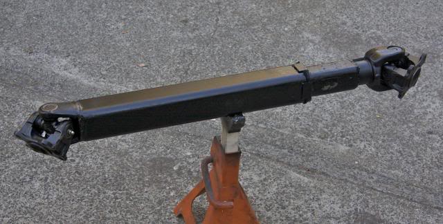

Square F D S..

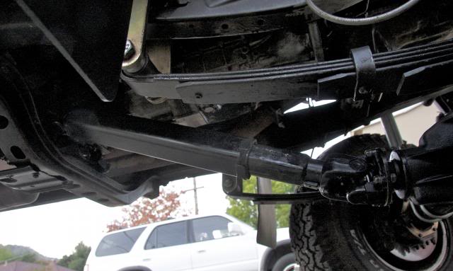

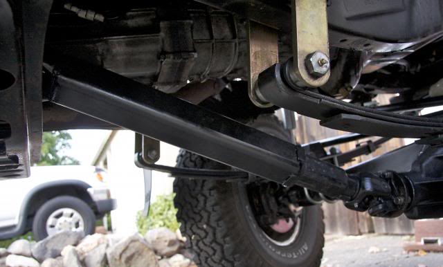

Old Nov 6, 2013 | 03:58 PM
  #200
Teuf's Avatar
Posts: 5,592
Likes: 24
From: Dixon, Ca

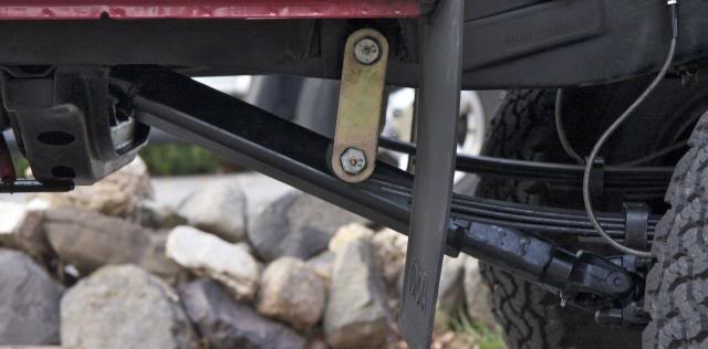

FDS on.........Name:  IMG_2407_zps3782b91f.jpg
