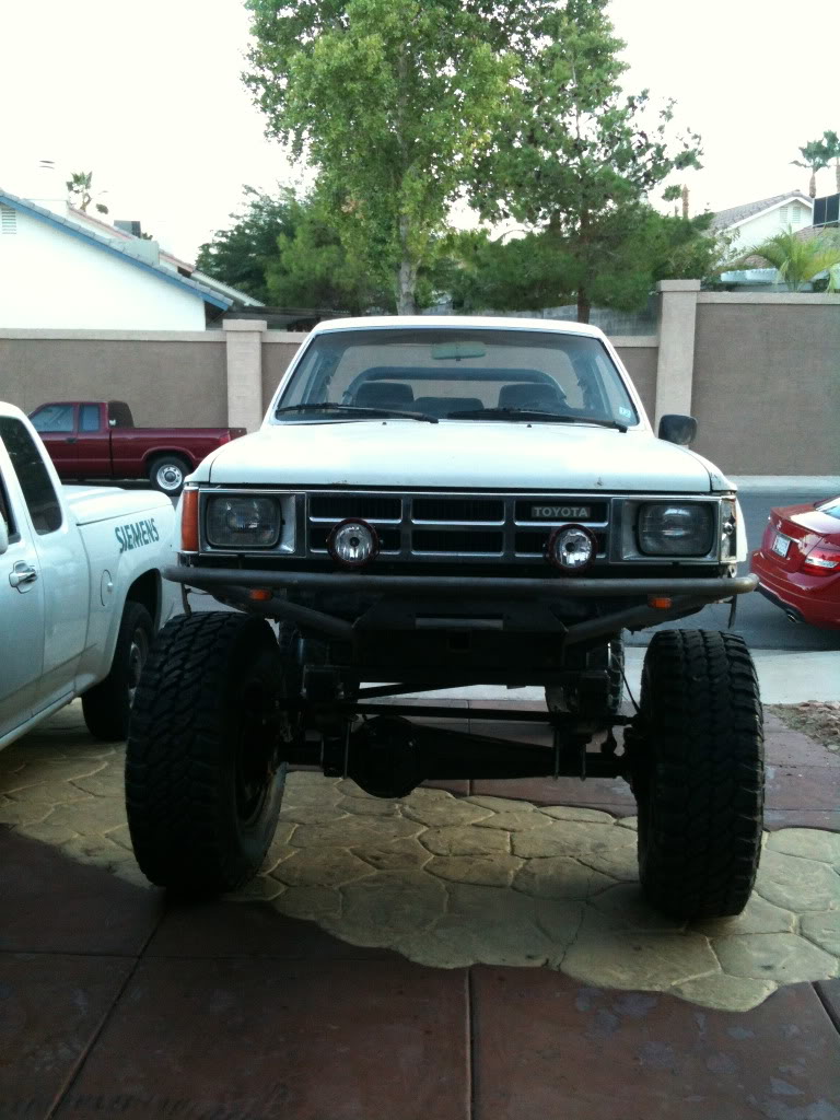

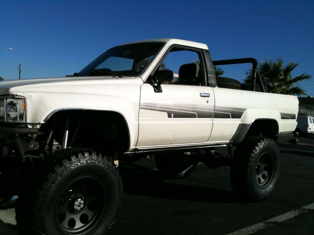

86 Runner
Longs
4.70 tcase
detroit front locker
g2 5.29s
chromo hub gears
35x12.50x17 pro comp wheels and tires
tg 4" front 5" rear

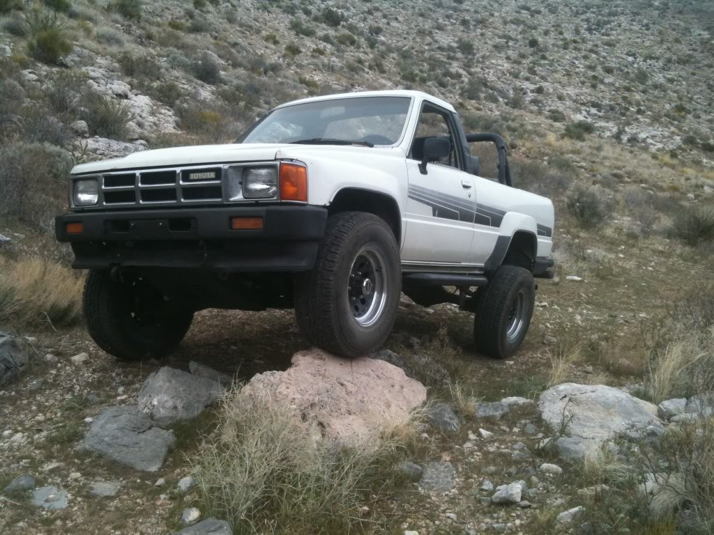

this was stock

That thing is nice!! Liked it before and after. You build it or buy it??

I did everything besides the diffs. My buddies let me use their shop, working on a lift makes everything a lot easier. After I posted those pics I realized how nice it looked stock. Thanks for looking.

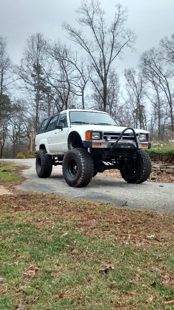

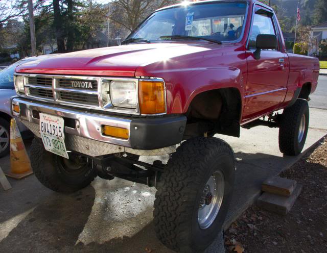

My 88. The 3 inch SAS is settling in. 33's. I may need to install 1 additional leaf in the rear, each side. And or will be getting 4 inch rear springs soon. We will see. My current set up is NWOR 3 inch rear, then I added 2 flat leafs and a half inch block on each side, oh and 6 inch shackles.Name:  IMG_2553_zps0c998e2a.jpg

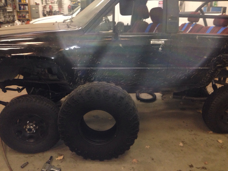

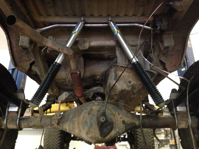

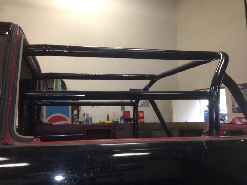

1986 runner... Has 63 inch chevy springs.... SAS ... Custom roll cage with 5 point harnesses.... Have w56 sitting on the floor waiting to go in along with doubler.... Just got some 37 inch iroks... Oh and I work for lincoln electric so naturally it has a lincoln locker in the rear 😃

I see that NH plate on there. Haha.
Why not just pull a leaf out of the front pack?

I like the ride quality. Besides its an excuse to get the true 4" rear leafs.

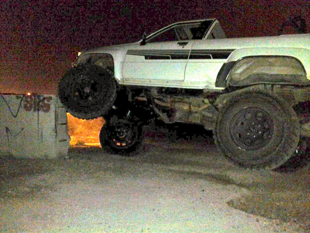

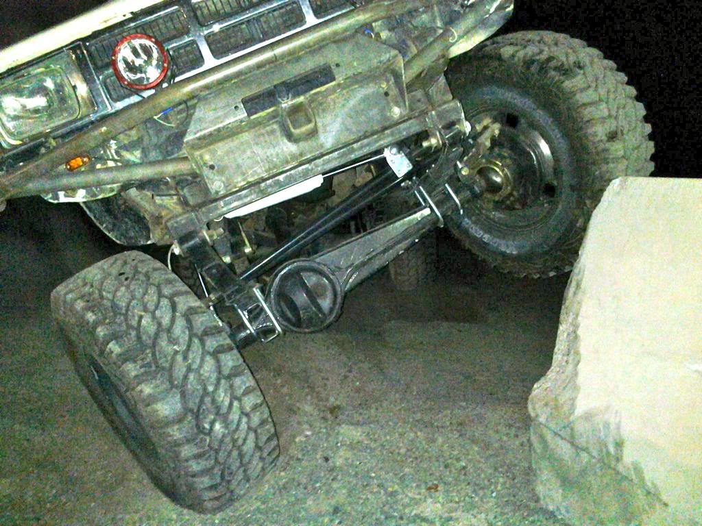

1987 4Runner SAS
'85 front axle, stock rear
RUF, 63" Chevy springs rear
5.29 gears, TG 4.7 t-case
Lockright in the rear, welded up front
Two inches is hell at 100 mph

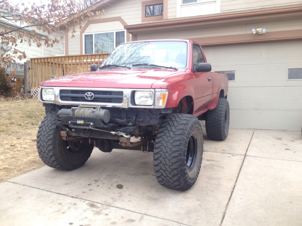

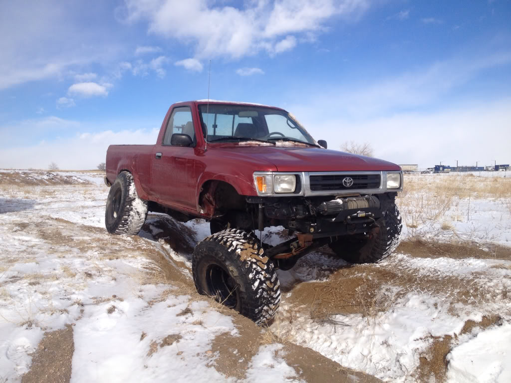

92 pickup, 48" RUF, stock rear, one leaf added all around, 5" shackles, 5.29s, detroit front, spool rear, high steer, low and slow on 35s
still need to slap the duals in, bob, armor
