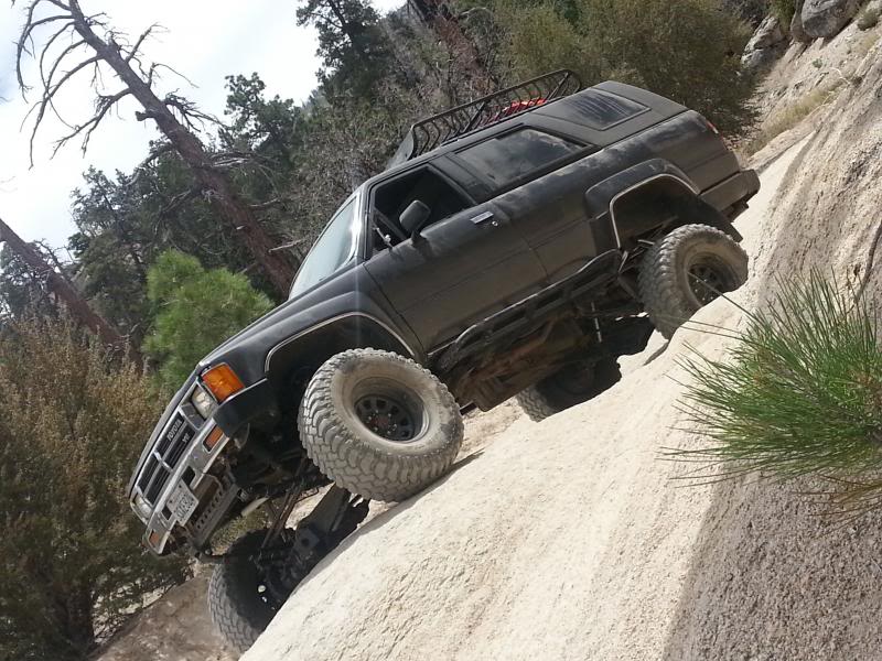

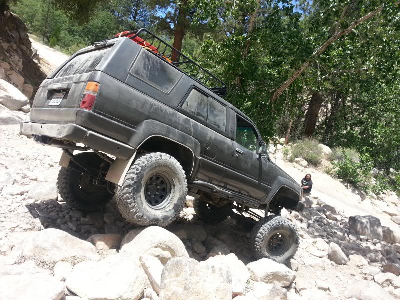

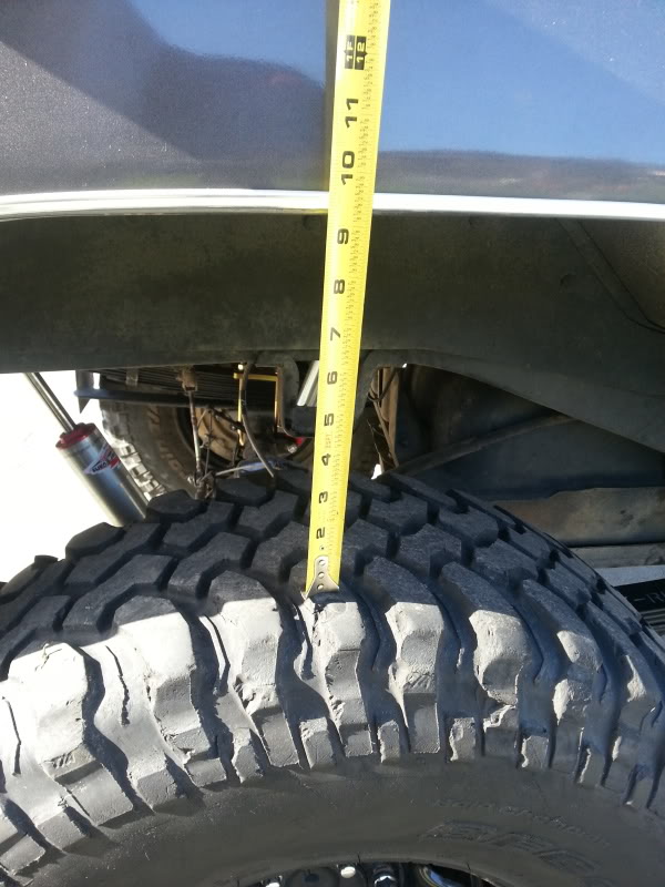

From: Los Angeles CA

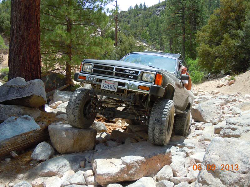

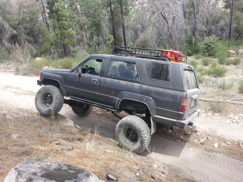

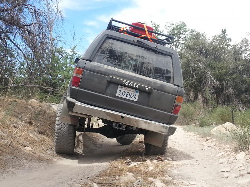

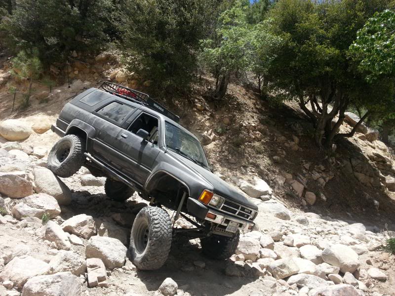

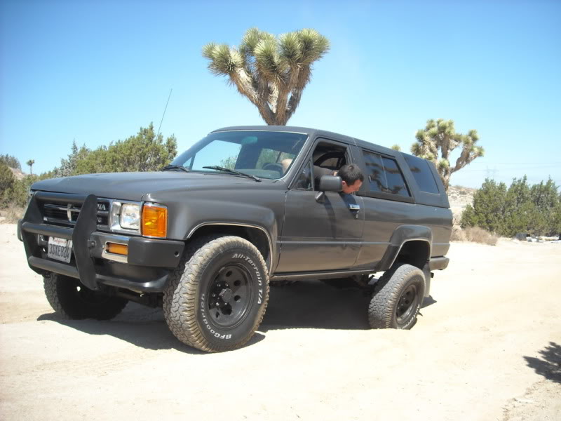

1989 3.0 V6 4Runner
- SAS'd with a 1985 toyota pickup front axle.
- Used the All-Pro Off-Road SAS ifs eliminator kit
- Trailgear diff armor
- Trail gear Trail Creeper 4.88 gears
- Front and Rear Spartan Lockers
- All-Pro Off-Road 4" lift
- V6 Caliper/rotor upgrades/1" bore Master Cylinder upgrade
- 15x8 Procomp Steel Wheels
- 33/12.5/15 BFG KM1 M/T's
- Walker Evan's shocks. 12" travel in the front & 10" travel in the rear
- 4xinnovations Rock Sliders
- Tahoe roof rack/Yakima Load Warrior Roof Basket with extension
***Custom rear plate bumper/tire carrier coming soon.***

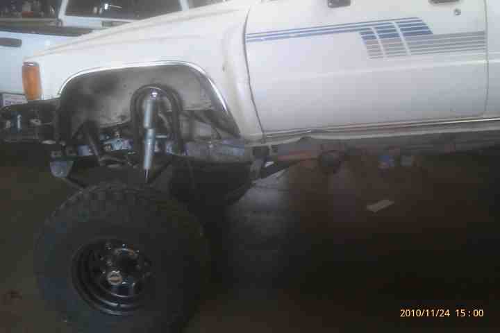

BEFORE PIX and vid

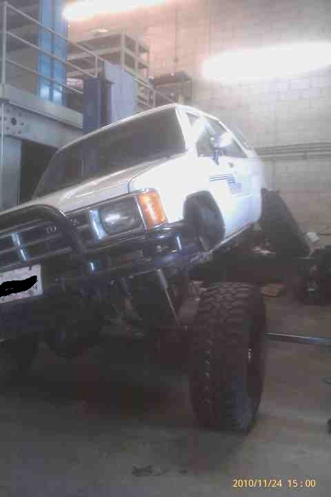

Very limited flex with stock set up:

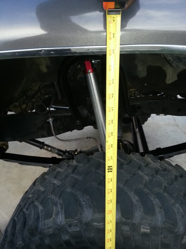

AFTER PIX!

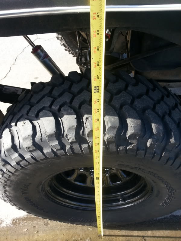

Floor to fender
Rear Tire to Fender
Front Floor to Fender
Front tire to fender
FLEX SHOTS AND VIDEOS!!!! WOOOOOOOT WOOOOOOOOOT!

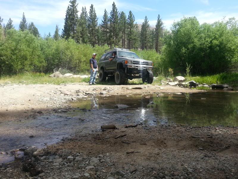

Videos After SAS and lift. Clutch got a good workout. My throttle body was acting up a lot this day and and was running at about 300rpm. so please excuse the multiple turn offs. lol Also was barely getting used to the new set up. This was the first off road trip after the SAS.

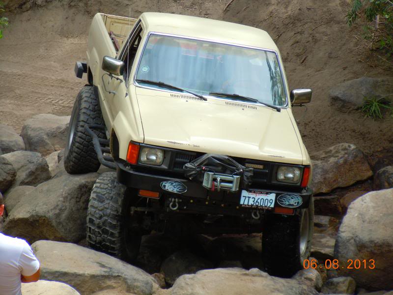

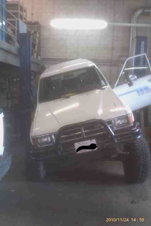

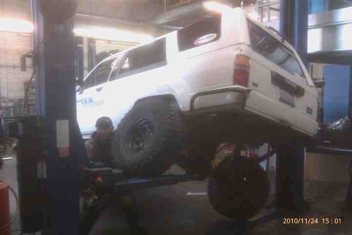

Some of the crew i go off-road with. 85 toyota pickup 5" all pro lift, marlin crawler dual transfer case, detroit lockers front and rear, 4.88's, 35" KM2 M/T's
and a white 1989 4runner SAS'd front and rear axles with chevy dana 44's, detroit lockers front and rear, 4.88 gears 35" MT's
