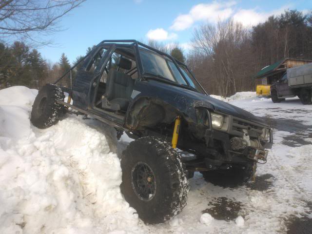

Sounds like you got it Konayota! What are you running for a front drive shaft?
Heres mine, now that its completed. 85 Front axle with a marlin rebuild kit and all the TG Armor, 48" RUF springs. Sky hanger/shackles, 30 Spline Longs, Creeper Flanges, 5th Stud, 7/8th Hemi Steering. IFS hubs ground down used with Tacoma slip on rotors. 4.10s and a locker. Ford 12" shocks and towers, TG extended brake lines. Daystar mini bumps and a square front shaft made from 2 single joint yokes. About 3" total lift over stock. 3" up travel and about 8" down. 25" to the frame
Front has more droop to go.

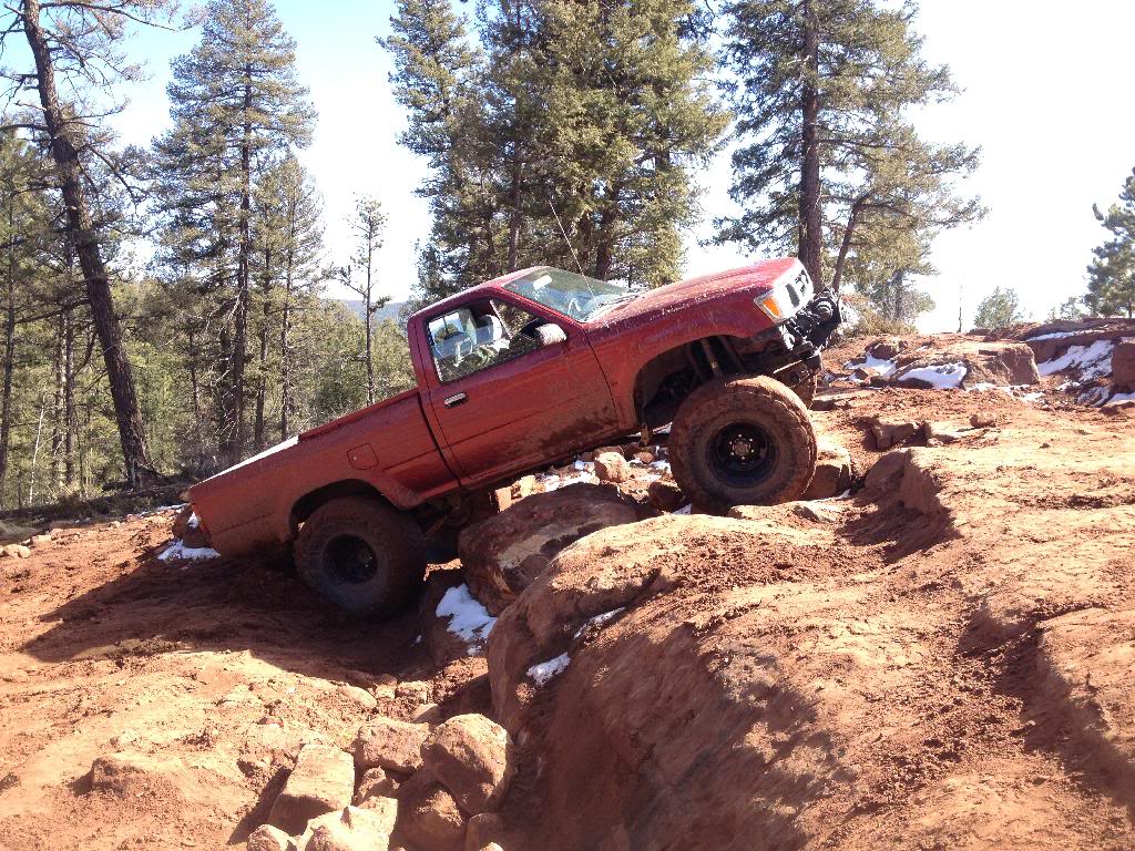

Why I need front bumpstops

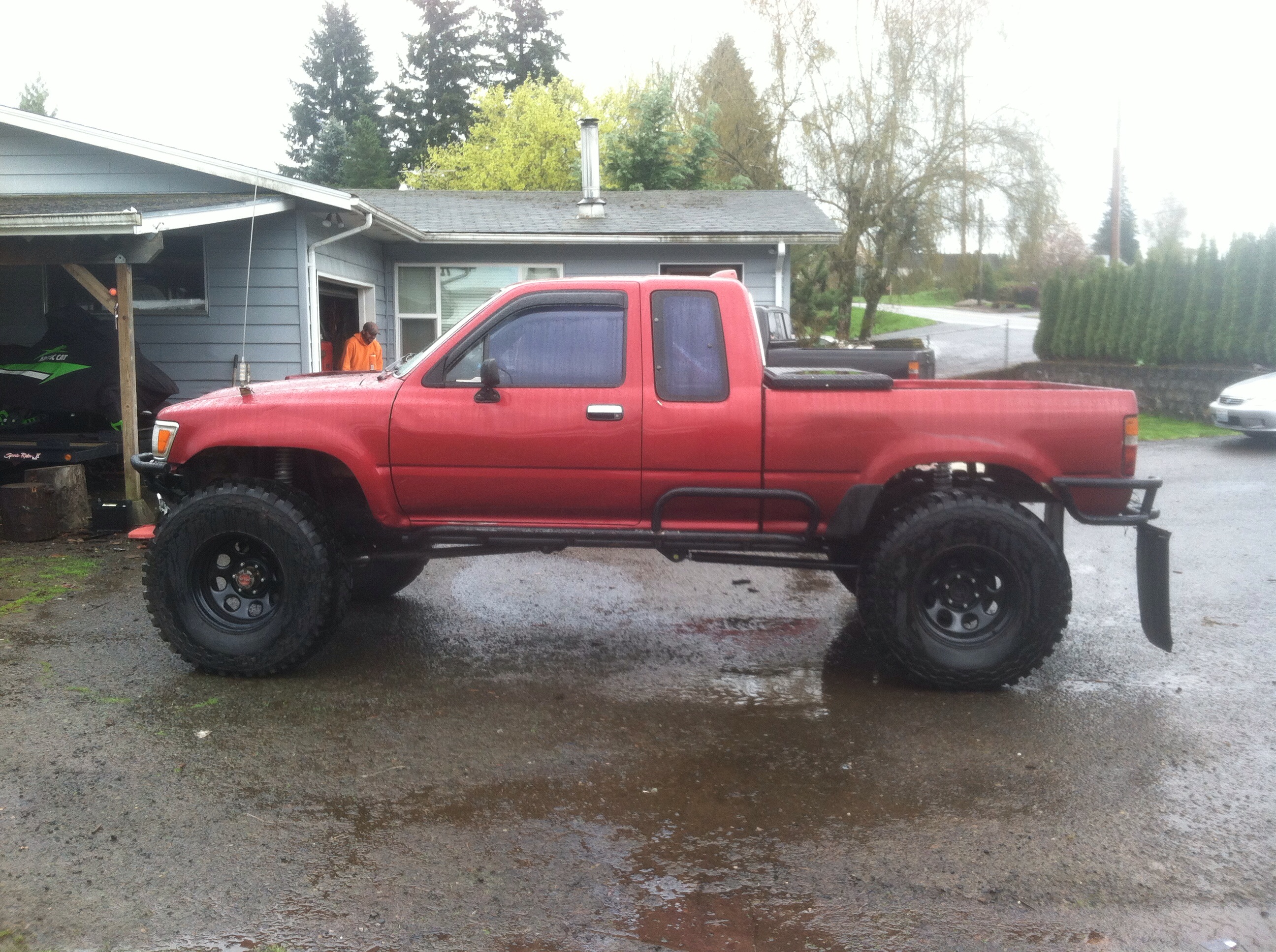

Need to bob

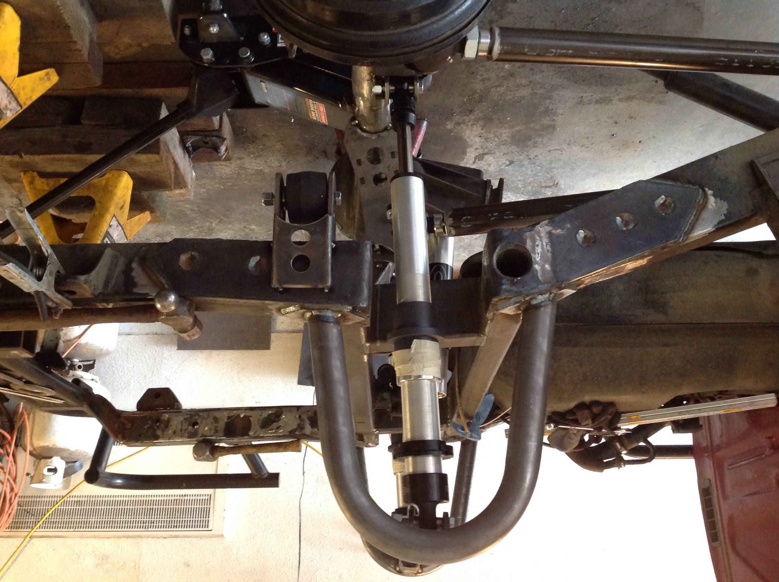

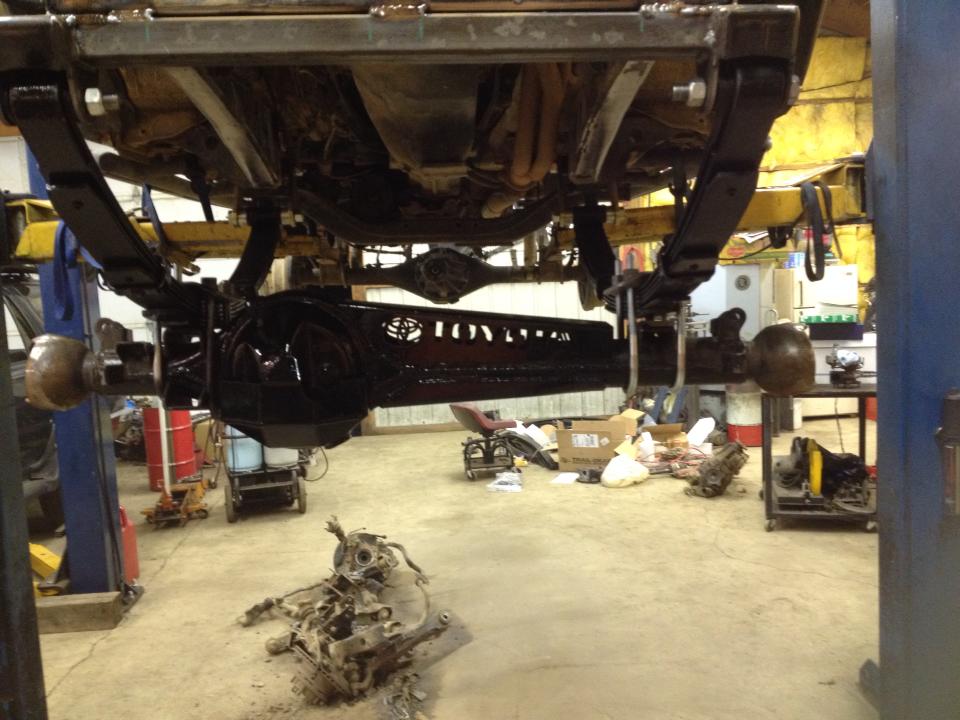

My rear mock up 3 link
Started in on custom 3 link
Old Apr 10, 2014 | 12:24 AM
  #251
Kkrause09's Avatar
Joined: Mar 2014
Posts: 5
Links for days
Finished rear set up

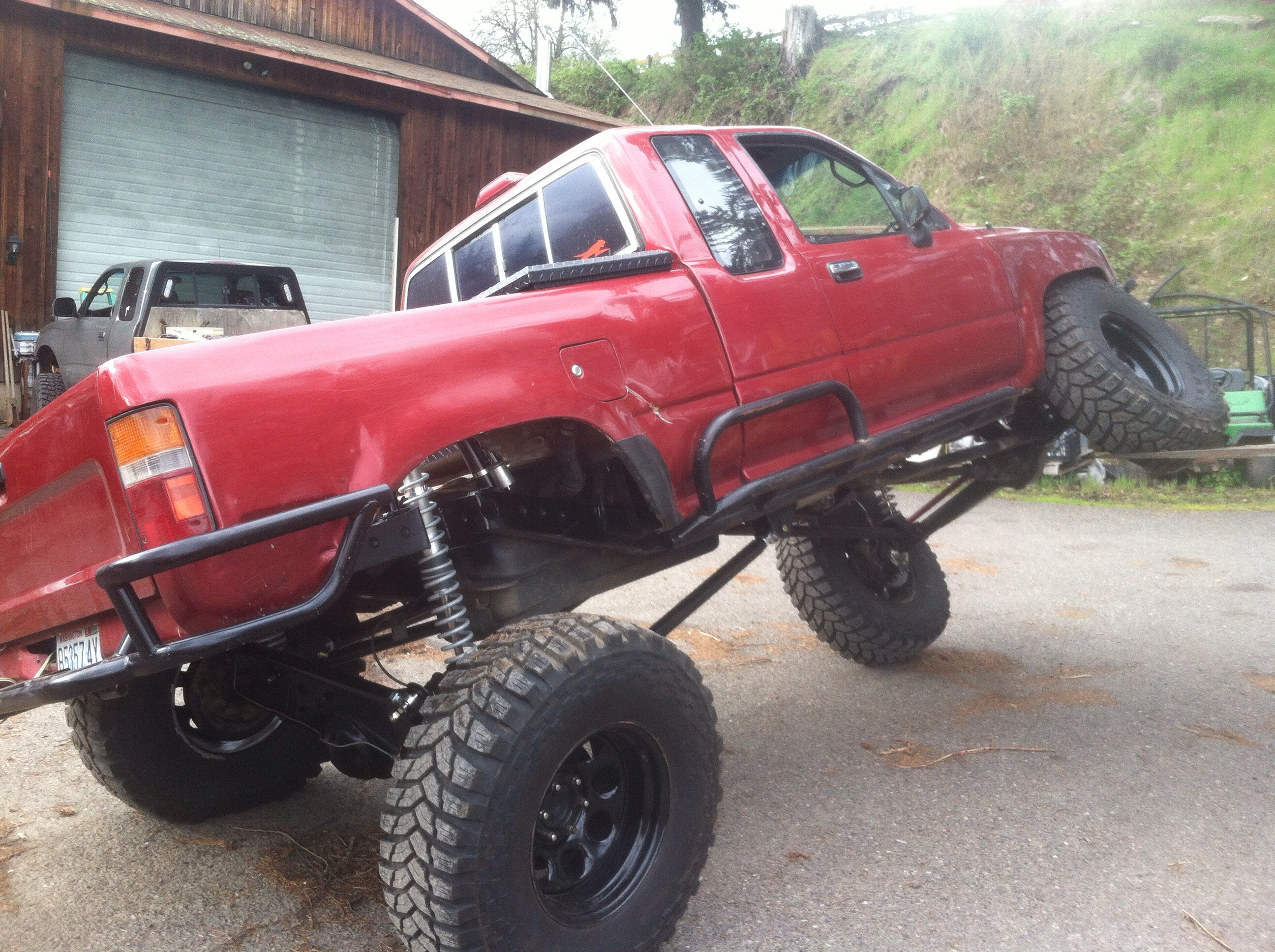

Ride height
22" frame to ground, 37" treps

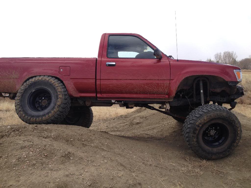

Sorry no build thread
Trucks a 94 w/ 4coil 3rz swap and running 8psi Garrett t3t4, 5.29s,detroitsf/r,dirtys,5shooters,duals,4.7,builtnotbought rock protection,bobbed12",14"radflo dual rates every corner,3linked f/r,37treps

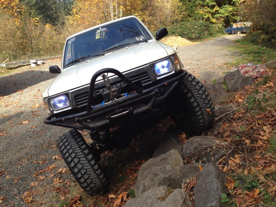

1990 sas it won't let me upload a picture :(
Size:  118.9 KB1990 toyota pickup:
-22re: bigger cam, bored .30 over, cold air intake, rock ripper header, and super 40 flowmaster.
-straight axle: dirty 30's, six shooter knuckles, trail gear 3" IFS eliminator kit
-rear: chevy 56" springs with sky's chevy shackles
-35" Kevlar wrangles
-built my own front and rear bumpers
-smitty built 8K winch, and spartan lockers front and 4.88's

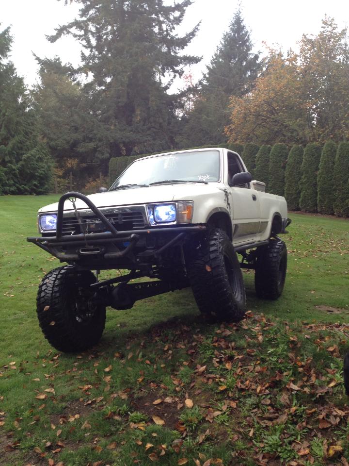

Here's mine... It's got a landcruiser 79series front diff
