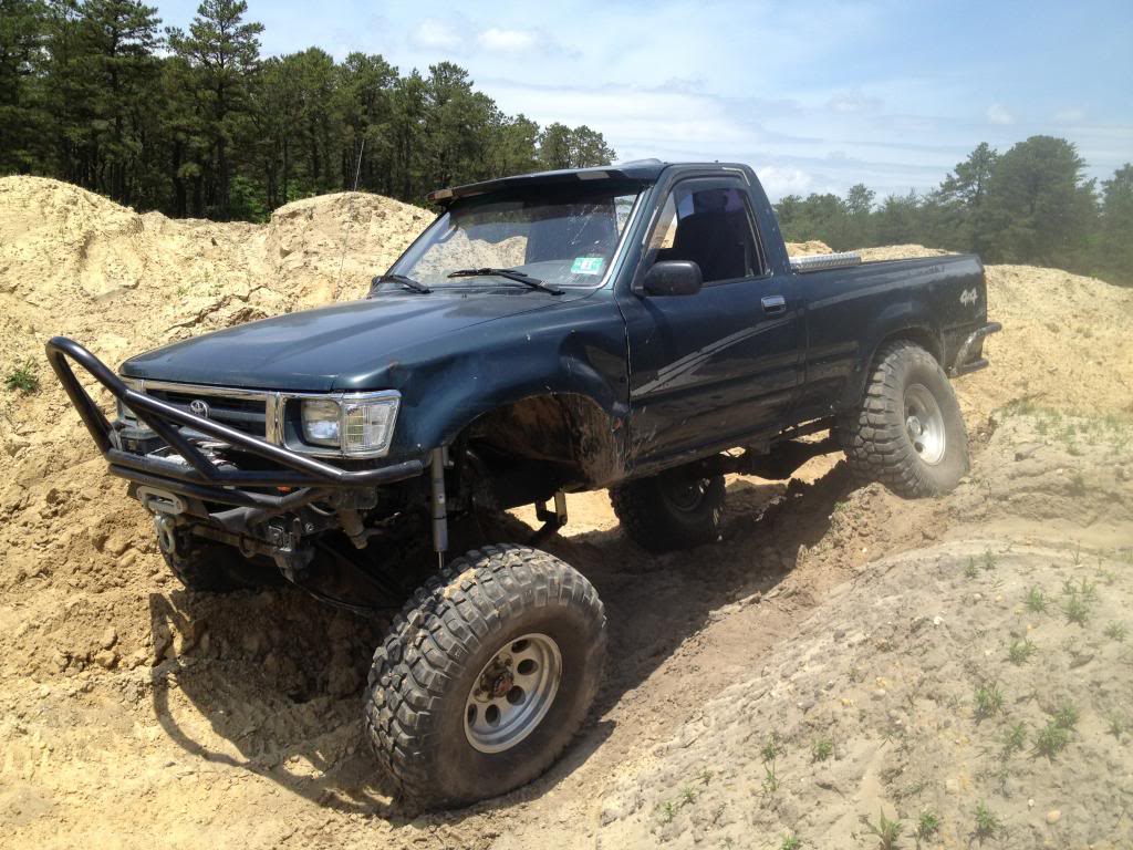

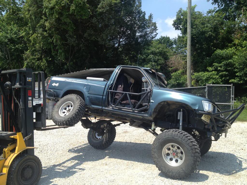

1994 22re Doug Thorley headers,big cam, electric fan. locked front and back..5.29 rears. double transfer-case 2.28 /4.70. Disc brake conversion in rear. 63in Chevy springs in back 5in trail gear springs in front. 35in KM2 on 15X7 rims. XRS Corbeau seats. rock sliders, waiting on exo cage..
