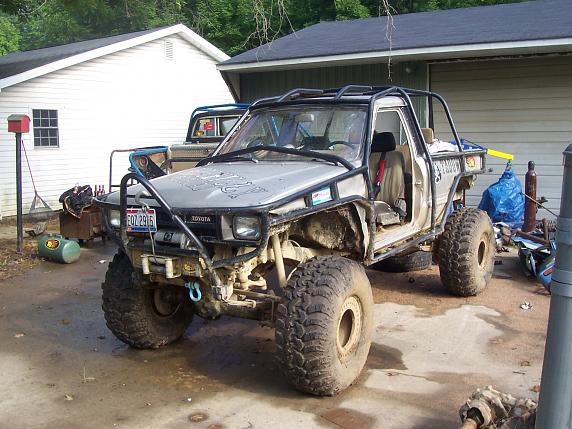

Heres my 85 runner

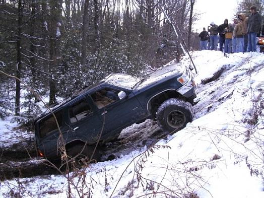

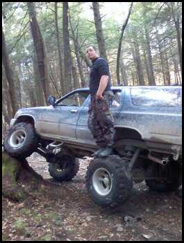

i was tryin to post some pics of my 94 runner which is all custom built using the stock 85 springs. i couldnt figure out how to post the pics on this thread but you can go in my photo gallery. the reason i wanted to keep the stock springs is because i didnt want that buck board ride that you get out of the arched springs. it rides way better than any other sas i have ever been in and flexes pretty good also. it ended up bein about a 6 inch lift and i have 36s on it now and they dont rub even when flxed to the max. the tires in the pics where im flexed are the 33s and al the pics in the snow are 36s.

think i figured it out. the pic of it on the floor........well yeah she fell off the jack stands. the the best pic i have of how we built it. as you might be able to see those things hangin down that look like teeth are what the shackles hook to. its similar with the rear of the front spring also

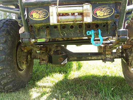

1988 4cyl DLX 4runner
Trail gear nuckle rebuild kit & hysteer & u-bolt flip
Dana 44 wagoneer springs re-arched = to about 6" lift but very flexy
Custom front hanger with tube bumper coming off
