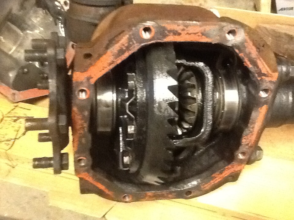

Currently fighting one of many...This I'd my first differential issue..and I've got a lot of verticle play on the passenger side axle. The diff is out and the cover is off and I cant seem to figure out how to get the axle out..I looked for rings inside and out... Don't see anything... What am I missing?What is broken on YOUR Toyota-image.jpg

Originally Posted by Billy Ray Valentine
Currently fighting one of many...This I'd my first differential issue..and I've got a lot of verticle play on the passenger side axle. The diff is out and the cover is off and I cant seem to figure out how to get the axle out..I looked for rings inside and out... Don't see anything... What am I missing?Attachment 100510
Put a couple bars or big screwdrivers behind the flange and pop it out.
There is an expansion ring that you can't see.
